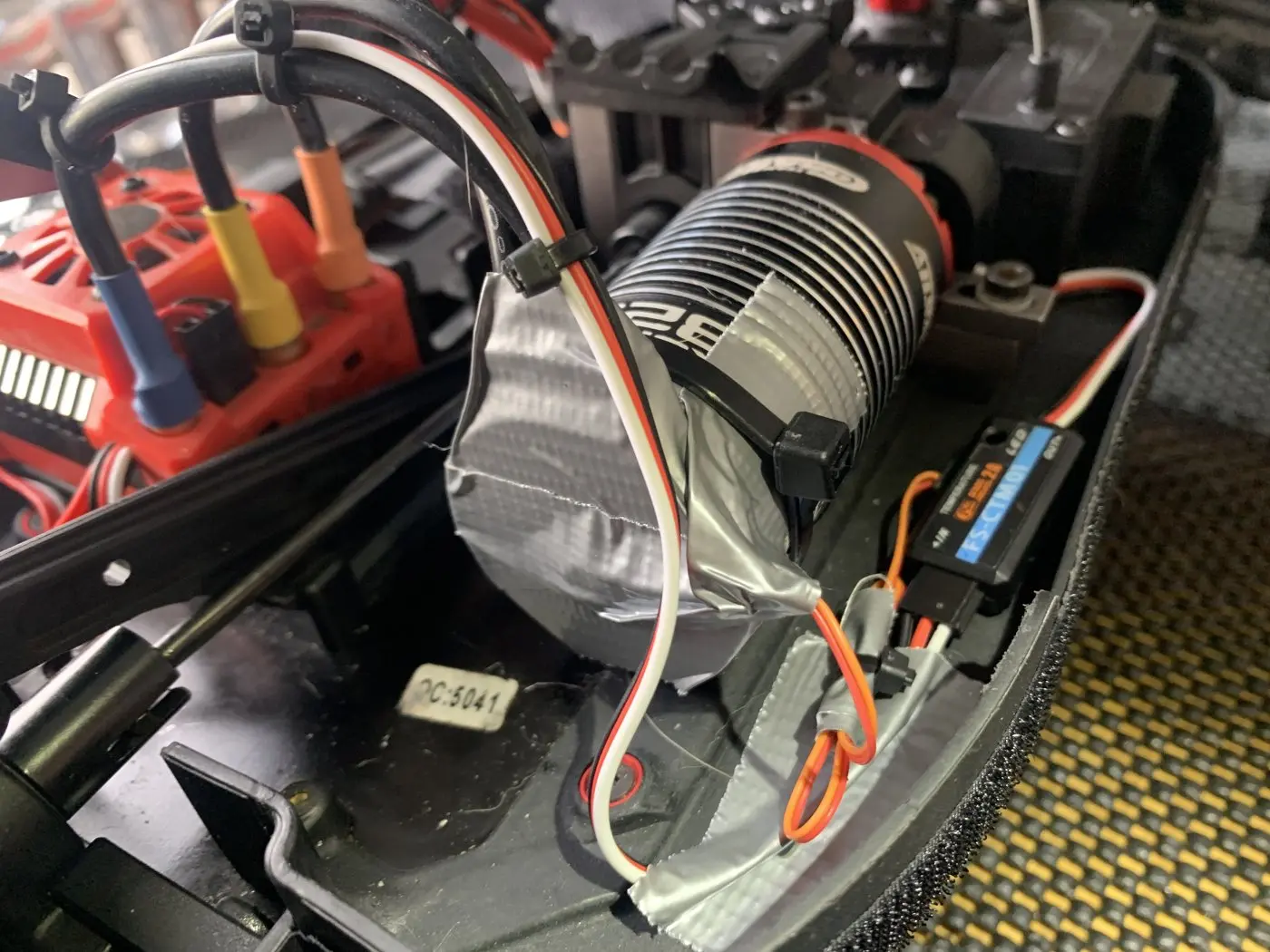

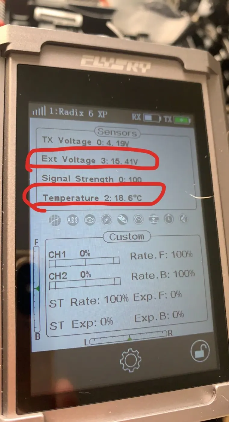

Today i installed telemetry on my Radix 6 (voltage-sensor on main battery, and temperature-sensor on motor), so now i get real-time data on the screen of my Noble Pro transmitter. Love it! :love: The voltage also is synced with the RX battery-indicator at the top of the screen.

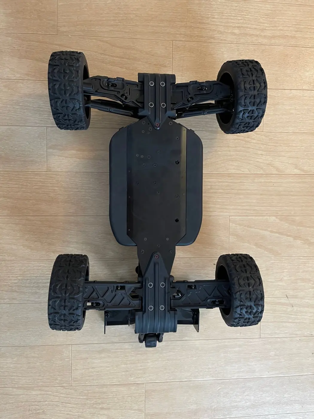

I installed both the front and rear bumper with skid plate from the Kronos/Jambo on my Muraco. They should give me more protection, especially to the bottom of the chassis.

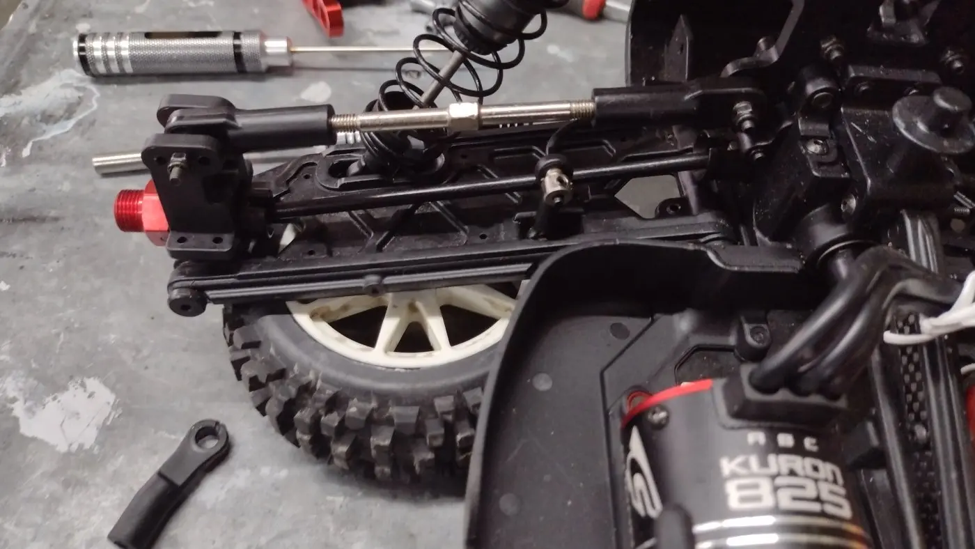

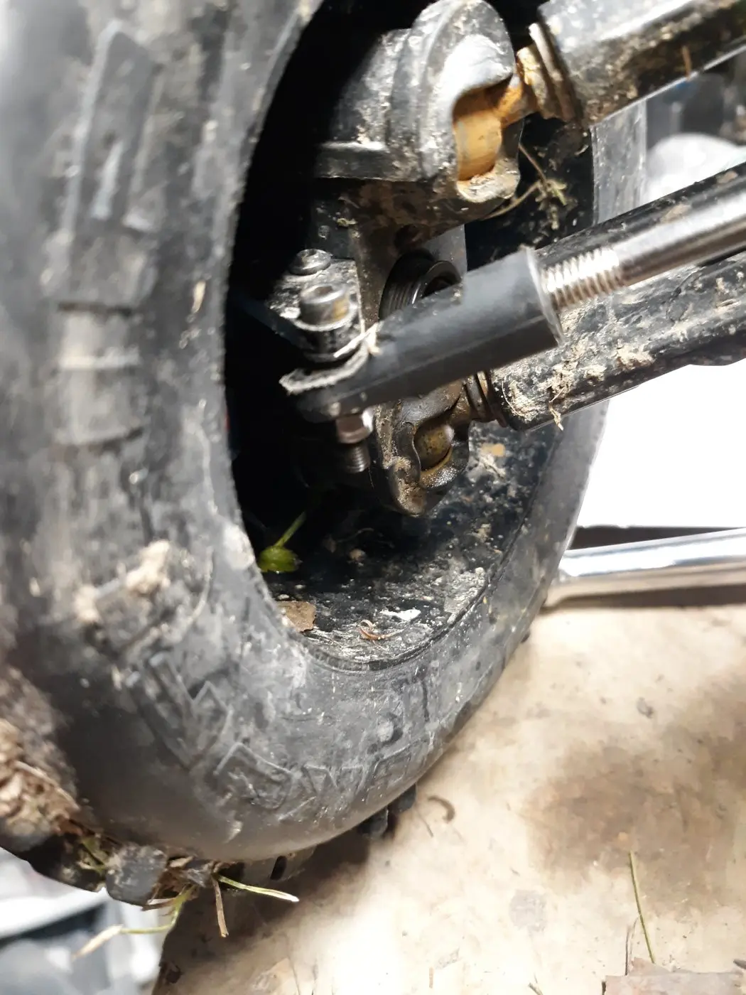

So, I replaced the side I broke yesterday with a rear camber link, Thunder Tiger rod ends and stock pivot balls. I shaved the Thunder Tiger rod ends down with a grinder so they can actually pivot on the balls..

Very nice, should work great!

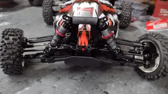

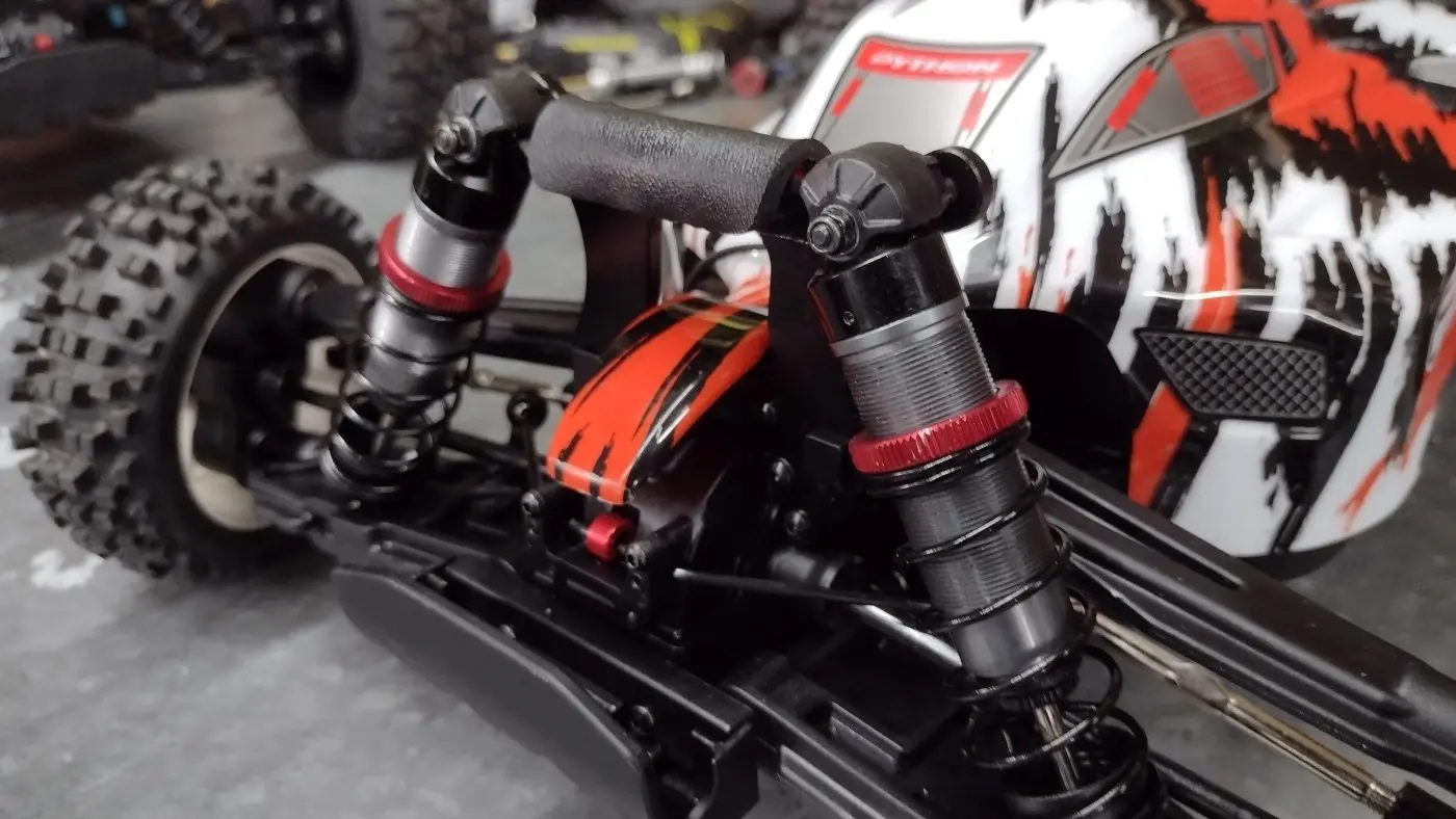

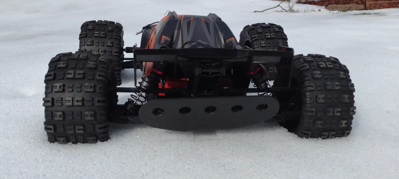

Built a stand off protector for python, normally I shoot these straight forward cause I have a body covering it but the buggy is exposed so I rolled it down so it wouldn't dig in the ground on a bad landing
I don't care for the look of the TC shock protectors but, might be worth it for the buggy?

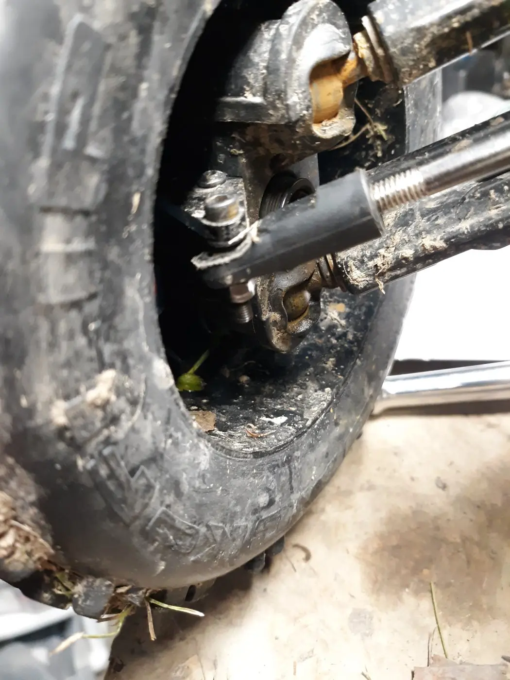

I used rod ends I didn't care about as a test. Now that I see the fit, might have to switch out to some longer ones, figure more engagement between the turnbuckle and rod end will be better. I have a plethora of 5mm rod ends.

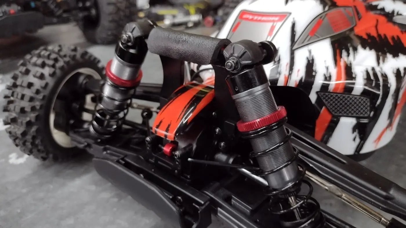

Yeah I modified a set of arrma shock protectors for the radix, still have the other 2 and was debating doing it on the python too.
The losi ends thread in really far on the rods, downer is you gotta buy the 8.8mm balls for them which is another $10-12 so costs about $25 per rig to do that upgrade, not terrible but adds up when you got multiples, I'm sure you'll find a fit, when you do report back, always nice to know options.
