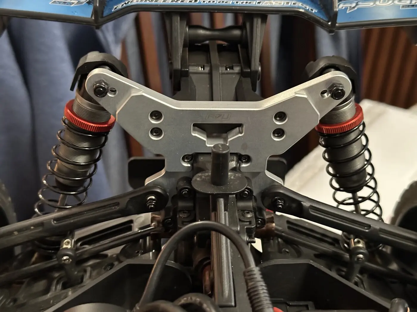

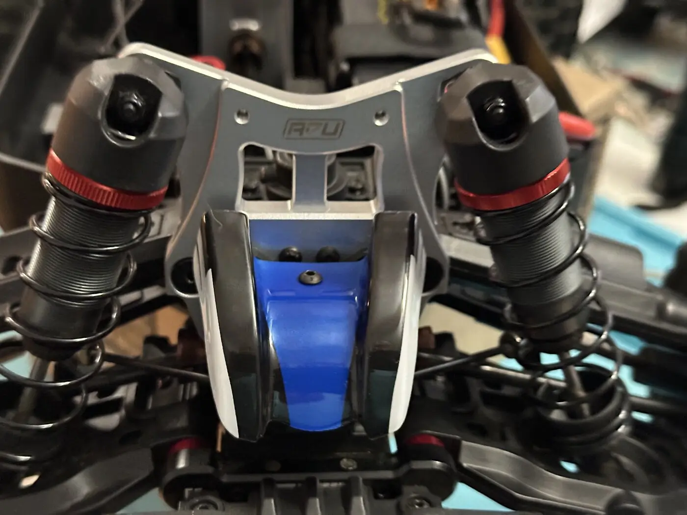

What's not to like? They are 7075 aluminum and super thick. I don't jump my Asuga - I primarily run it fast on my dirt and grass backyard, so the shock towers won't get much punishment.Those look nice!

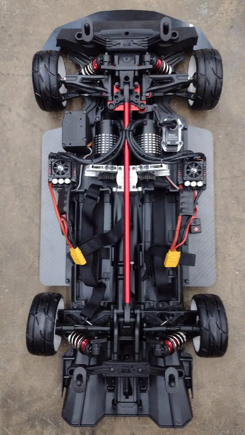

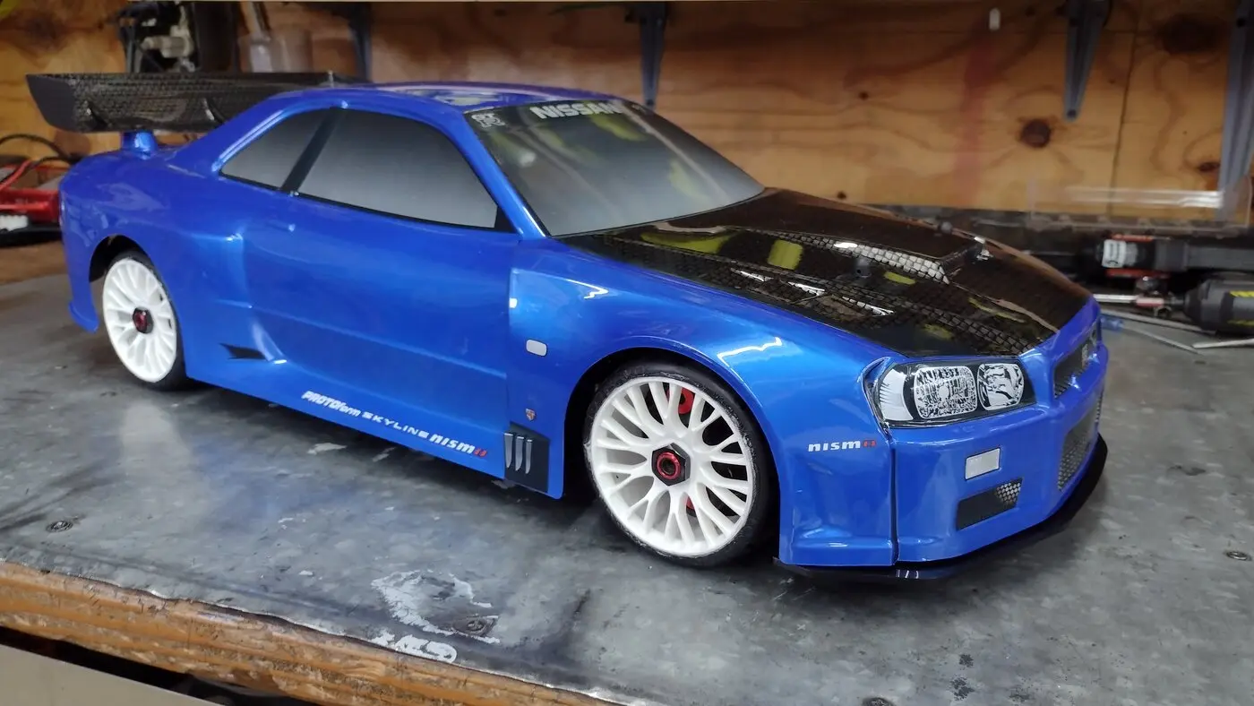

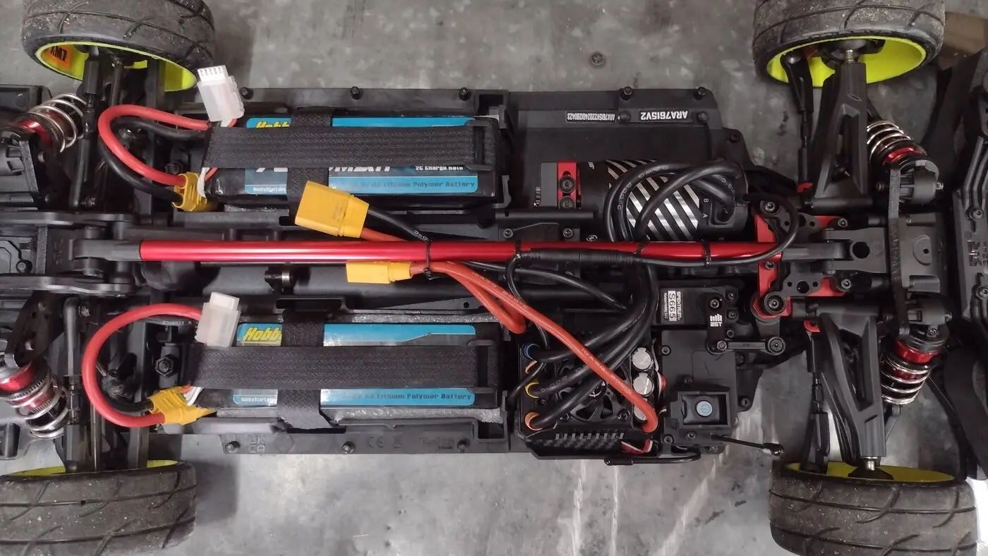

Can't wait to see what it can do.Worked on my dual motor car, waiting on one last piece then I can finally test it
How you make two esc react to just one controller?Worked on my dual motor car, waiting on one last piece then I can finally test it
It's pretty easy actually, any normal radio/receiver, just calibrate them individually then hook them to the receiver via a y splitter, one esc you'll need to pull the red wire out of the connector so your not putting power to the receiver off both, I pull it on the y to not alter the esc itself, just have to remember to turn the "powered" esc on firstHow you make two esc react to just one controller?
I suppose you'll need more than a standard controller for that, right ?
so how did you fix the front arm shim issue? i haven't upgraded anything on the front arms only the tower to tower brace. i noticed the front right arm has too much play. any suggestions ?The shims for the front upper suspension arms arrived today and I installed them. I had been utilizing a temporary fix to solve the issue of the front suspension arms not fitting properly after installing the aluminum steering deck and new suspension arm mounts, but now the issue has been fixed correctly.
