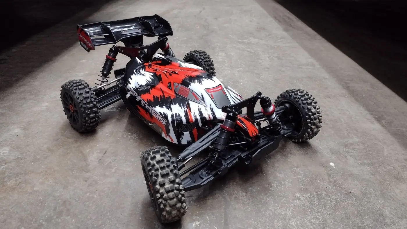

I send a message 2 corally. No 7075 shock towers for the Sketer. Will go for the basherqueen carbon ones.
Woven carbon fibre parts look awesome. 😎👌
💡 It's a really good idea to seal the edges of CF parts with super glue. 👍

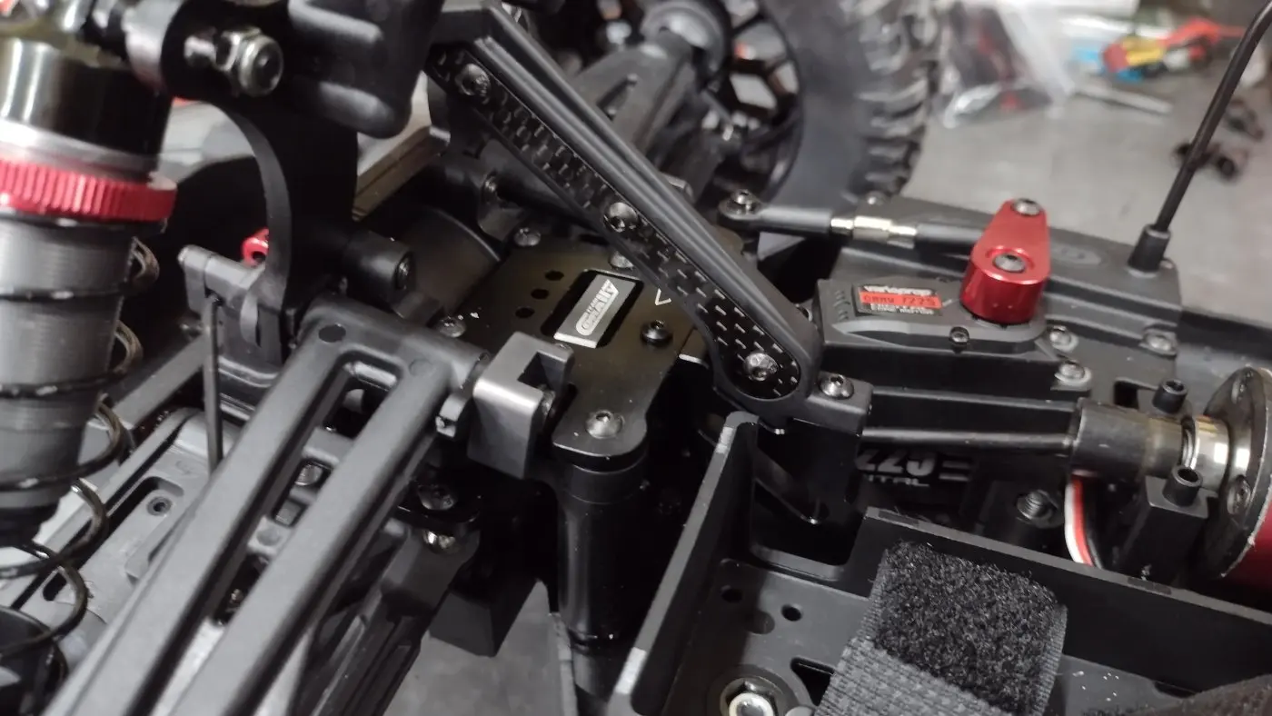

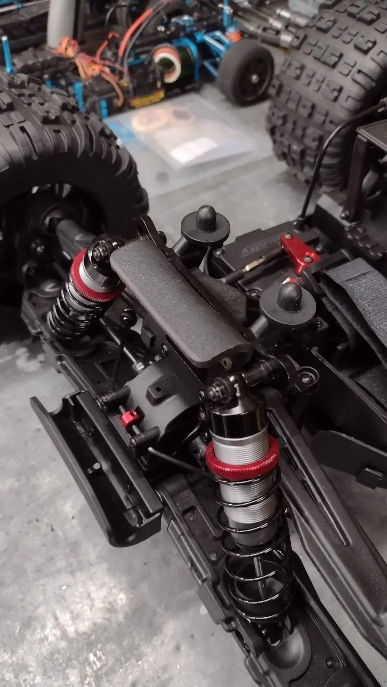

Stiffened up the jambo, 7075 braces and steering bits, HD hubs and shock ends, and built a standoff protector, did the diffs, pretty much done aside from waiting on the large cap pack to show to replace the stock one

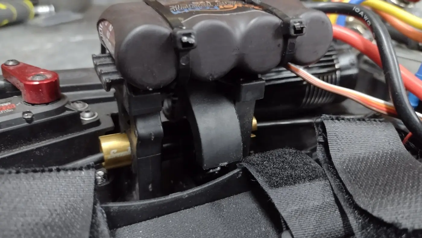

Put a speedtek 35t spool in the radix, waiting on a few new pinions to show. She's a dedicated street car now, should be in the 100-110mph territory
Crikey! I thought driving the Kronos XTR at 62mph was challenging enough. Your machine must be proper scary. 😱👍
Nah, sure it's fast being 8s and all but that car is planted, once I turned it into a wide buggy it's unbelievable how easy the car is to drive, it's a hoot but so stable anyone could drive it flat out

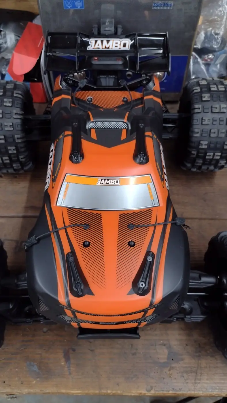

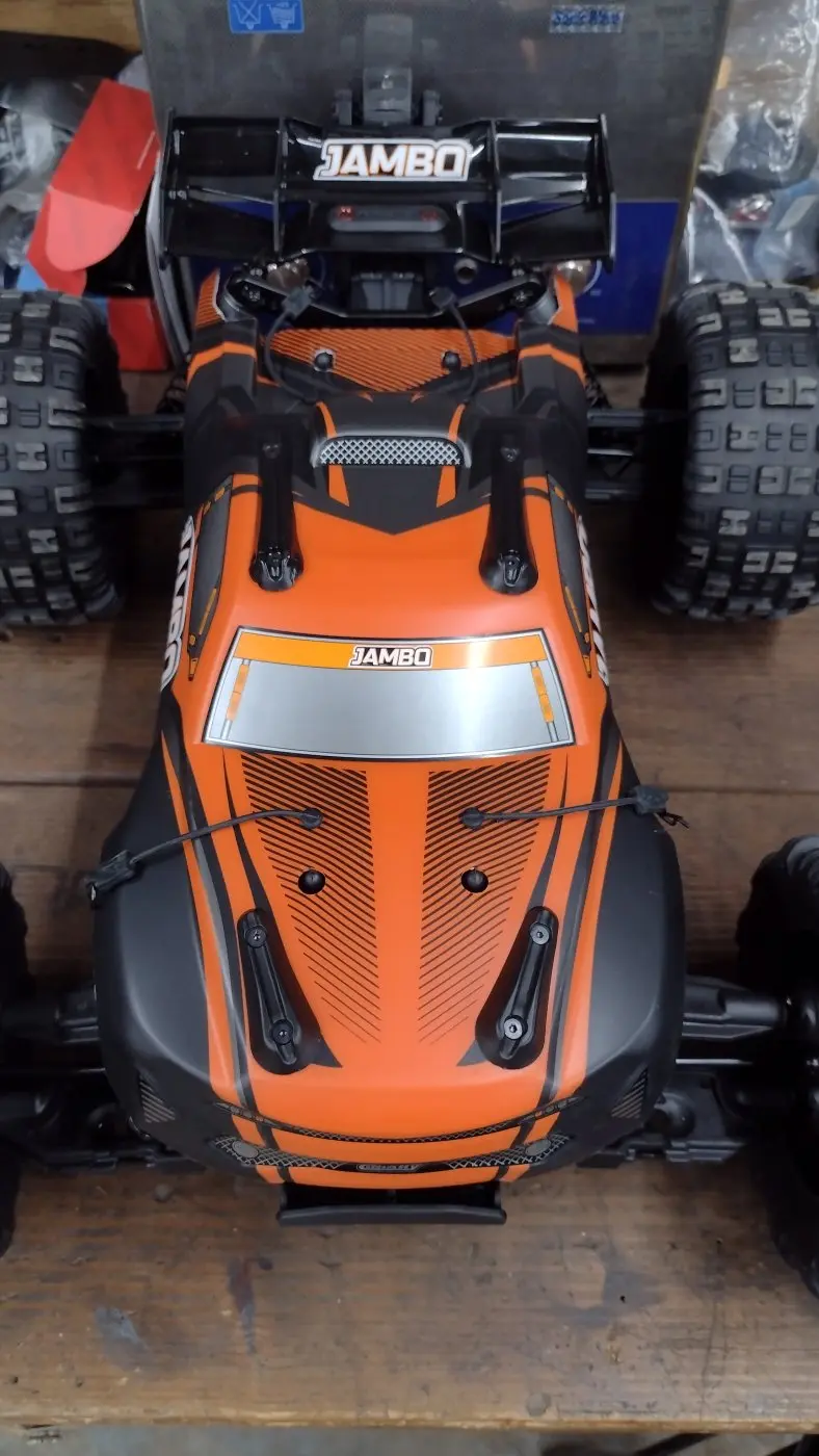

Threw some proline body protectors on the jambo, not sold on the look but they serve a purpose
I like them - good idea. 👍. Have you still got the protective film over the body, or is it just a trick of the light?
Film is off, it's got a flat finish, not the typical shine you typically see

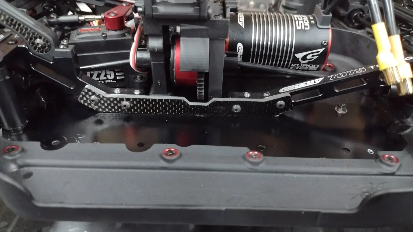

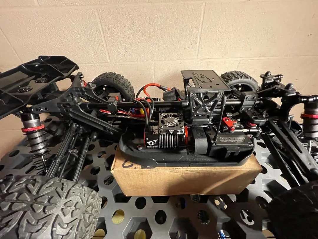

Got and attached carbon chassis stiffener, I question it's longevity but it definitely took all the flex out. Just waiting on the rear half of the tower to tower brace to show, only going to run the rear section, after that I can finally test the jambo out

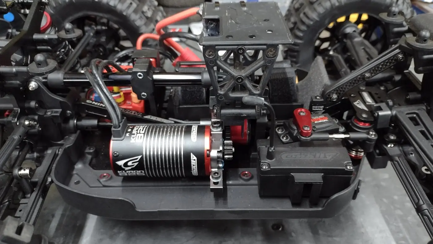

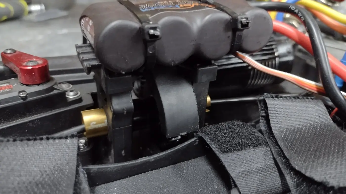

Finally finished up the jambo and she feels rock solid. Upgrades are 7075 chassis braces with carbon chassis stiffener, 7075 steering deck and dual stiffener, carbon inserts on front shock tower brace, hd shock ends and pillow blocks, heavy springs, losi 8ight t camber links, and rear half of tower to tower brace, as well as a 10,750uf cap pack, just need some good weather to go play

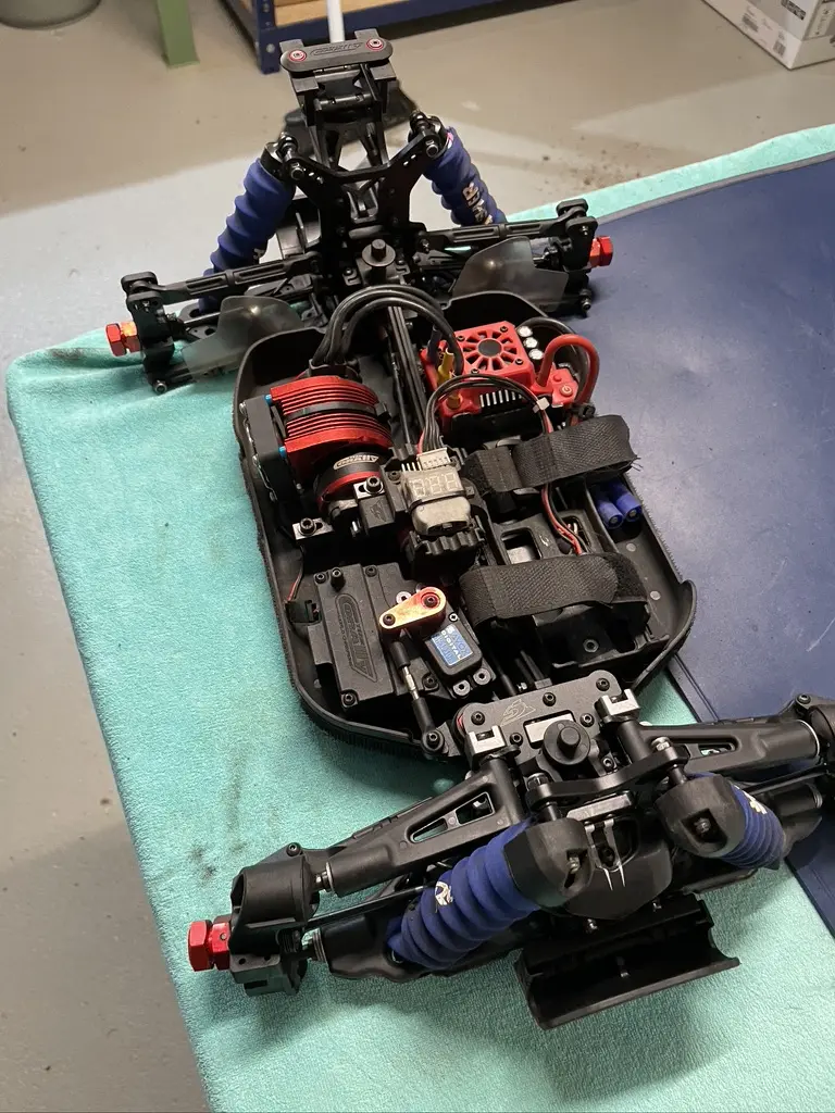

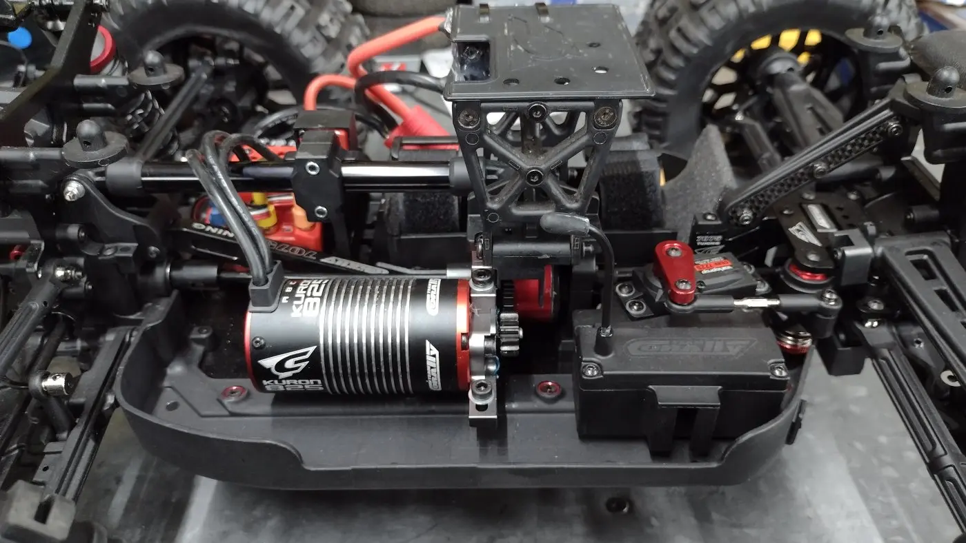

In my Muraco I have 7075 front and rear shock towers; 7075 front and rear chassis braces; and the T2T chassis brace that came with the upgraded aluminum steering deck assembly.
