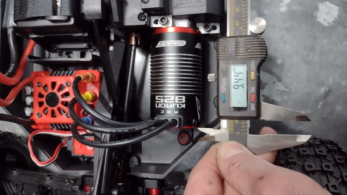

I get 62mph out of my Kronos XTR using the 825 on XTR gearing. If the Asuga is a 1.5lb lighter, it's going to be faster even on the Corally Electronics. If people shoehorn 7000w into this thing, it's going to exceed 100mph, surely? 🤯
No experience with Mamba Monster X or HW. I know Corally (what needs a fan 2 keep it cool) is a rebranded Hobbywing. What i want is power and a cool motor. Speed, ofc but it needs to be controlable. Would love not to run a fan on the motor.

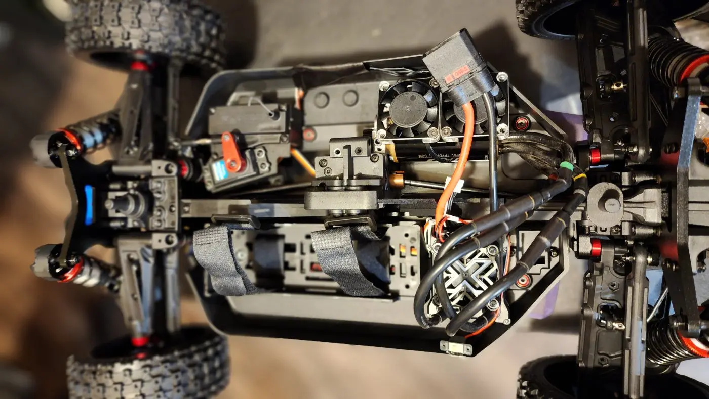

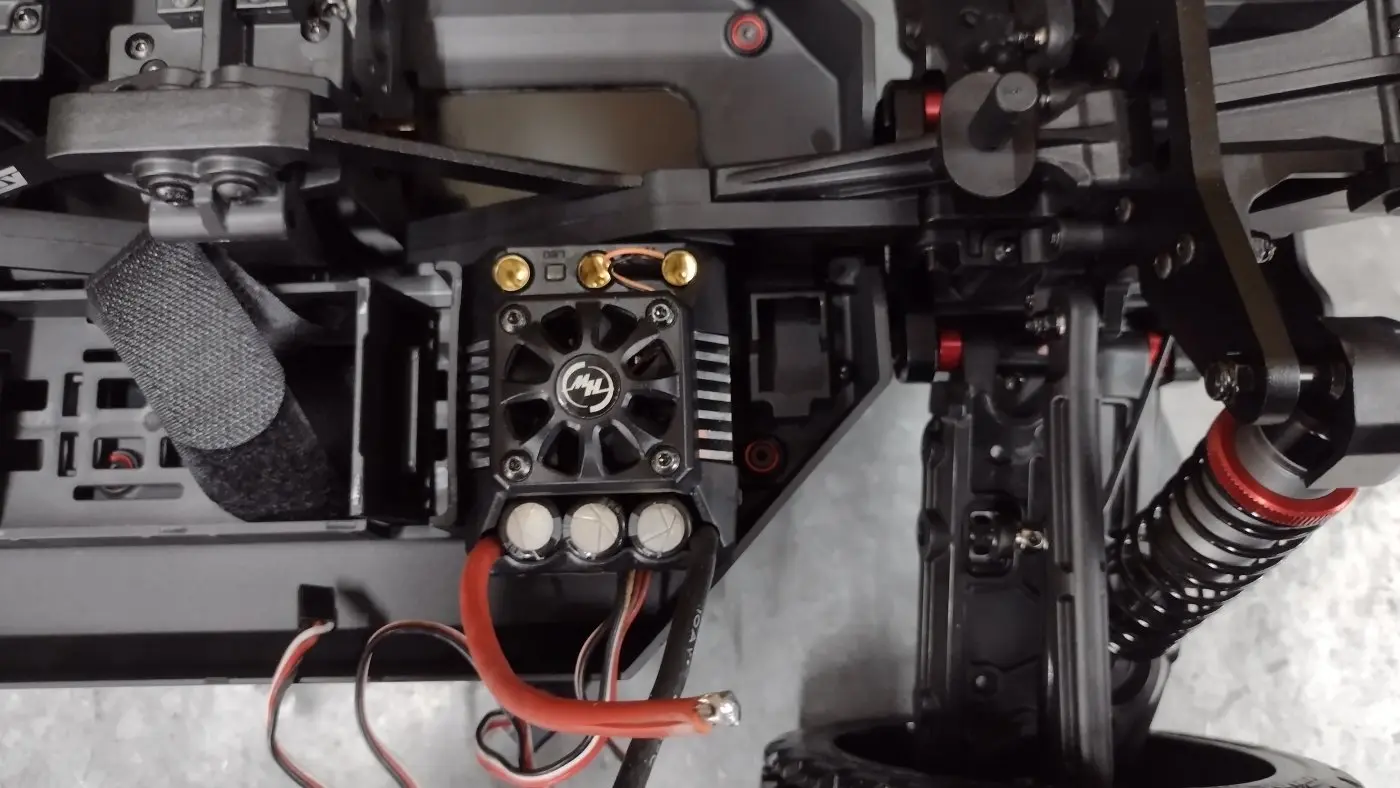

Quickly put together with a tp 4040 3770kv until the real motor is here Friday. About to go test it soon as lipo finishes. Probably going to be 29f outside but I sure don't have the patience to wait until tomorrow. 🤣
Any issues with that MMX8S? Looks like you have the full battery box and didn't have to the car sides any
Its definitely squeezed in there tight and is poking against the side guard. It works but I might end up nipping a piece off at some point anyway.
Only got to test it for a very short amount of time as it was freezing outside. My fat ass SMC dv extreme 6300 mah packs barely fit too. It felt really nice and smooth to drive. Definitely happy so far with my first TC.

I was trying to hold off because I wasn't sure how the MMX8S would fit.
How much space do you think is open between that TP and the chassis, or what's the largest diameter you think would fit with the stock mount?
The body appears to come straight back, so snipping some of that angle plastic on the chassis wouldn't hurt much
My motor is 4074 and it looks like there might be about 8mm of space between the motor and the closes part of the side guard. I definitely think I'm going to have to cut a piece off to fit my 4092.

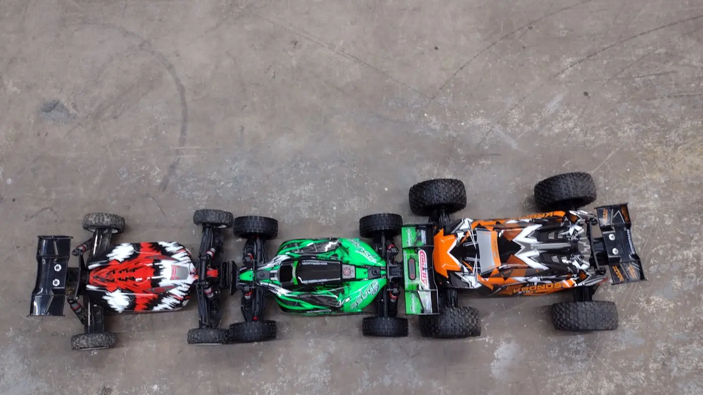

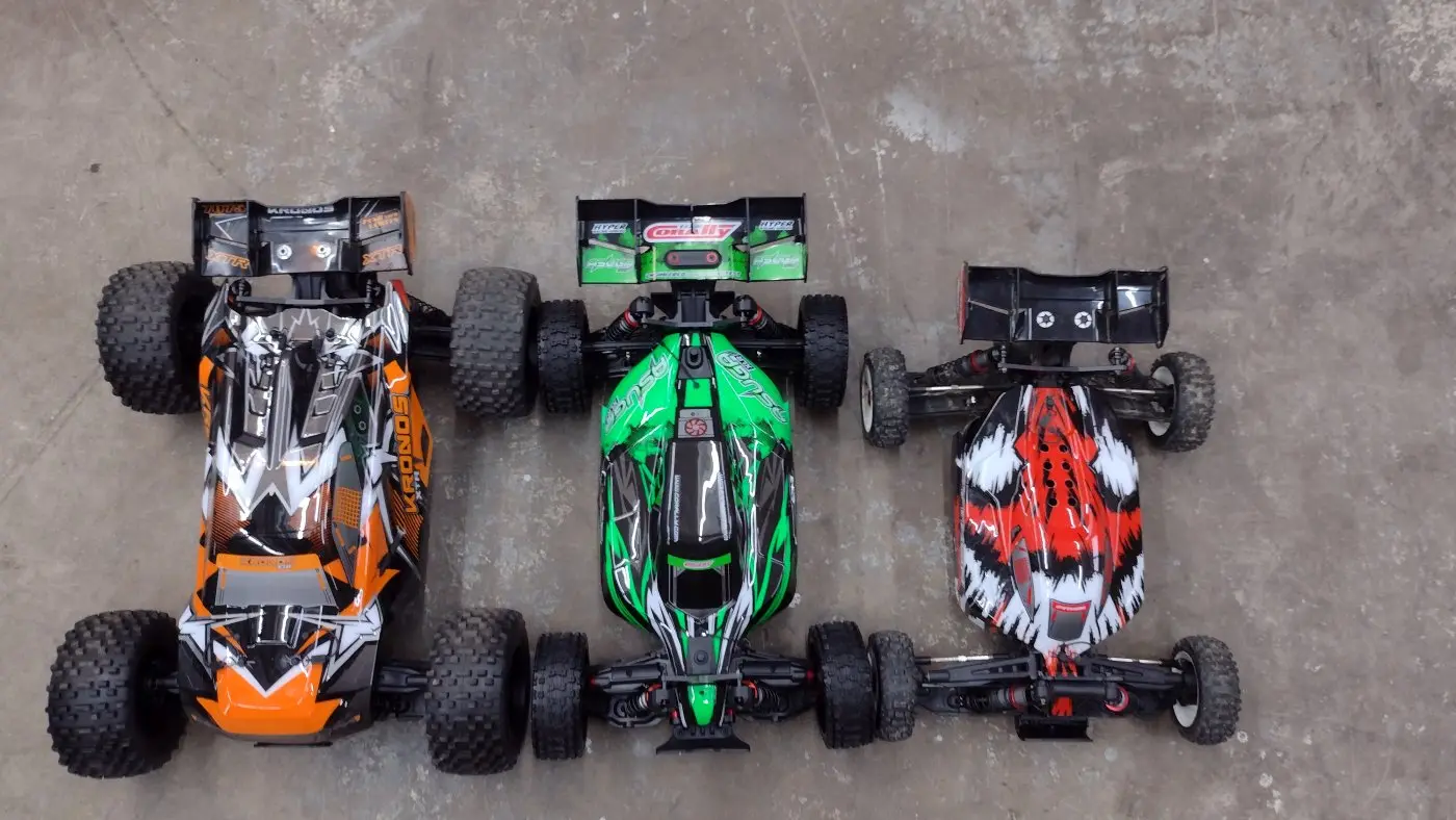

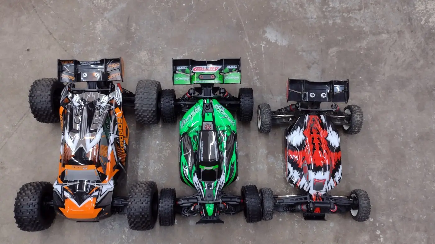

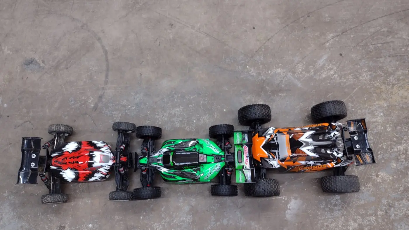

A little size comparison for those curious. It's very light, granted no electronics in it yet but weights the same as my python @ 8lb 13oz, xtr is 12lbs 7oz.

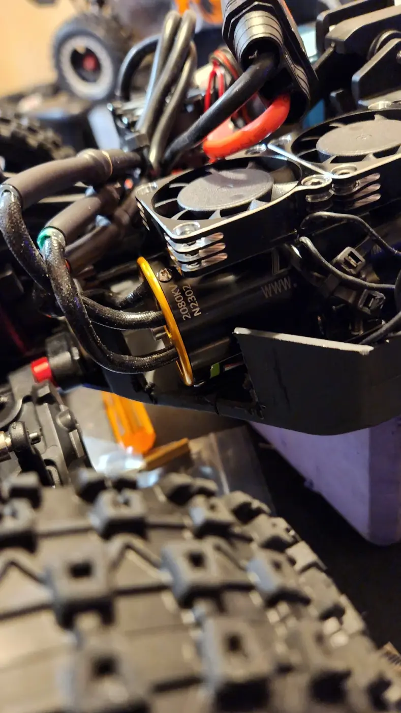

Oh, and a max6 will fit, it's touching center brace and side guard but fits, not what I'll be running in it though
Interesting. Maybe i am gonna make it lighter with carbon and stuff. The opposite what i did to my Sketer. But in the end i know myself and i will make it heavier 🤔
19t pinion is the max that will fit with stock center diff -_- That is the most disappointing thing I've found so far. They should have included a 46t center diff instead, like all the other buggies. People warned me but I totally forgot about it lol.
See you got a bit cut out to fit the motor? What size will fit not cutting it out? Can you measure it maybe?
I think a 4082 may but not 100% sure, I stuffed a 4985 in to see and it fit but was touching and allowed for no adjustment of motor mount so thinking the 4082 would work but may not be able to go max pinion?
