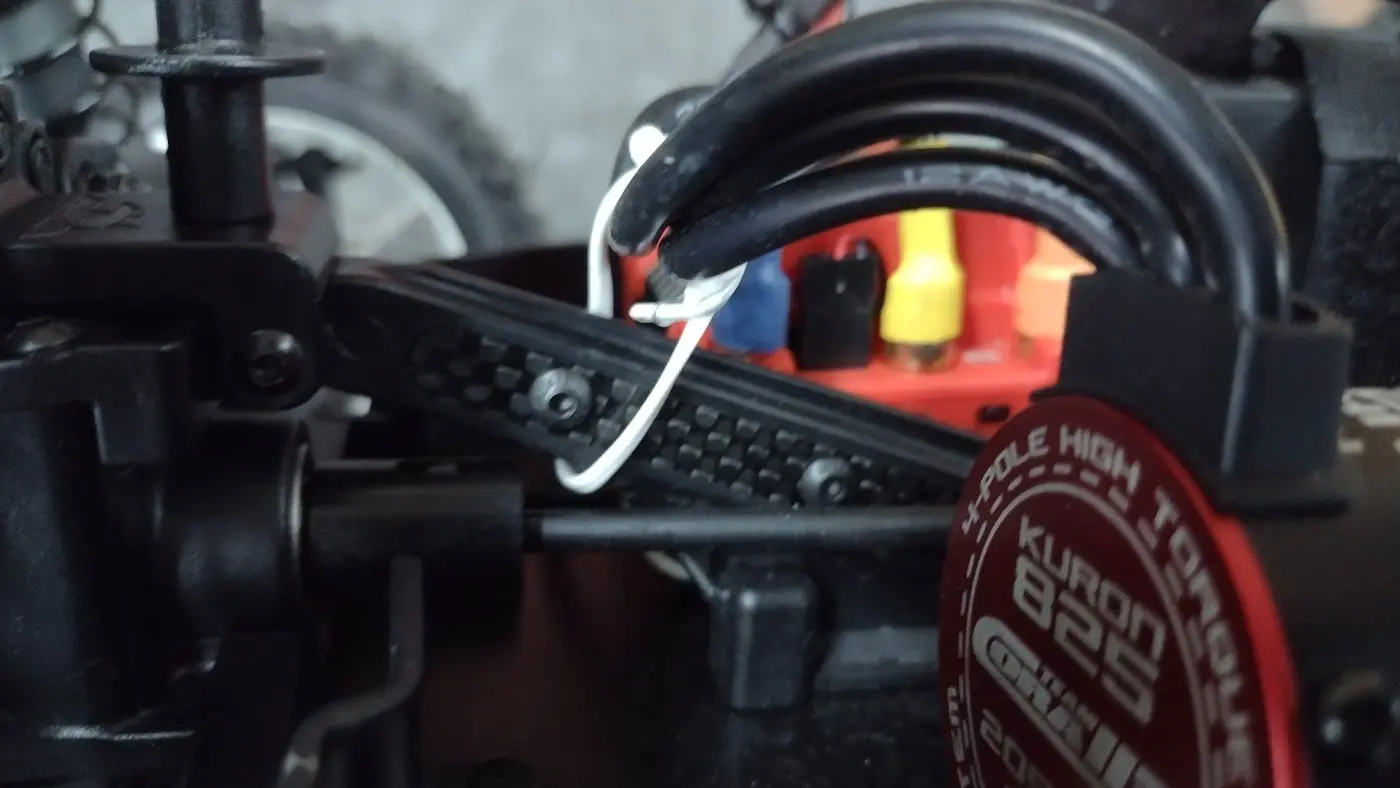

Jenny's shows the Kuron 825 @ 74mm. A Castle 1717 may fit with no trimming by the looks in that vid. 1717 is only 11mm longer(~1/2")
The space for the ESC may be the issue, not sure and MMX8S will fit.
Yeah, the 1717 is basically the same size as a 4985 so all depends what mount it has if it could clear the chassis. I had to cut both my radix and kronos to fit the mmx8s esc and they have rounded guards so I know this thing would need trimmed since they shoot straight back to the chassis, not opposed to it just hate cutting a new car up right out of the box

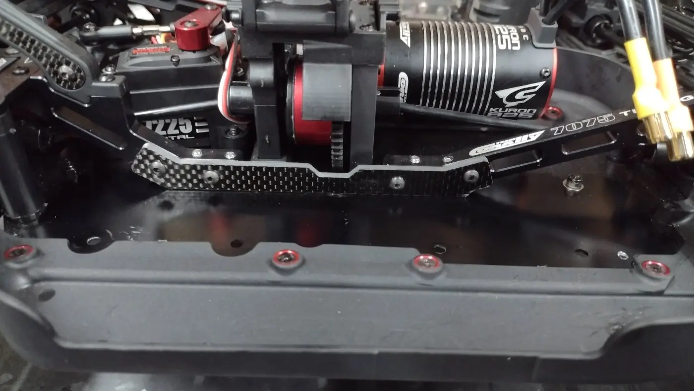

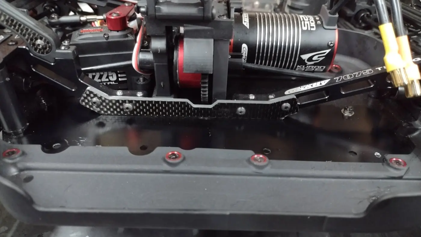

Yep, you got me I'm clueless! The only thing that gets rid of the chassis flex is the chassis brace in the last picture, even with all the aluminum braces they still flex, and that's not opinion, press your chassis on an edge and watch the body posts separate, xtr is the only one that doesn't because it comes with the brace and has a stronger chassis, I'm not here to argue but funny how all mine do or did
Space for Esc is a problem i think. Why not make space for it by trimming it.
