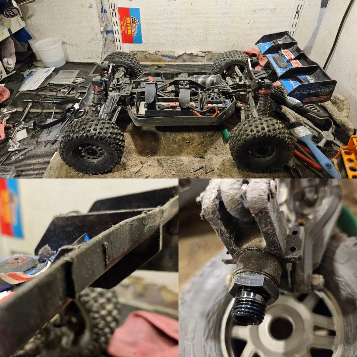

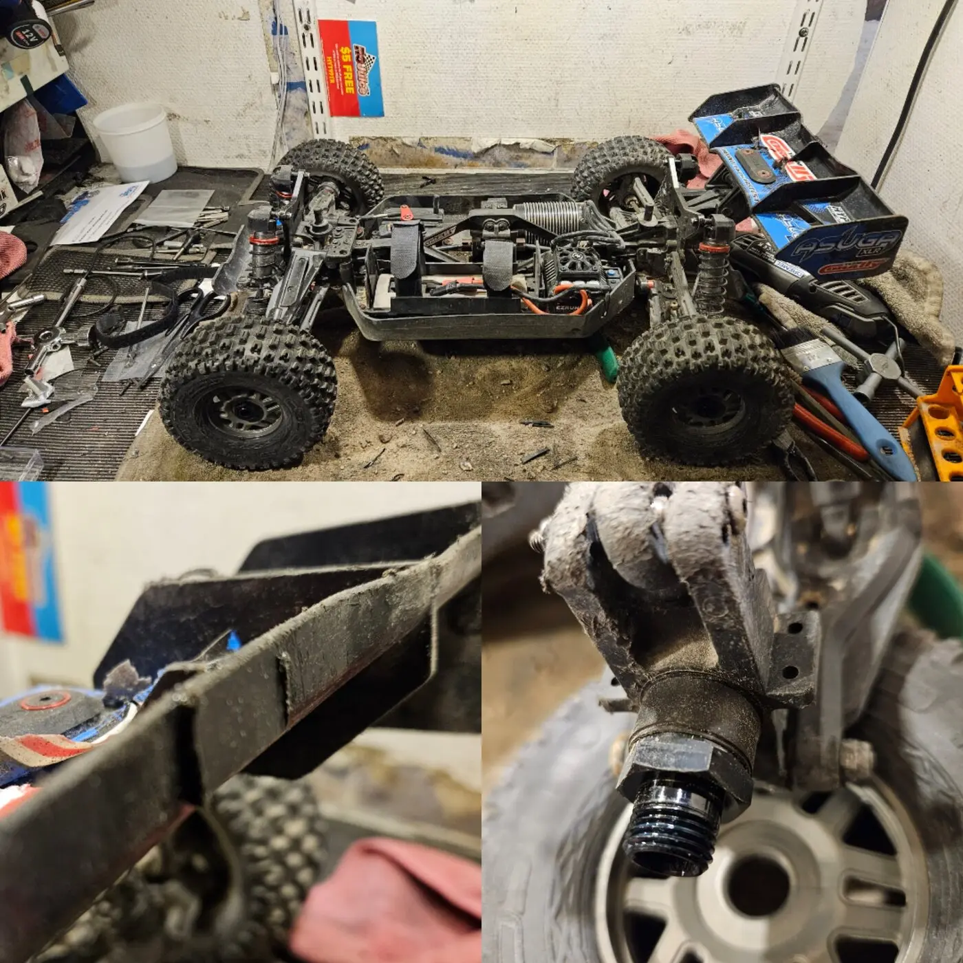

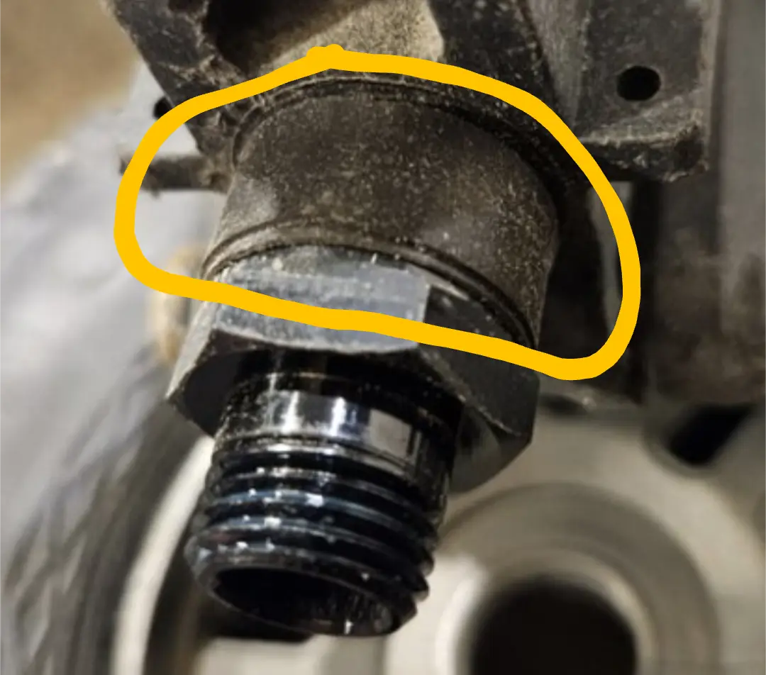

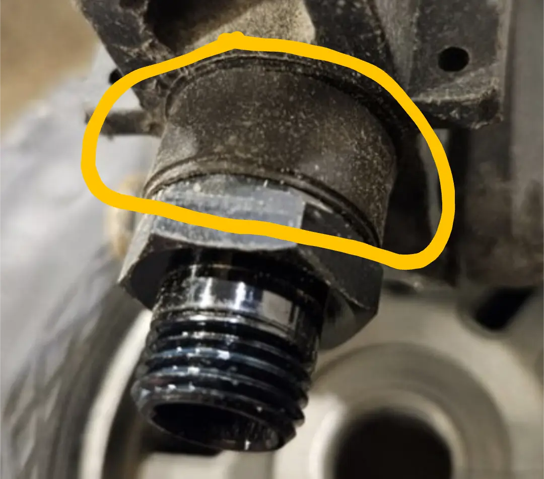

ASUGA XLR, lost hex pin, solved it with 2 layers of shrinktube, fixed a crack in the rear wing.
Can please explain how you stop the hex pin falling out? Any idiots guide please I have watched lots of videos on you tube and they wheels always seem to be falling off in them.ASUGA XLR, lost hex pin, solved it with 2 layers of shrinktube, fixed a crack in the rear wing.
I check mine after every runView attachment 4556
See above - look at the image again - this pin ain't going anywhere!!

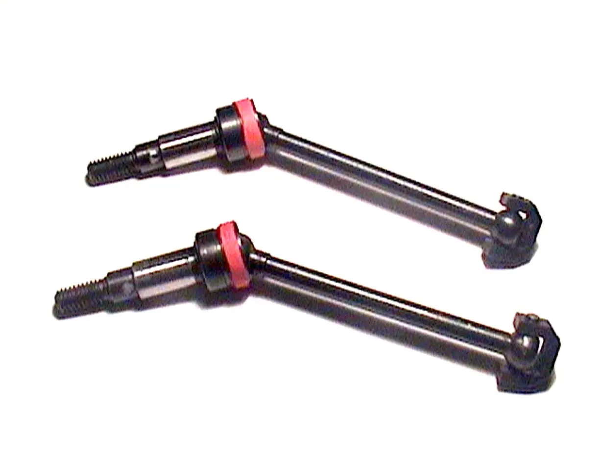

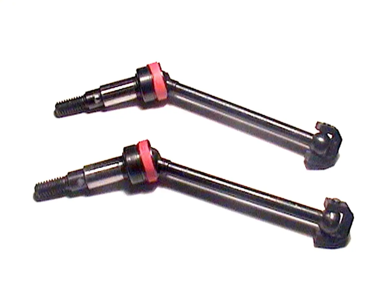

I used to do something similar for my CVD pins in 1/10th touring.
And it's high time our dog bones get blades, too.
No slop, no premature wear, no changing outdrives. Win, win and more win.
So why don't we already have them?

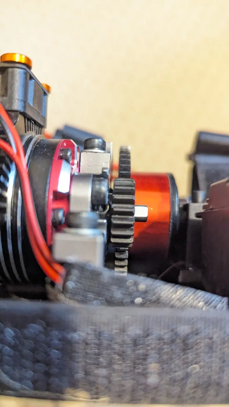

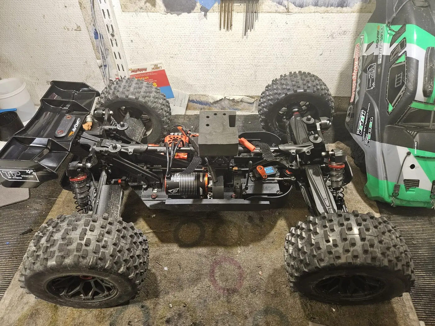

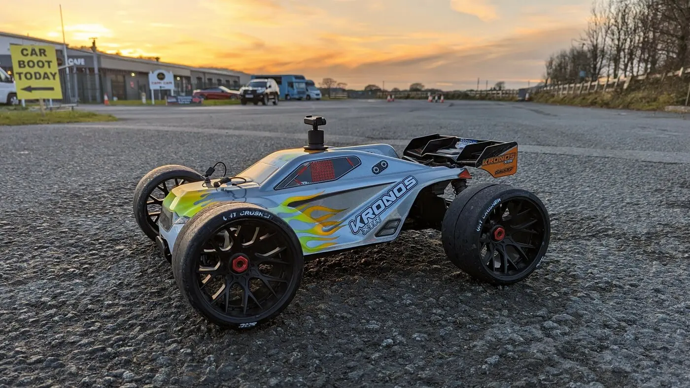

Fitted a Tekno 18t M5 5mm grub screw pinion. Time to see how fast this bad boy can go ...
Next purchase following advice here - 46t spur. Used with 4292, 1780kv, 4200watt motor, dual fans. Should be OK.Rip it!

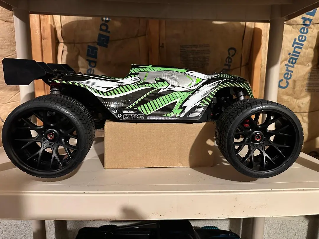

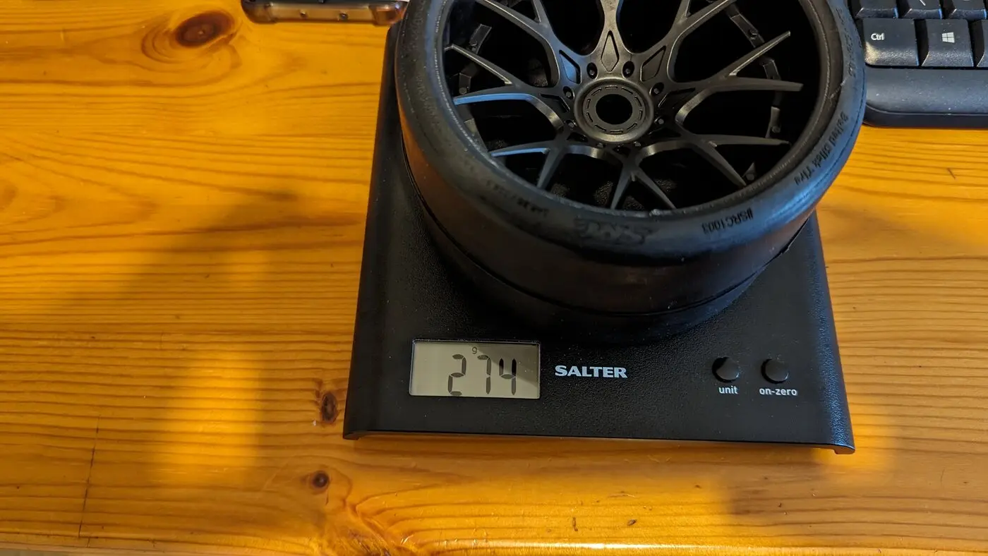

Those tires look beautiful. Belted? Looking for some street tires myself for my Asuga. Not 2 heavy.
The Sweep Crusher tyres are belted. They're not that heavy and are easy to balance due to the way they're produced.Those tires look beautiful. Belted? Looking for some street tires myself for my Asuga. Not 2 heavy.
I’ve been running the terrain crusher belted on the Kagama while testing things over at the soccer fields and I’ve been really impressed. They seem to be holding up fairly well too. I would take them to a skate park but I bet they would be pretty mean on an Asuga.Those tires look beautiful. Belted? Looking for some street tires myself for my Asuga. Not 2 heavy.
Thanks. Helps a lot.The Sweep Crusher tyres are belted. They're not that heavy and are easy to balance due to the way they're produced.

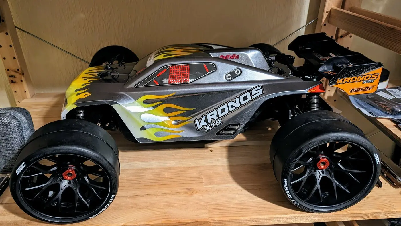

I got the slick version for my XTR and so far, they seem very good.View attachment 5243
I'll up a video soon of just how good these are. Very progressive tyres as they start to let go, even in the sub-zero temps I ran them in.
Hope this helps.![]()
