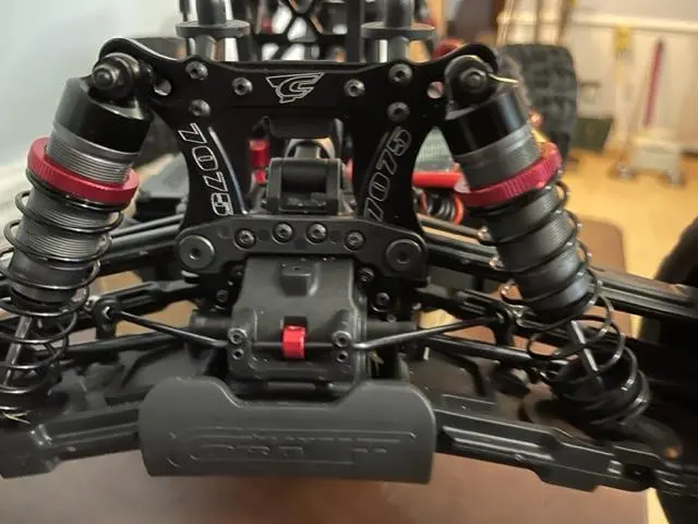

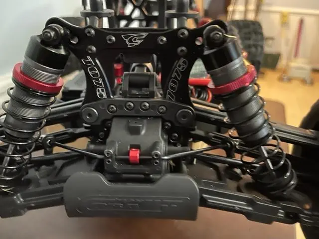

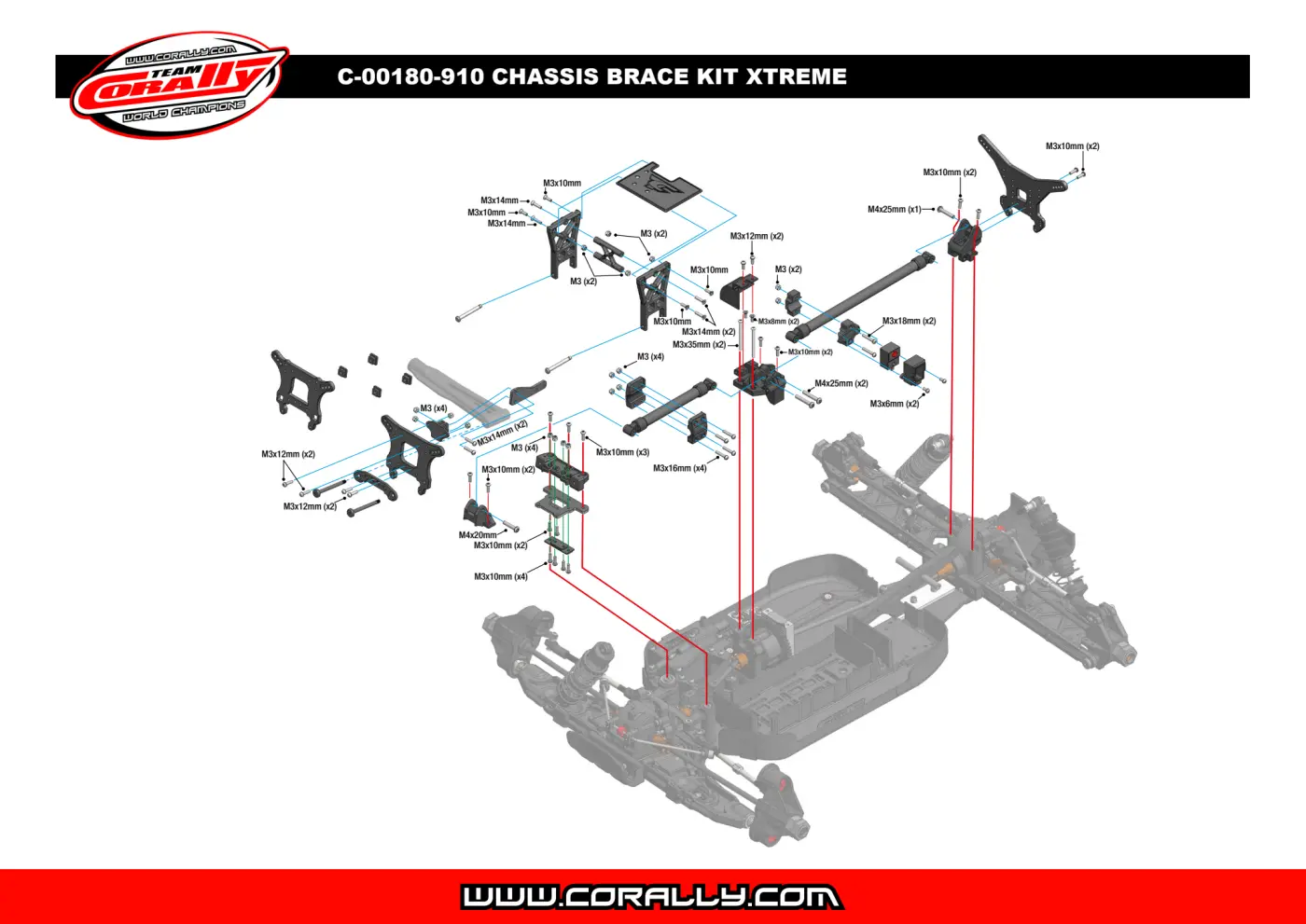

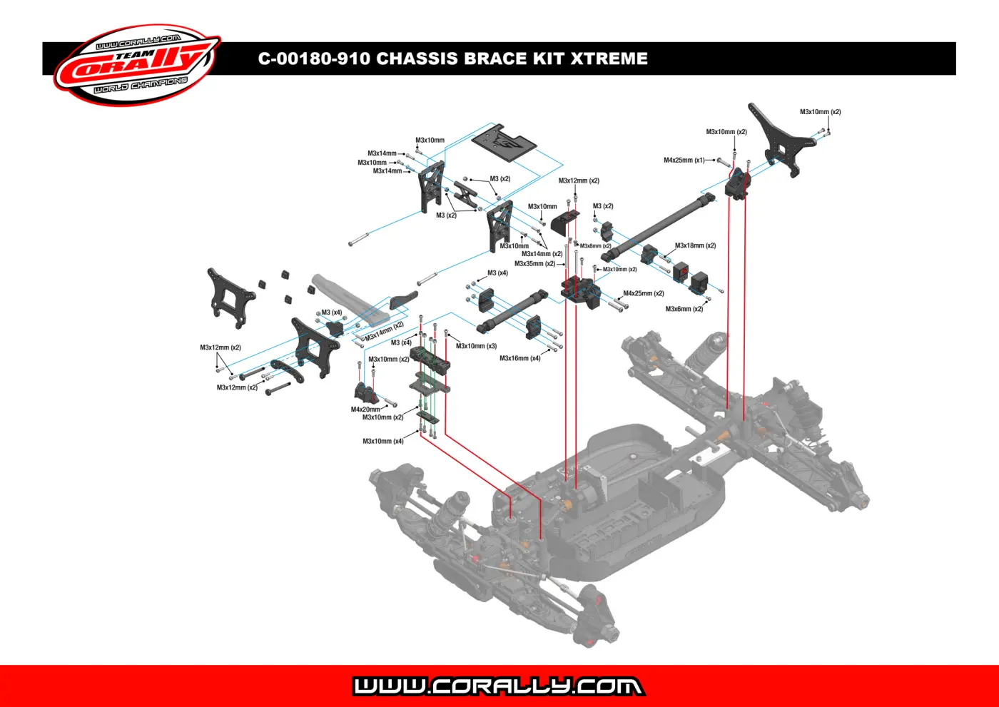

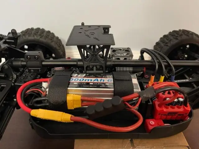

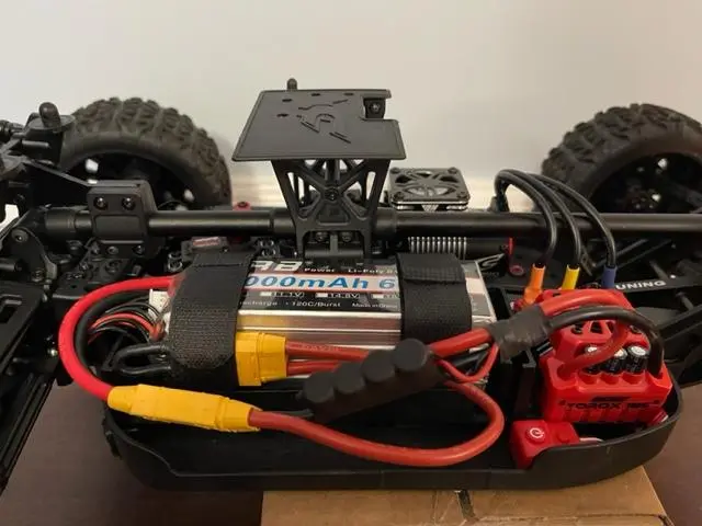

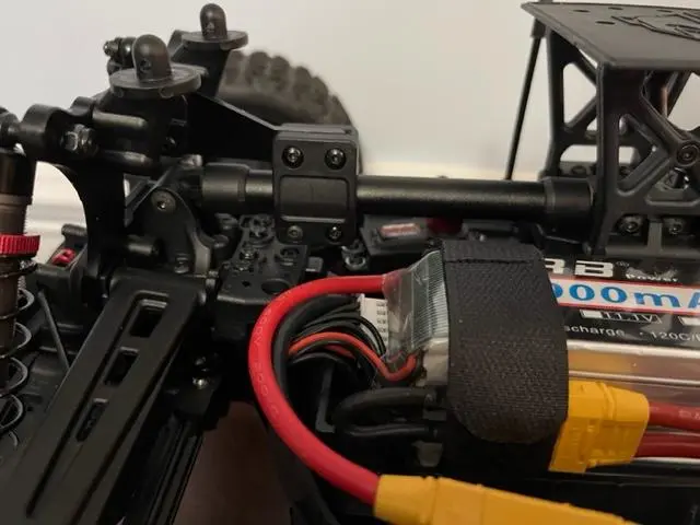

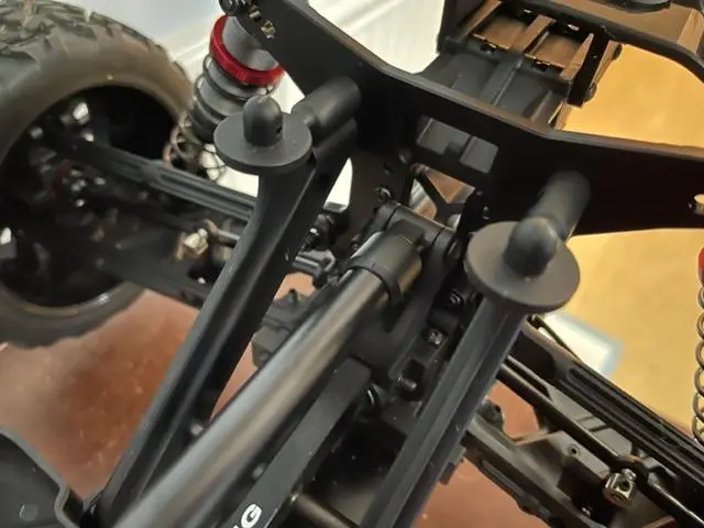

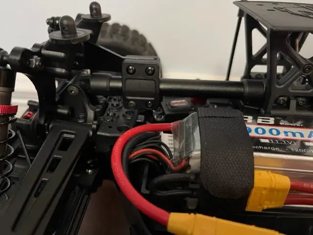

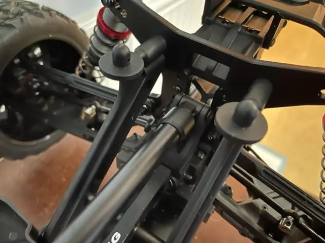

Post some pictures!I put the Xtreme Chassis Brace in my Muraco tonight. Talk about a PITA - the brace comes completely unassembled in a bag with no instructions. There were a lot of different length screws and nuts that needed to go into the right places. Fortunately, I've seen enough pictures to tell where all the major parts went, so it wasn't too bad.
An additional advantage of the brace kit is that it replaces the stock composite steering deck with the TC aluminum steering deck, and it replaces the stock hinge pins with the screw-in pins that are used in the bashing option. It's a significant improvement over the factory setup.
That would have helped if I had had that before I put it together, but I got it together on my own. I found out from personal experience and a YouTube video that some of the fastener lengths that Corally recommends are either too short to provide enough strength (i.e. 10mm long top steering deck fasteners) or are too long, which allows the ends of the fasteners to stick out beyond the end of the locking nuts. I'm talking about a couple of millimeters in both cases. I replaced the ones that came with the kit with what I felt were the correctly sized fasteners from my collection of fasteners.
