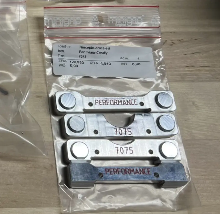

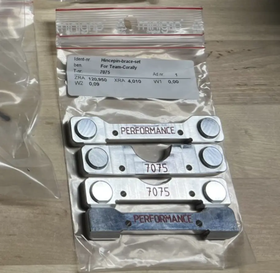

I wonder would these fit the XTR?
How do you buy parts from this guy? Where is he based?
He can be found on FB. You contact him direct and he will promptly respond.
Erik van Ravenstein
Pretty sure they will. According to RC Hobby explosion and Jenny's rc, the Sketer and XTR share the same part numbers for the plates.
Also worth noting, they could be used as upgrades to any of TC's 6s rigs. The part numbers for the rtr kronos plates cross to all 6s rtr's. The Sketer and XTR use same plates, just a tad thicker. The pins "may" be different, I didn't go that far into it..but I bet they're the same.

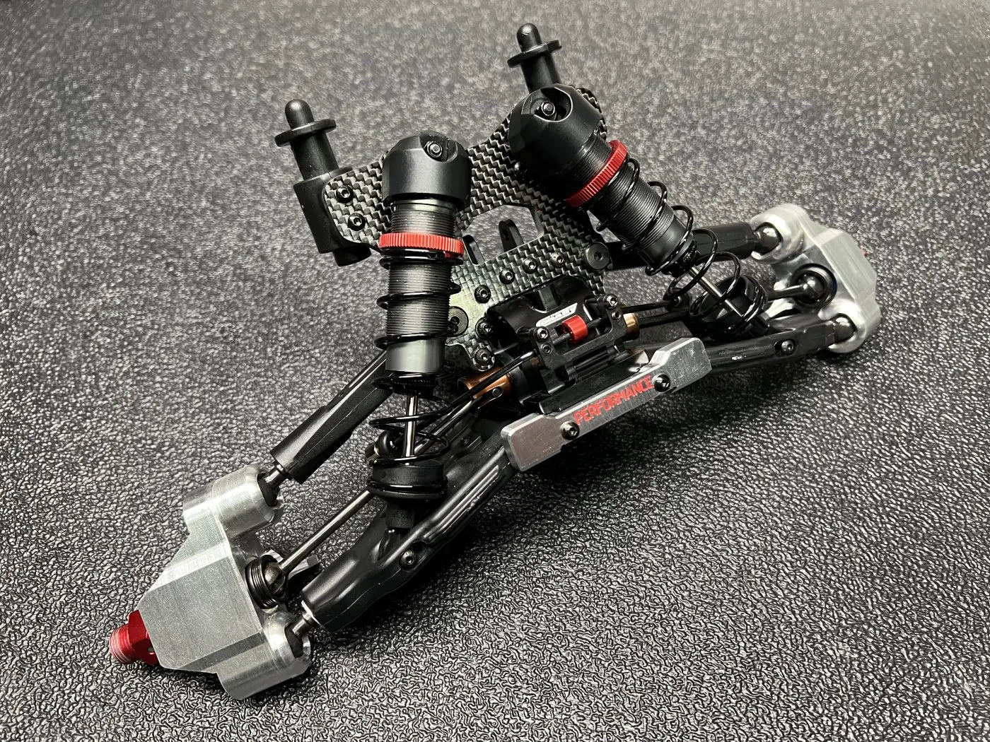

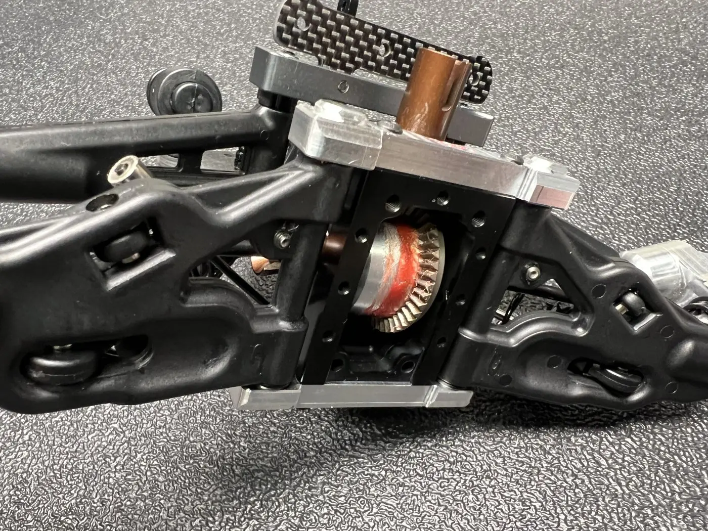

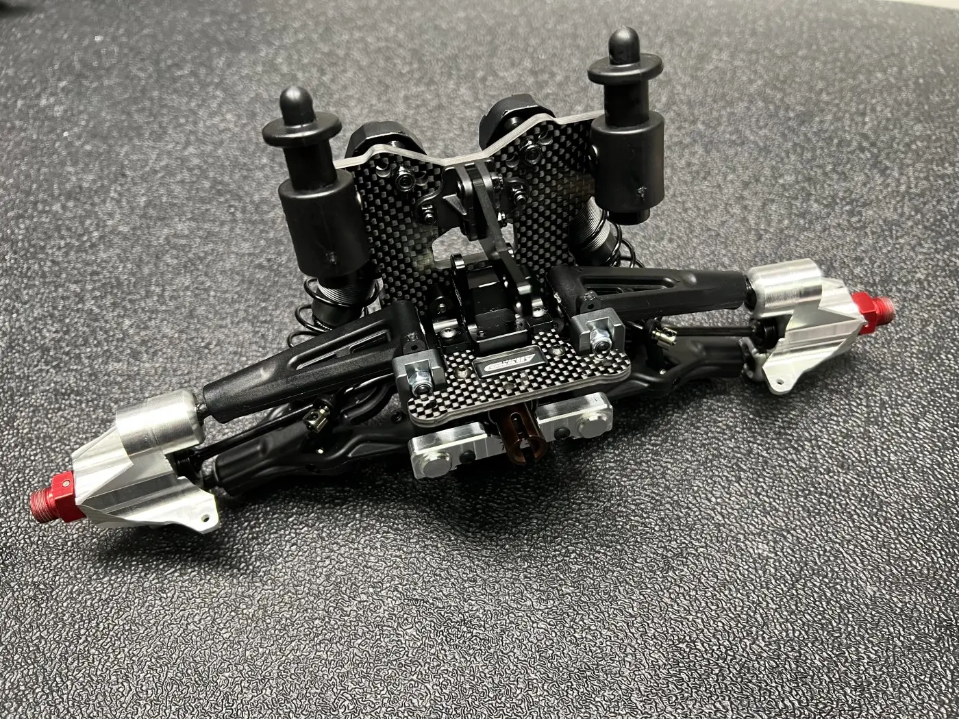

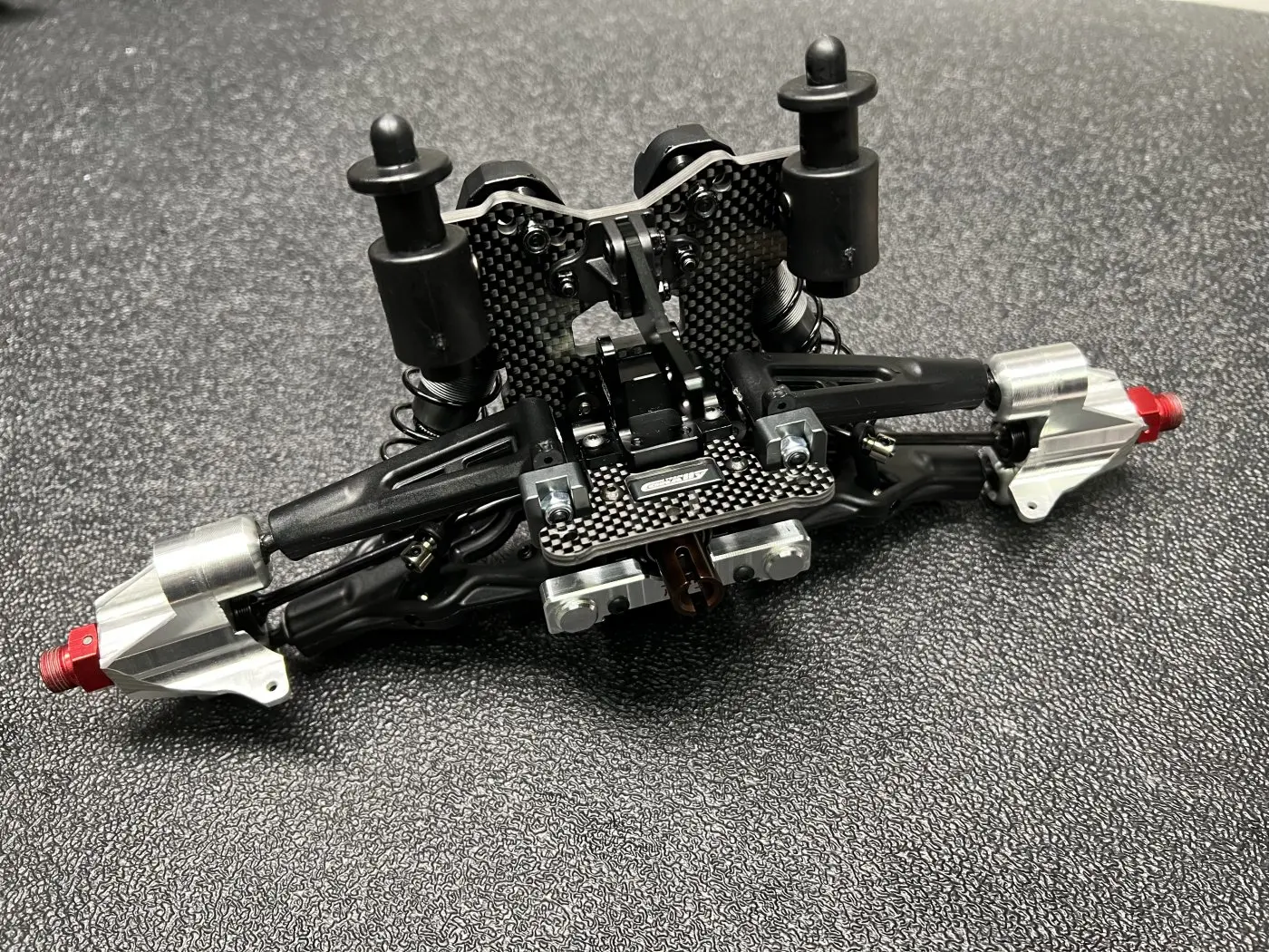

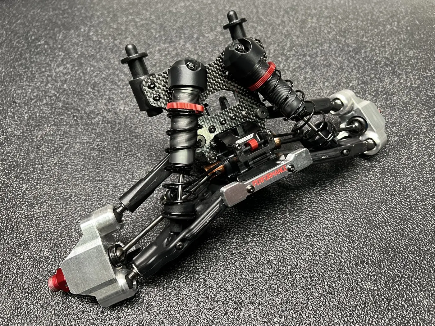

Wide Mod and changed shock oil to 55wt (725cst). Done with the Front.
View attachment 3731View attachment 3732View attachment 3733View attachment 3734

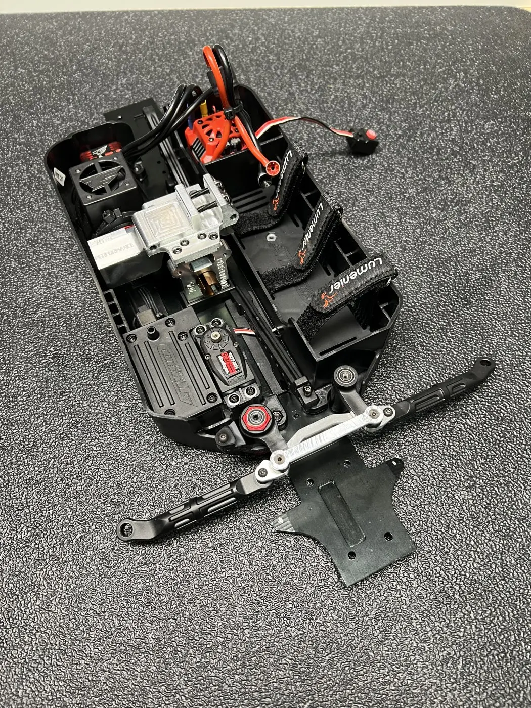

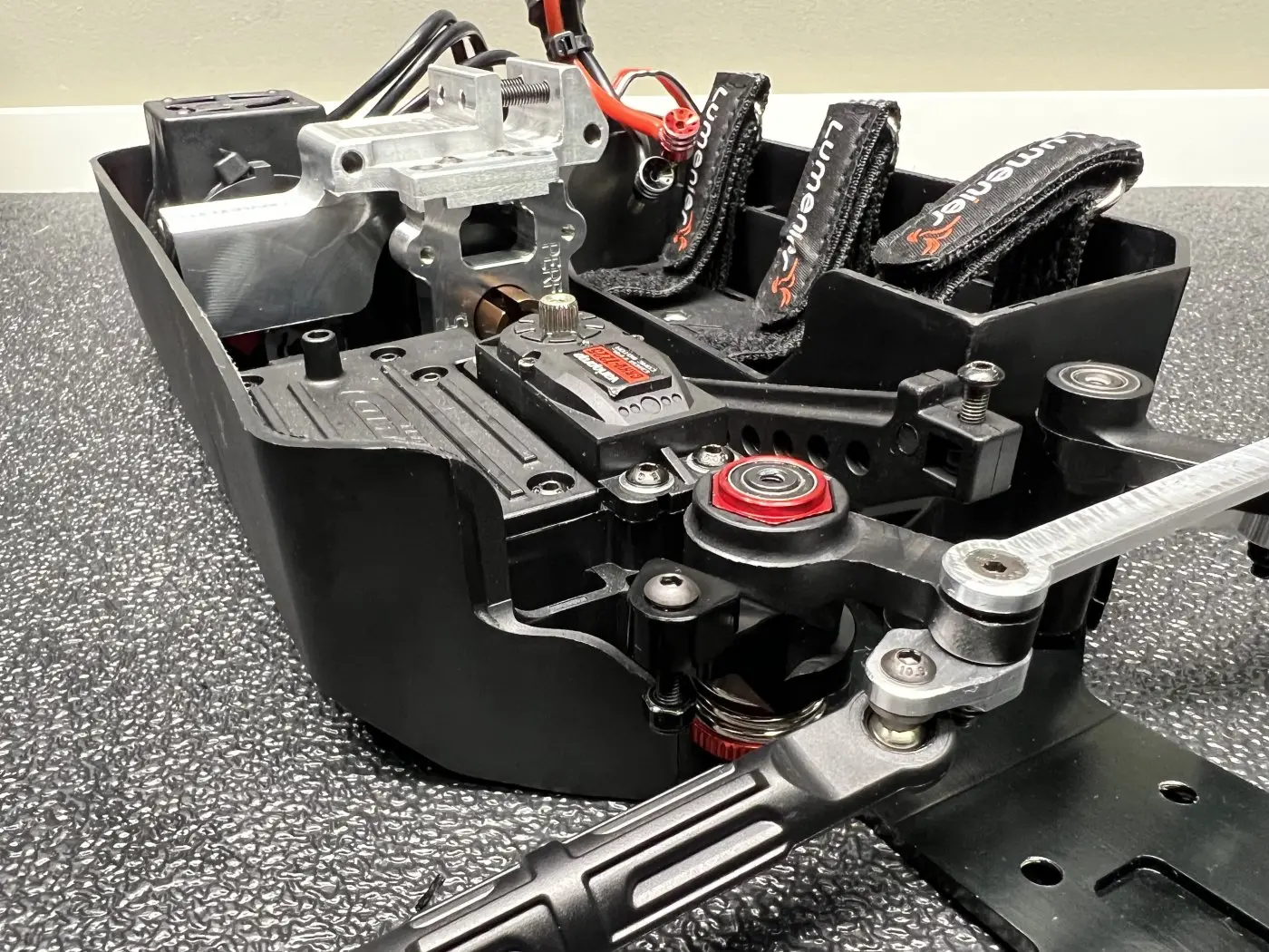

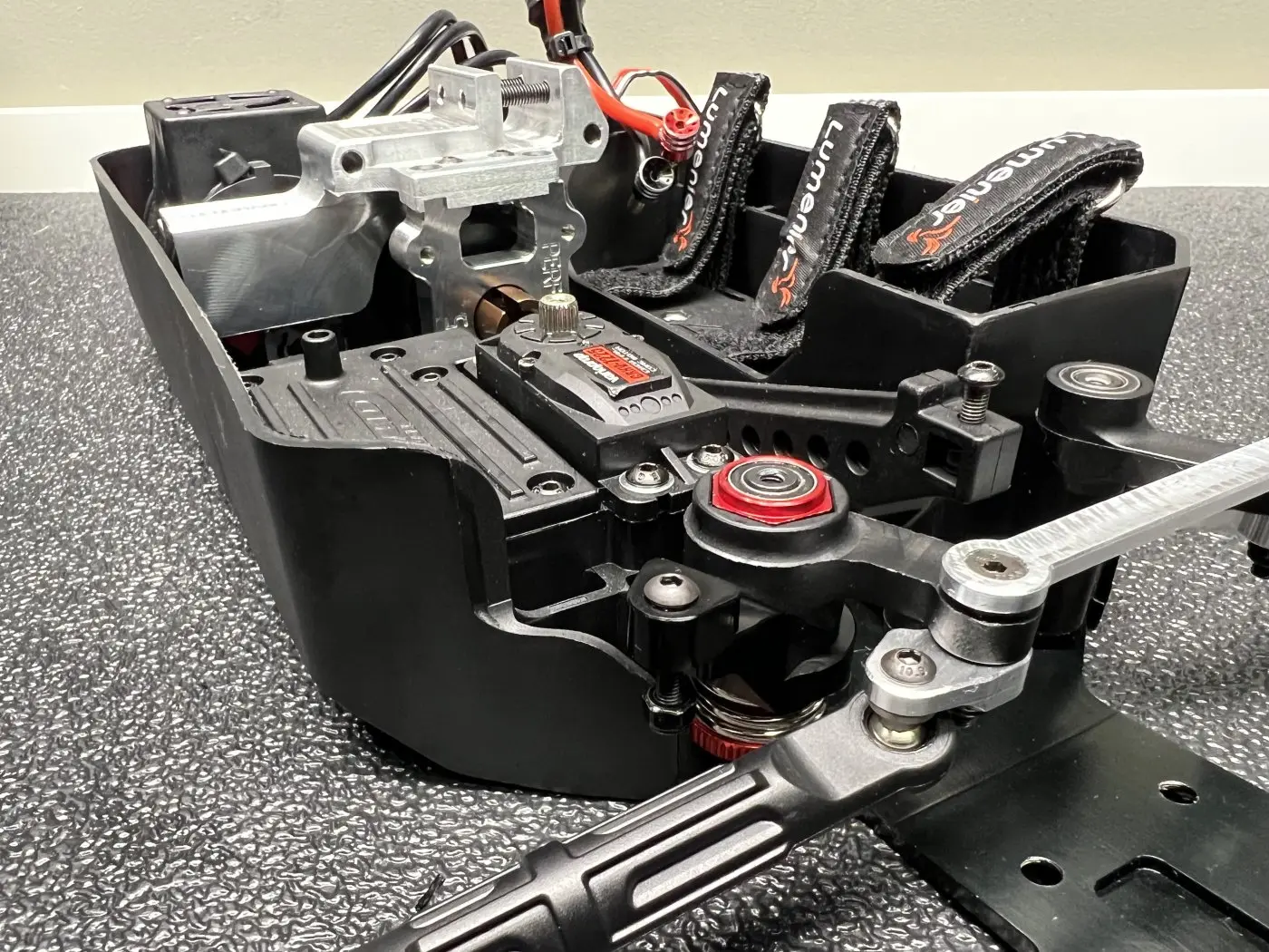

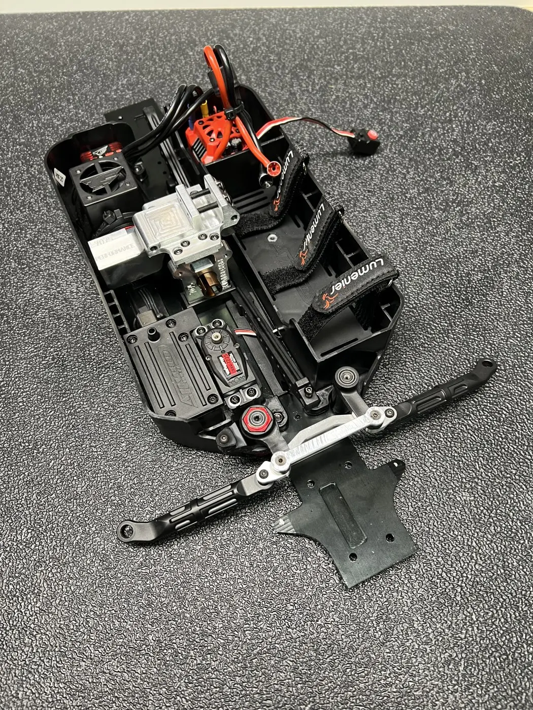

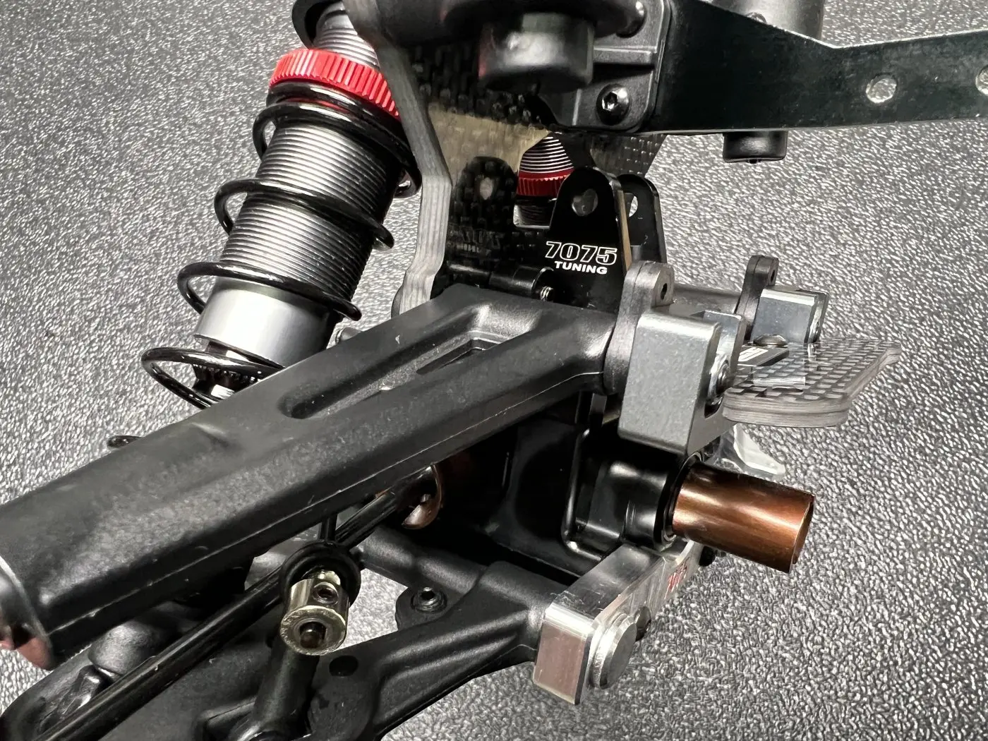

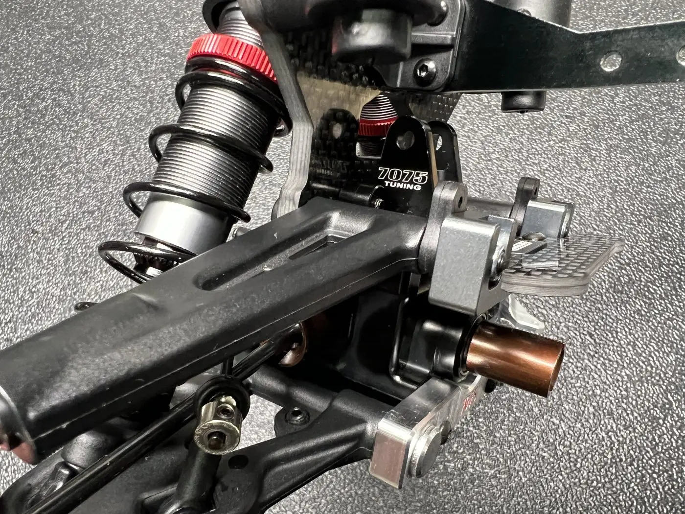

Rebuilt servo saver with aluminum arm and added 7075 steering components as well as heavy duty steering arms.

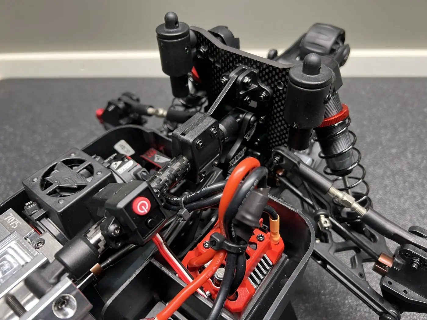

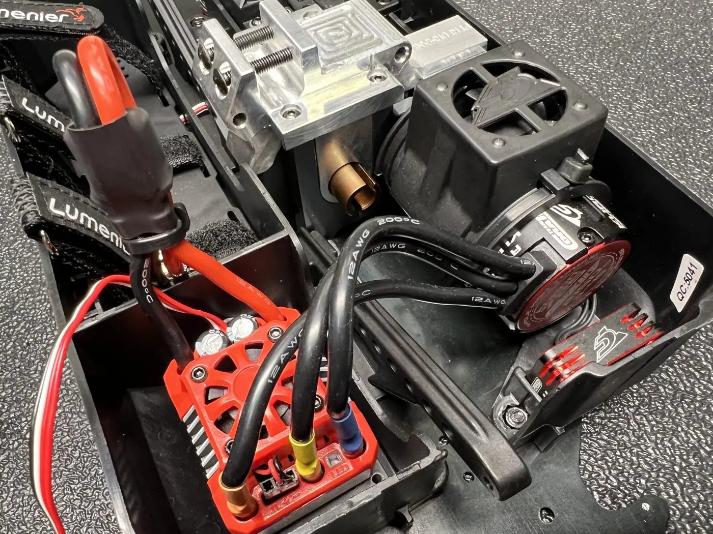

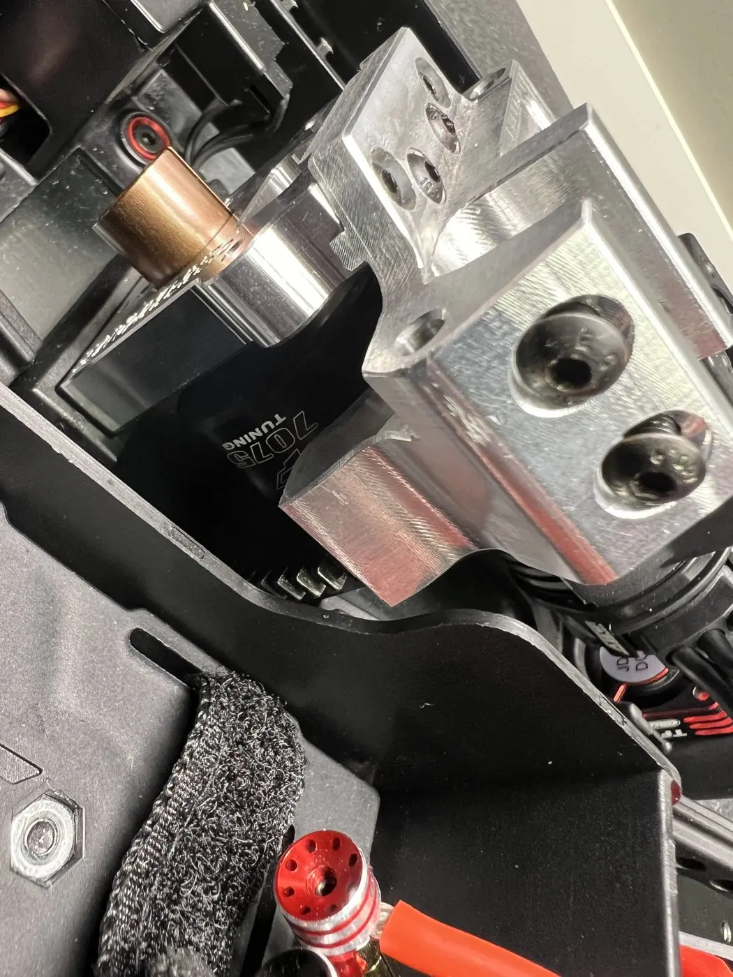

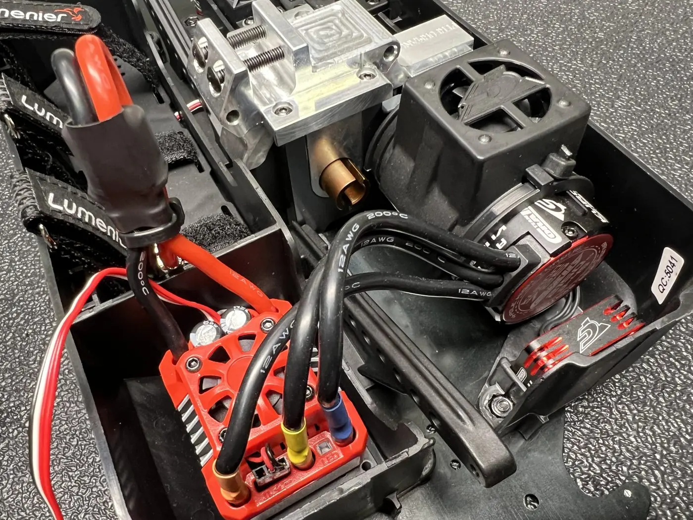

Finished with center section.
View attachment 3736View attachment 3737View attachment 3738View attachment 3739
That's rc porn right there!!😉👍 B-E-A-U-T-I-F-U-L🍻

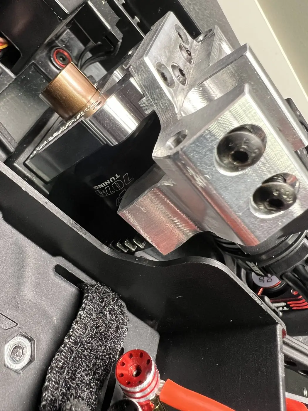

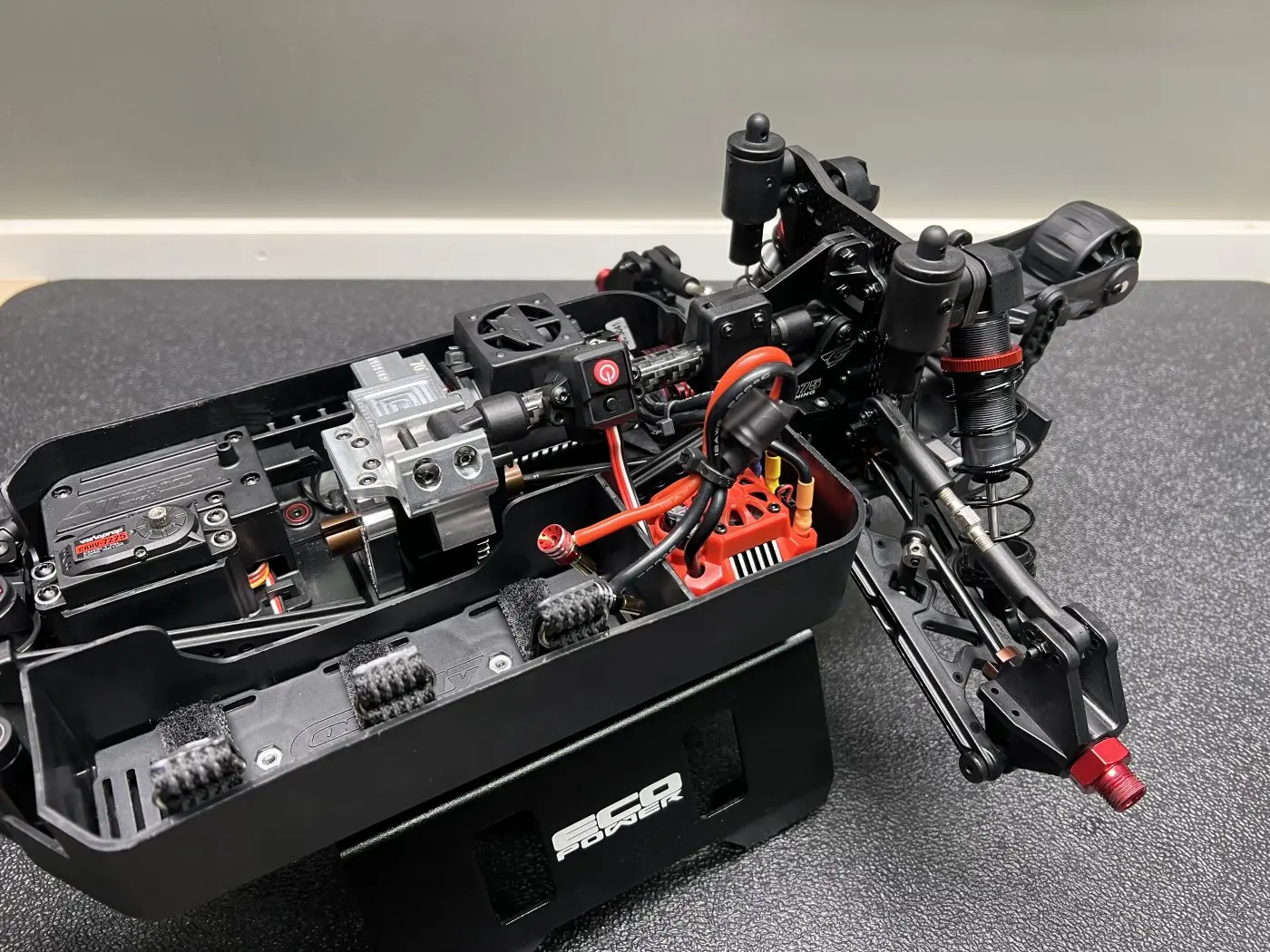

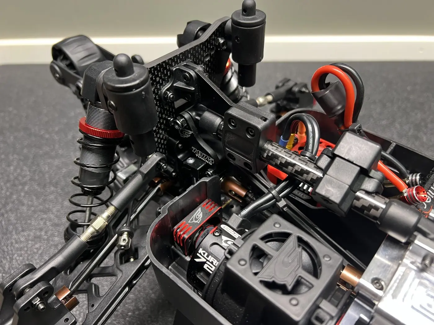

One thing I can't help but wonder.. how's the fan at the rear of the motor going to move any air if it's butted up tight to the chassis gaurd? I would just take it right out and save it for later, after the other one above the motor takes a dump.. they all do. Just how it goes with these things.
Looks awsum tho!!👌
Looks awsum tho!!👌
Thanks bud. As for the fan in the rear, it has a small center void behind the fan that allows air to circulate. Surprisingly, it flows pretty decent. I stayed with the recommended 15t per the manual and with both fans the motor should stay fairly cool.
Had it to but got rid of it. 2 fans on the motor is much better 😉

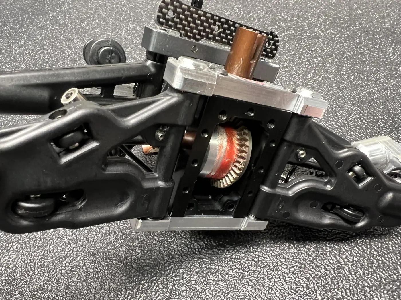

Finished mounting the rearend to the chassis and all the associated parts that go along with it, including Tekno drop screws.
