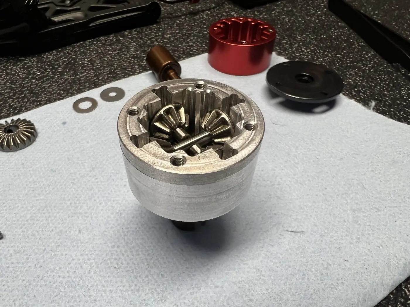

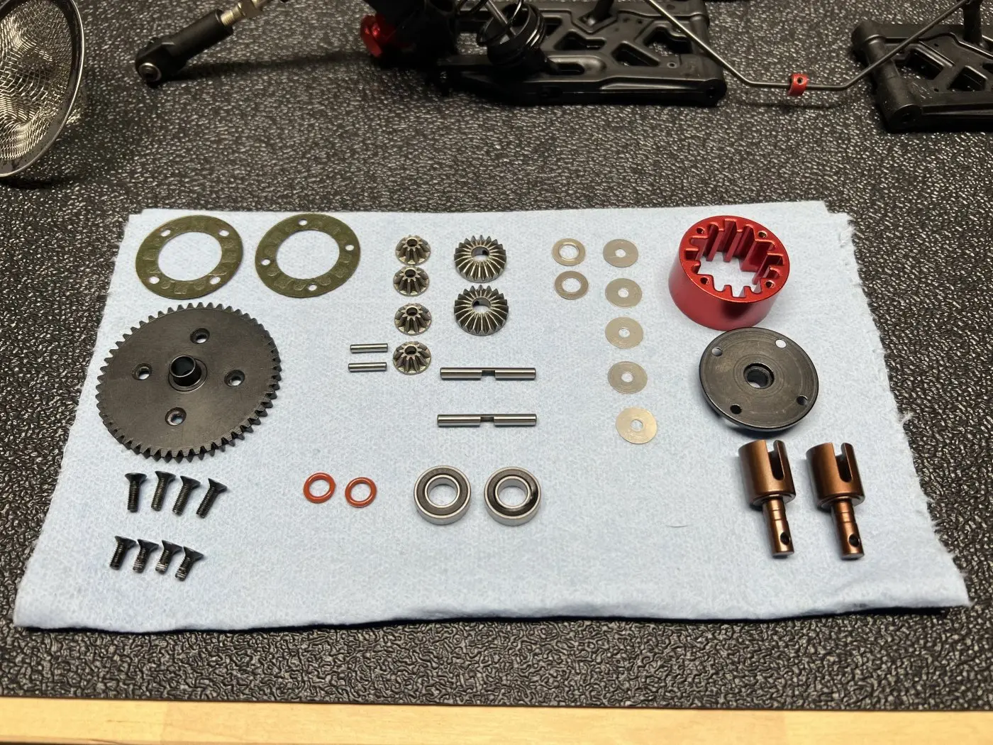

Thanks for the reply. It seems yourself along with everyone else leaves the rear housing thin/stock.I use 40/300/20 on both my Radix and my Muraco. I don't jump my RC vehicles much: I do a lot of fast driving on dirt and grass, and this combination of diff fluid seems to work for me.
From what I have read, most everyone who has tried various weights of diff fluids usually winds up with the front being twice as thick as the rear. I do that on most all my vehicles, and it works out great for me.Thanks for the reply. It seems yourself along with everyone else leaves the rear housing thin/stock.
