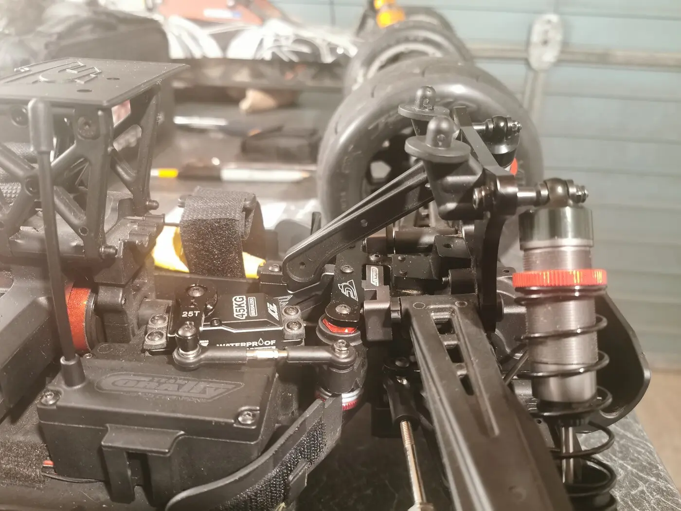

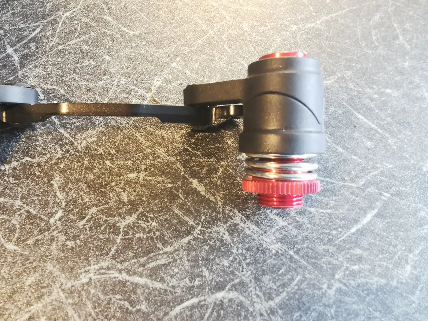

So, all done, fitted - pretty much what Dani said, but I have a couple of points I'd like to add.

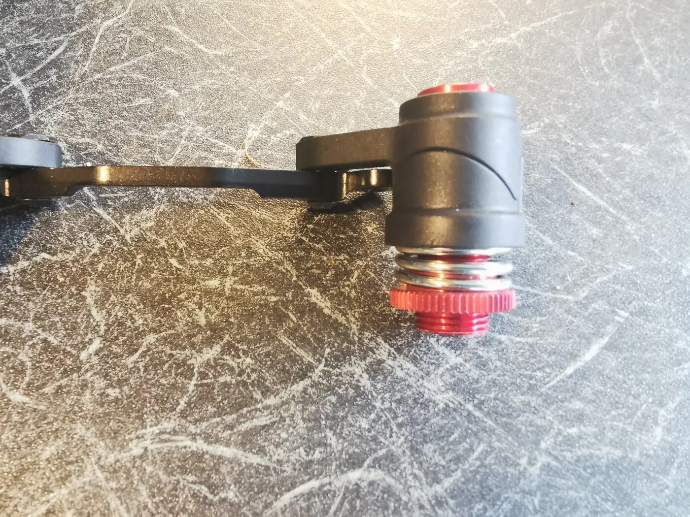

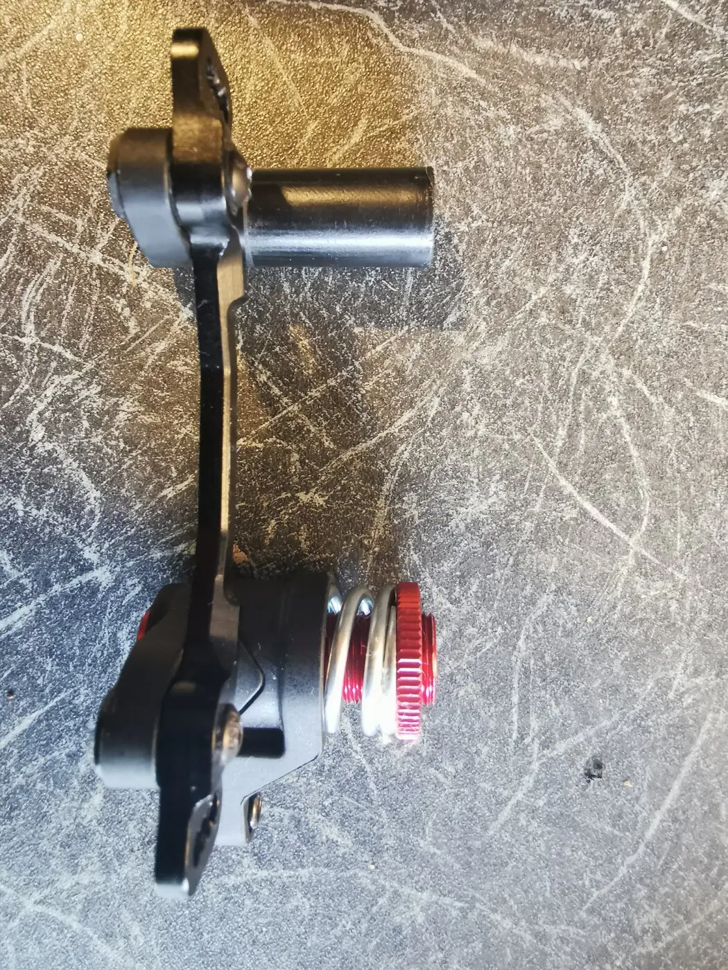

Here's what the stock item looked like, clamped up -

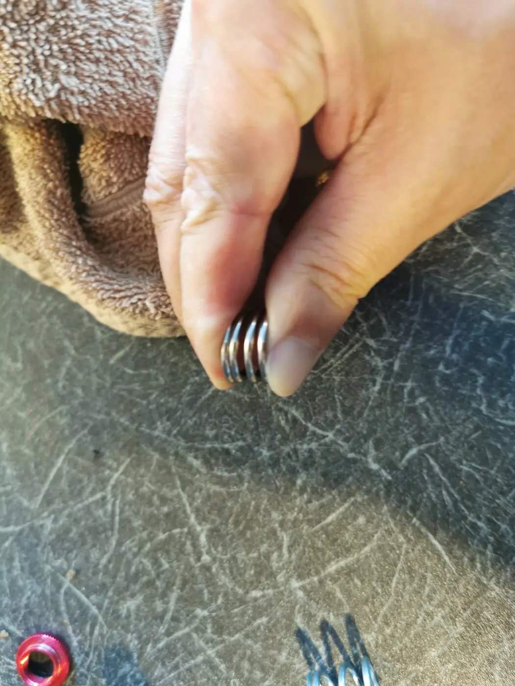

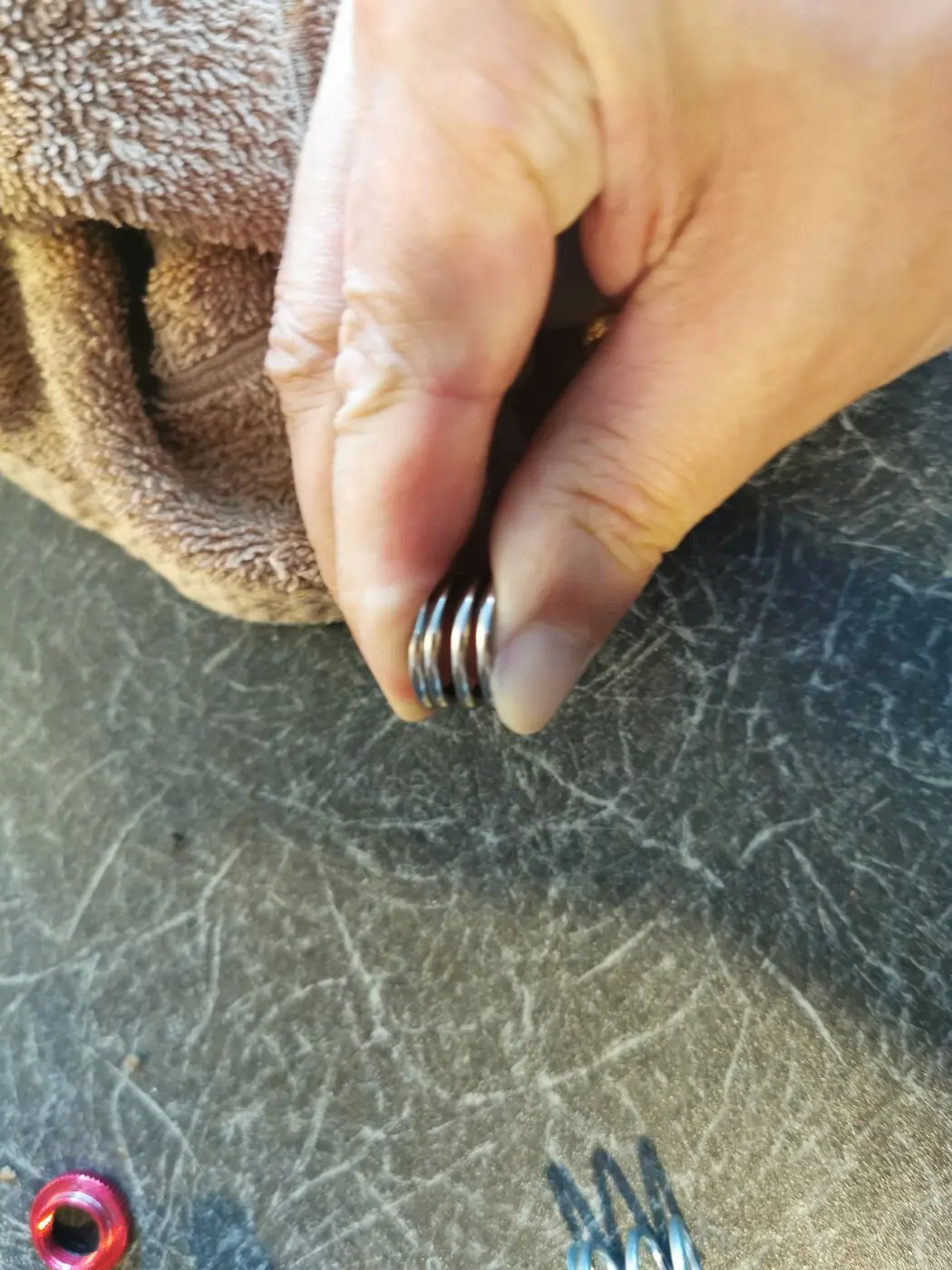

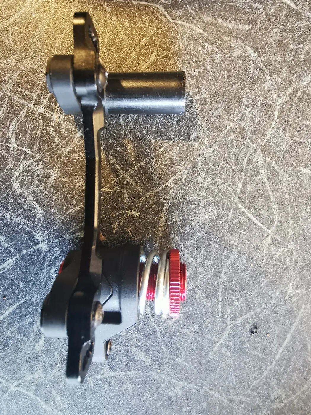

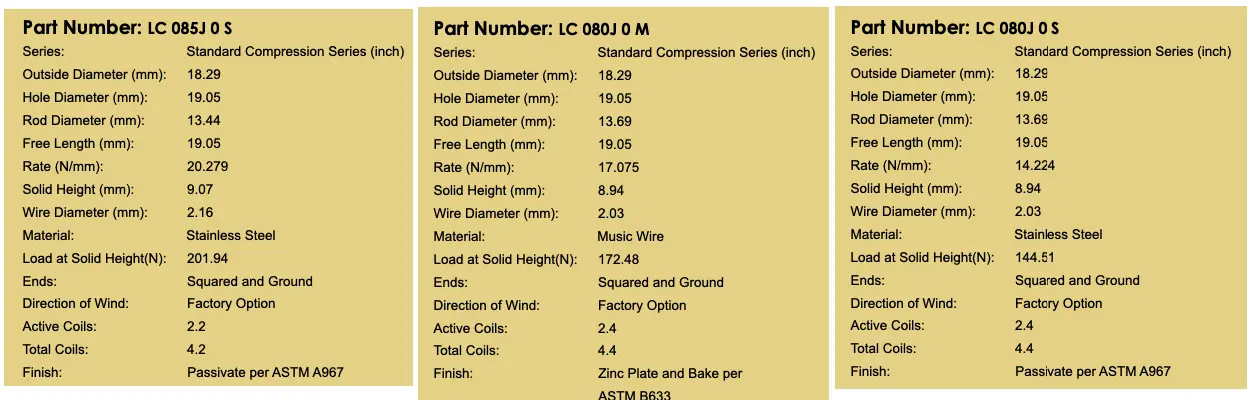

The new springs are slightly bigger than stock, both in length and diameter. In my bag of 10, there is some degree of tolerance. At the bigger end of this spectrum, the spring is a firm interference fit - meaning it will need prying into the plastic servo saver arm with small screwdriver - but it will fit with effort.
Stock spring can be fully compressed between finger and thumb! Good luck trying that with the upgraded spring - it ain't happening!
Collar compresses the spring slightly before it meets the threads - this isn't a problem, but care is required to:
A) ensure that the collar is square to the thread
B) provide adequate force to act against the spring until at least the first 2-3 threads have got a purchase.
Failure to do this will likely result in stripping out the threads on collar and/or the post.

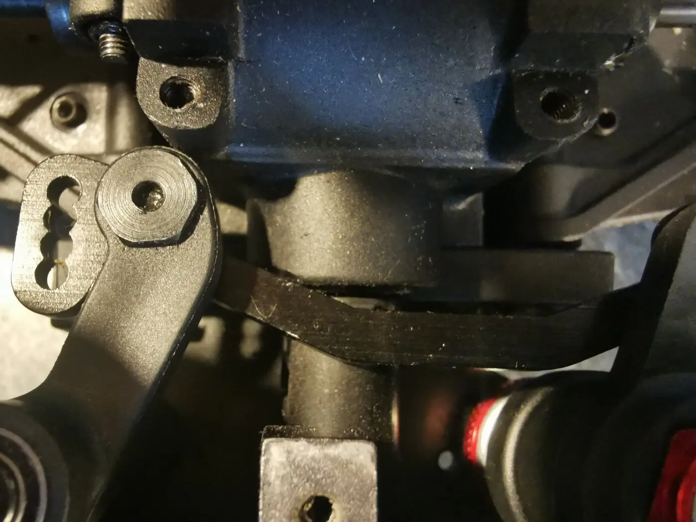

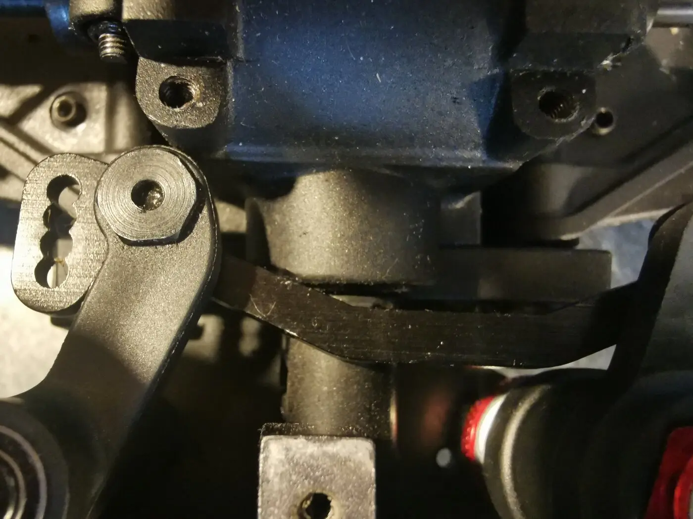

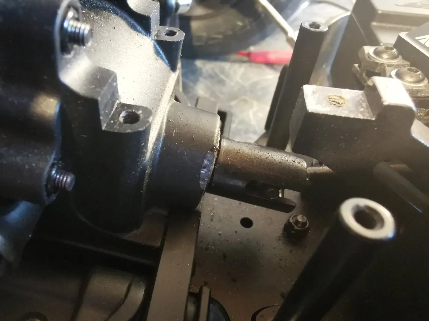

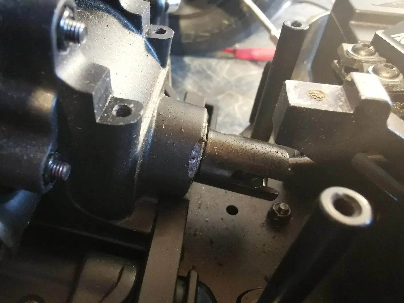

Whilst I had the servo saver out of the car, I fettled the edge of the front gearbox where the input shaft bearing carrier is. This provides a better clearance for the ackerman plate which interferes at full left lock. This is more relevant now that the car is able to attain full lock with the improved action!
You can clearly see in this shot where the steering assembly interferes with the front gearbox.
With the fettling done and the braces back in place, the steering was super free but with zero slop.
