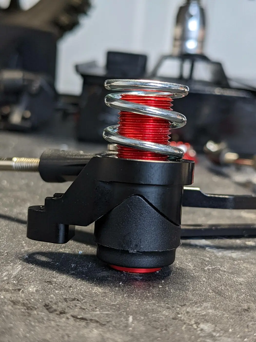

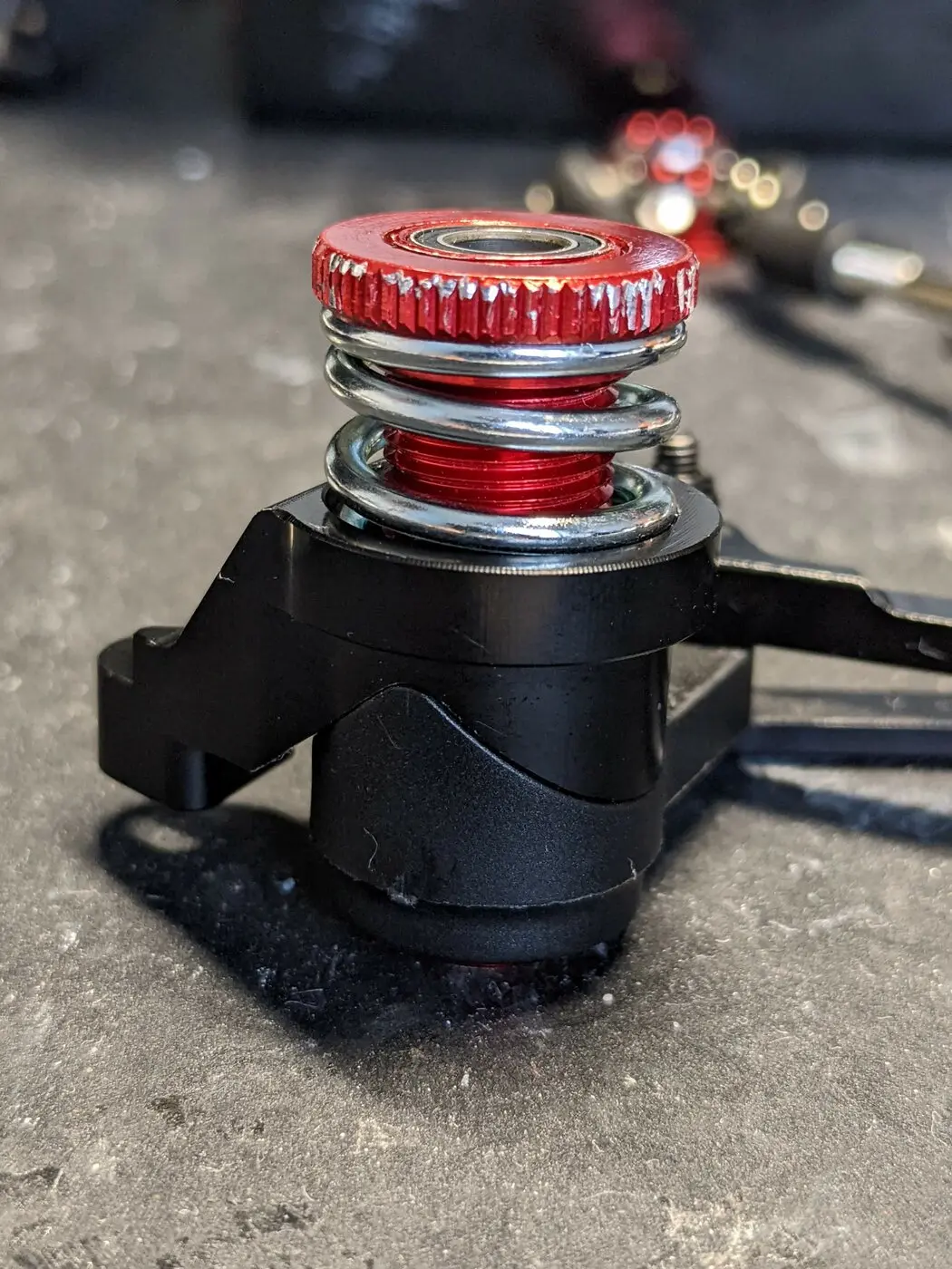

Guys, the new spring is an absolute success! At least from an installation point of view, I haven't driven it yet but I'm certain it'll be much better than the stock one just by how it feels.

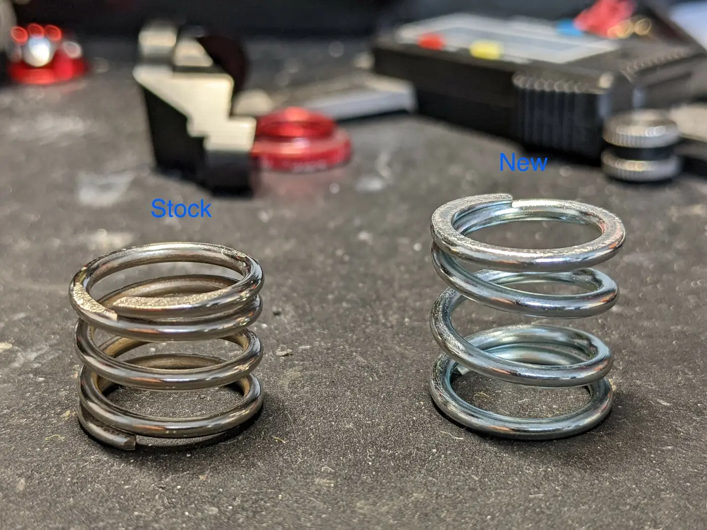

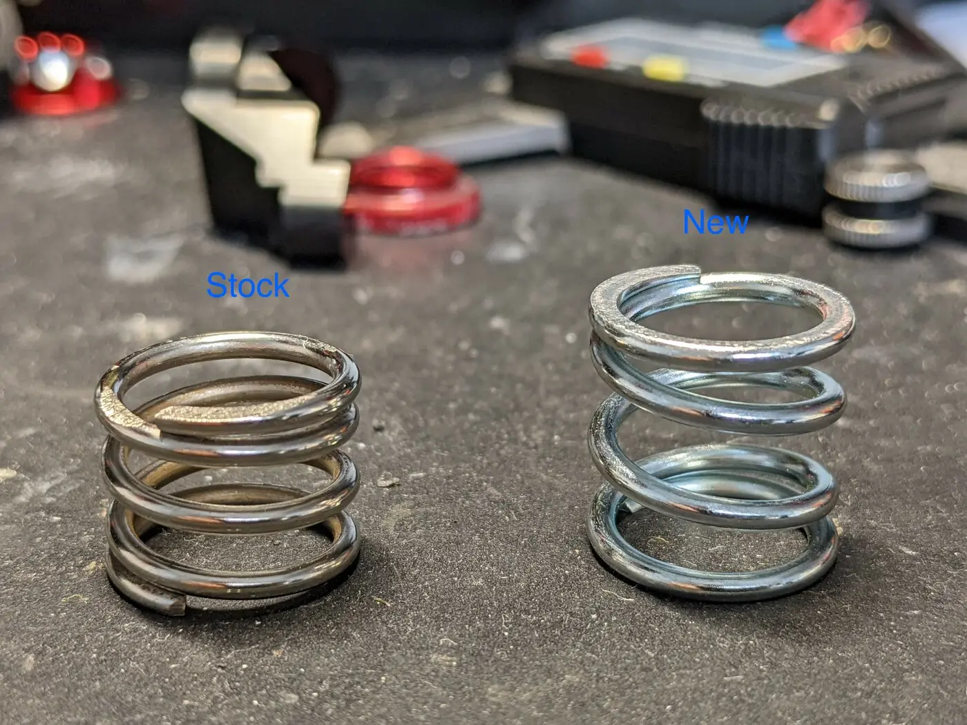

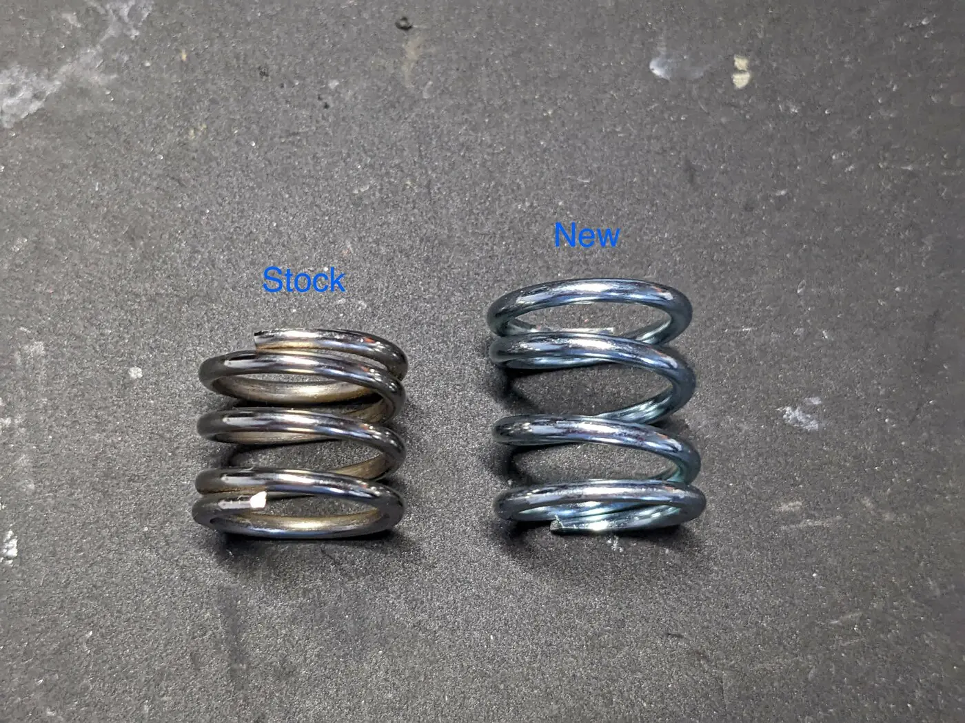

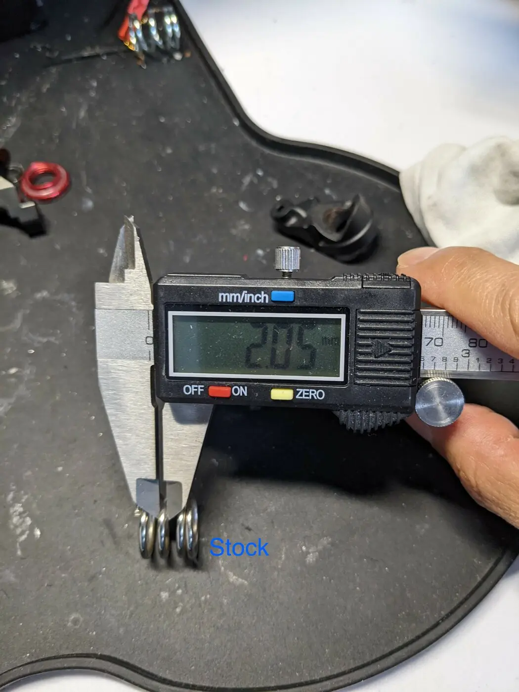

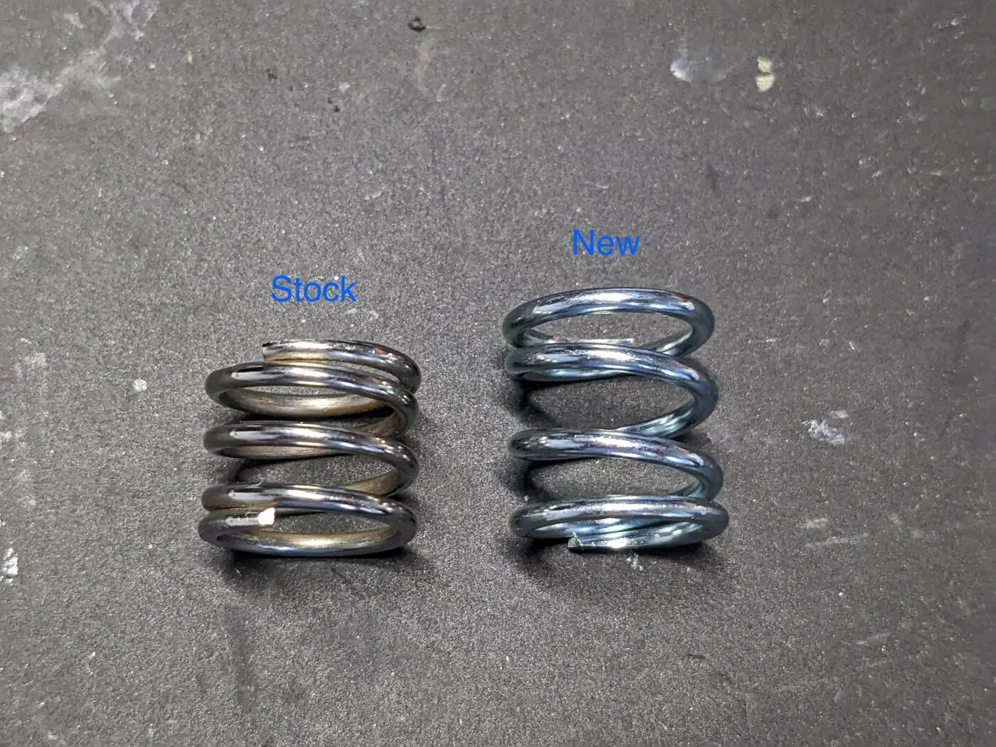

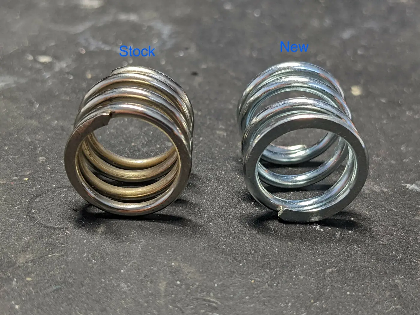

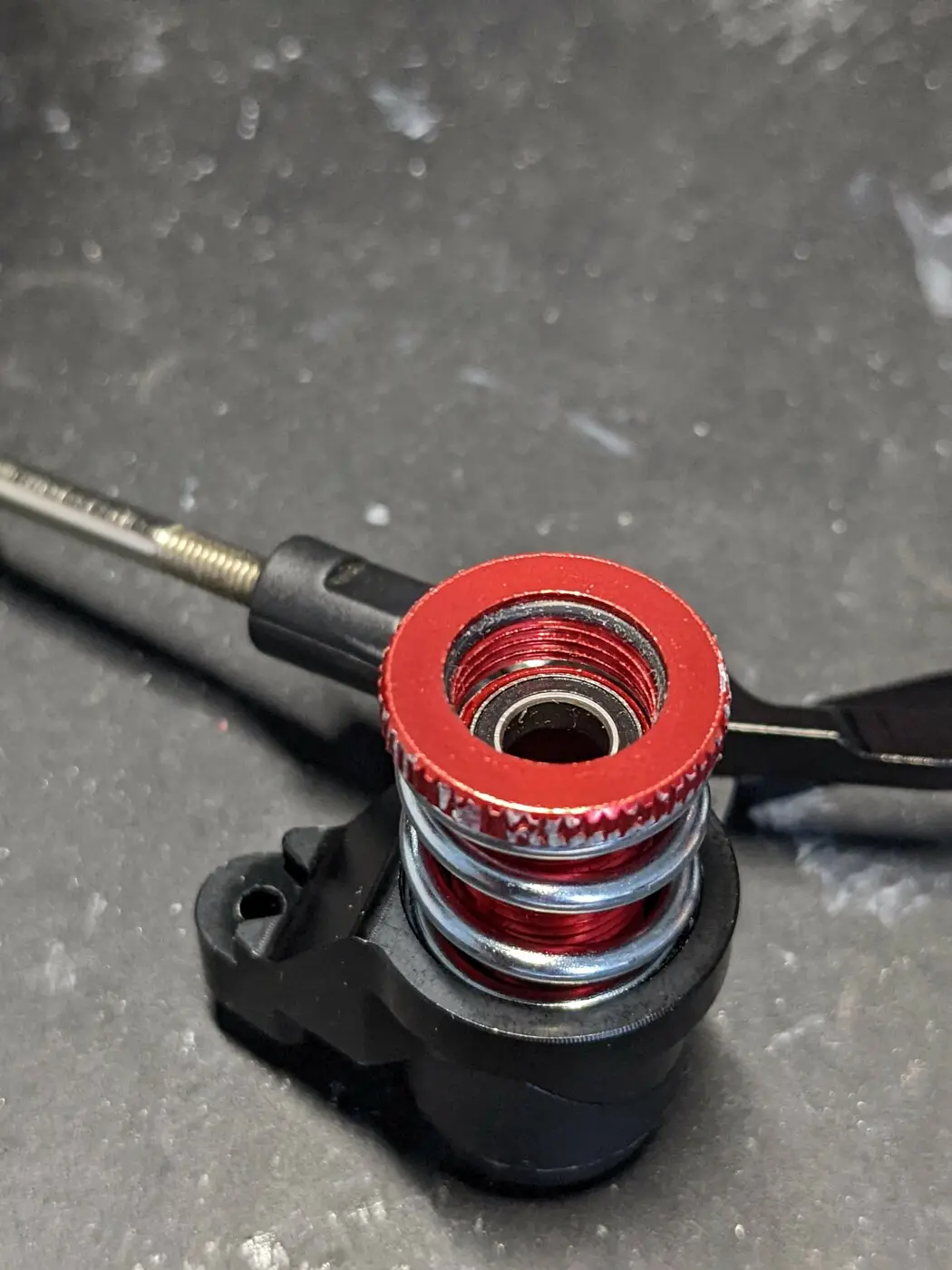

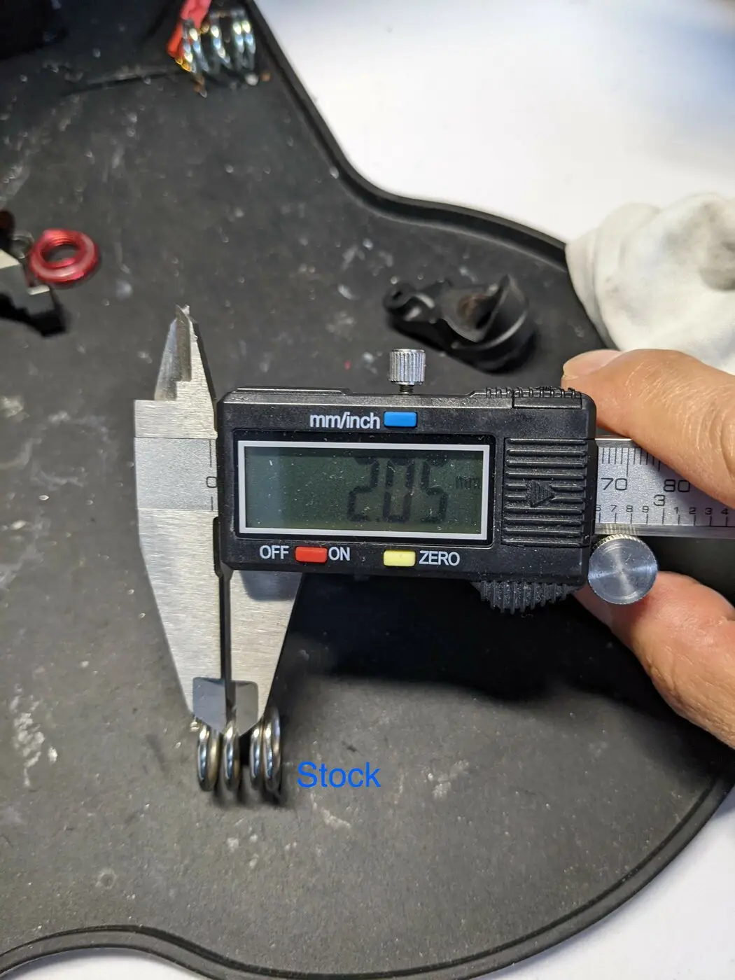

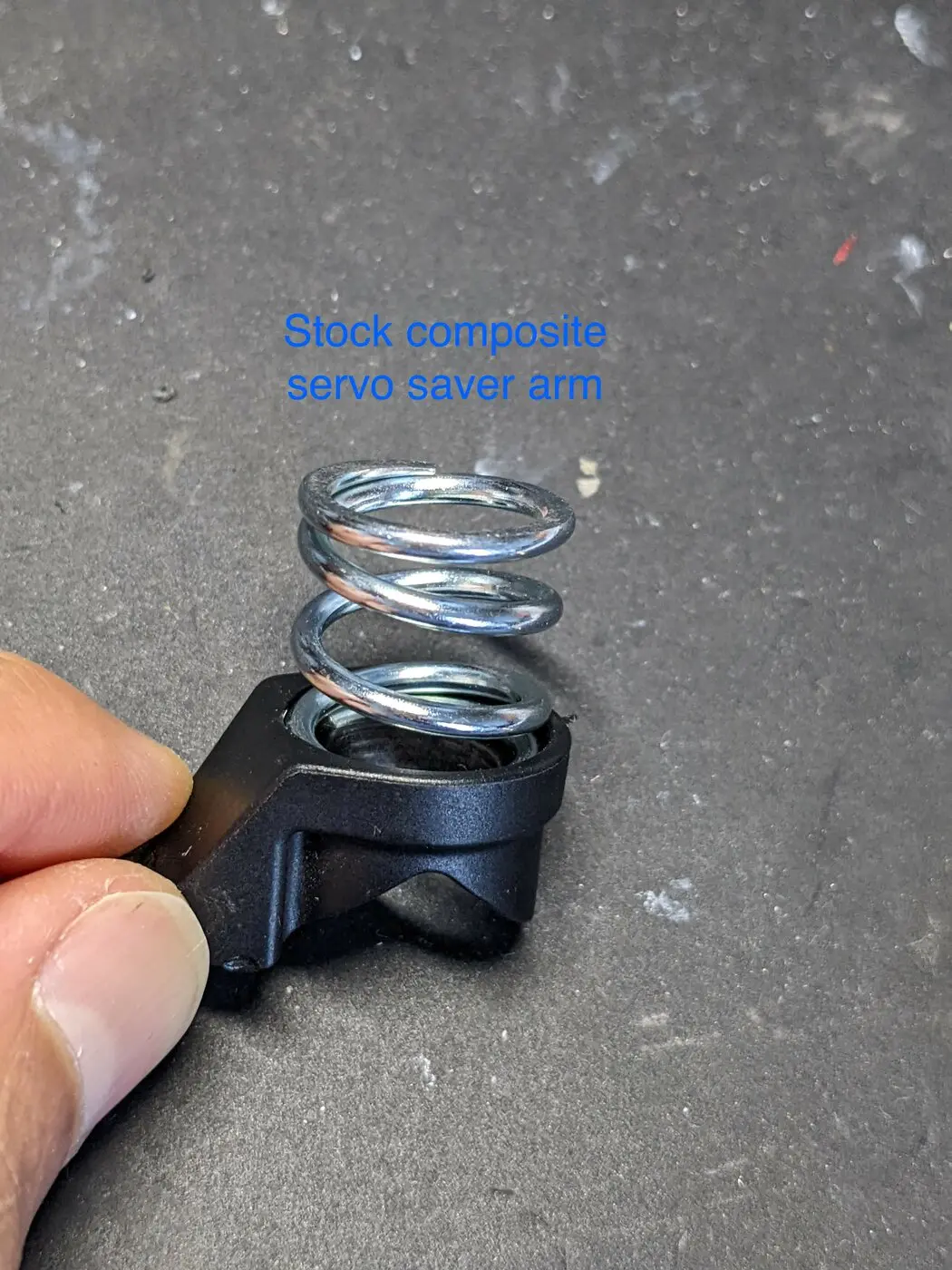

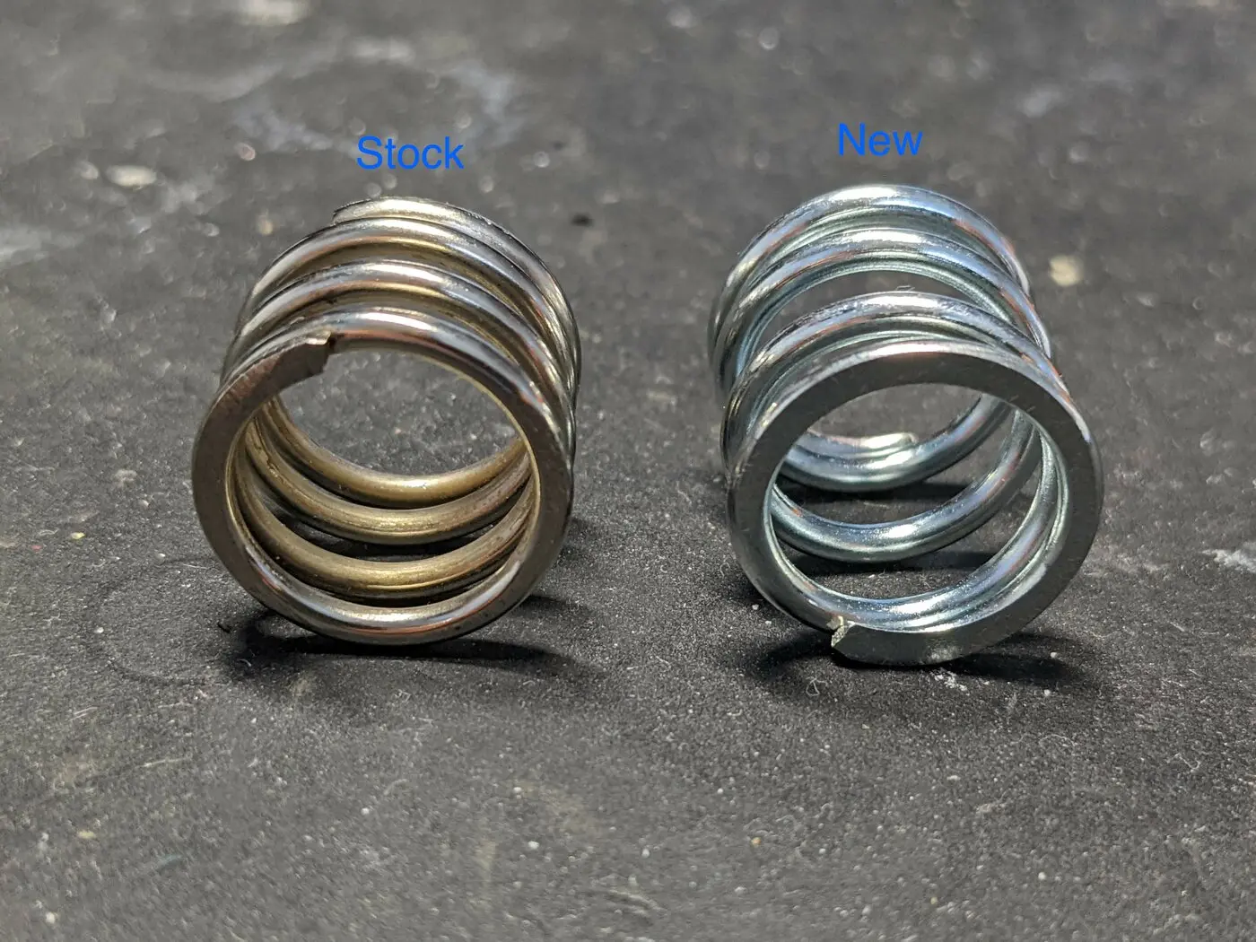

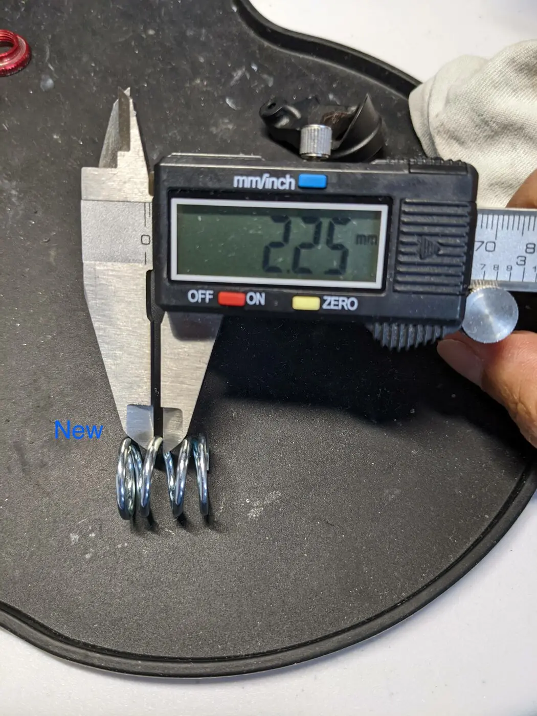

Here's a few photos of the two springs side by side.

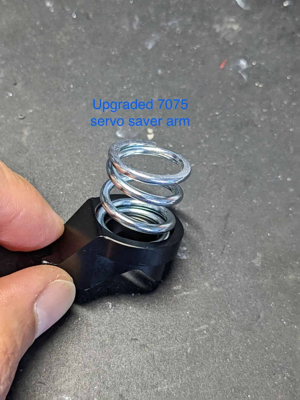

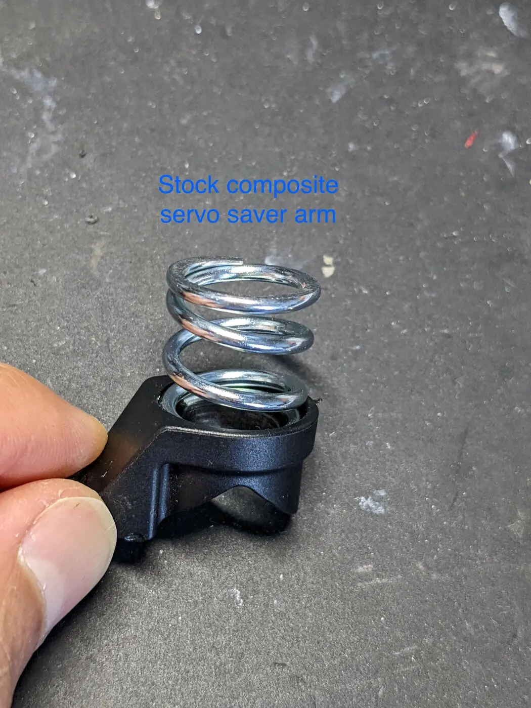

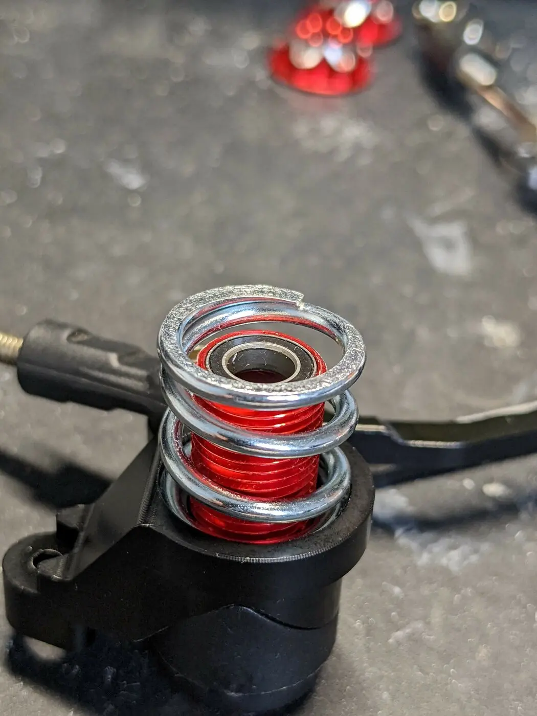

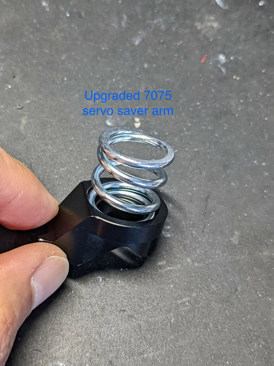

And fortunately, it fits fine in the servo arm, it's a bit of a squeeze, but it fits! And it fits fine on both the stock composite arm as well as the 7075 one.

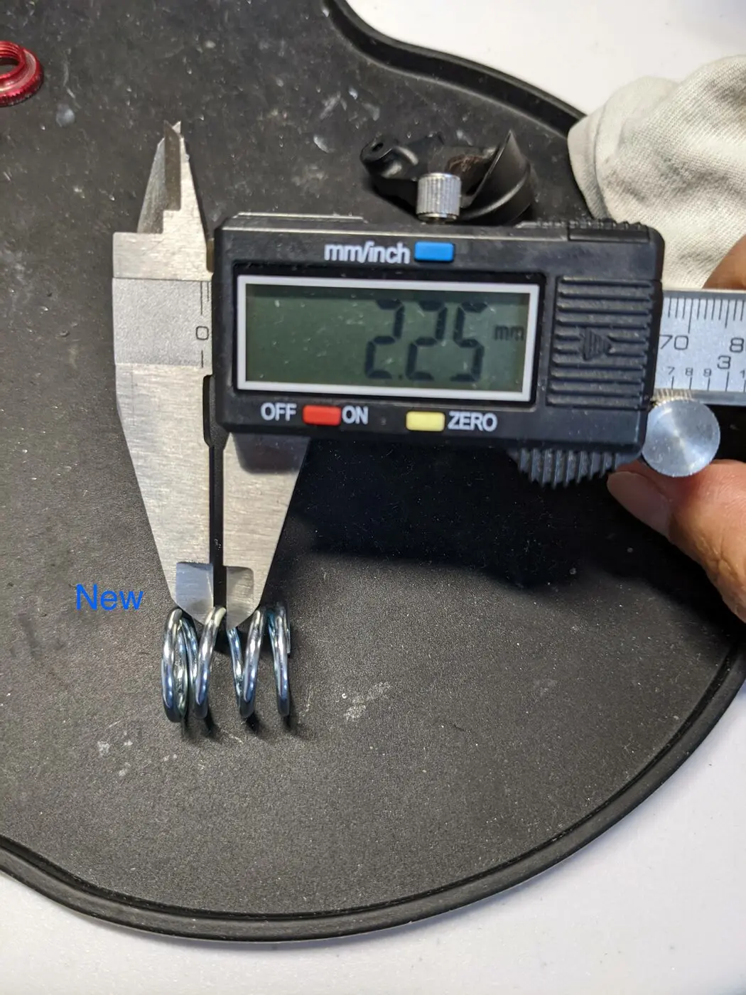

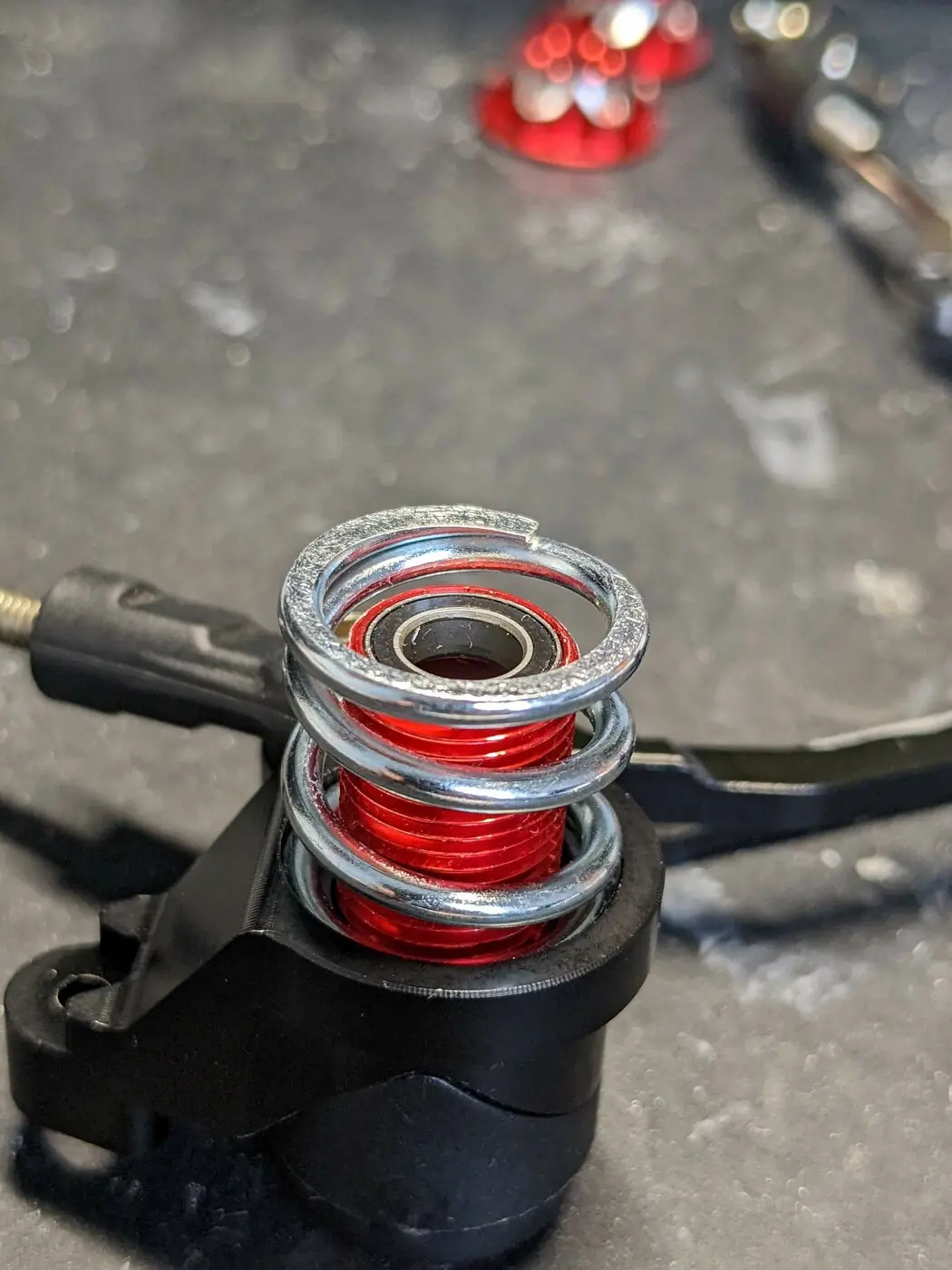

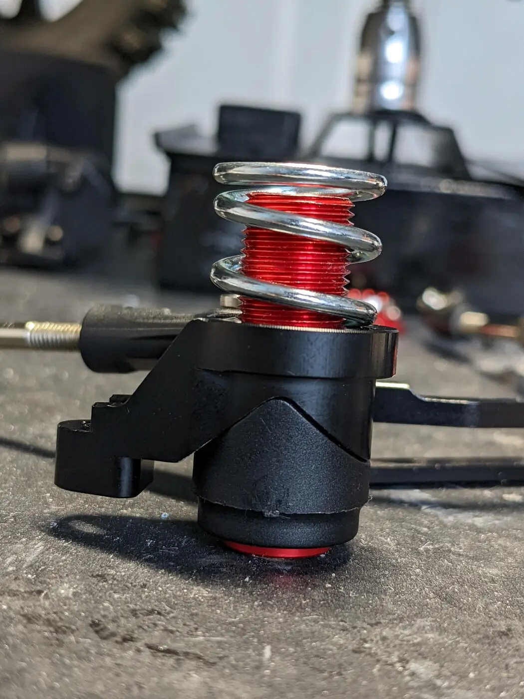

Here you can see how tall the spring is when mounted onto the shaft.

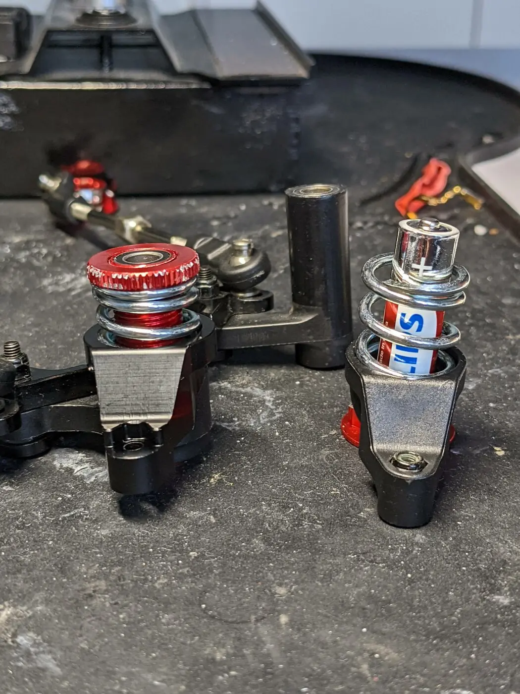

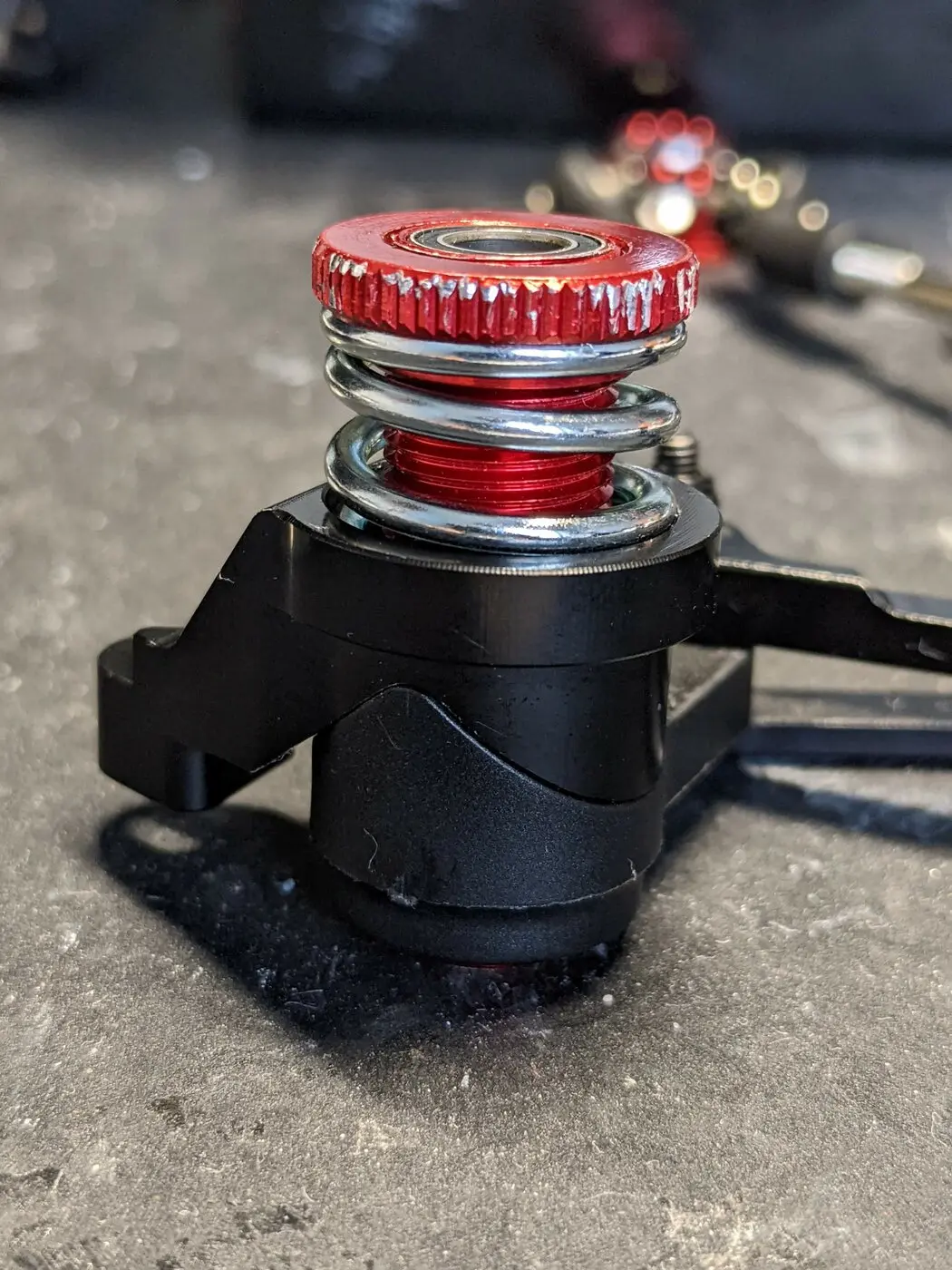

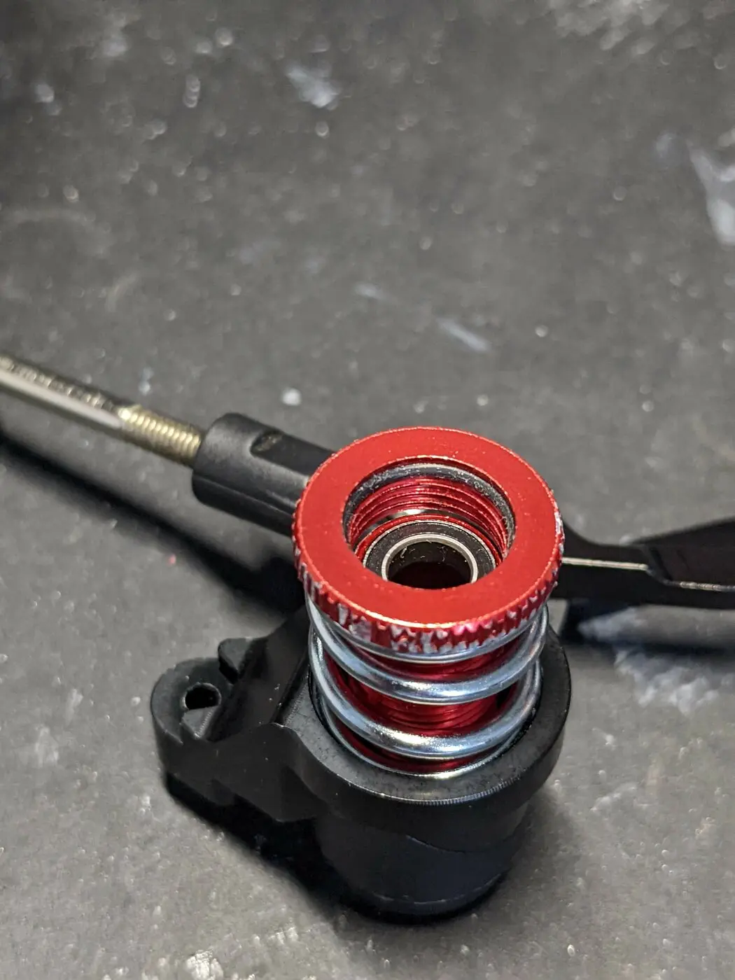

However if you just place the thumb spring collar over the spring you will notice that the bottom of it nearly touches the threads below, meaning screwing it in isn't that bad and it won't compress the spring too much, but it does compress it some as you need to screw the collar down so it's flush with the shaft, which in turn will rest directly on the chassis when mounted.

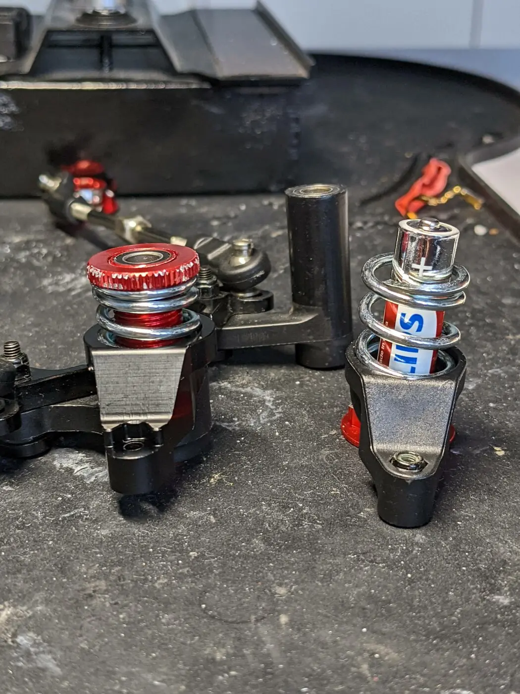

Finally, here's a visualisation of how compressed the spring ends up compared to one that is free (these are both new springs). Don't mind the AAA battery, it's just there to help me keep the thing straight for the photo!
That's it! I've bench tested it by installing the wheels and turning it on and turning the wheels while holding them and I can see the saver flexing and doing it's job. But I really have to hold the wheels tight and it takes me a bit of effort to keep them from moving. So I'm sure this will drastically improve the performance.

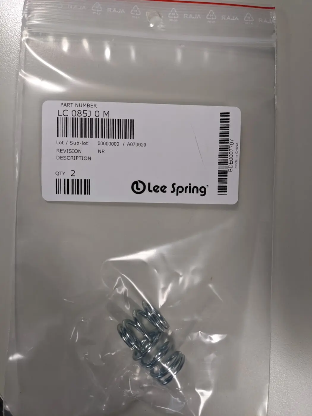

So, to recap, you need part number LC 085J 0 M from Lee Spring, and make sure to select your right location! I ordered from the UK site because I didn't know they had so many locations but in the end my order got processed by Germany and this introduced some delay. It would have been faster if I had ordered directly on the Germany site.
However if you just place the thumb spring collar over the spring you will notice that the bottom of it nearly touches the threads below, meaning screwing it in isn't that bad and it won't compress the spring too much, but it does compress it some as you need to screw the collar down so it's flush with the shaft, which in turn will rest directly on the chassis when mounted.View attachment 2535
