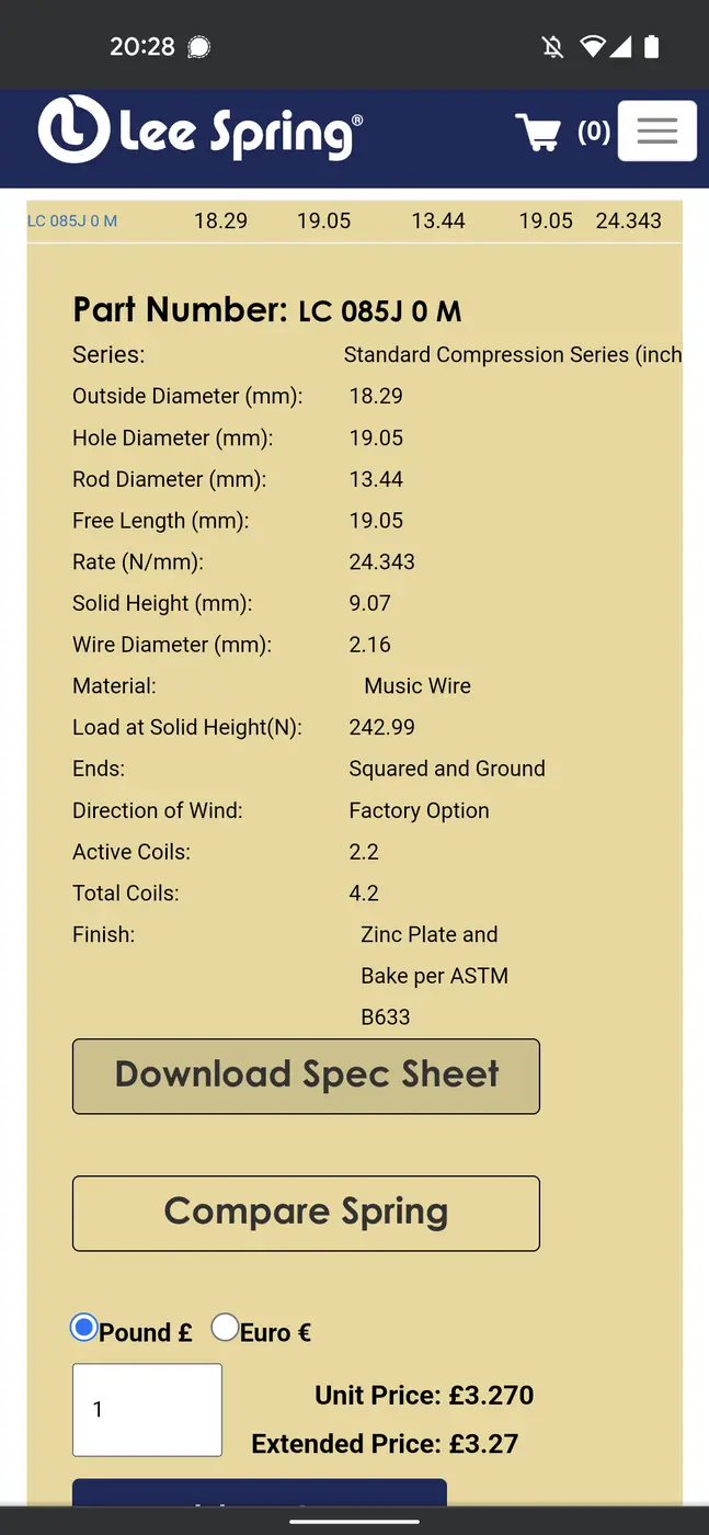

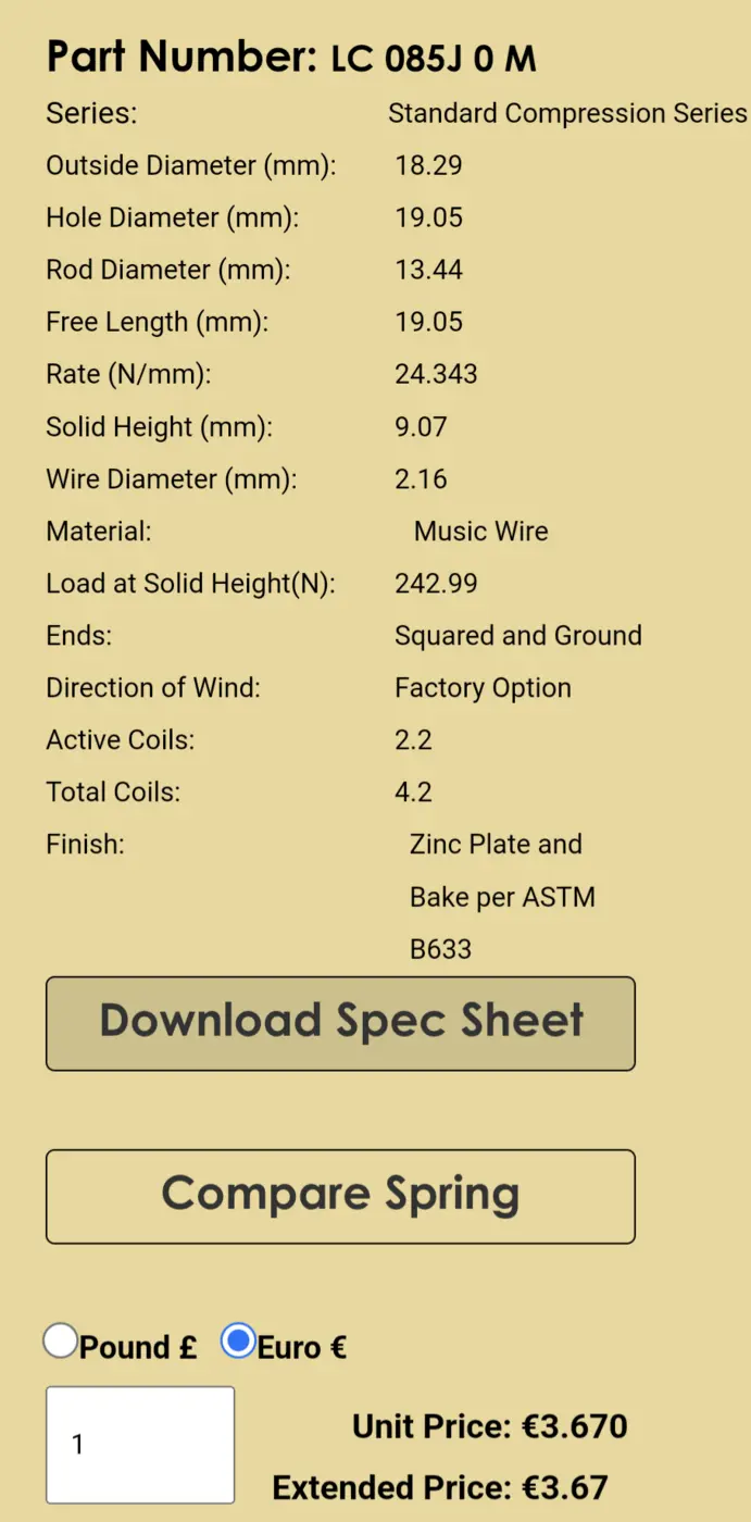

The load rating on the stock spring would have to be lower, being made from a thinner wire. This spring at 240ish N spring would require about 24kg of weight to fully compress the spring. Sounds ball-park to me.Guys! Check out this page!

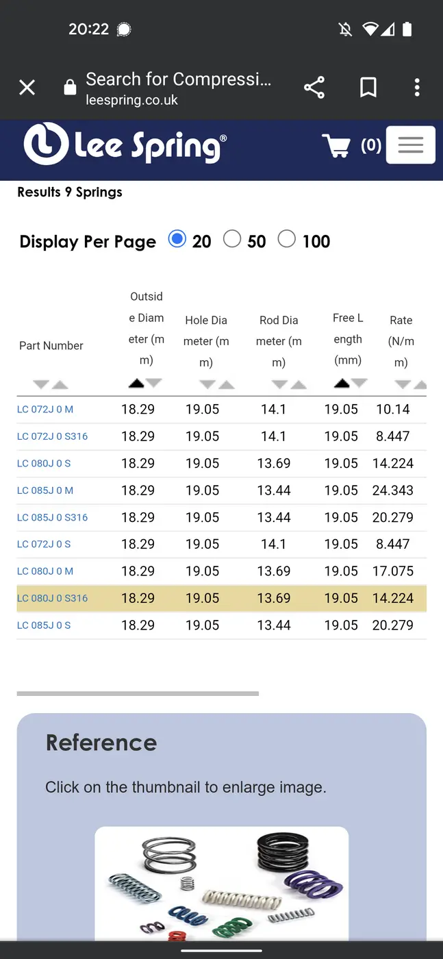

https://www.leespring.co.uk/compression-springs
This explains how to measure the spring and then your can put all that in the filter and voila!
There's a few like this:

Ok so we're thinking the following spring might be a good fit.I'm not a fan of C spring, Kinborough style servo savers. There's a limit to how much spring resistance you pack into a servo mounted servo saver.

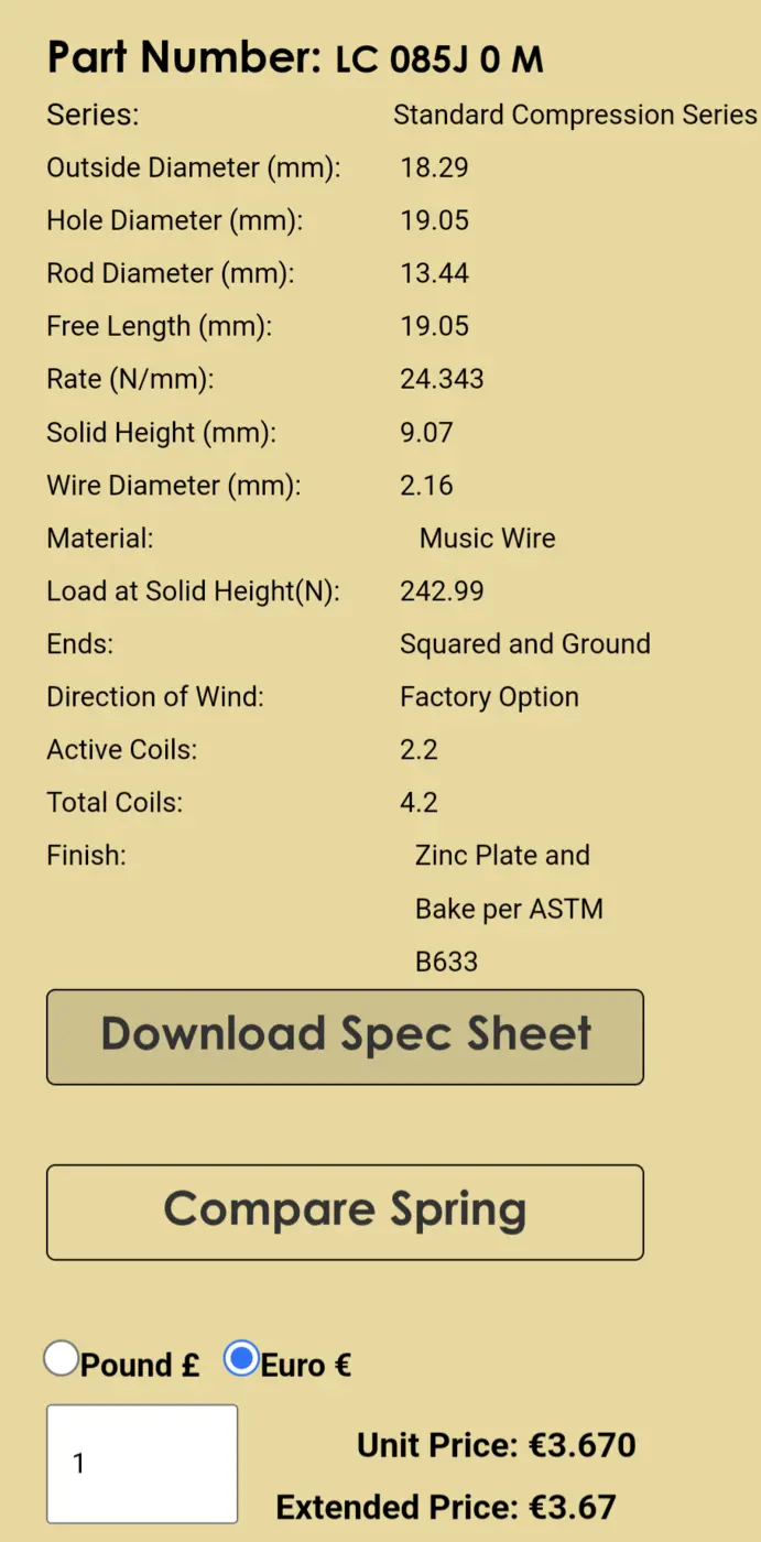

This spring looks like it's worth a try.Ok so we're thinking the following spring might be a good fit.
Part Number: LC 085J 0 M

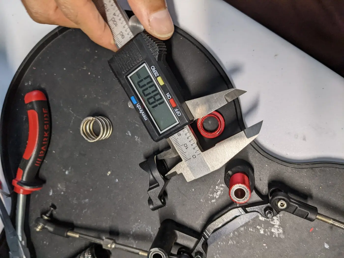

Now I'd just like to understand what's the difference between hole diameter and rod diameter?
I just want to make sure it'll fit in the post, did you happen to measure the diameter of that @Horatio ?

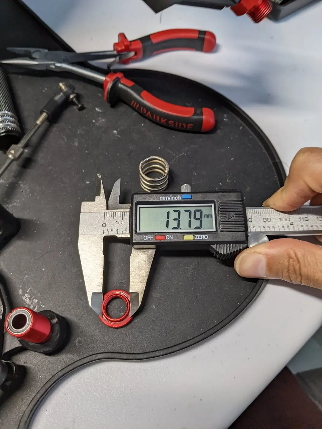

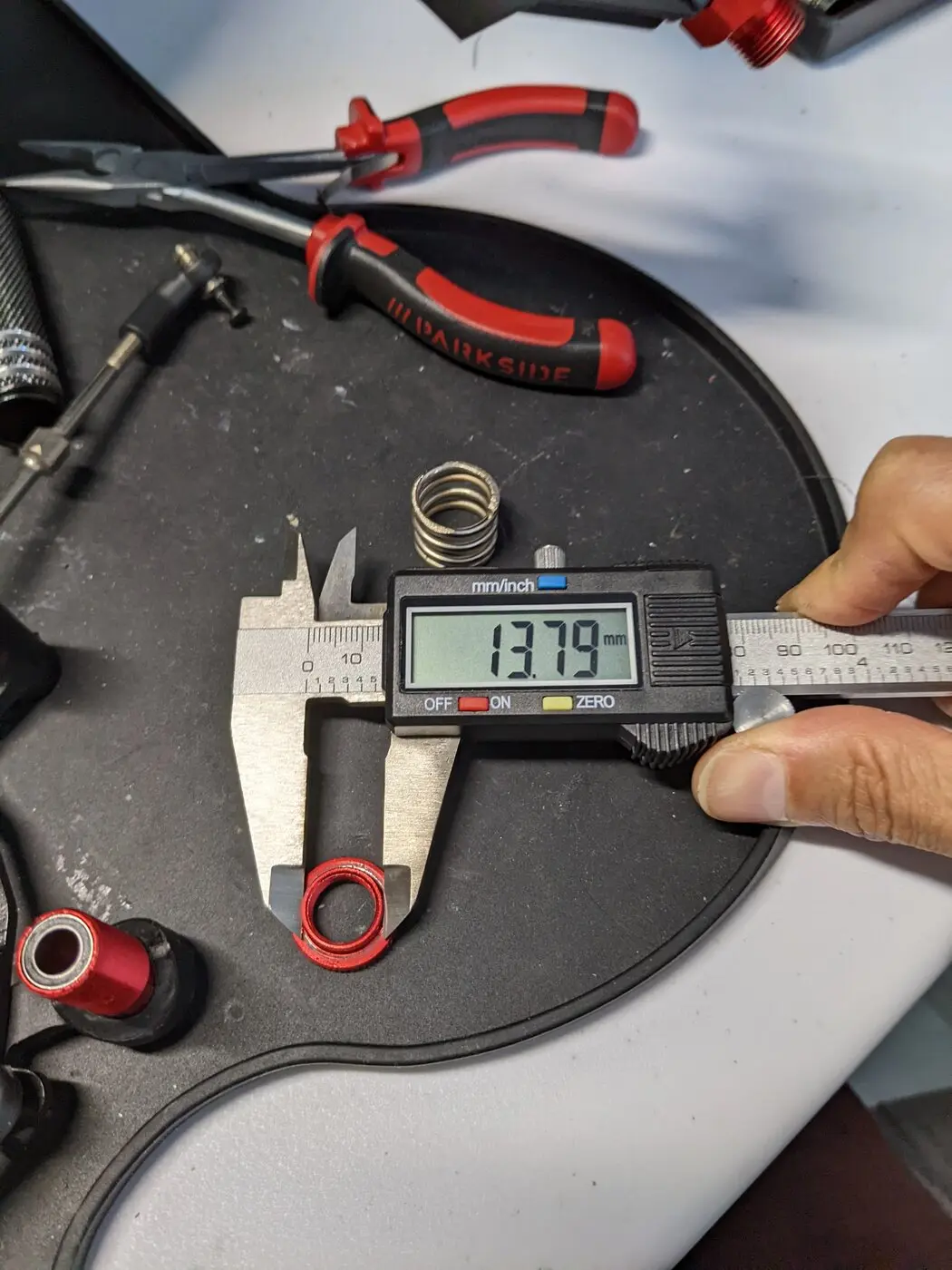

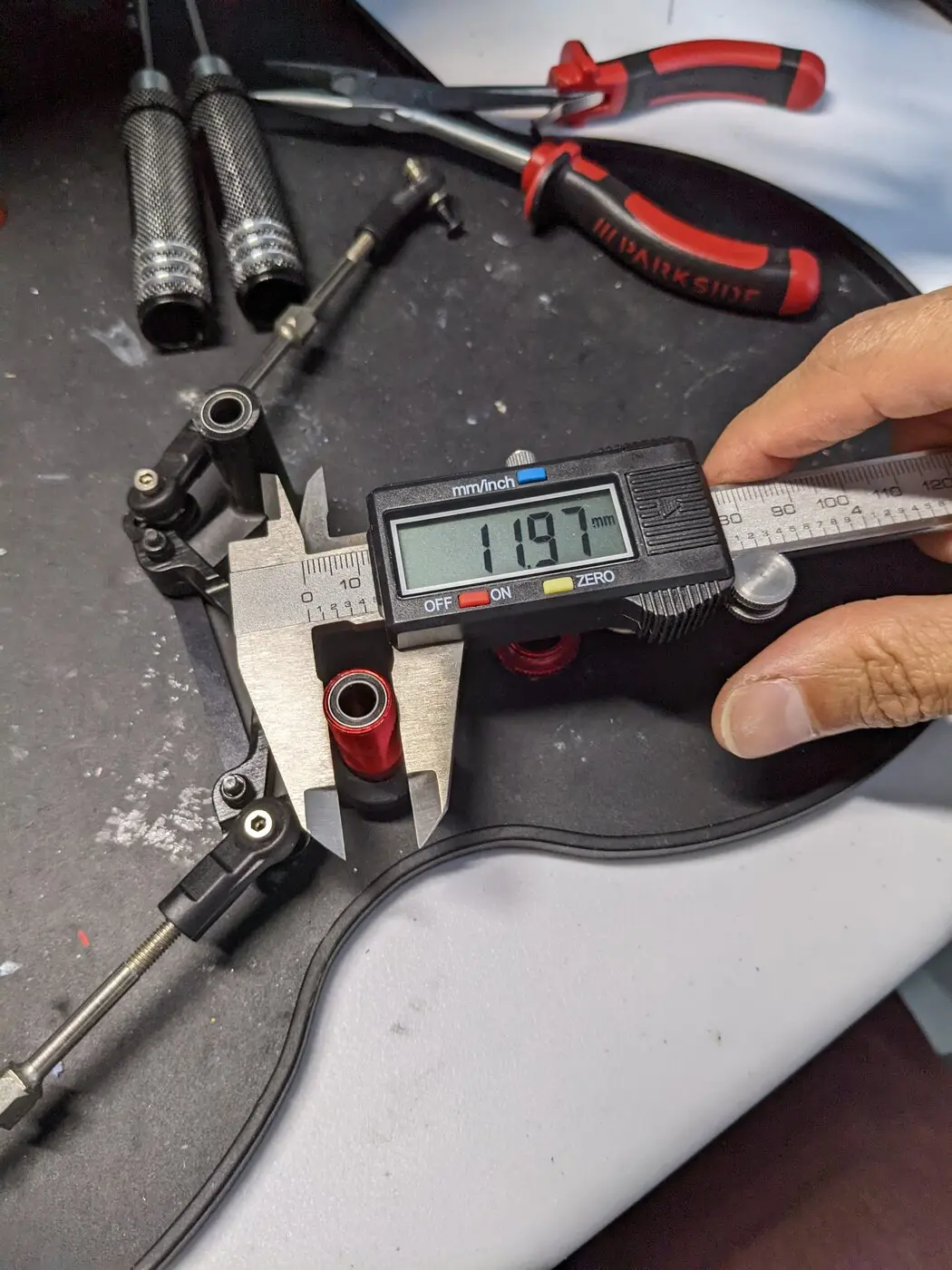

My calculations would be that of the outside diameter is 18.29 and the wire diameter is 2.16 then the inner diameter must be 18.29-(2.16x2) = 13.97. Right?

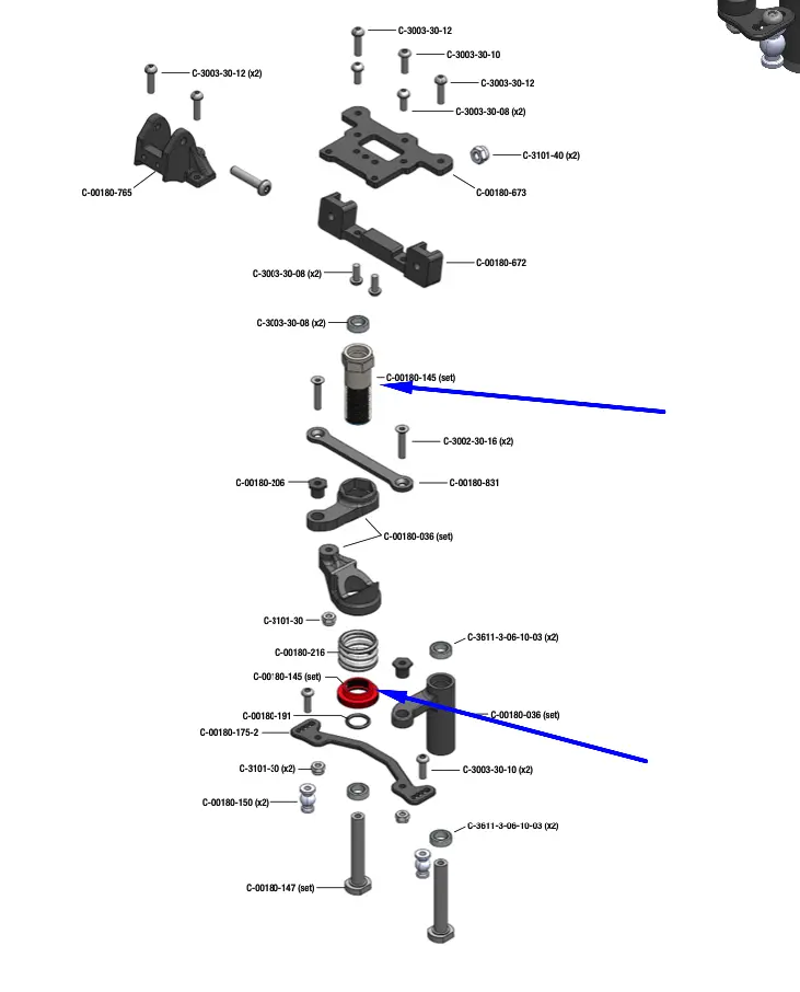

Ok so the question is if the diameter of C-00180-145 servo saver shaft is 13.44 or less? If it is then we're sorted!This spring looks like it's worth a try.
Rod diameter is the maximum size rod you could put into the spring without an interference fit.
Hope diameter is size of hole you could put the spring into with a clearance.
One small issue with this company is that orders below $30 attract a handling fee of £12.50.
So, we'd need to buy around 10 springs to avoid paying the additional fee.
If the post is 13.4mm or less, it should work.Ok so the question is if the diameter of C-00180-145 servo saver shaft is 13.44 or less? If it is then we're sorted!

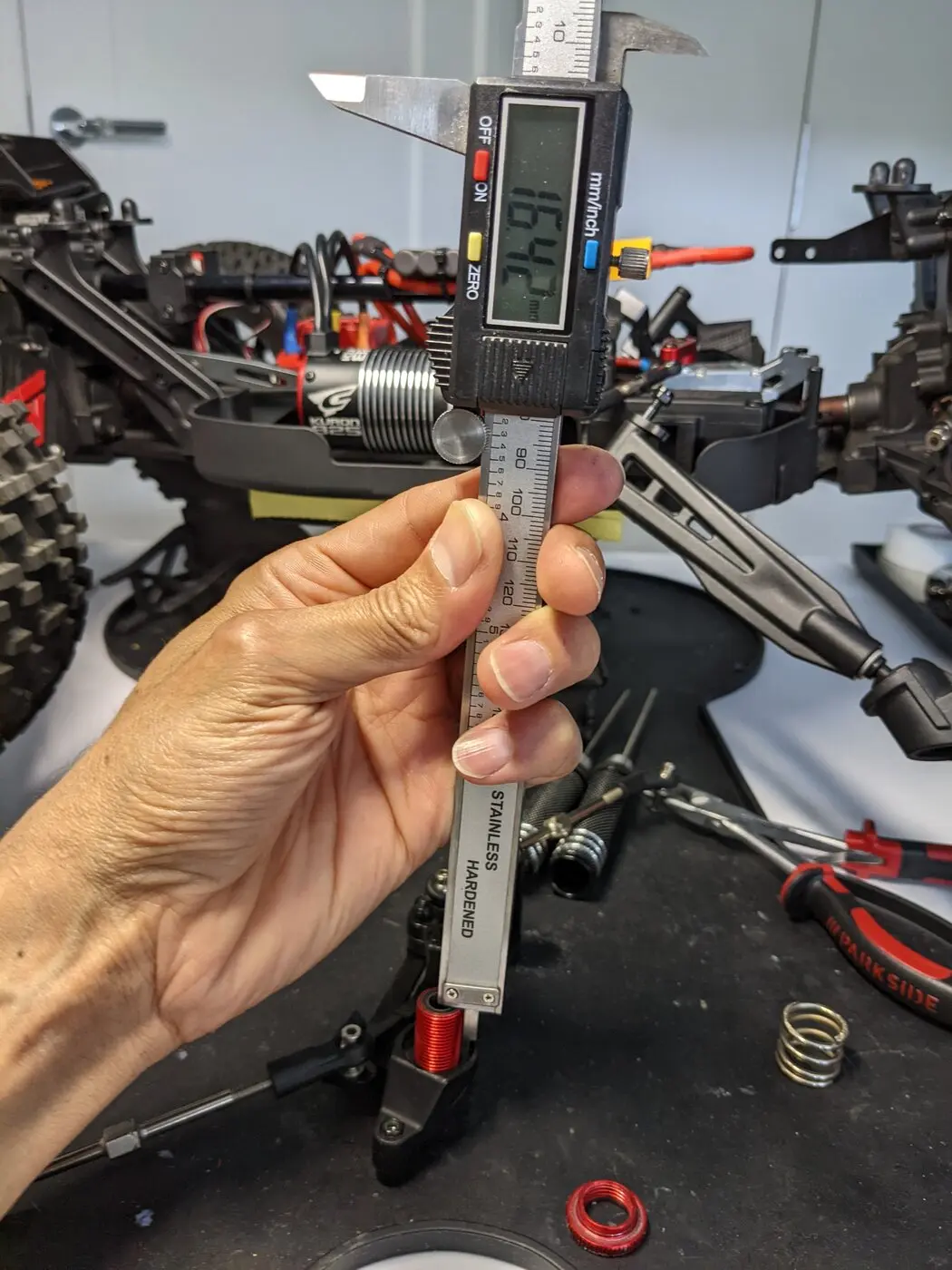

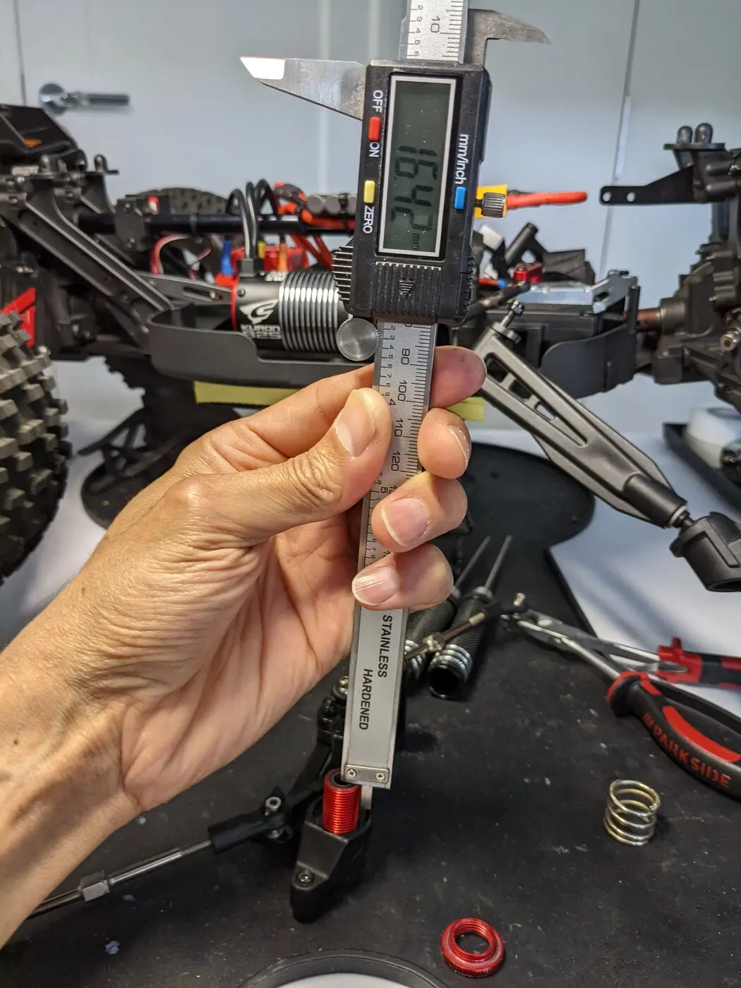

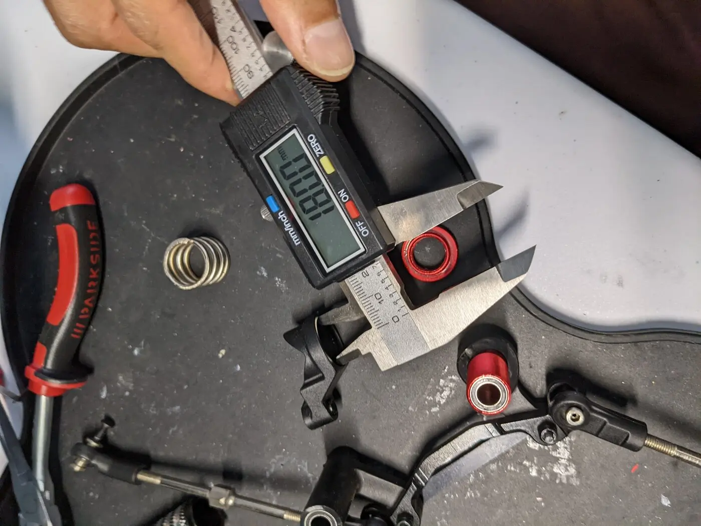

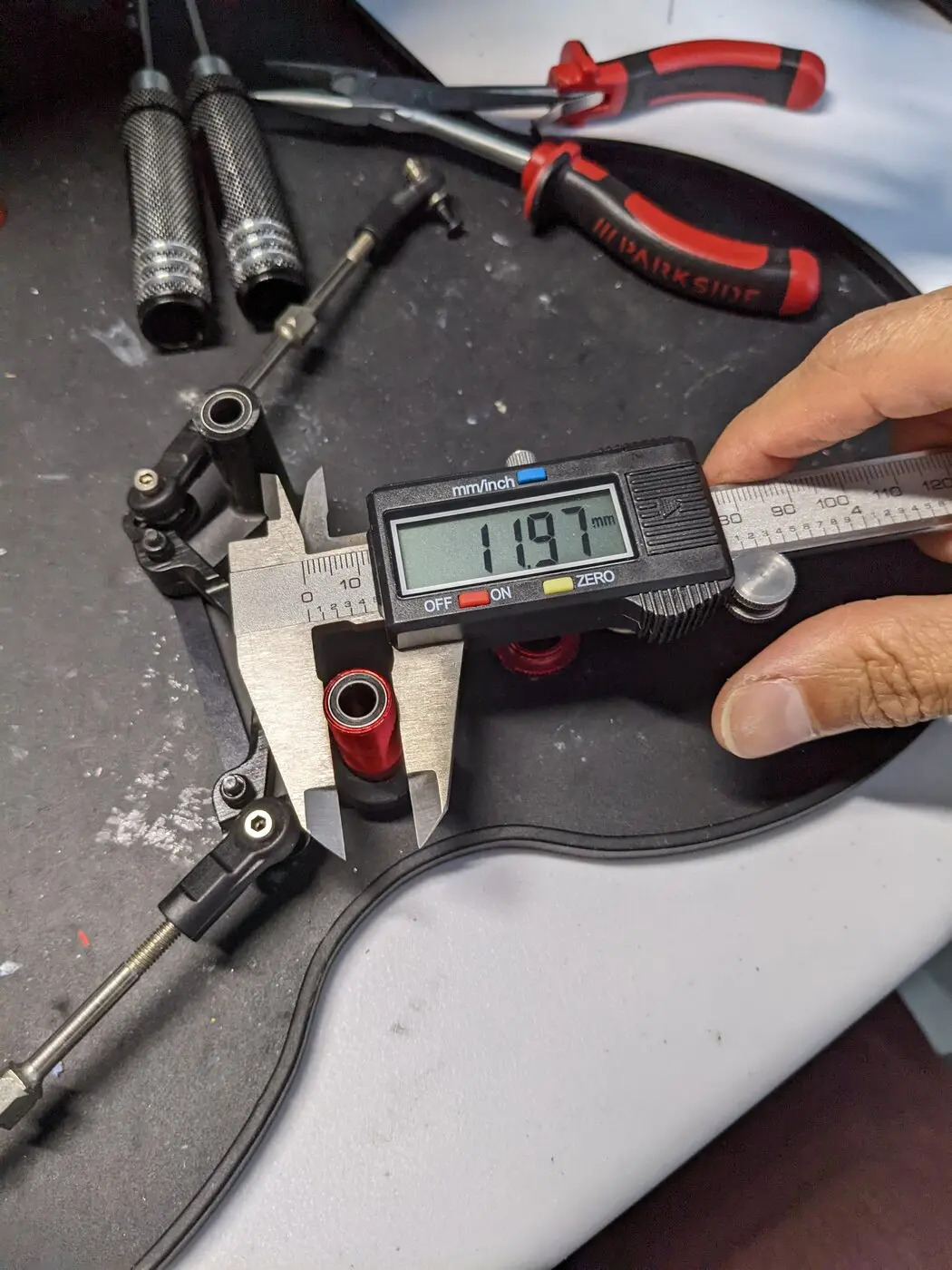

Thank you so much! I've only just put mine back together! You saved me a chore. Solidarity bro!So I took mine apart to take some more measurements and I think we'll be ok with that spring.

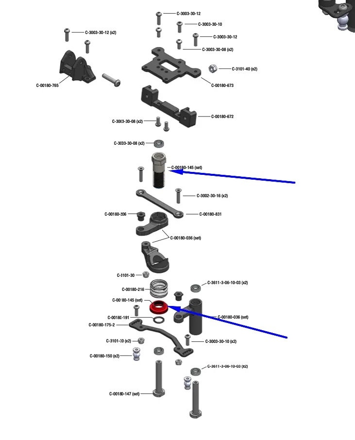

The servo saver shaft is 12mm in diameter.
The depth available for the spring is 16.50mm, so yeah it'll be tight but I'll work.
The one thing that might be a struggle is where the spring goes into the saver arm, that's only 18mm but it think I'll go in, last resort we can file that part a bit. Same with the collar.

Excellent!I think this spring is going to work fine. As Danni pointed out, one minor issue is the .29mm excess diameter that will foul the plastic arm - but I'm confident that this small interference can be 'fettled' away from both the spring itself and the plastic arm.
In return, we'll have a thicker gauge spring, with a higher rate, and a more positive action - without having to clamp it all the way down.

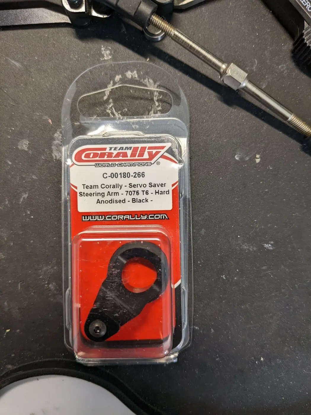

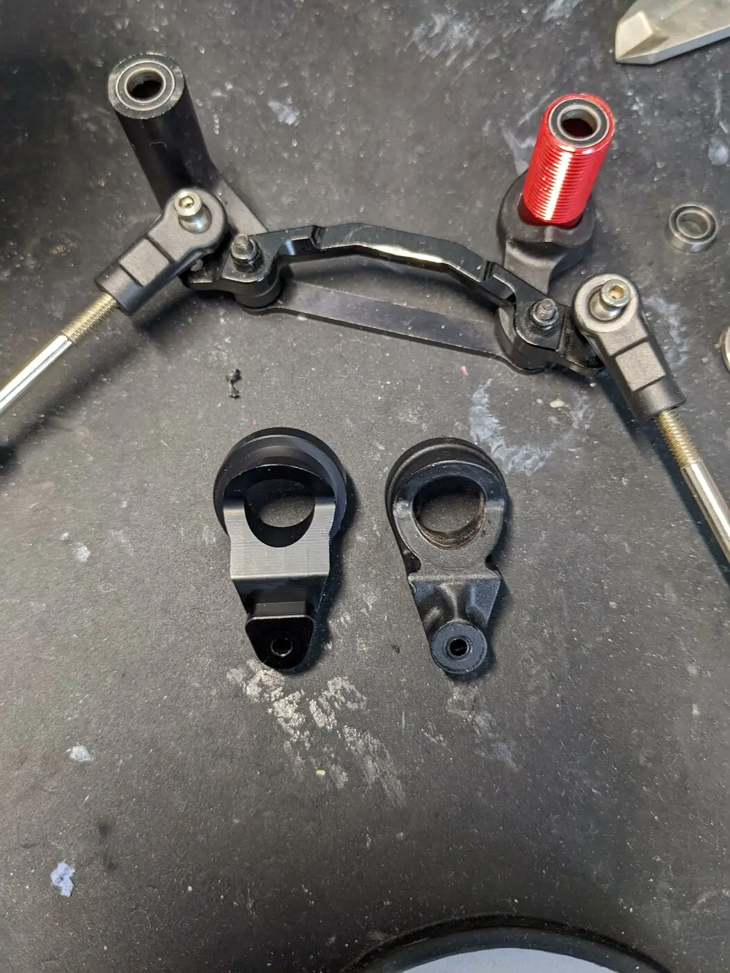

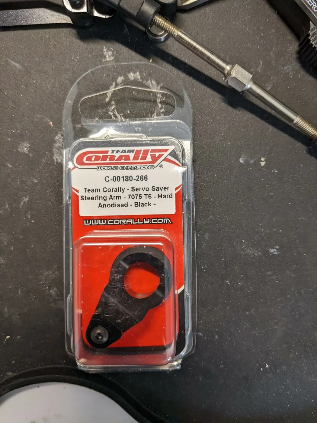

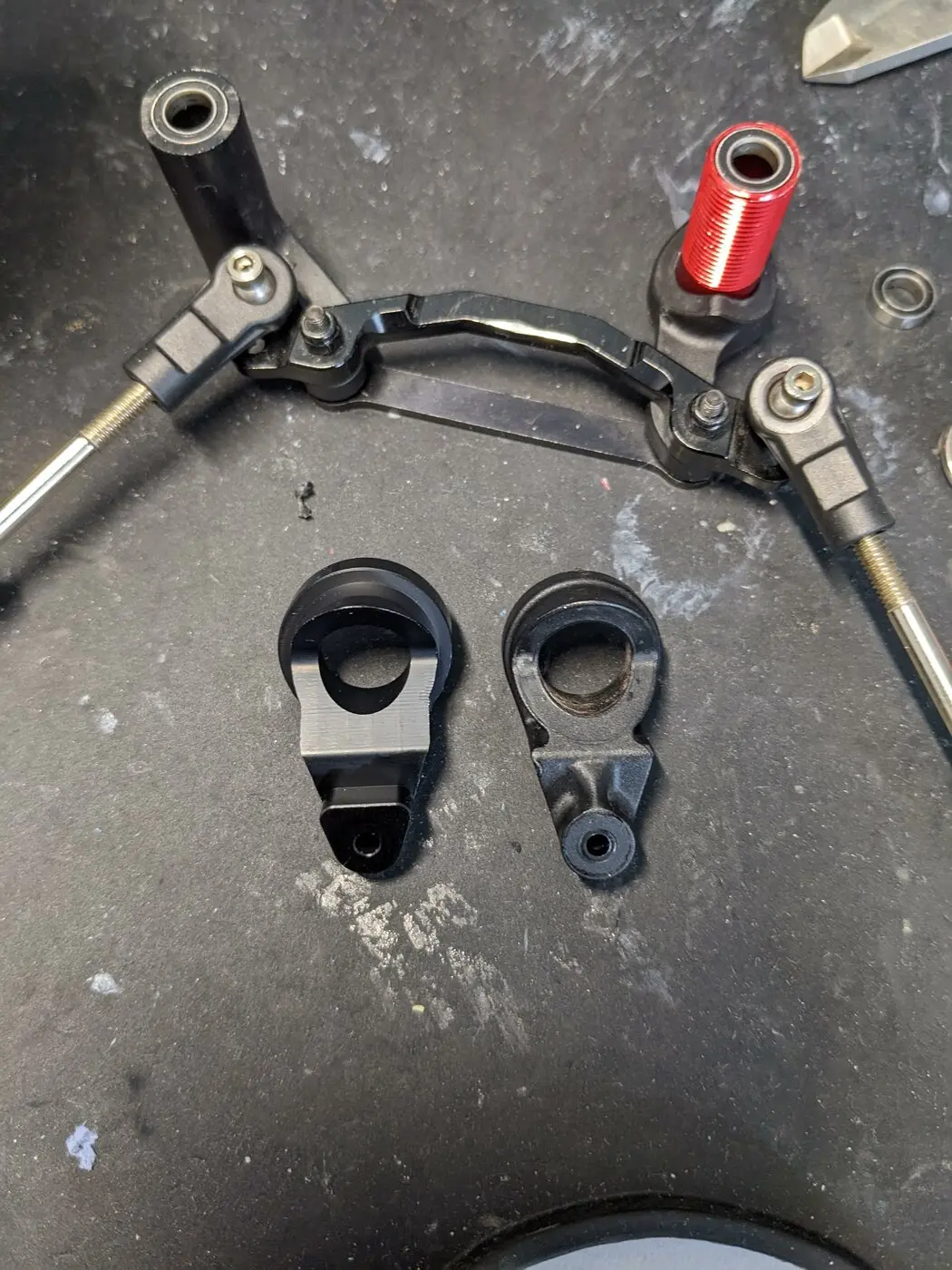

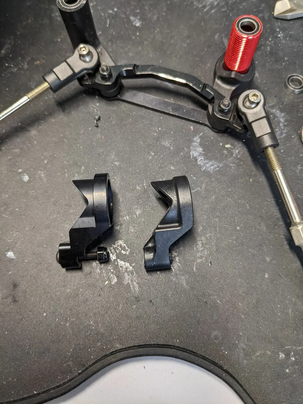

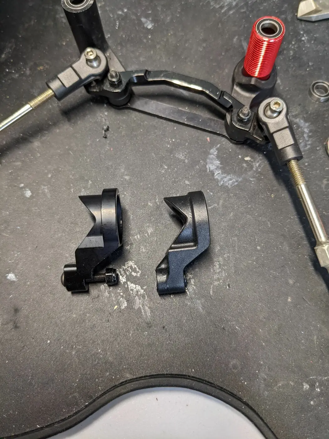

Looks like a nice quality bit of kit!While I wait for those springs, the 7075 servo saver arm arrived. Looks like great quality!
It's the first time I see a servo saver where half of it will be plastic and the other half will be metal. It's always been either all plastic or al metal. We'll see how this works.

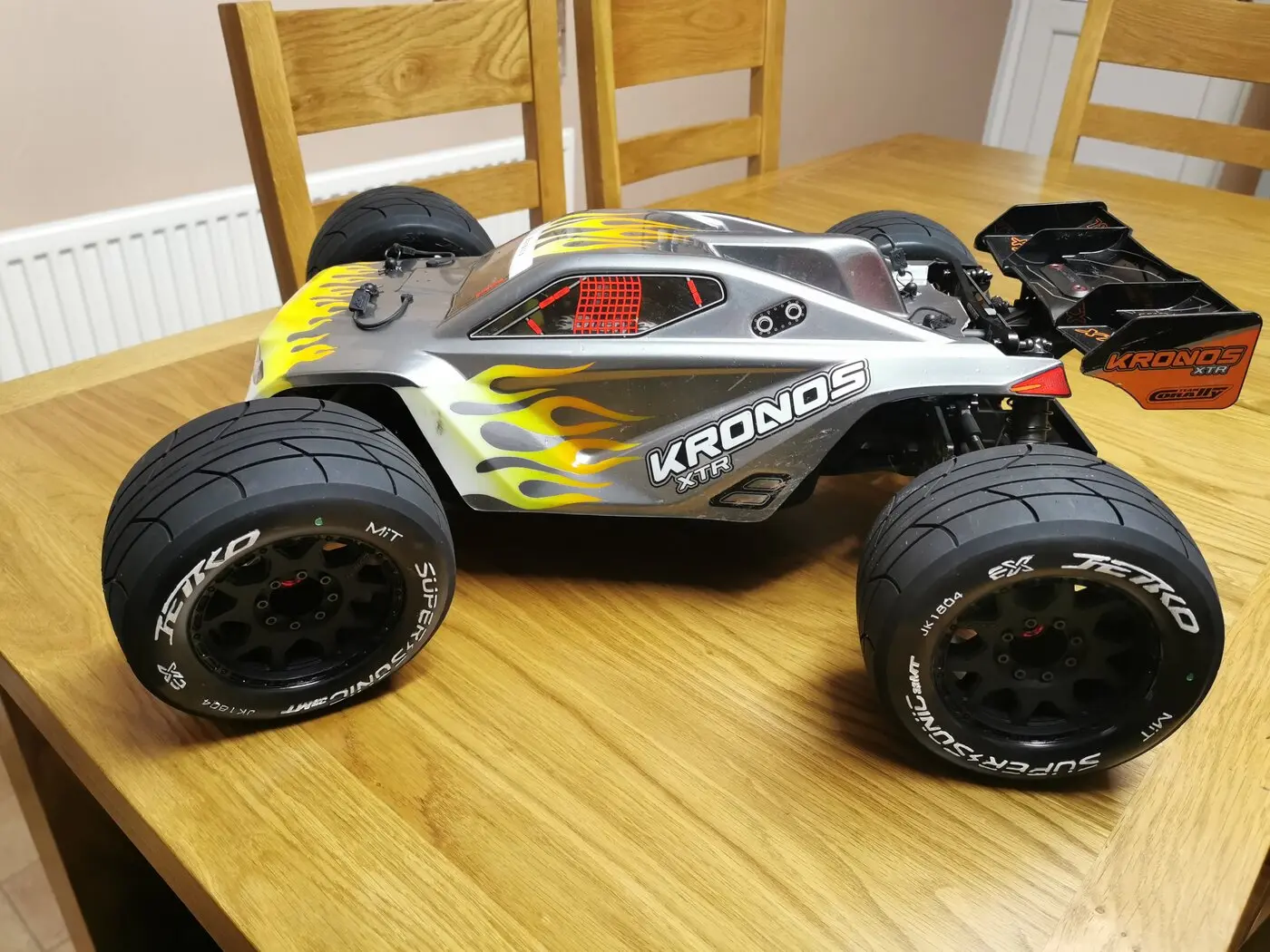

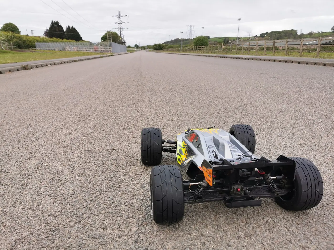

My steering was less vague today with the servo saver clamped up, but I think what I'm getting is a little bit of torque steer.
I'd like to think this could be reduced by careful geometry changes on the ackerman plate and track rods, but that spring - as long as there is room for it to compress - is likely not going to be able to hold the forces of 830g worth of wheel and tyre going at 20,000 rpm.
Even the slightest angular change is going to result in gyroscopic forces being fed into the spring.
Speaking of which... View attachment 2507View attachment 2508
This is why we need tidy steering.

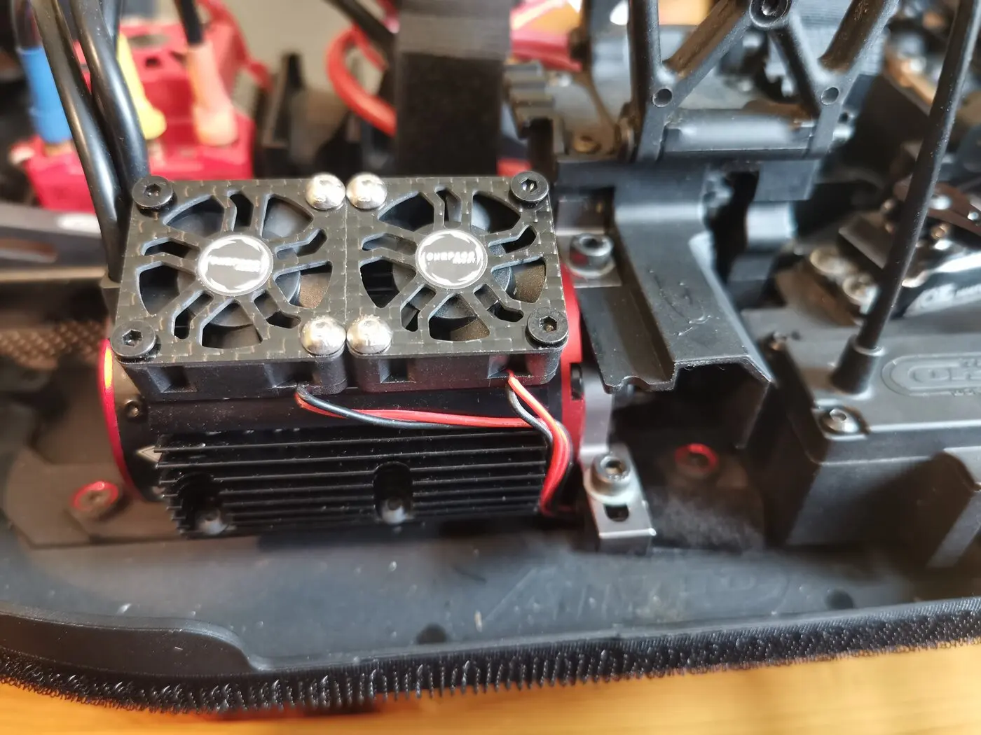

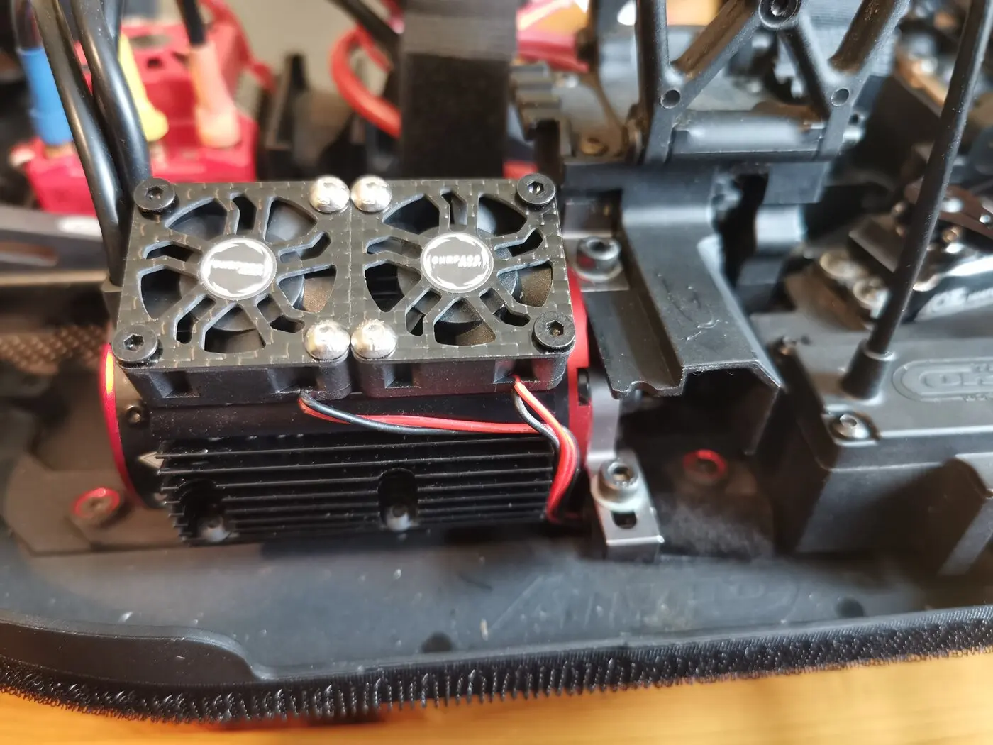

And proper cooling....
Motor Temps were kept within the 130°F after these dozen or so runs today.

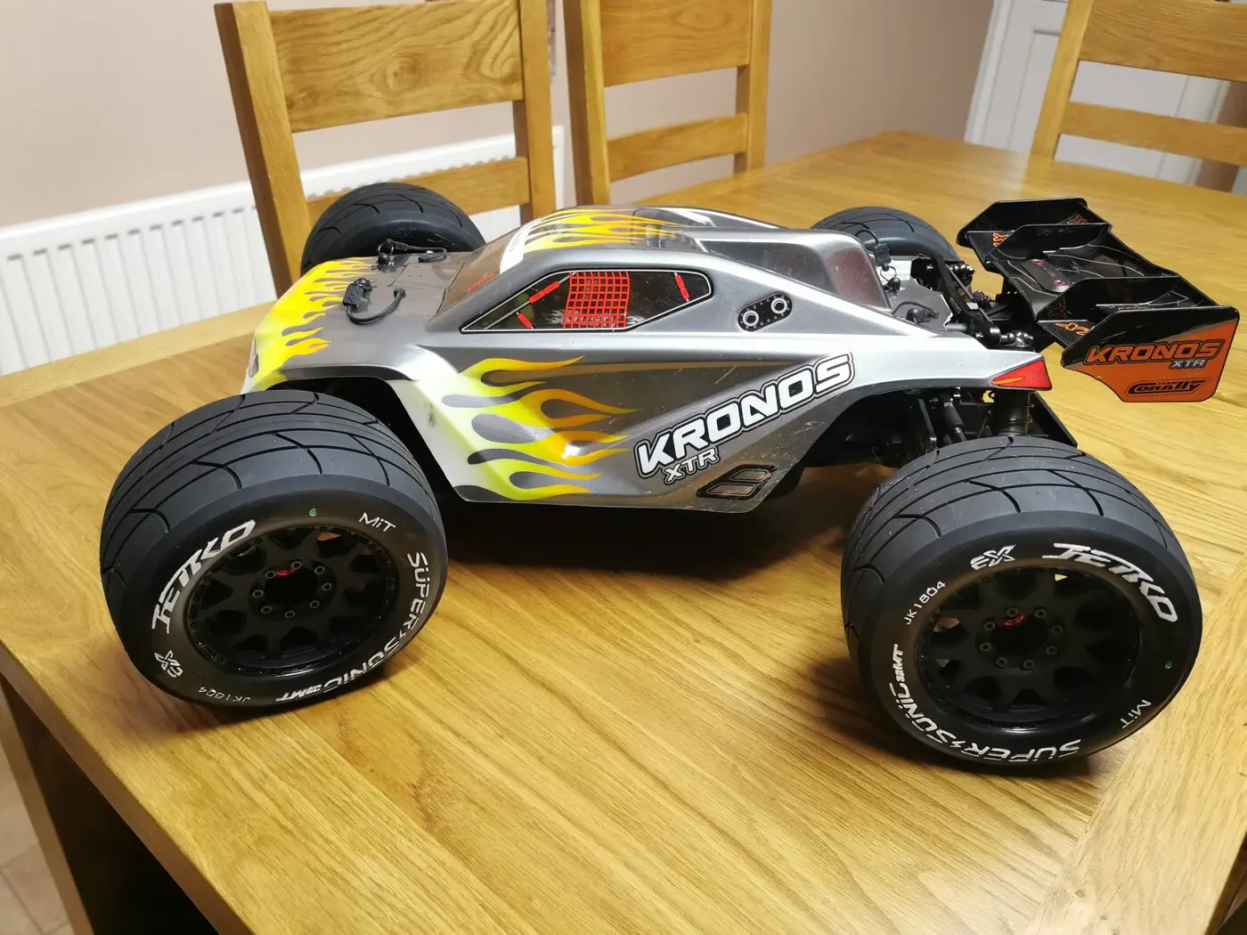

Even with all this space - steering is still essential!
JetKo Tyres grip well and are belted - but they're heavy and place demands on your servo saver that the stock wheels/tyres don't. A good servo is essential, but without an equally good servo saver setup and correct geometry - steering can be......fun.

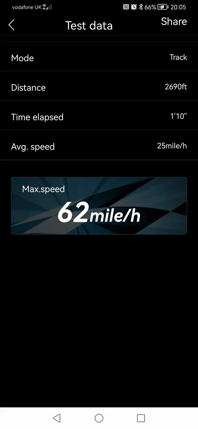

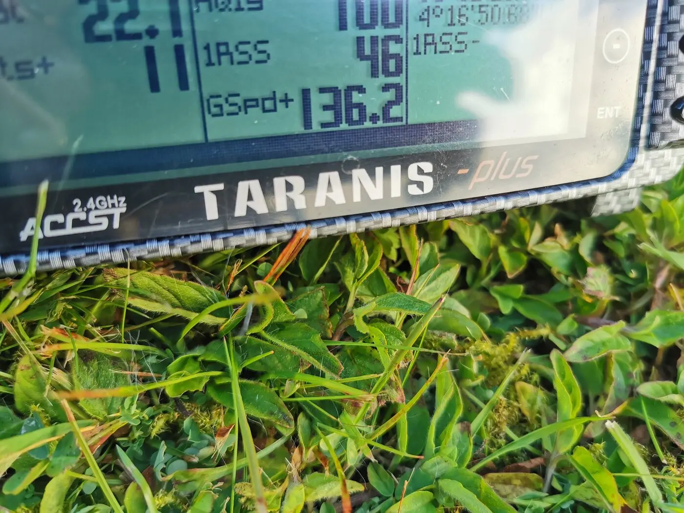

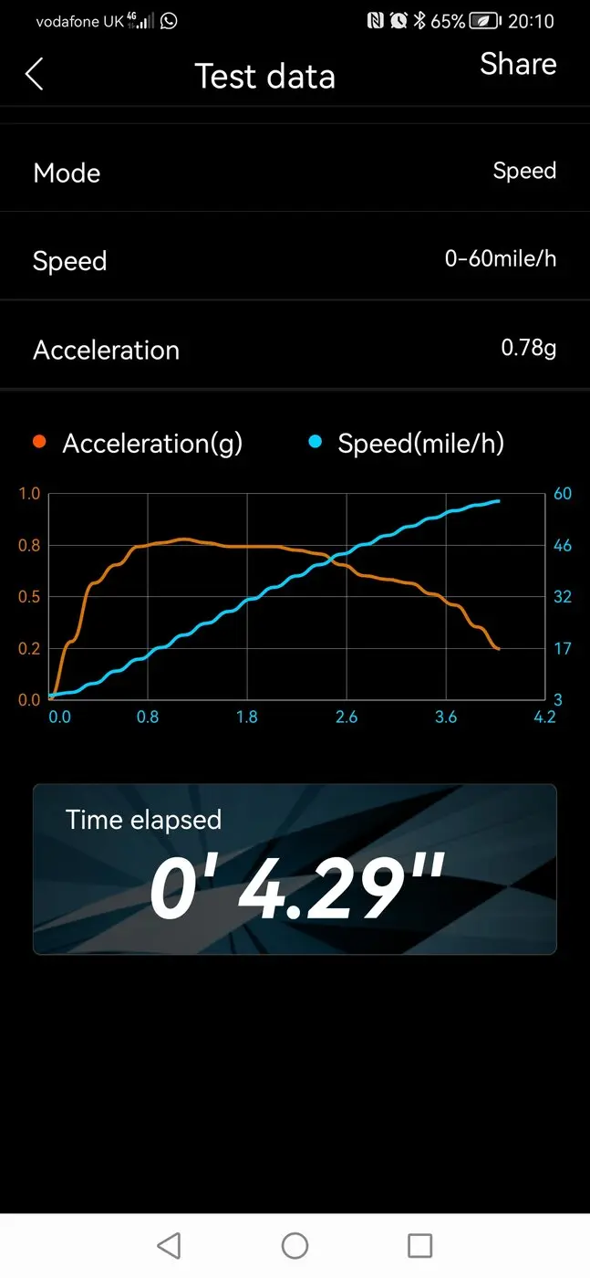

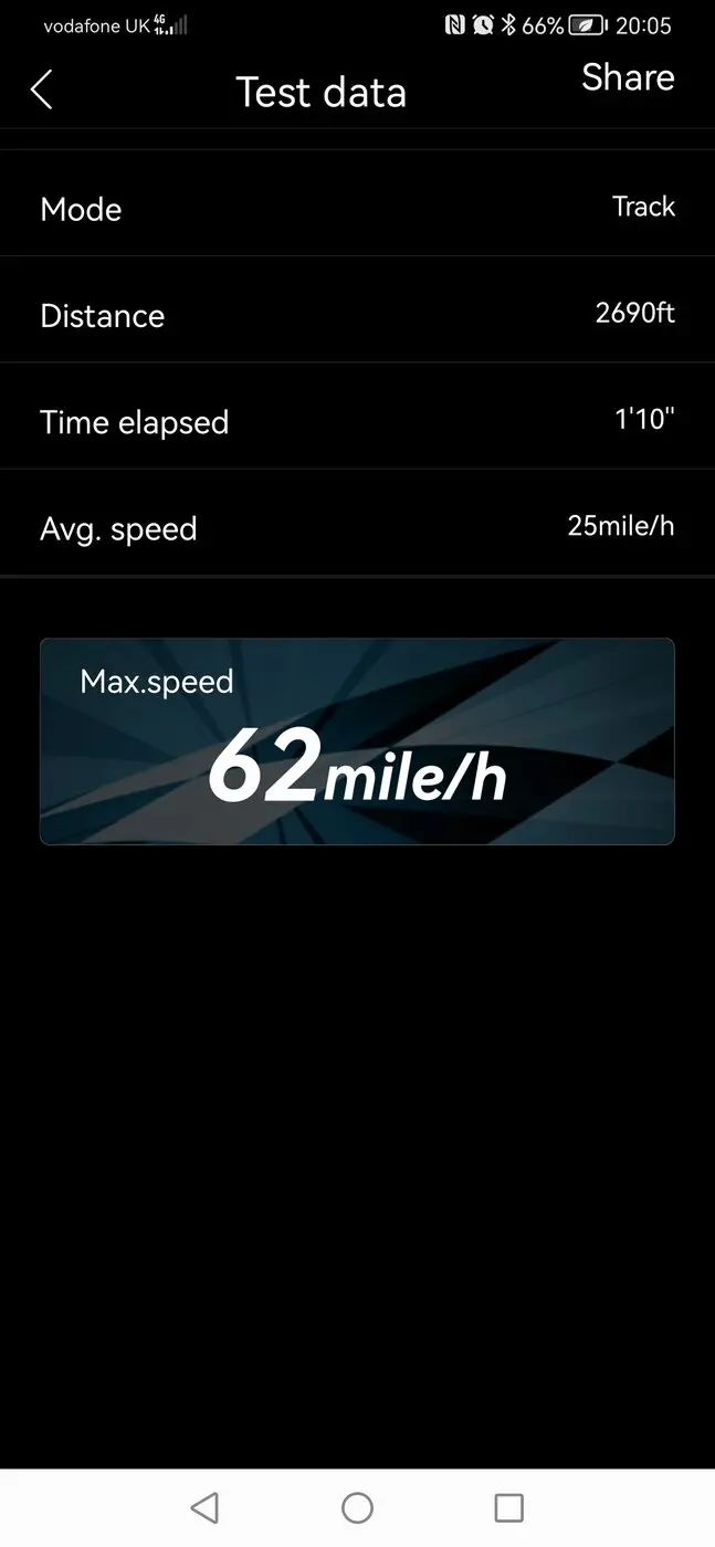

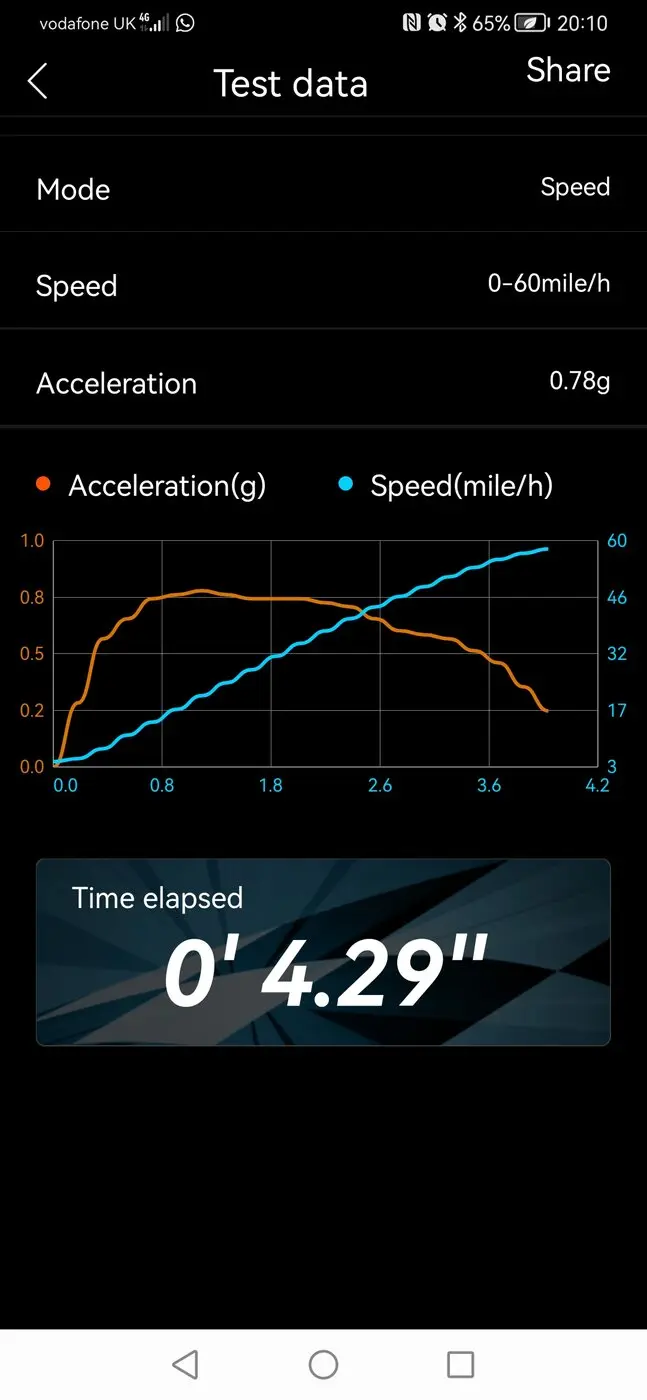

I'd love to know what sort of speeds/acceleration people are getting out of their rigs.
I love ripping it around off road too, but I just had to find out what it could do, opened out on 6S. Turns out, it's completely bonkers.Wow! Nice Street basher!!!! I haven't done any speed measurements yet. Will try to do that soon.
