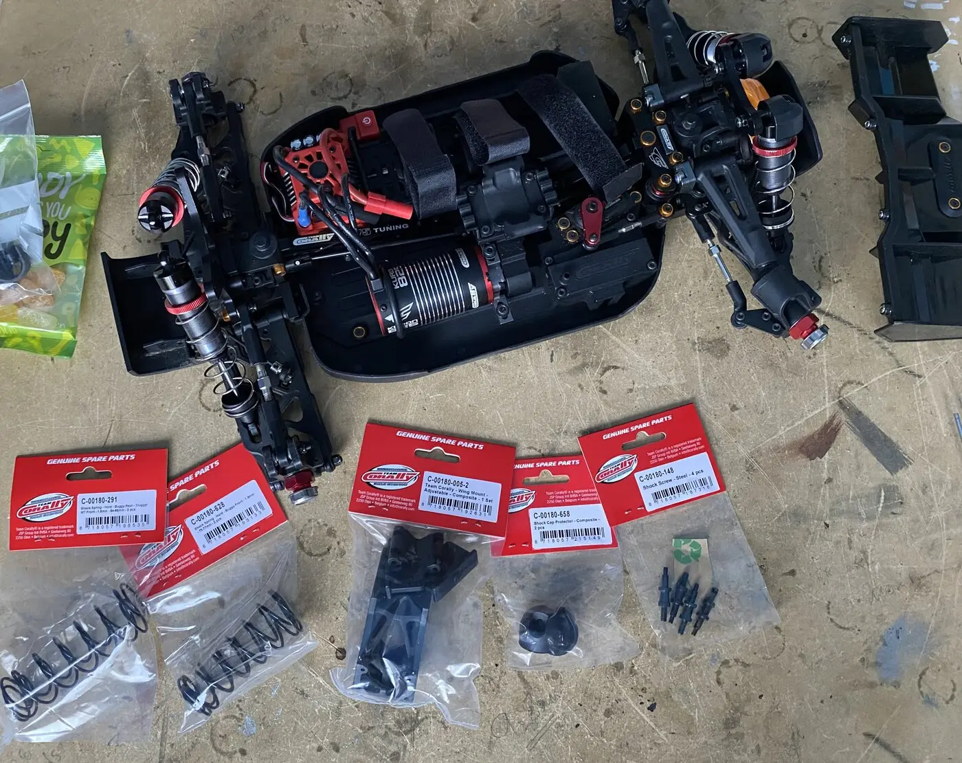

Front 7075 chassis brace View attachment 2119Skeeter Front tower, shock protectors and longer shocks.
7075 rear chassis brace
Carbon center chassis brace
Skeeter rear tower
Boom monster radix. Also has the wide hub conversion.

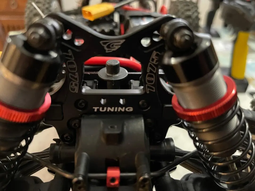

The 7075 shock towers arrived today, and I installed them. I will be installing the aluminum steering deck when it arrives, which should be Saturday.

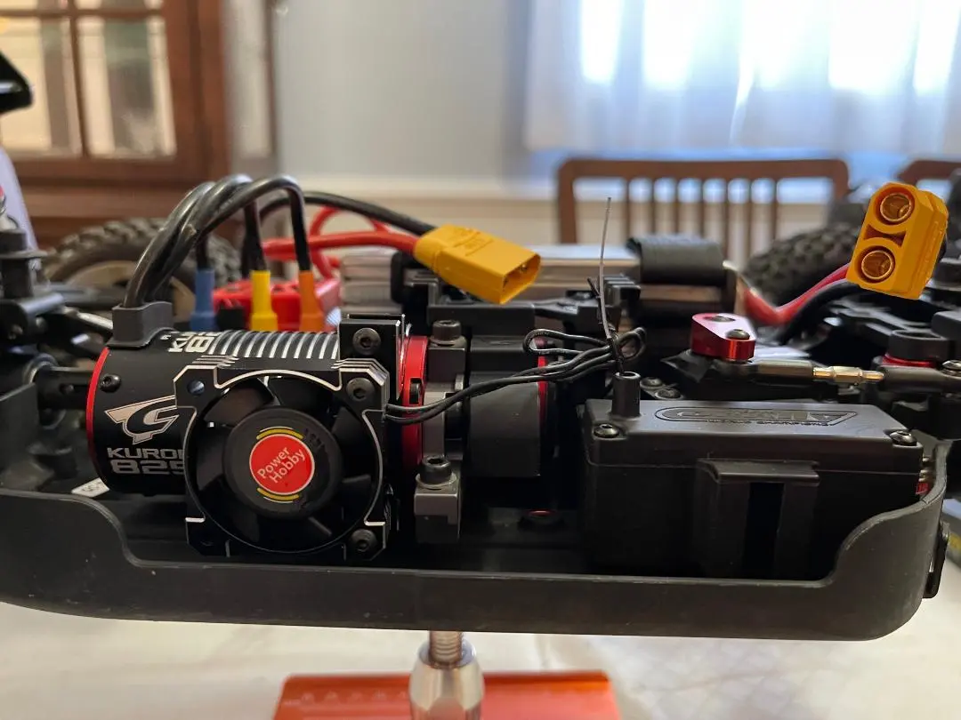

This morning I installed a Powerhobby 40mm Tornado fan on the motor in my Radix 6. What a PITA: to power to the fan, I had to completely remove all the screws that hold the combination receiver box/servo mount to the chassis; unhook the servo arm; remove the lid of the receiver box; fish the fan wires up through the bottom of the receiver box; plug the fan wires into the receiver; then reassemble everything. This receiver box was obviously designed without a thought about maintenance.

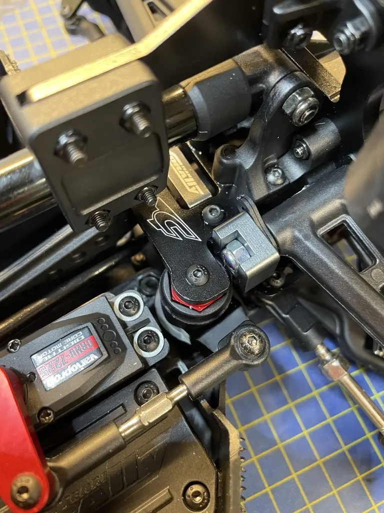

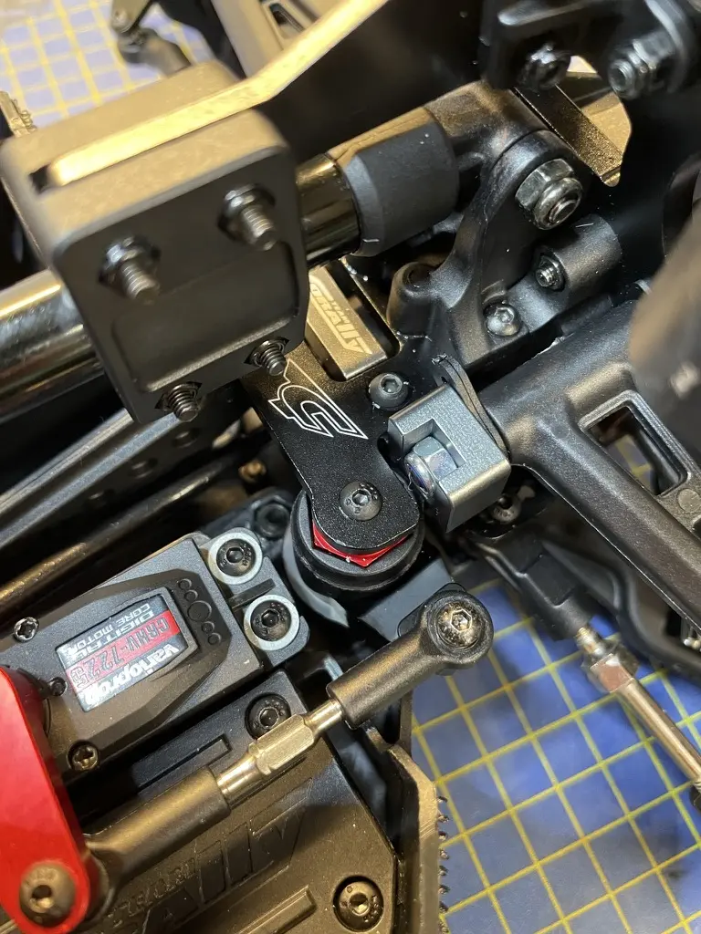

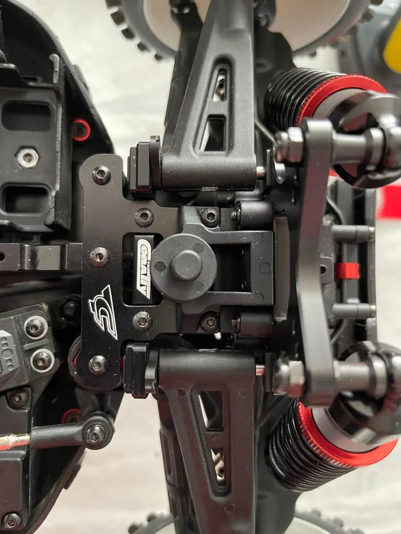

I received the TC 7075 XTR aluminum steering deck, TC 7075 PRO front upper suspension arm mount, and steering deck holder and front body post this afternoon. I started to install them, but I ran into an issue: there is now a space between the suspension arm and the new rear hinge pin mount due to the design of the PRO mount. I had to order a suspension arm shim kit from RC Hobby Explosion to fix the issue, and my Radix is down until the shim kit arrives. :( Fortunately, I usually get Corally parts from RC Hobby Explosion in three days or four days, so my Radix shouldn't be down too long.
I'm not using that front rear suspension mount shown in your pic, I'm using the PRO Racer mount, which uses the square composite bushings held into a TC 7075 suspension front upper rear suspension mount to hold the rear of the hinge pin. Your basher setup uses the threaded hinge pin system and a different front upper rear hinge pin mount, as shown in your pic. I bought everything based on a diagram on the Corally web site, and it didn't mention needing additional spacers. You can see an area on both hinge pins that need shims to fill the gap on the hinge pins. The TC suspension arm shim set, part number C-00180-055, has a selection of shims that should work. Those shims have to be put on the hinge pins before they are assembled: they do not snap on like the ones to the left of the suspension arms as shown in the pic, so I will have to partially disassemble the front end to put the shims in.
arm
The owner of my local RC shop helped me find some Traxxas suspension spacer clips that solve my issue with the spacing on the front upper suspension arms. I still plan on using the Corally shim kit that is due in next week for a permanent fix, but the Traxxas clips will work until then. The Radix6 is ready to run again. :)

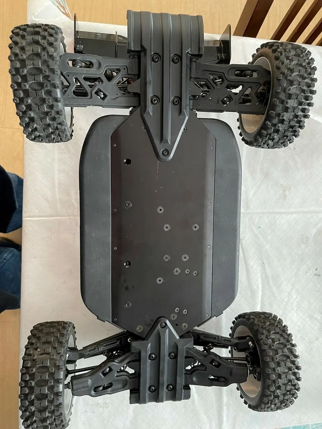

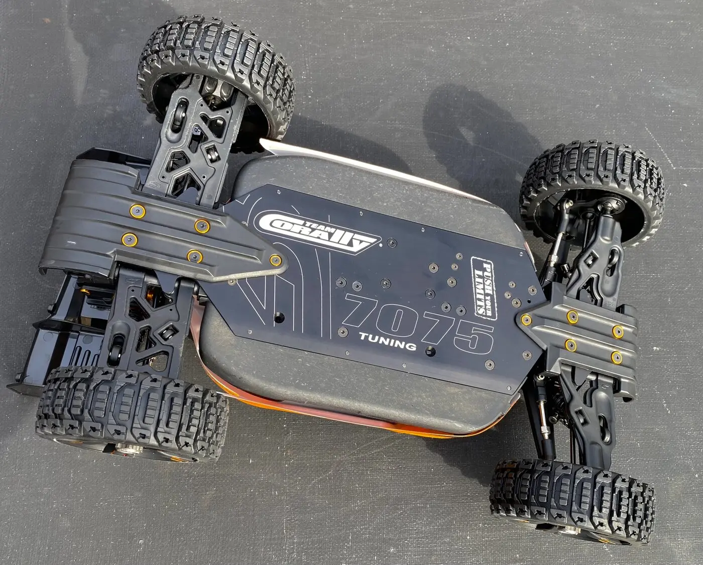

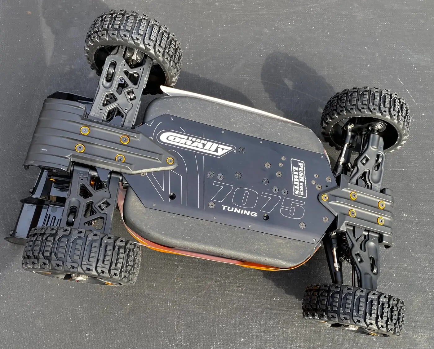

I just finished installing the Kronos XTR front and rear skid plates and bumpers on my Radix6. As soon as the suspension arm shim kit arrives I should be done with the upgrades.
I would try and get the correct bolts and washers for the skid plates, because otherwise the bolts may pull through the plastic 🤔
https://www.corally.com/Car-Parts-T...er-for-M3-Flat-Head-Screws-OD-8mm-Red-10-pcs/
https://www.corally.com/Car-Parts-T...r-for-M4-Flat-Head-Screws-OD-10mm-Red-10-pcs/
They don't have to be red Corally ones, but this is what you need 👍🏼
Finding those metric conical washers at local hardware stores and RC shops here in the US is nearly impossible, and the larger hobby companies that carry a decent selection of Corally parts hardware just don't carry things like these washers. A web search for M4 conical washers turned up absolutely no source for them other than Corally in Europe. I might just wind up using M4 flat washers under the screws I have, if I can find some.
I'm not a big basher, and it's unlikely I would pull the fastener heads through the holes.
I bit the bullet and ordered the correct fasteners and washers from Corally in Europe. What I have now will work until the new parts get here.
The shims for the front upper suspension arms arrived today and I installed them. I had been utilizing a temporary fix to solve the issue of the front suspension arms not fitting properly after installing the aluminum steering deck and new suspension arm mounts, but now the issue has been fixed correctly.
I replaced the stock receiver with one for a Radiolink RC6GS transmitter I already own, so I have one less radio system to worry about. The Radiolink receivers only cost $17.99, and they bind easily in just a couple of seconds.
The last parts I plan on replacing, the aluminum conical washers and the flat head fasteners to attach the skid plates, are due to arrive no later than this Friday.
The conical aluminum washers and correct flathead fasteners for the eight major skid plate attach points came in today from Corally in Belgium, and I installed them. I think Corally felt sorry for me having to spend 21.50 Euros on shipping: they sold all the parts to me at lower prices than the published web prices.
