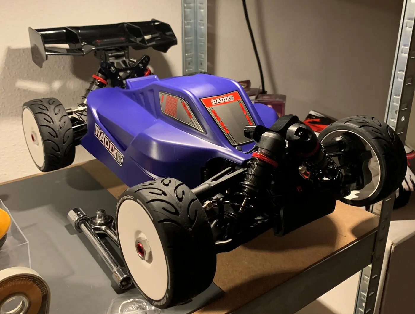

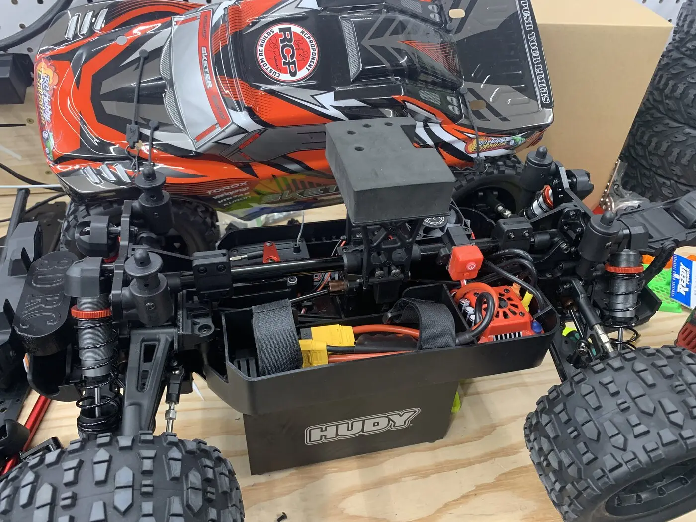

I put the V2 battery tray into the Radix so I could fit my 6S batteries in. I should have taken a picture but used the battery strap loops under the tray to route the ESC cables since they are easier to deal with that the tight, feels like I will pinch my esc wires when installing or removing. wire routing. The body is lifted up when a 6S is installed. I might try to lift the rear body mount some another time if I get ambitious. It really seems like the solution would be to go wider since there is space the outside of the battery tray then you could run my 6S on their sides so the overall height is reduced. It would support dual 3S better too. I did find it interesting that the area for electronics is the same whether short or longer wheelbase. Overall I am not as happy with the TC battery tray's as the Arrma's but they have issues too. It would be nice to have a hybrid of the two or a totally new solution that's better.

Yep, arrma battery trays are better. One of the things I don’t like about the corally’s. But hey there’s pros and cons to everything right.. haha
Smart thinking about the wider tray, maybe the owner is watching and he’ll listen like arrma used to :)

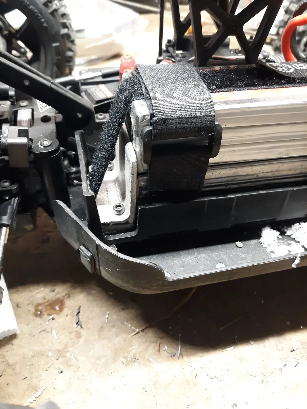

Yeah I have never ran dual 3D on any of my TC rigs because 1) the battery tray front edge is too low. The first battery in most cases is taller, so there is nothing to stop the battery from moving forward on larger impacts. Good thing we don't ever do those ;) 2)There isn't any lengthwise battery straps either so that can't take up the slack. Bashers tend to run larger batteries and then have bad landings...
My next rant would be on the lack of room in the Receiver box and no real weather proofing type seals. If you had a larger receiver it wouldn't fit.

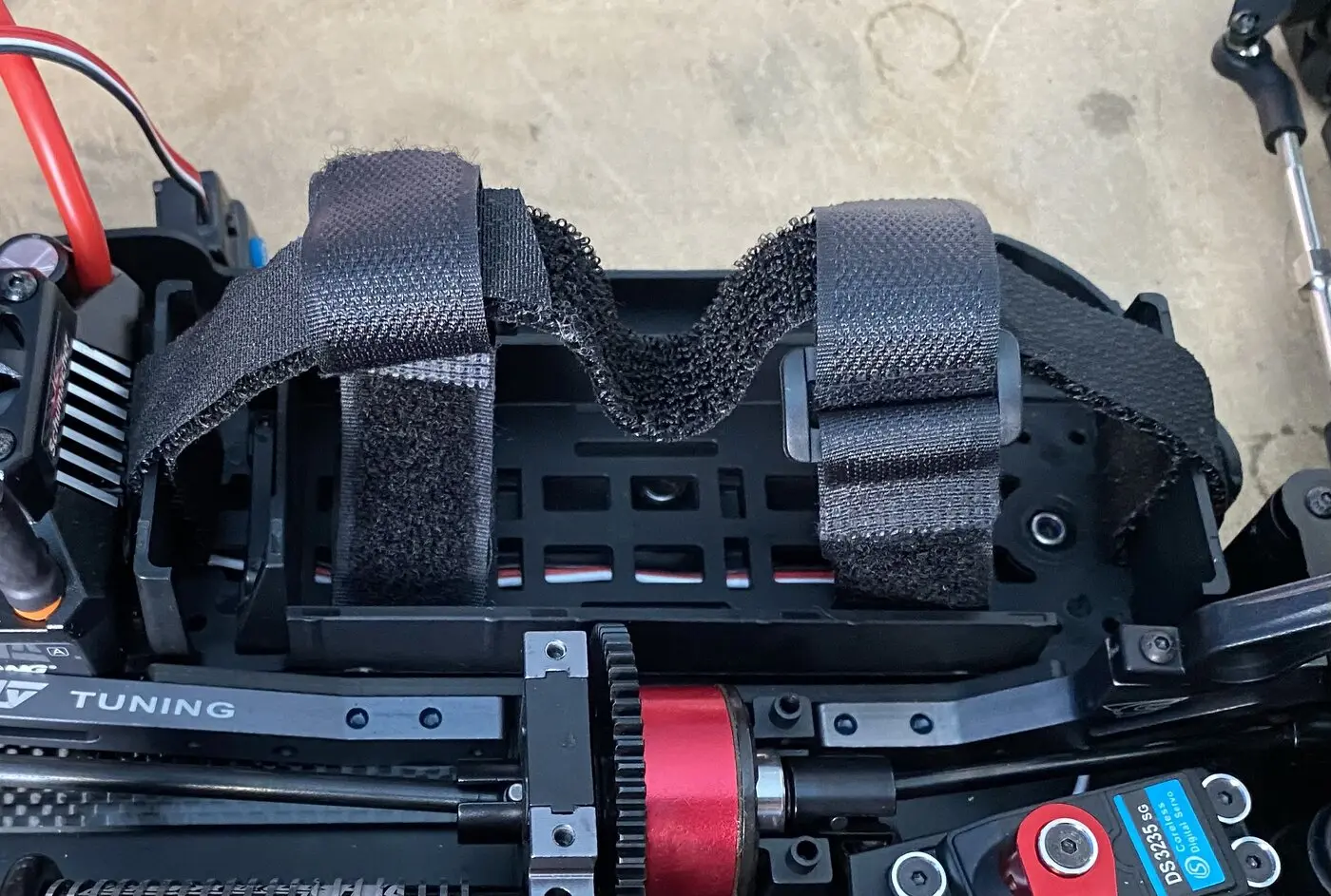

I modded the TC tray with a backstop made from aluminum angle and added a strap lengthwise. I'll get a pic next time I'm out in the man cave. It "should hold", I'm hoping. I still prefer Arrmas tray over the TC. +1 on the receiver box, it's okay for my el cheapo flysky receiver but small.

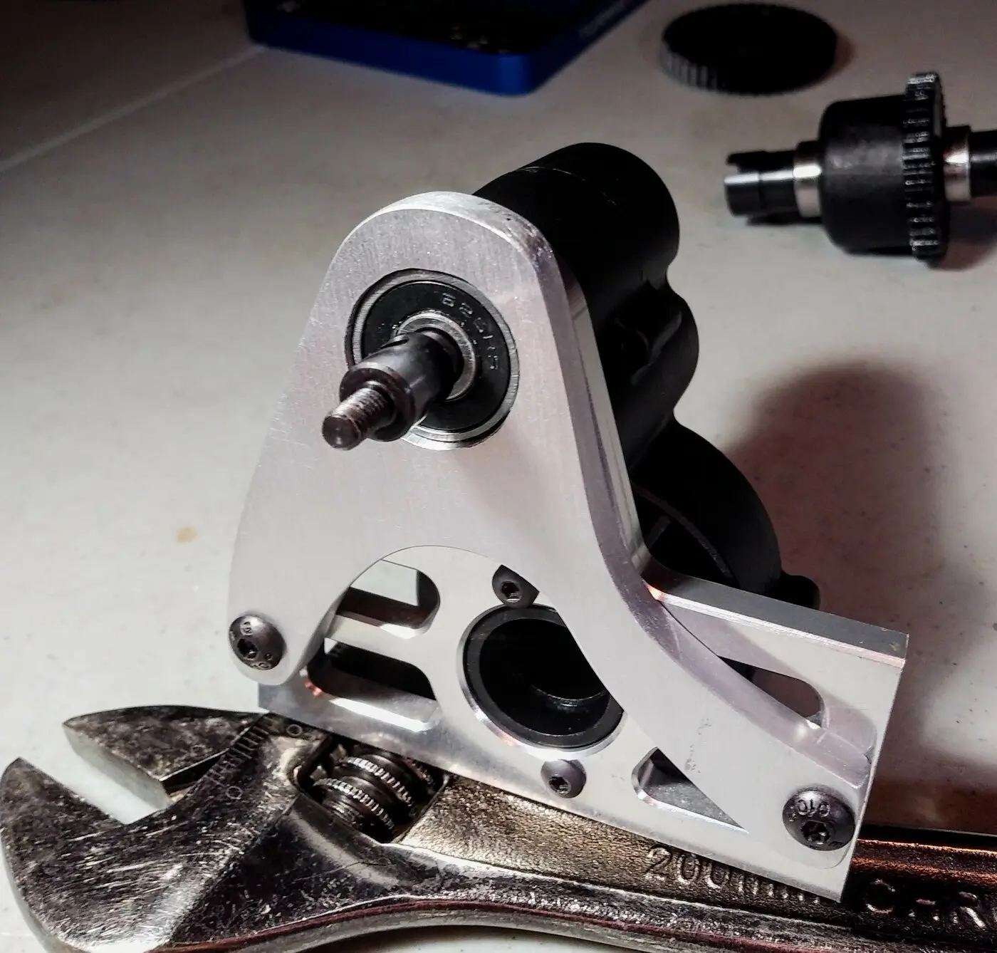

Nice thingy ma jiggery mate 👍🏼
Thanks.
It looks deceptively simple but when you don't have so much as a drill press it's harder than it looks. I'm truly surprised I got it right on my first go.

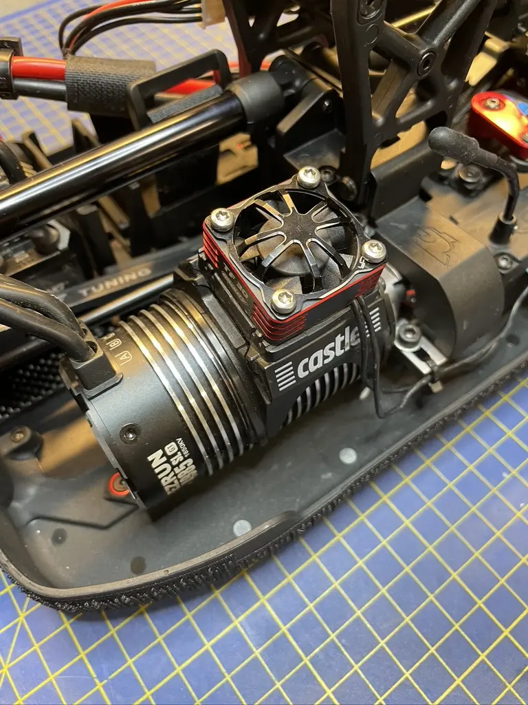

Motor and Servo fitted to the Hyper 8 SC 👍
ESC arrives tomorrow

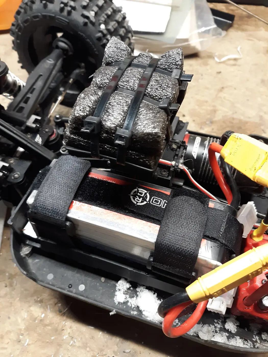

So I cobble cobblepotted my xtr battery tray with a "backstop " so I can run 2-3s packs. I don't currently own any 6s bricks.. not sure I'm comfortable with this tho.. Needs longer straps at least but still weary about the top battery getting ejected? May just run a 2 and 3s for now with the 2s on the bottom. I find 5s to be plenty exciting.

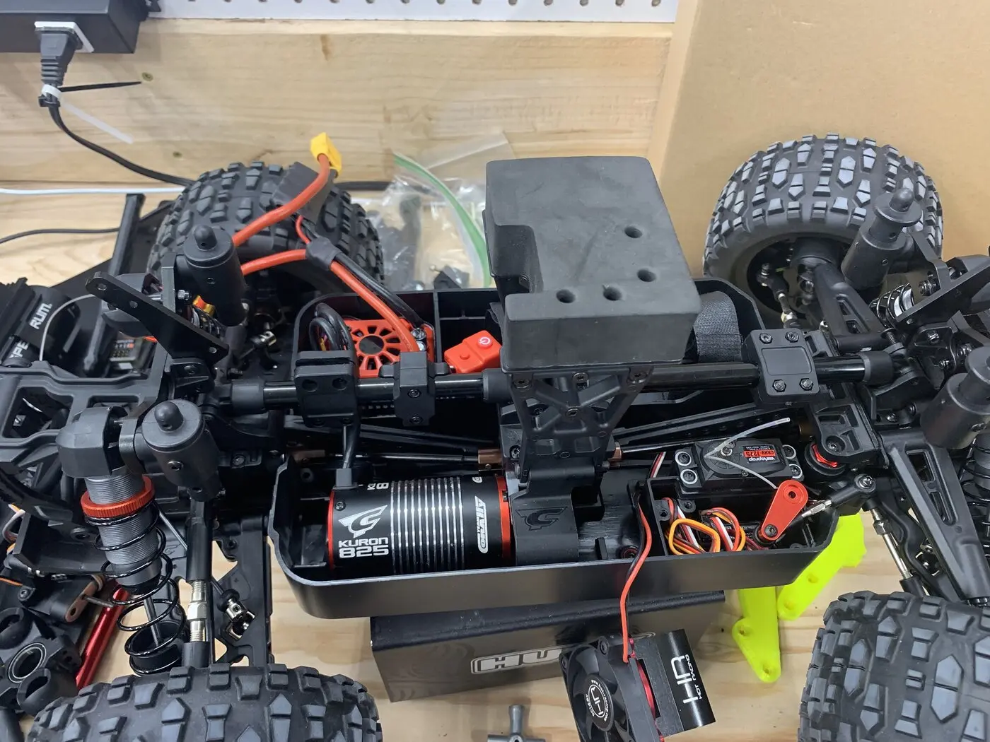

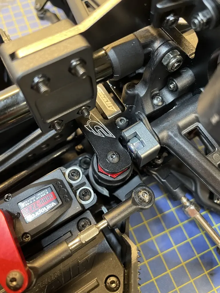

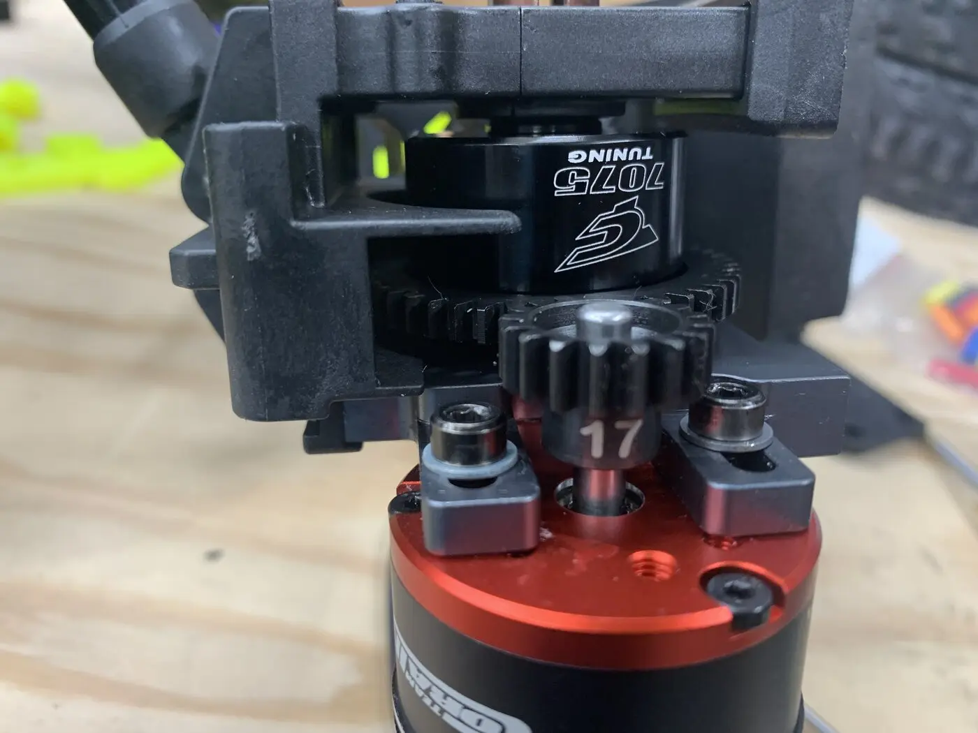

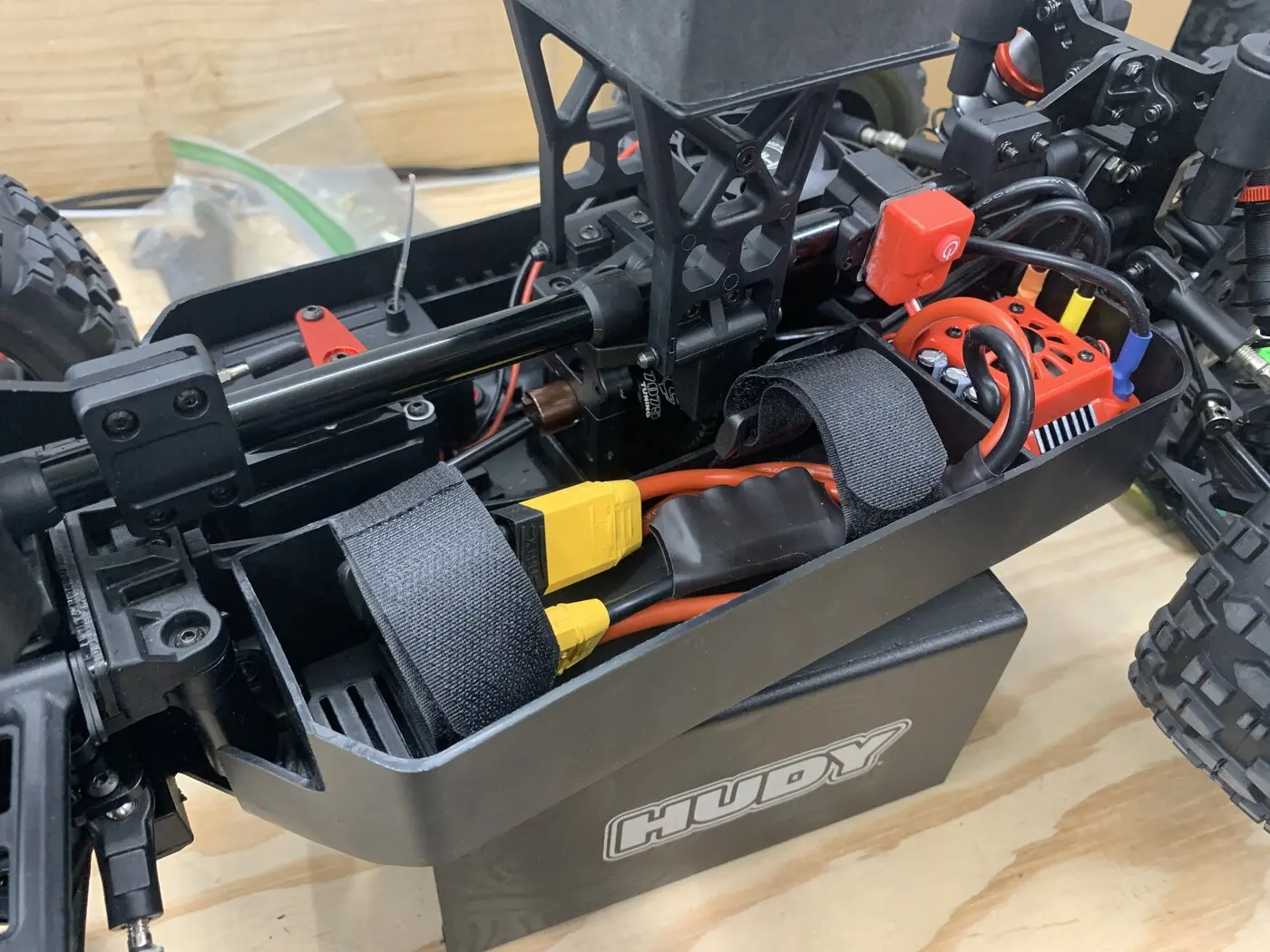

Very early this morning, I worked on my sketer.. haven’t even driven it yet and I’ve already done this….
Tekno 17T pinion
7075 center diff case/carrier 500k fluid
46T spur

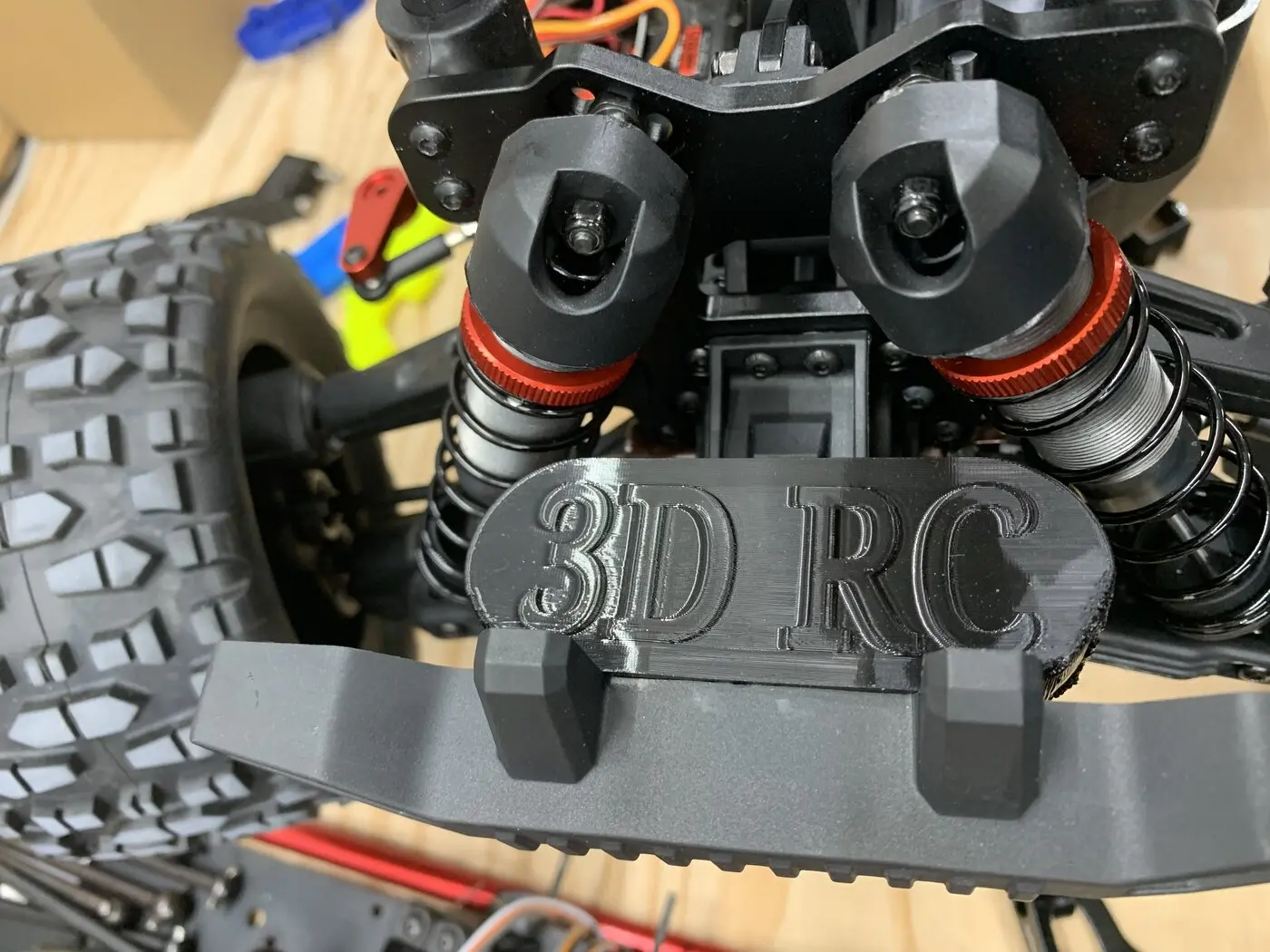

@3D-RC.online bumper support

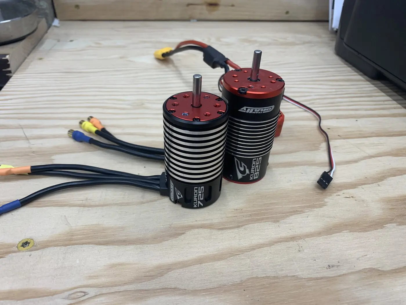

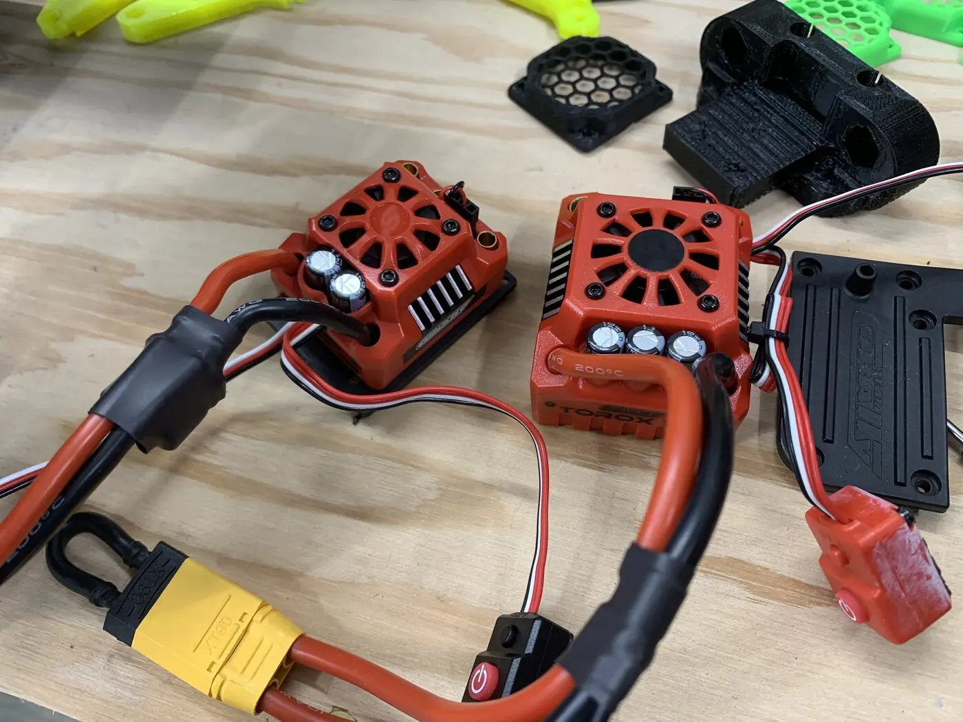

Torox 185 and Kuron 825 swap (100% direct fit) Aside from the esc switch mount… you’ll need the one off the Kronos..
And here’s a sneak peak at @3D-RC.online ’s newest prototype that im hoping to test this weekend 🤞🏻
this bumper support/spring/thingy whatever you wanna call it is beef cake. In true @3D-RC.online fashion of course…
