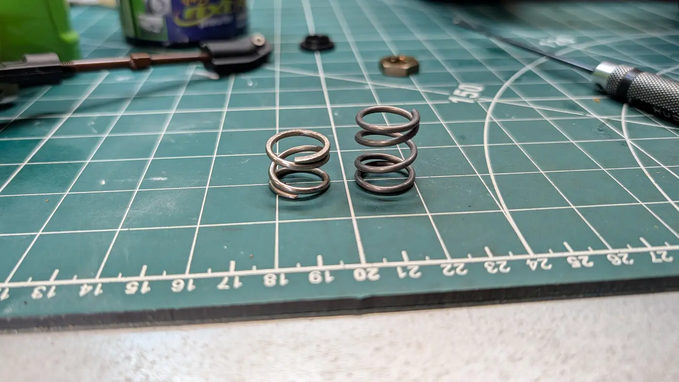

Hi, the spring from AliExpress finally arrived. I have a question: when you installed it, did you preload the spring to the max or not?

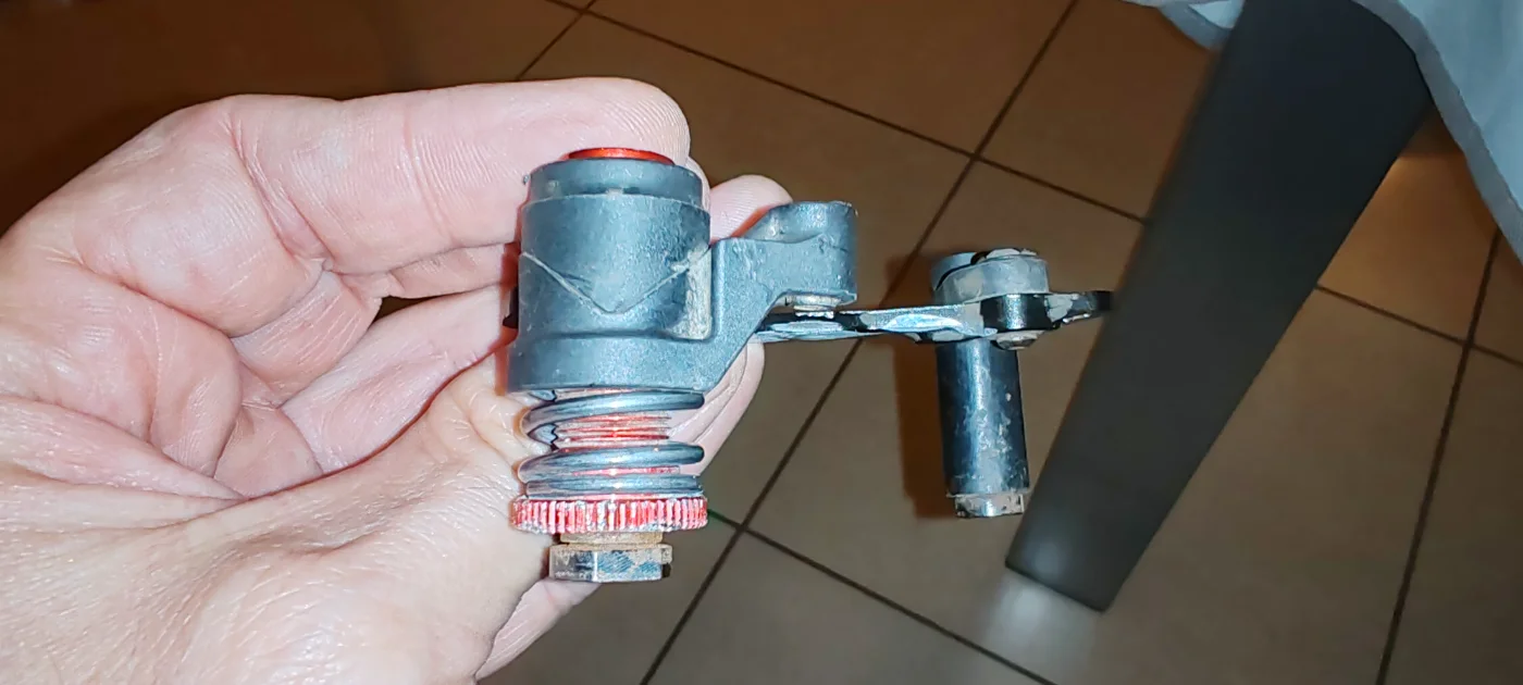

No! Preload it some. Be careful not to cross thread the preload collar. You have to press the spring down while you get it to tighten. Leave 2 or 3 threads visible.
Like this. 👆

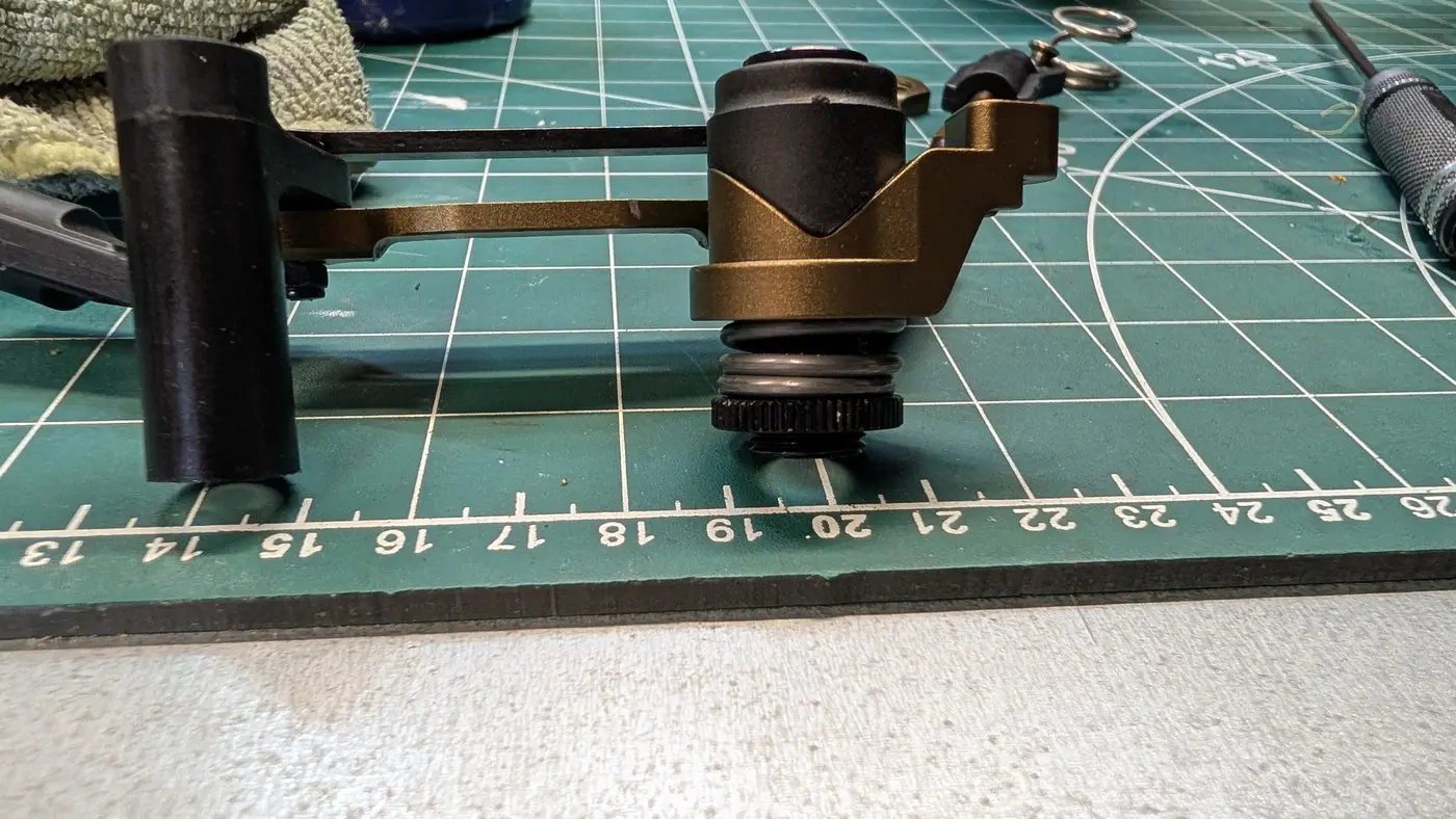

Not the max but did tighten it up quite a bit left enough for the spring to compress a bit.
