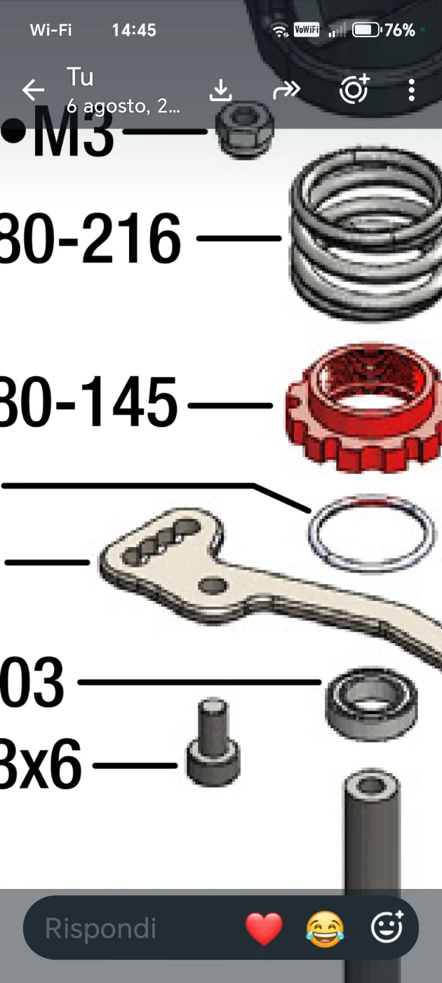

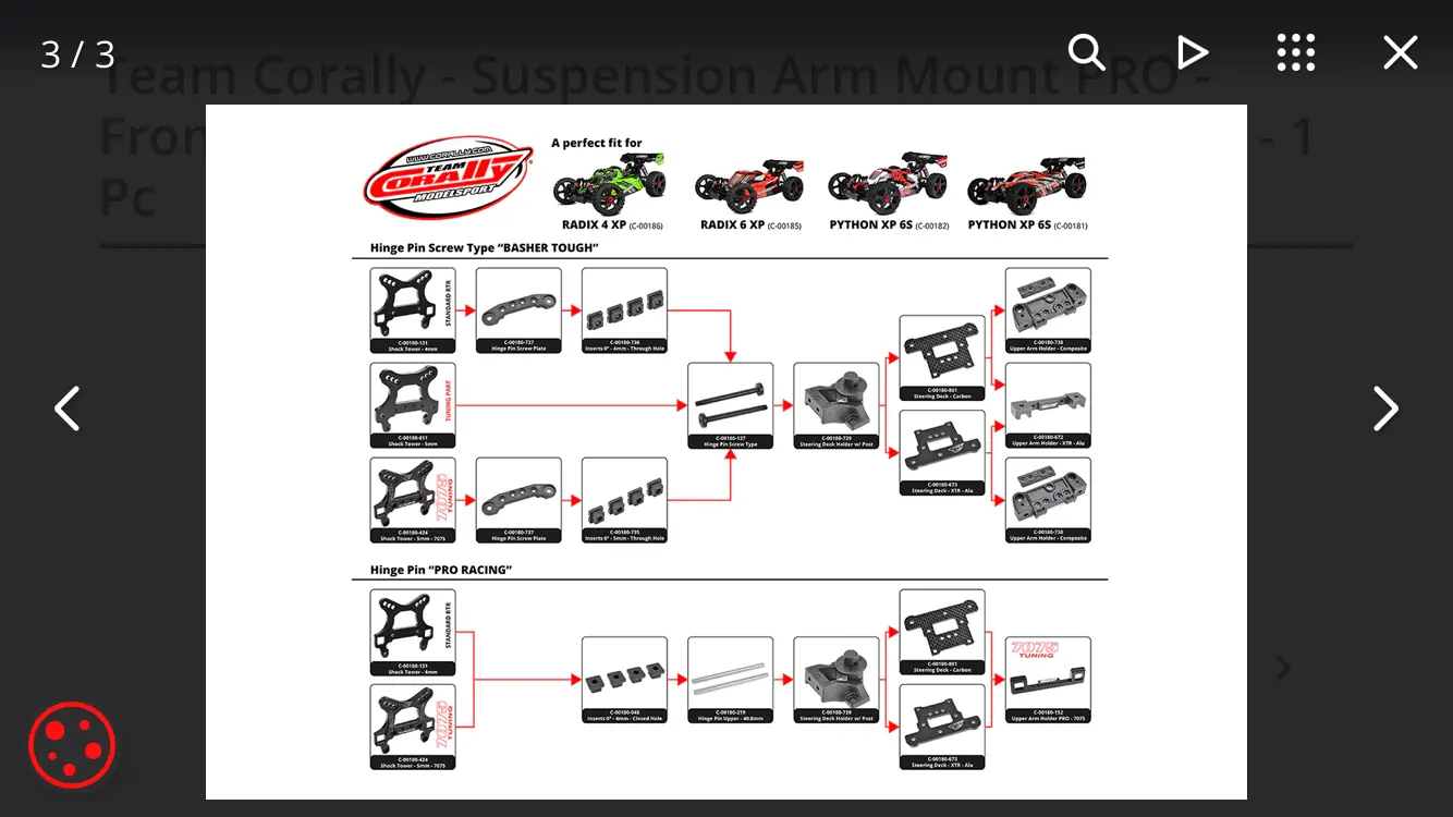

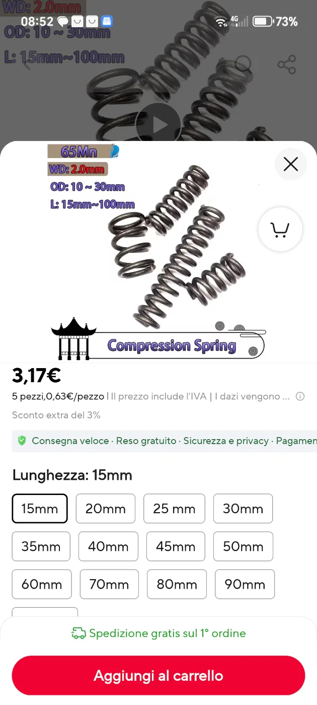

Hi, are any of you trying to adjust the Ackermann plate by moving the tie rod balls and re-threading them into the last available hole at the bottom to get better steering? I've written in the past about my Shogun turning very wide. Horatio, whom I thank, has always recommended installing the Lee spring, but unfortunately I haven't been able to find one (I live in Italy and haven't found anyone to share the purchase with). So, by asking the AI, among the various solutions, he also recommended adjusting the Ackermann plate. He also recommended setting the toe out to 1° or 2° and the camber to -1° or -2°.
