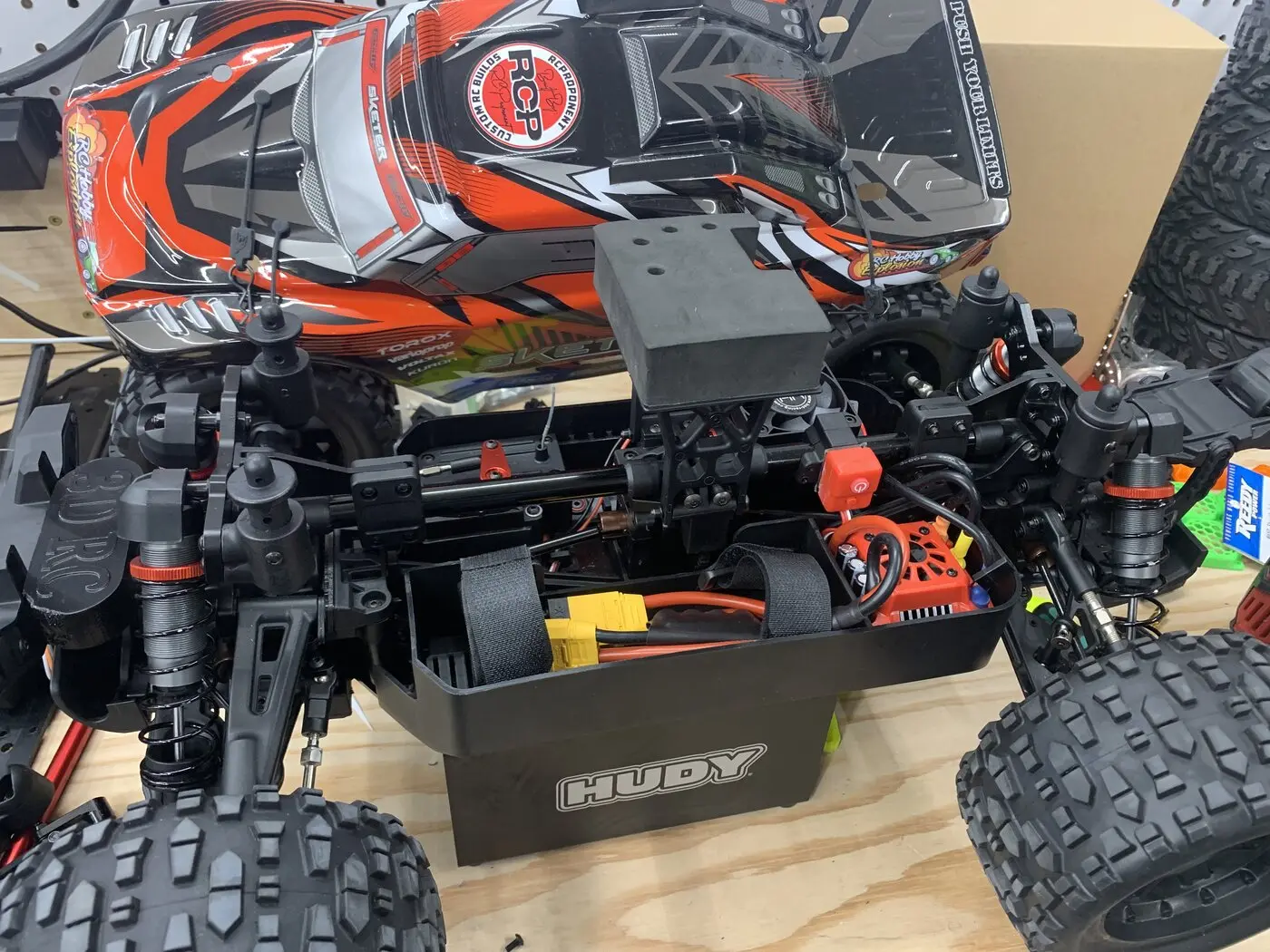

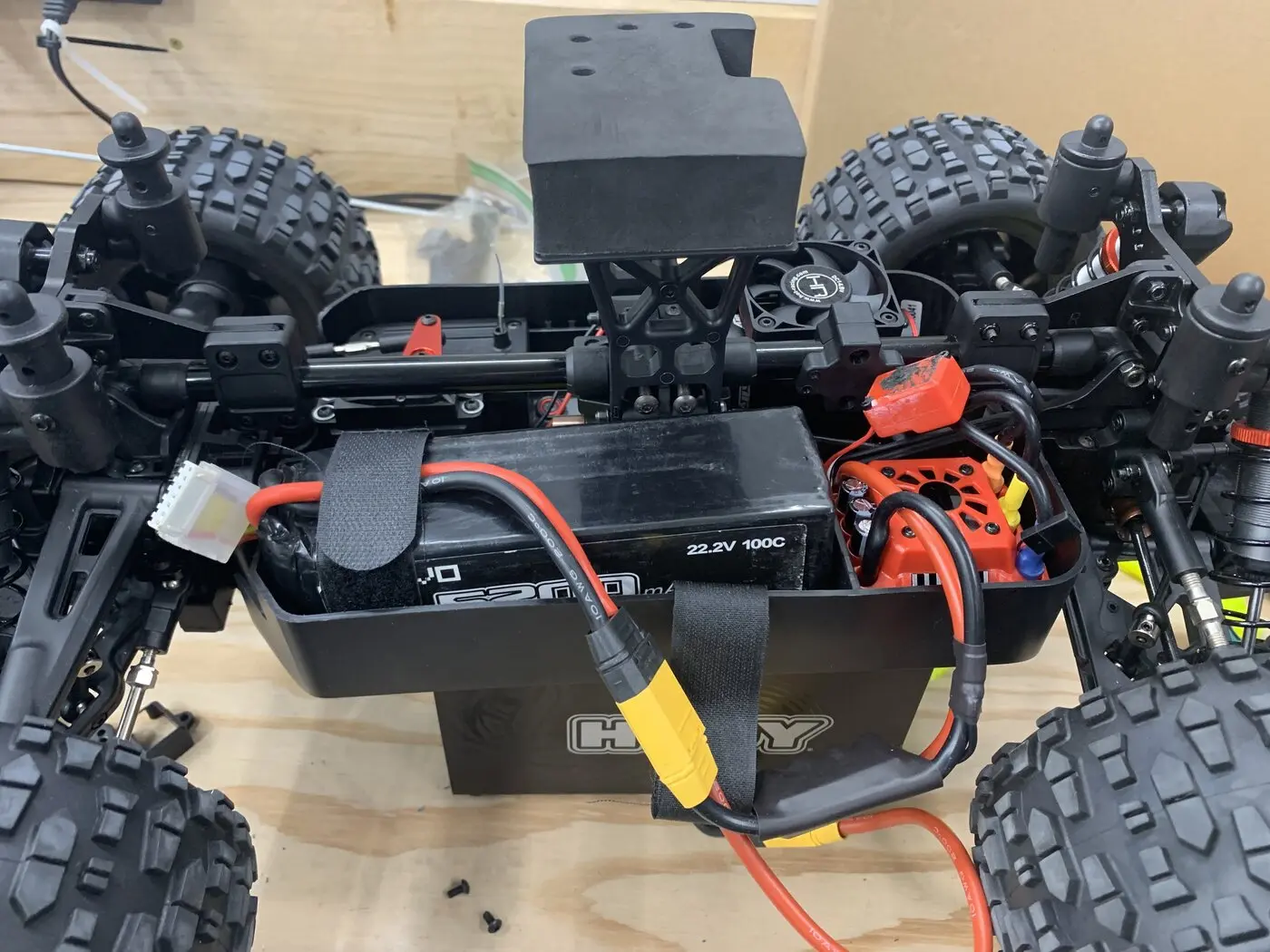

Get some pics up so I can see how it all fits ;) then I can start soldering up my electronics ahead of mine arriving :LOL::ROFLMAO:

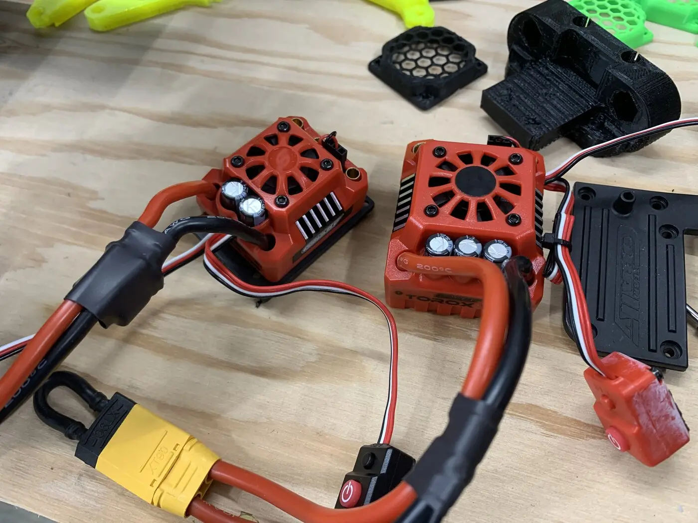

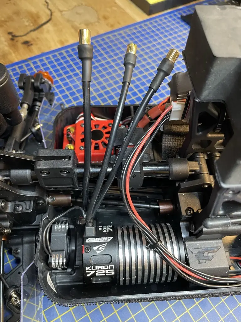

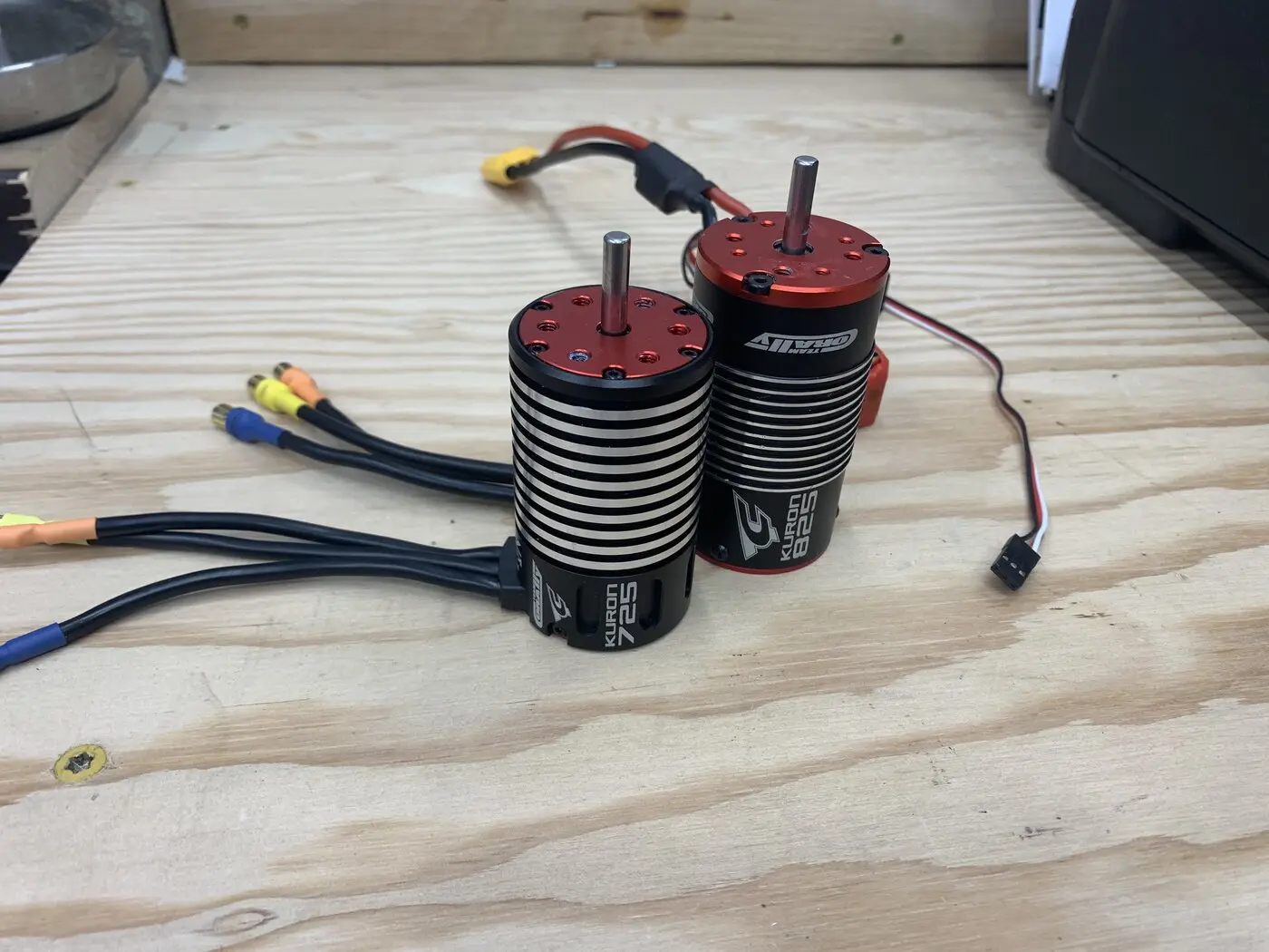

It literally was made to go in… the whole changeover took about 15 min (esc only) I haven’t decided if I’m going to keep the Kuron 725 or change it to the 825.. I’m in the process now so it’s time to choose lol
Agreed ☝️☝️☝️ running the 725 with the 185 torox would be like putting a 4 barrel Holley on a v6..
But then again, TP parts xtreme runs a stock maxx(and hoss) motor on 6s soo...?

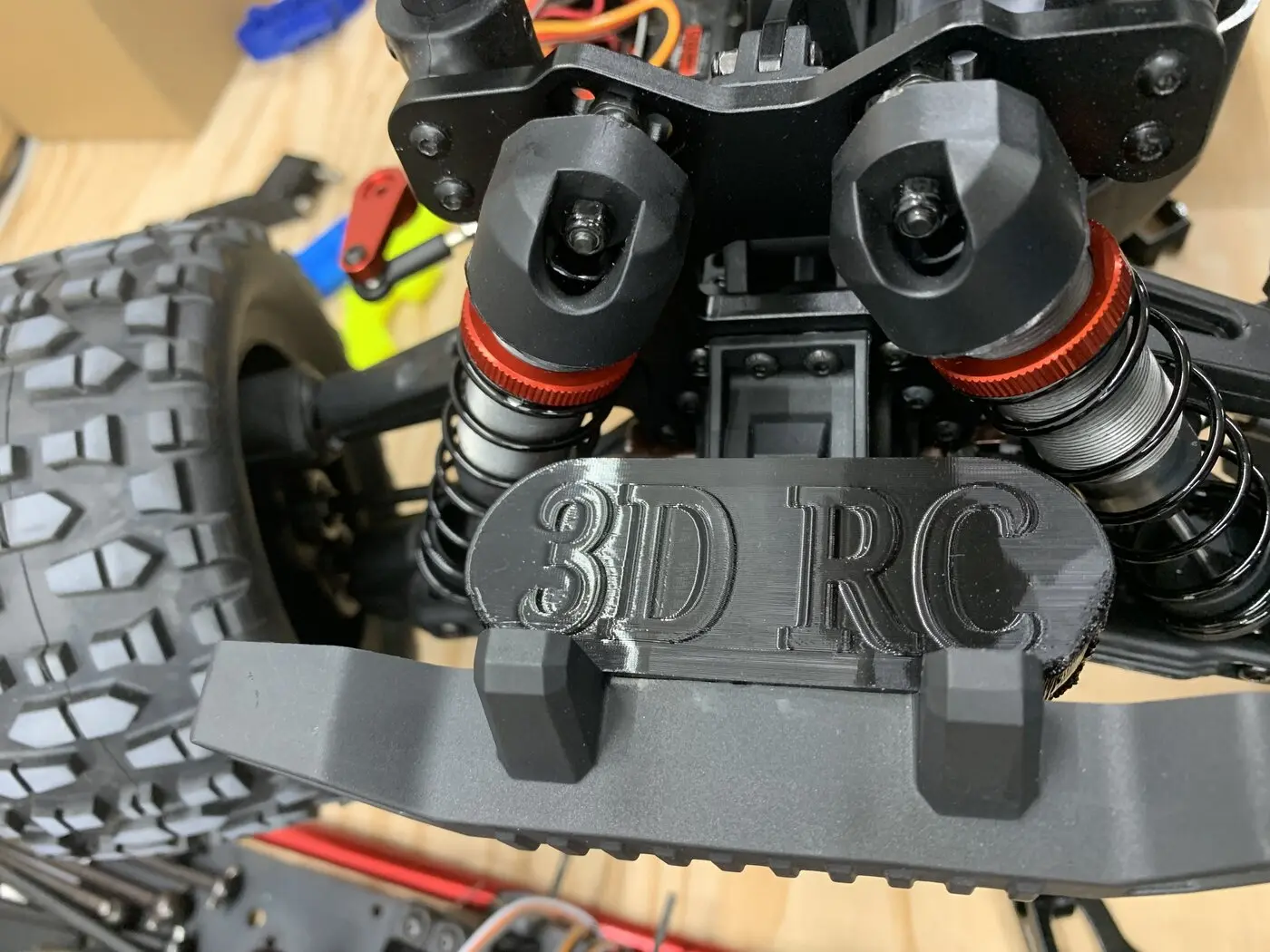

a sneak peak at @3D-RC.online ’s newest prototype that im hoping to test this weekend
this bumper supper/spring/thingy whatever you wanna call it is beef cake. In true @3D-RC.online fashion of course…

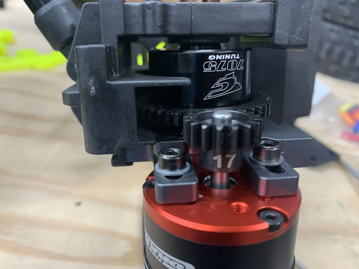

Tekno 17T pinion

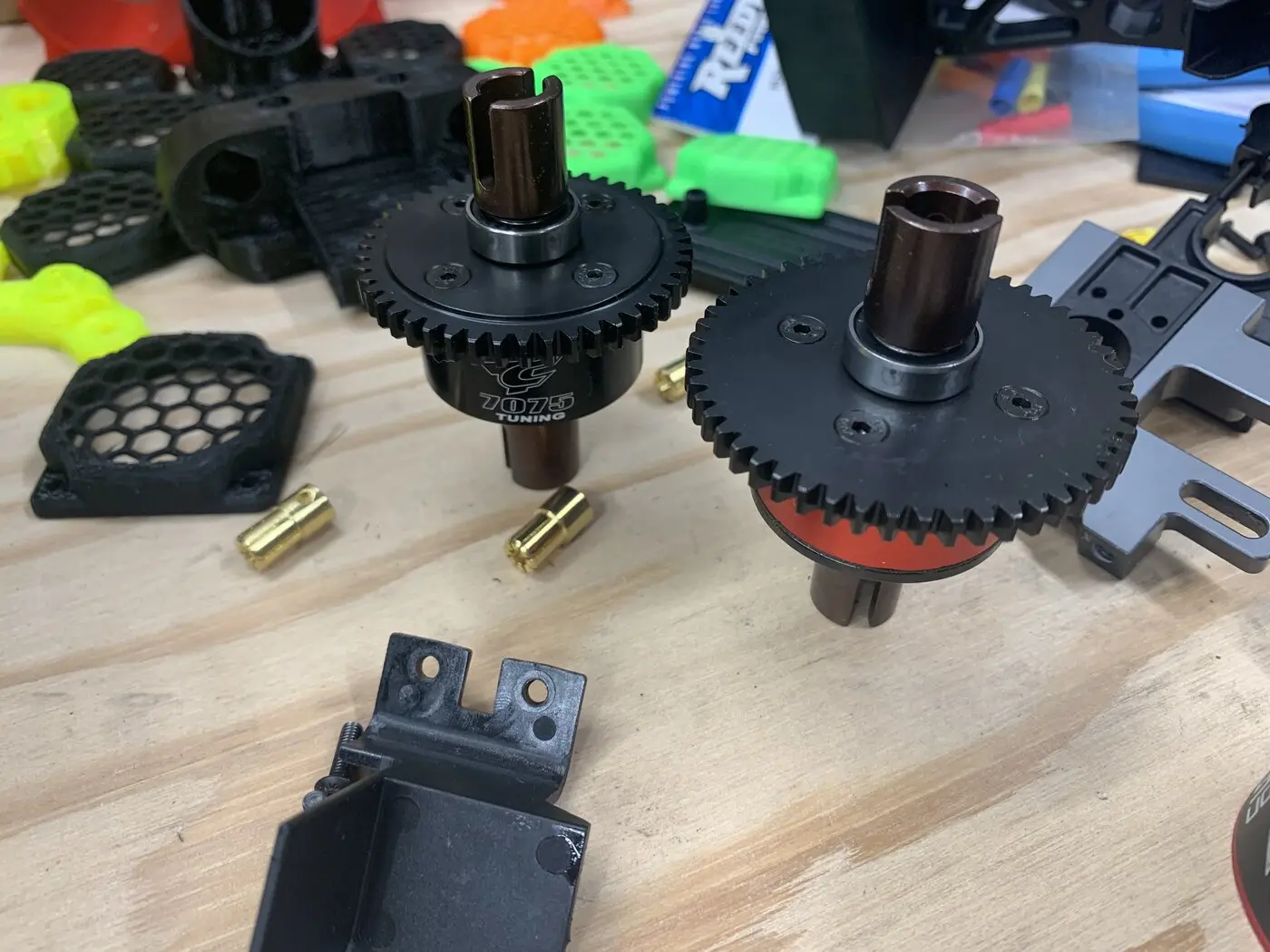

7075 center diff case/carrier 500k fluid
46T spur
@3D-RC.online bumper support

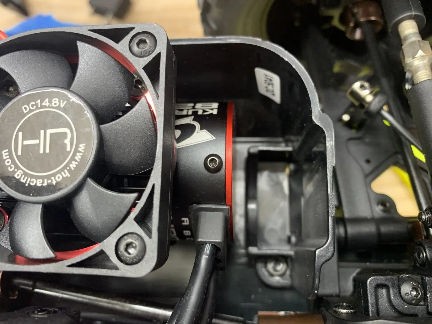

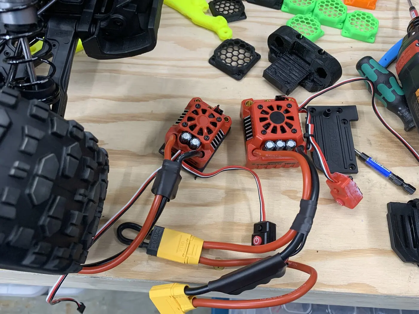

Torox 185 and Kuron 825 swap (100% direct fit) Aside from the esc switch mount… you’ll need the one off the Kronos..
