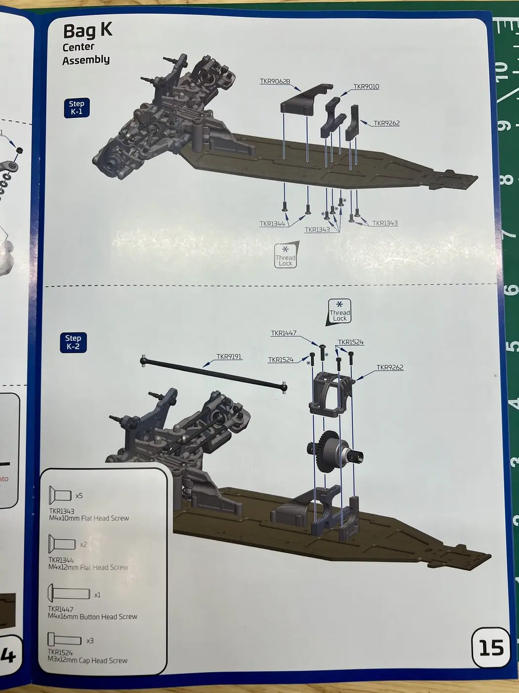

Day 4

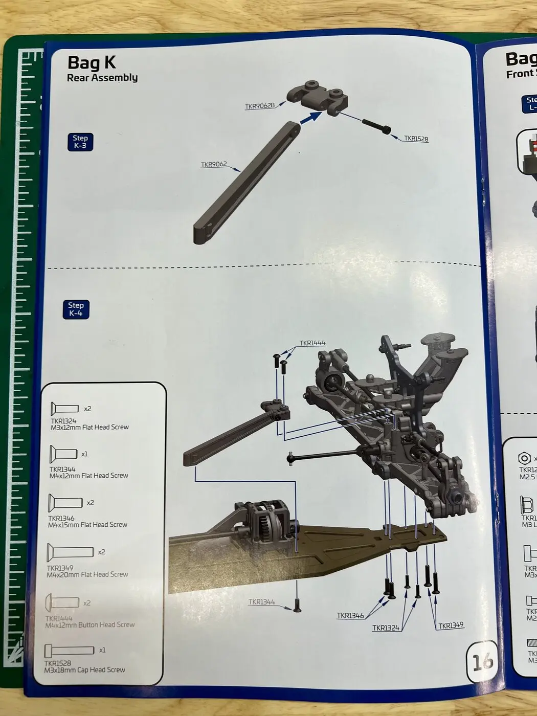

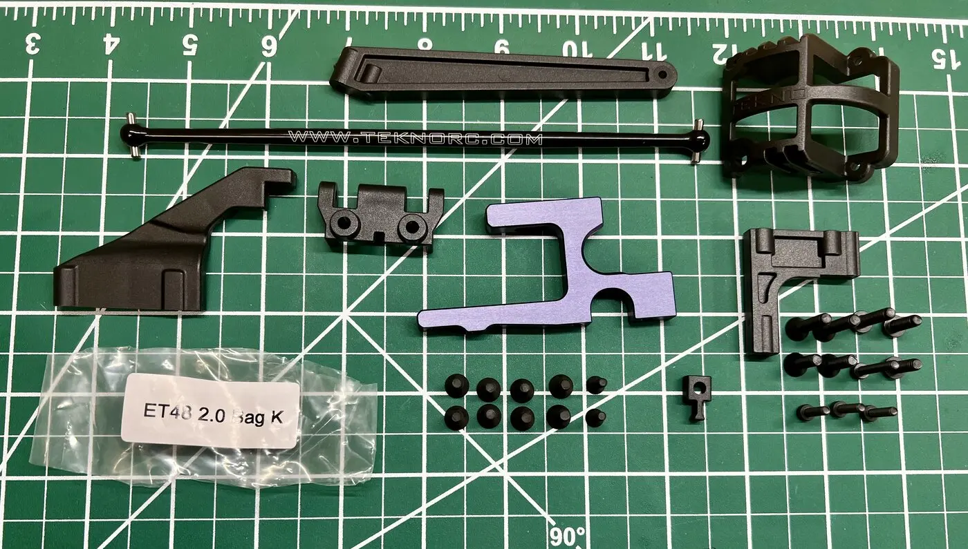

Bag: K Center Assembly
There wasn’t much to comment on with Bag K. It’s the center assembly and it went just as it should.
Bag K: Rear Assembly (yes they are both bag K)
Again, not much to say.

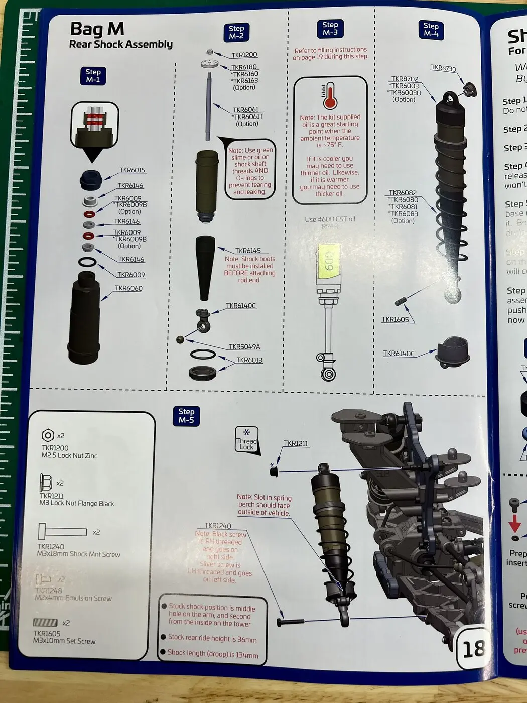

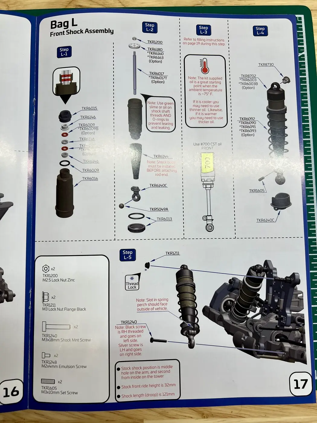

Next up Bags L and M, Shock Assembly!!!

Day 4

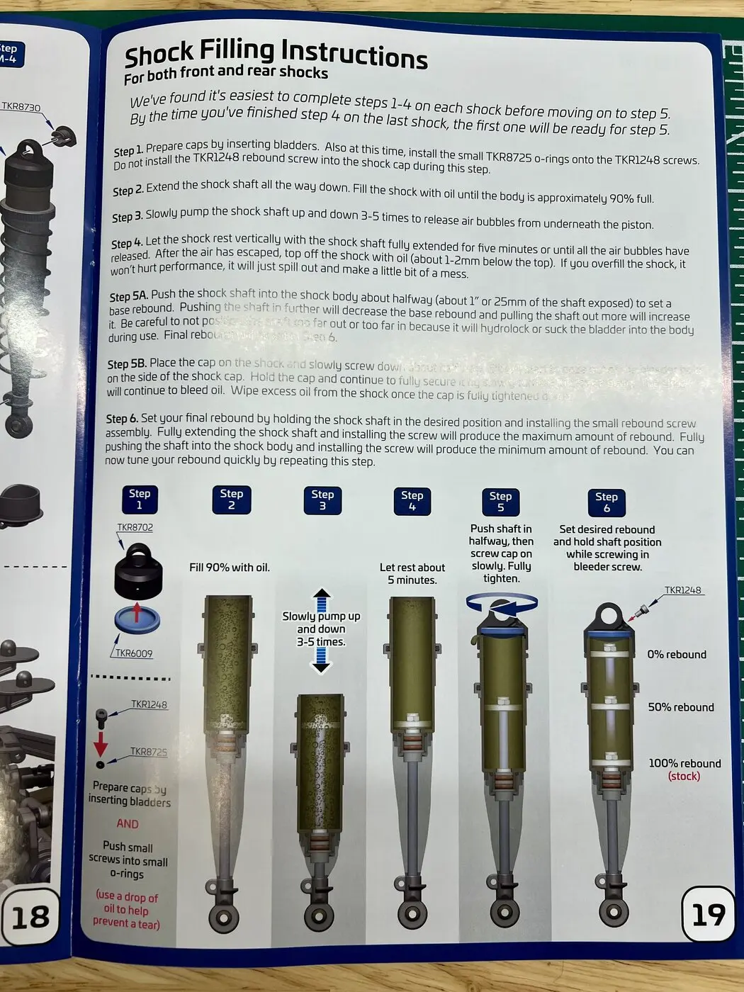

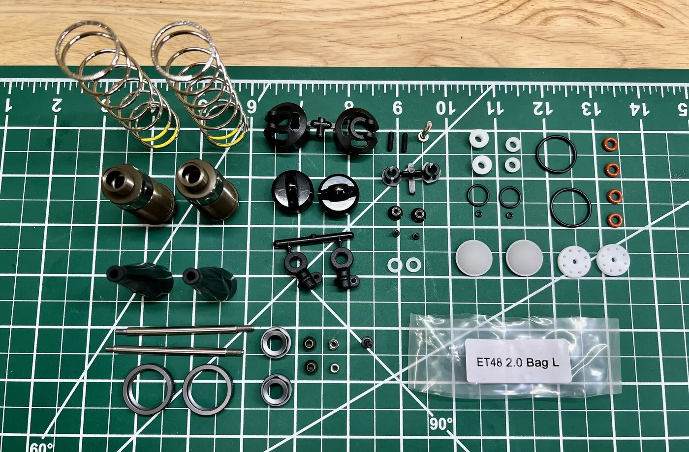

Bag L: Front Shock Assembly
Bag M: Rear Shock Assembly
Front
Rear
Nice fill level instructions! Again, important bits are highlighted!

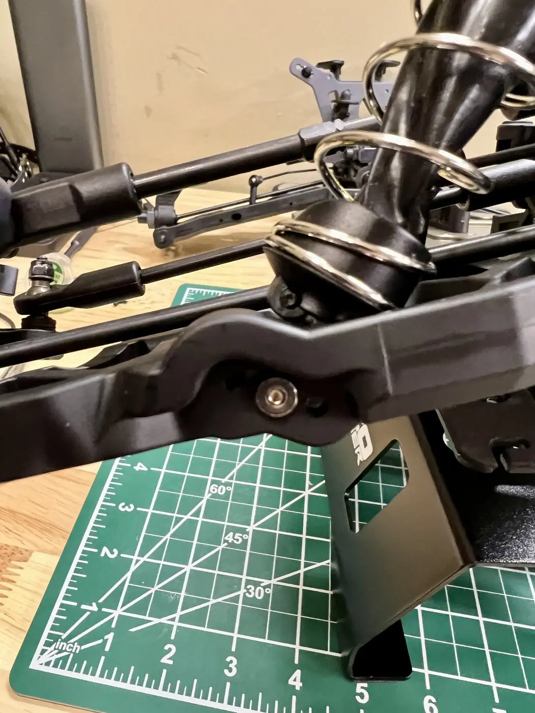

Big, Beefy parts! Quality has been superb the entire build.

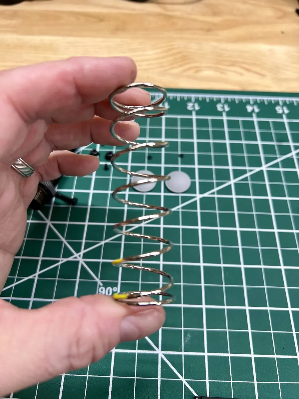

Tough Springs!
Big Bodies!

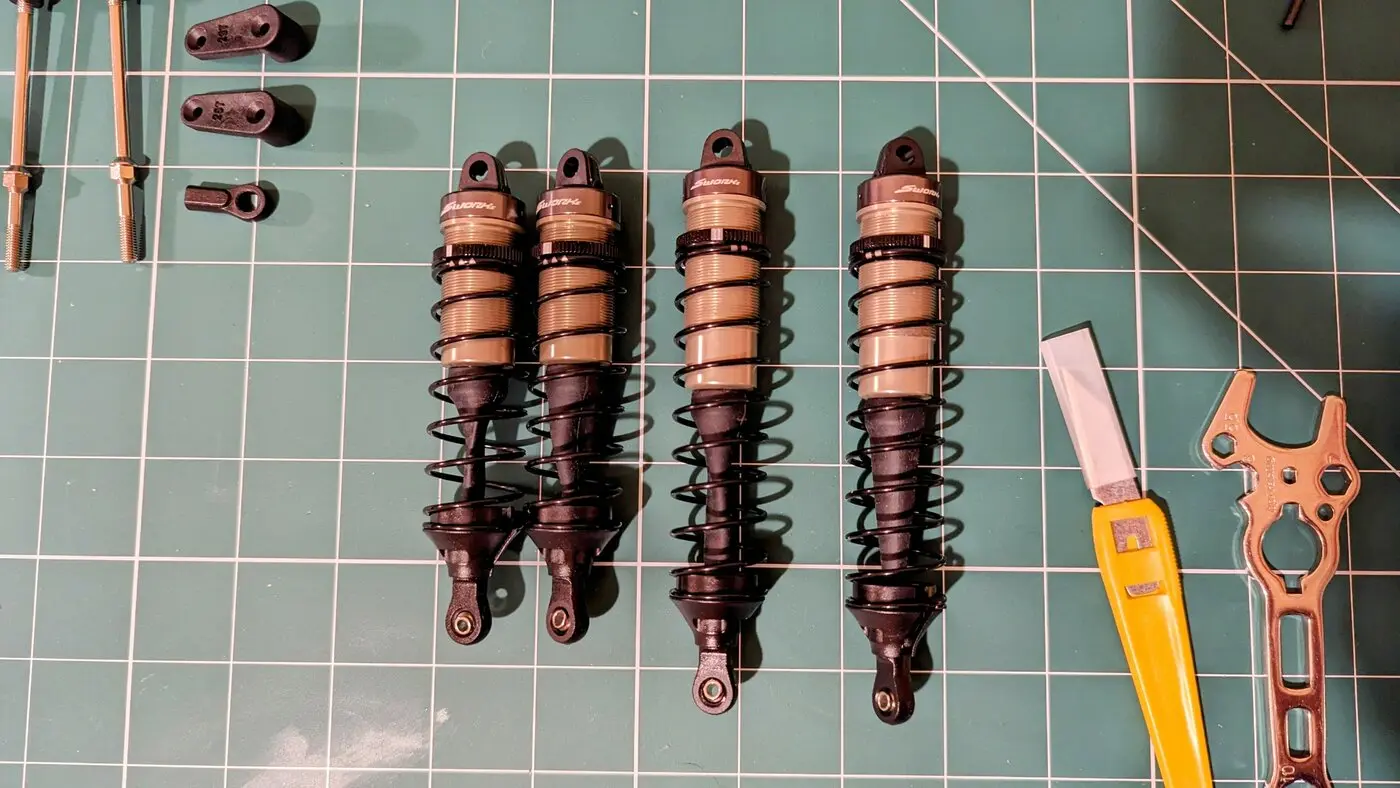

Nice shocks! Lots of travel!

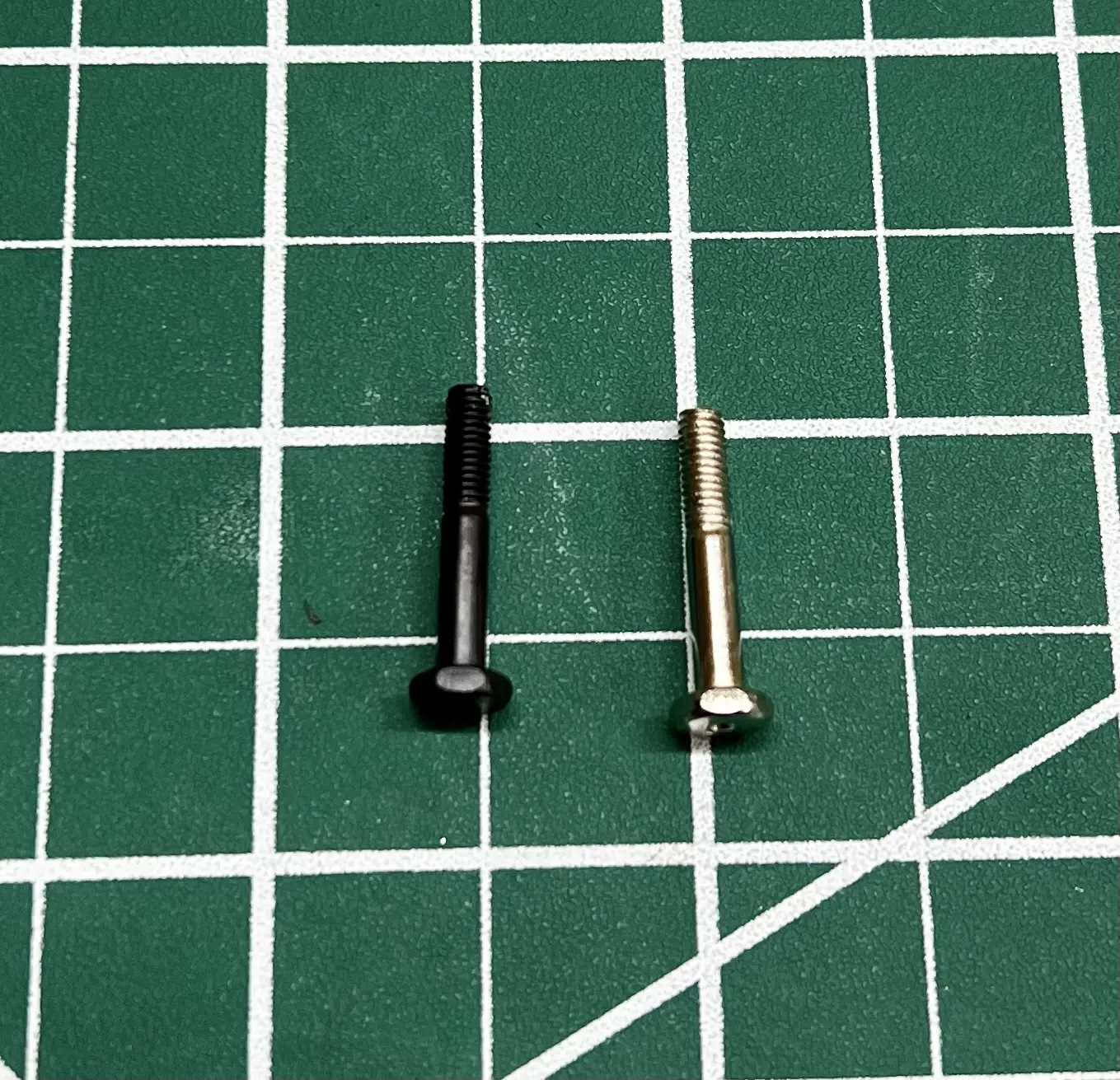

Two different color Lower Shock Mount Screws. 1 is cw, the other is ccw. Easy to keep straight!

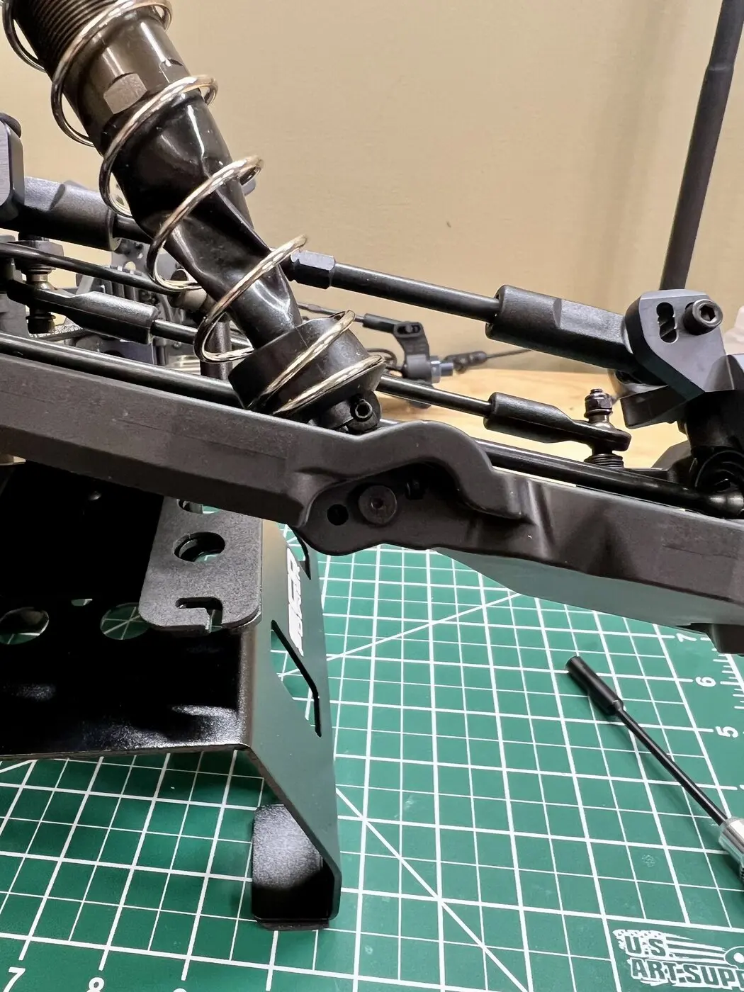

Starting to look Mean! 😈😈😈😈
Tough Springs!
Big Bodies!

Those shocks are nearly identical in design to Sworkz. 🤩😍
I wouldn't be surprised they get made at the same plant. 🤣
The stance and stamp of the ET48 2.0 is very purposeful looking with those 'proper' long shocks. Whilst the styling is 'understated' - the quality shines through. 💪🤩
