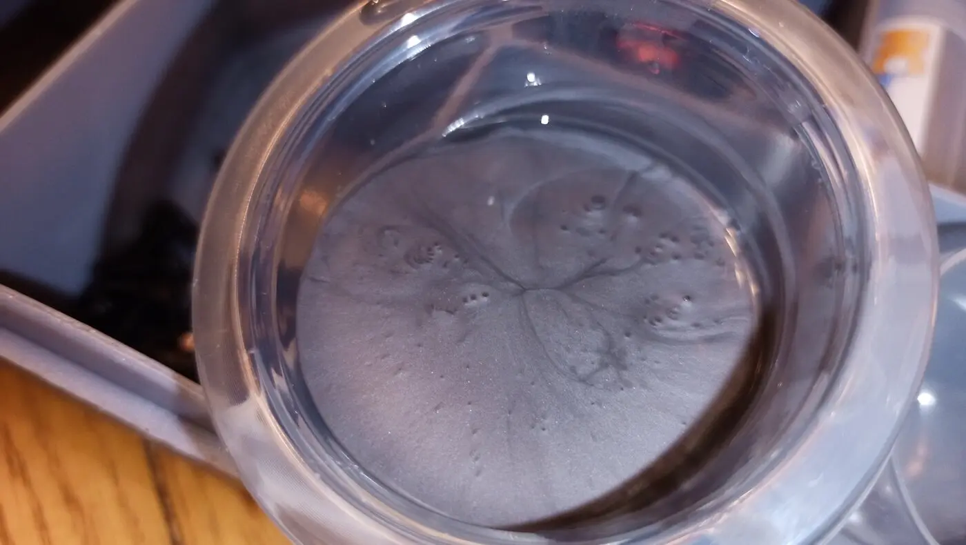

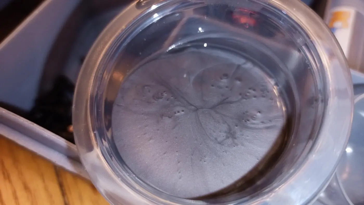

Looks delicious!Time to change and refresh. I've had a year of just topping up oils if needed, but as I've gone for a heavier 1000wt, time to drain and clean.
Looks a lot, but it's only about 30ml to refill all 4 shocks.

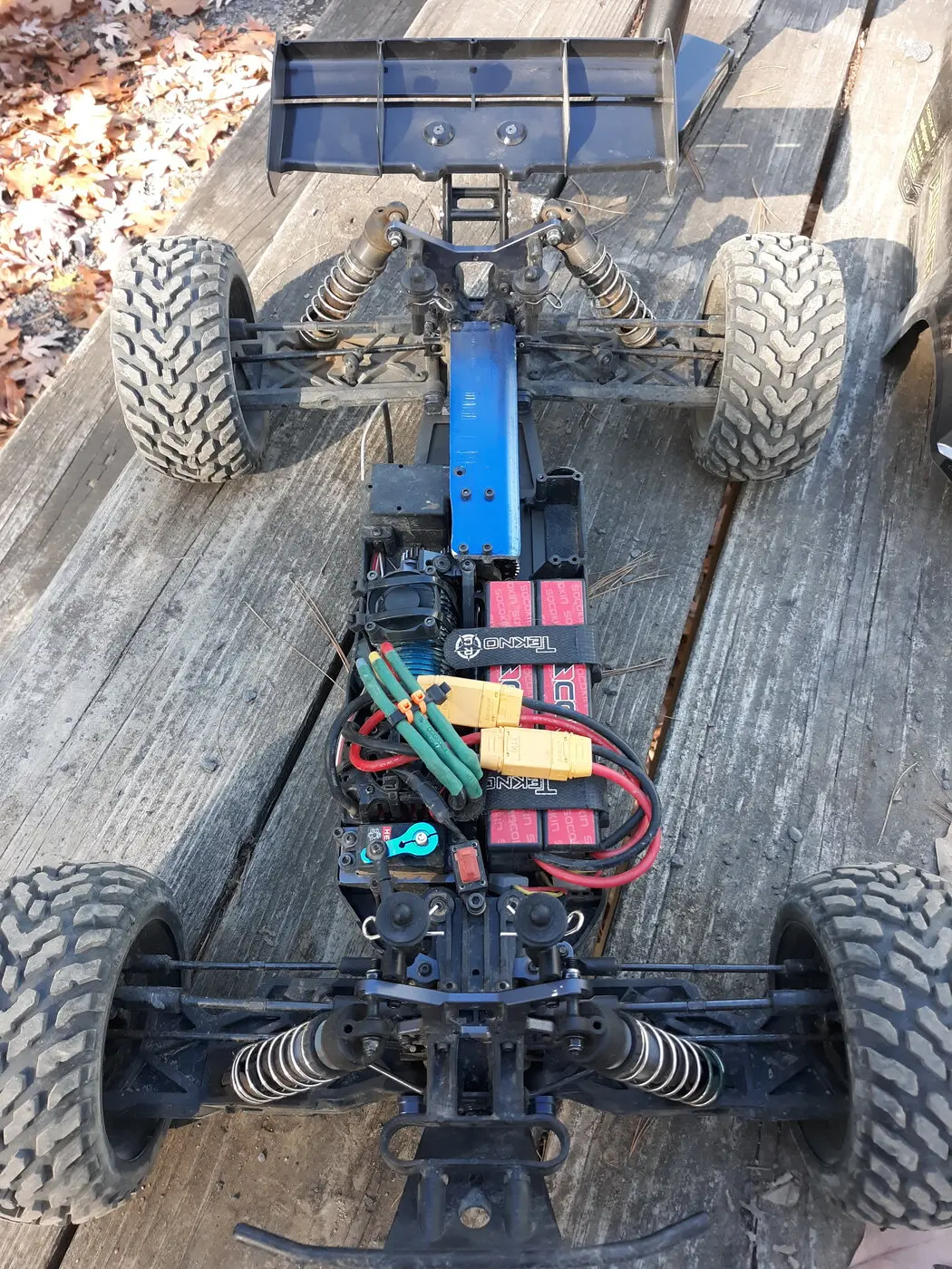

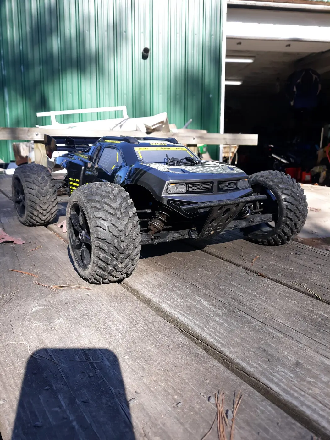

I converted my MT410 to ET48. I just wanted something that would handle better. That it does, no ragrets there! Also have an SCT410.3 that I think should be a buggy instead. That'll take more funds to do though..Hrmm...I just redid the shock oil in my Python, Kronos, Shogun and EB48.3. The Python oil was scary. Almost as red as the dirt I run on. The EB48.3 was pretty dirty as well, but that oil has been in there for over a year.
Now I have a ET48.3 that's gonna need some shock work. I also have an MT410 that I was supposed to convert into a ET48.3, but I'm still debating on whether or not to do the conversion or just break it down into a 500+ dollar pile of parts. Either which way I go, I'll have those shocks and diffs that I'll need to work on as well.
Hey KA,Looks delicious!

I took the minimalist approach. Which only requires ET48.3 chassis,rear driveshaft, rear chassis brace. Around $125 worth of parts IIRC. There may be differences in front C hubs, shocks that I'm not sure of. I use it way more as an ET than I did as an MT. I like track style rigs vs freestyle.Hey KA,
How hard was the 410 conversion? I can get a slightly used 410 for a great price from a local guy, but I was already planning on ordering a new et48.2 now you have made me stop and think for a minute. Your far familiar with Tekno than I am so I figured that you would have an opinion.

It's my best handling rig. Really impressed with it. I have no actual racing experience or race rigs.That’s awesome! It almost looks like that’s the way it should’ve been designed to begin with! Very nice! I bet it handles like a champ as well!
Started out with a BLX185 combo when I built it. Then TC 6s combo, now TC esc and Tenshock 2200kv motor. It's pretty fast on 4s, 18t pinion.
Was gonna say the same about the MT410. Not dissing the new one, just much different from the previous version.
Get it before they're gone.. one thing I like about my converted ET48 is knowing how quick and easy it is to convert back to MT410. Same for the SCT410 to EB48SL..That’s kinda what I figured. I like to Frankenstein things up a bit as well so it might be a fun conversion. I don’t ever see Tekno prices change much anymore so I’m assuming I can pick up another et48 at any point for roughly its current price but I can get the 410 for a really good price. It’s honestly not the $$$, as much as I like wrenching so I may go that route.
