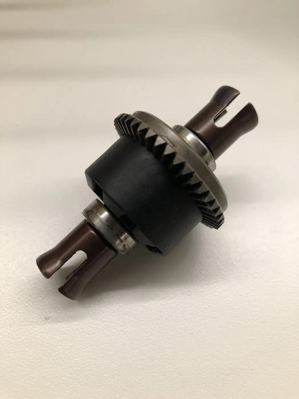

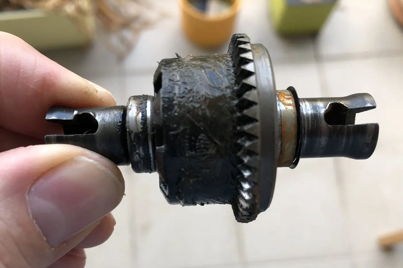

Nice. I'm gonna fix mine tonight. In the meantime I'm running my talion.... thing's a beast! But can't wait to get the sketer back in tip top shape. The diffs seem to be really simple on the sketer which I liketook my rear diff out today:
WARNING! Not for those of sensitive nature!
the damage in all it's pride and glory!
No new bearings? I would have for a couple bucks. Hopefully you won't have to disassemble again anytime soon.mucho mejor / viel besser / plus bien!
Very true. I'm fool enough to be running one each of 7 different makes of rigsThey were still ok, I'll gonna change them with the next diff-fluid-service…
But, you are right, I've seen better bearings on other models. Apart from that I really do appreciate, that TC only uses one type of bearings. On a Axial RR10 you have 5 different ones (I think)
Did you put the shim back on the gear side? Looks like not on their from this pic?mucho mejor / viel besser / plus bien!

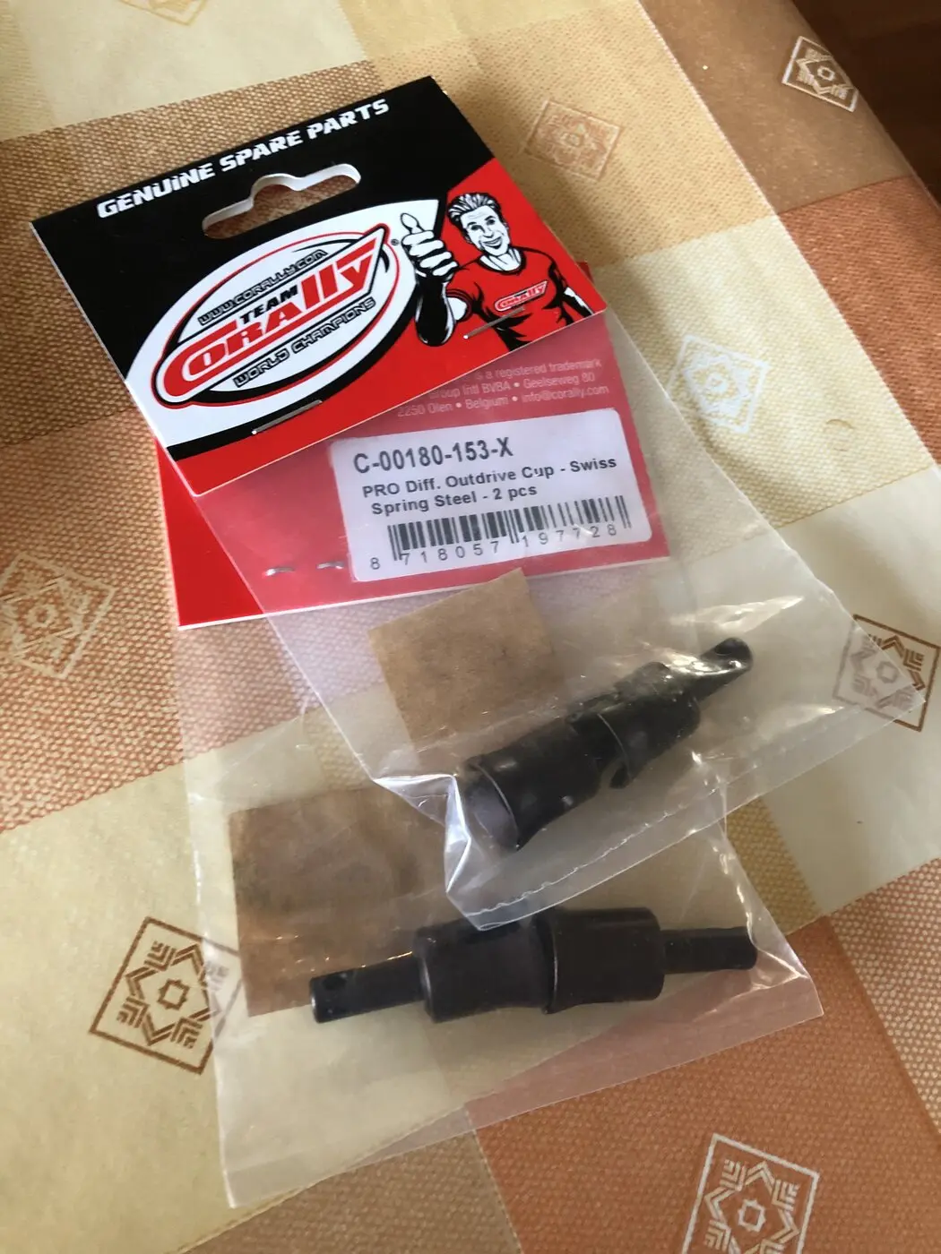

@Mr. Fring any updates on the replacement parts? Been a bit, was curious whether you had a chance to install and use them? I am seeing some similar wear on my '21 xtr since switching from 4s to 6s..the front and rear center shafts and cups are wearing unusually fast, as are the rear diff outdrives.

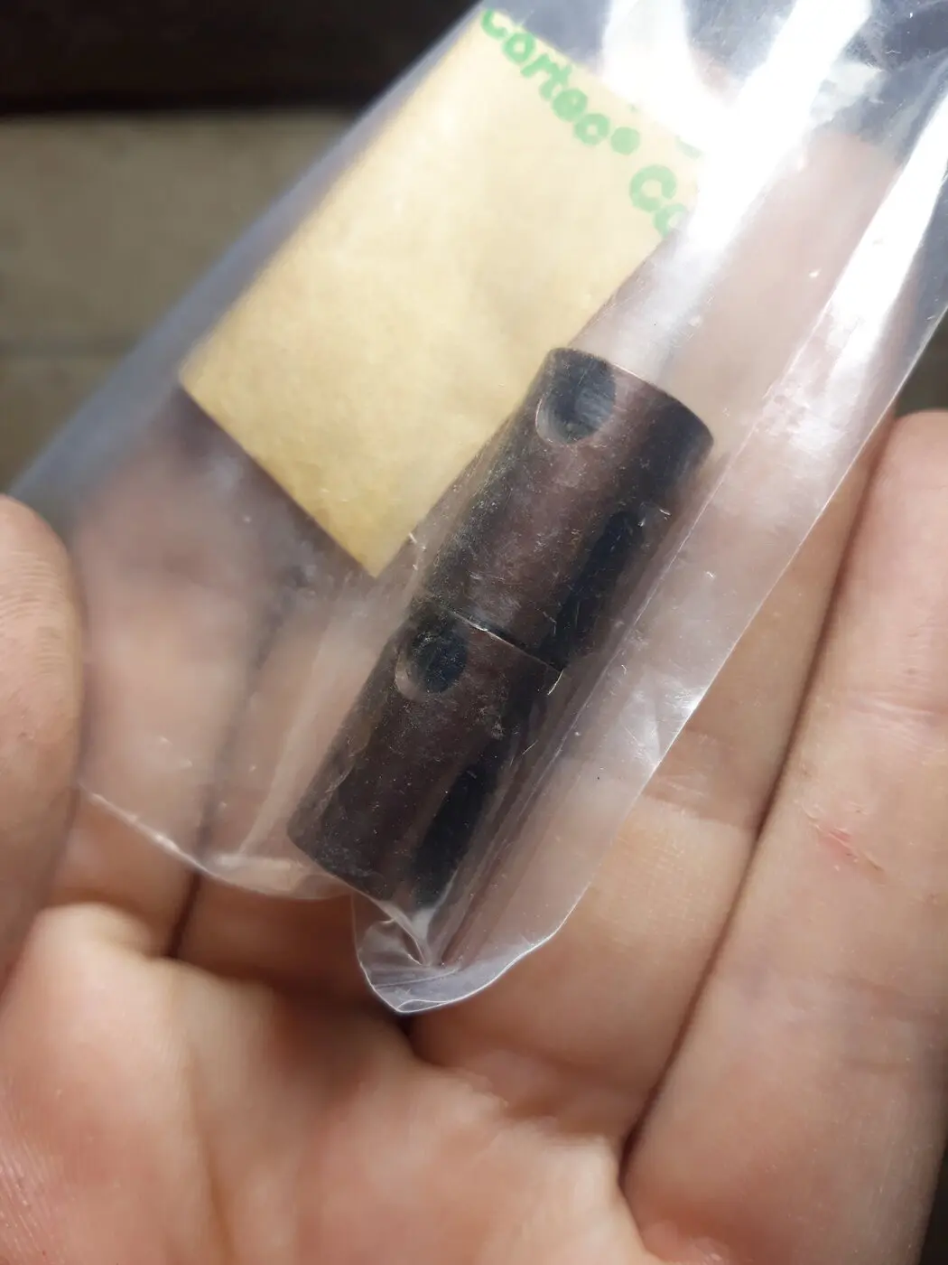

That's good to hear. Not sure why I'm experiencing the wear on my '21 model either, besides switching to the spring steel on the '22 xtr TC also introduced new part numbers for the front and rear center drive shafts that are each a tad shorter than the original parts. This may be a part of my issues, not sure.I did receive warranty parts from corally. .. they sent me both center driveshafts (front and rear) and center diff cups. I have replaced all of that. I've run probably a dozen batteries through since repairs were completed - I'll take some pics later. It seems to be holding up. I haven't yet done the front and rear cups as it's a lot bigger job. But my worst were at the center.
What's strange is I have a radix that i run on 6s and it's got the 'regular' steel cups and I'm not seeing the benefits of the spring steel. They seem to be wearing equally as fast. I'm not sure if maybe there was a batch of spring steel parts that weren't hardened properly.
I'll take a few pics later and share to show how the new cups are holding up!
