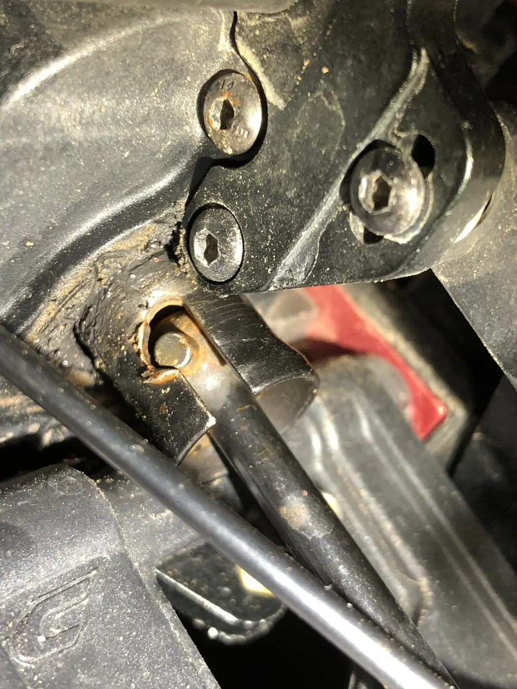

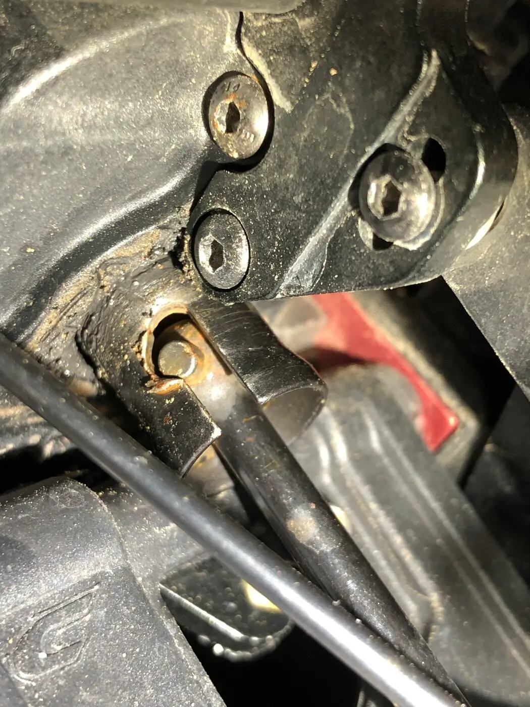

Wow, I've lost count on my battery packs. Been running 15t to 17t pinions bashing real hard and I only had a single bent shaft but the cups and pins look pretty much like @HZRDOS 's as well.
Sorry to hear you're having issues. There must be something amiss here,that is a crazy amount of wear for such little run time. I have seen drive shaft and cup wear like that on Redcat rc's from a while back but dang!Well, just to get their feedback I've sent these pics to corally... I'm curious if they can provide any input. Something can't be right. My stock in corally is pretty low right about now...
Hopefully the new parts come in soon and I can fix it before next weekend!. I may start breaking it down before I get the parts to start investigating. In the meantime I'm playing with my arrma talion and loving it.
I want my sketer back!
I will move the motor back and check that out today. I'll do that first. Thank you for the tip.Sorry to hear you're having issues. There must be something amiss here,that is a crazy amount of wear for such little run time. I have seen drive shaft and cup wear like that on Redcat rc's from a while back but dang!
I suggest you either pull the pinion or just slide the motor back so the pinion is clear from the spur and see how much resistance there is when rolling the truck back and forth. It should roll easily without the resistance from the motor. Maybe you did indeed get some dry bearings from the factory.
I can't imagine shims are going to have that type of effect on the dog bones or drive cups.
You don't by chance hold the throttle on when jumping? That would be more likely to snap parts than wear though.
I agree, bearings usually do cause the rig to pull to one side, or feel like the brakes are on as soon as you let off the throttle.I will move the motor back and check that out today. I'll do that first. Thank you for the tip.
As to holding throttle while jumping... I really don't do huge jumps. I drive it around pretty "regularly" with the occasional small jump off a gutter, e.t.c. I don't "full send" my rcs like I see all the time on YouTube lol. But when I go over some terrain that might give me air in usually let off the throttle.
The thing with the bearings is... in the past with other trucks I've driven if there was a bad bearing you'd know immediately because the truck wouldn't drive straight. It'd want to veer off one way or another unusually. My sketer has always tracked pretty straight which is why I wasn't ever too sure the bearings were bad.
I'm definitely going to move the motor and check the resistance. I'll do it later today and report back
Yep, the whole rig is stock. Stock pinion, wheels, e.t.cI agree, bearings usually do cause the rig to pull to one side, or feel like the brakes are on as soon as you let off the throttle.
To have shaft and cup wear like that so quickly is puzzling. After a couple years,sure, but not a couple weeks. I would have to think if parts were defective we'd be seeing this with other users as well.
Start with the easy/basics first I guess.
Stock Sketer tires/wheels?
This seems to an atypical example of the Team Corally products. I feel for you, hopefully TC will take care of it for you. I'm guessing you paid for the parts so you wouldn't have to wait for them to warranty the parts? I don't blame you there.Just an update: corally has opened a ticket on this... I'll see what they say.
I already ordered new driveshafts, drive cups, and various diff components if needed. Also I have shims for the wheels and new bearings coming too.
At this point I could have bought a fifth scale LOL
The sketer is a bit pricey for 4s,but it is built like a tank and should last for years. Keep us posted
Wow!.. yea they must have had a bad batch or something. Definitely reach out to them since I'd guess it's becoming a common issue. I don't think these cups should wear like that so soon especially being spring steel so I'm guessing there was a manufacturer defect. It's definitely a detailed repair job since it requires basically rebuilding each diff.guess what?

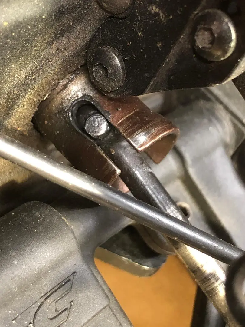

Same issue after about 20 runs:
this is the rear outdrive, the front doesn't look better :-(
It can be an issue of the camera not showing the correct colours, but your outdrive does not have the typical "brownish"colour of the spring steel outdrives.guess what?
