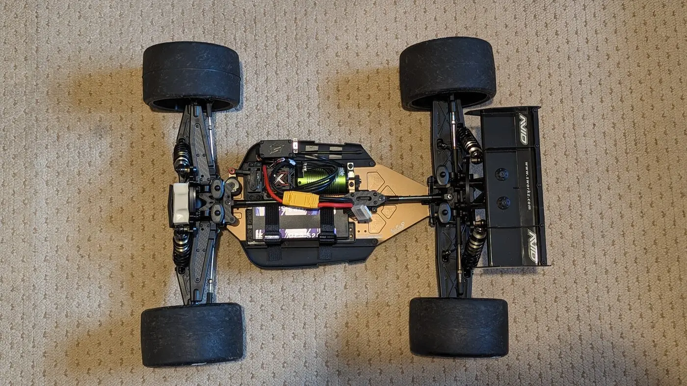

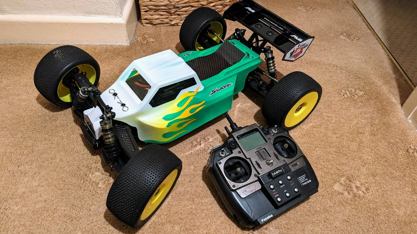

Ok, so final installation bits have been done. Just got to bind the Rx and then centre the steering servo - and it's ready to rock n roll!!
Soldering setup, which I have to say has been excellent throughout all my FPV drone building stuff.
XT90'S suck some heat, but these joints are looking alright.
ESC plate is a tight fit - but it's in. Just!
The Sworkz battery tray has inserts for 2x2s packs, or one 4s pack. I've removed 1 of the four spacers and have no trouble fitting this 6s pack.

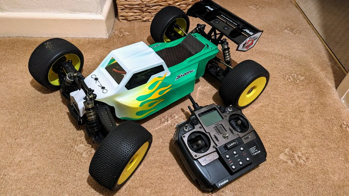

Time to get my Futaba 3VCS Transmitter out and setup a new model profile! 🤩
Lookin absolutely beautiful. I gotta say...the S35 is one gorgeous piece of kit. Maybe with the rumored new release coming up, the prices will go down a little and they'll be within reach for me.

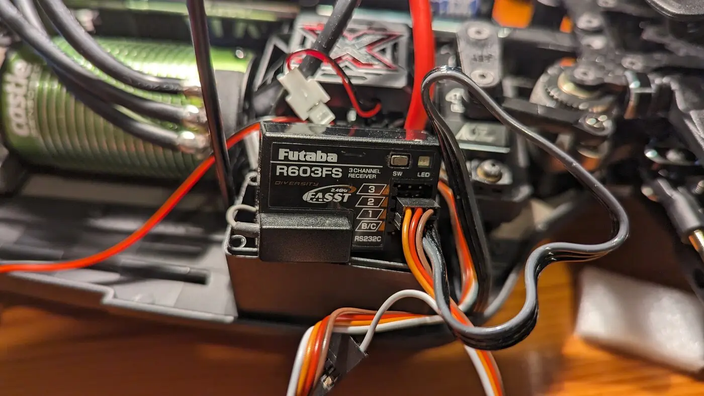

Apparently, my FRSky FASST TRF6 receiver is junk and simply will not pair up. I wasted well over an hour of time, check my Tx's modulation, resetting it - it just would not pair up.
I elected to remove it from the build entirely and the receiver has been replaced with a unicorn receiver - the R603FS. They're brilliant, but discontinued. Examples on eBay are double the price of Frsky stuff, even when tatty and secondhand. However, it works perfectly, proving that the TRF6 needs to be hit with a large fixing hammer 🔨. Twice.

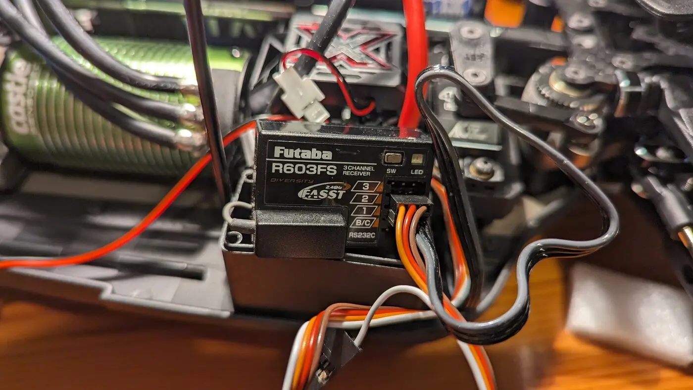

Erm... modern receivers are very small. The R603FS - not so much. It barely fitted in the radio box, but with some 'super glide' - it's in.

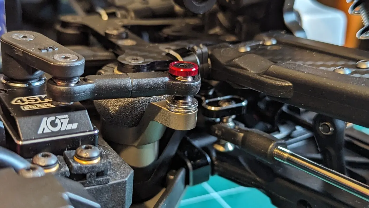

Next - the ESC. The mounting plate lifts the ESC up and because of this, the steering horn was fouling it, when turning left.

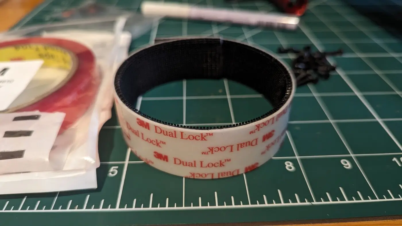

So, the ESC will now fit directly to the chassis, using UHB Dual lock. This drops it down by about 5mm - enough to clear the horn. 😁🤩
Calibration of the Castle system was..... interesting. The manual says one thing, but the ESC does something entirely different. I had to reverse the throttle channel apparently. But I have brakes and full throttle.
Steering endpoints have been set (the steering bellcranks and ackerman plate on the T2E are very good. The speed and power from the AGF810BHMW is very impressive and without a doubt are the quietest servos I own.
The Truggy is now fully operational. I just need to charge things up and give it a shake down. 🤩

So, back to the finishing touches on the S35 T2E.

I needed to get the angle of the steering link level. To do this, I used 3 washers, a conical M3 washer and an M3 countersunk washer.

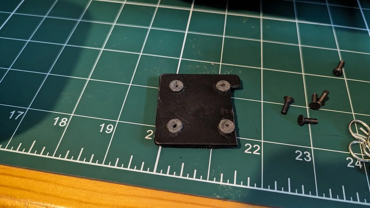

The mounting lugs have been removed to 2mm on the ESC mount. Fitted to the chassis, this lowers the ESC sufficiently to avoid the steering horn fouling it. 🤩

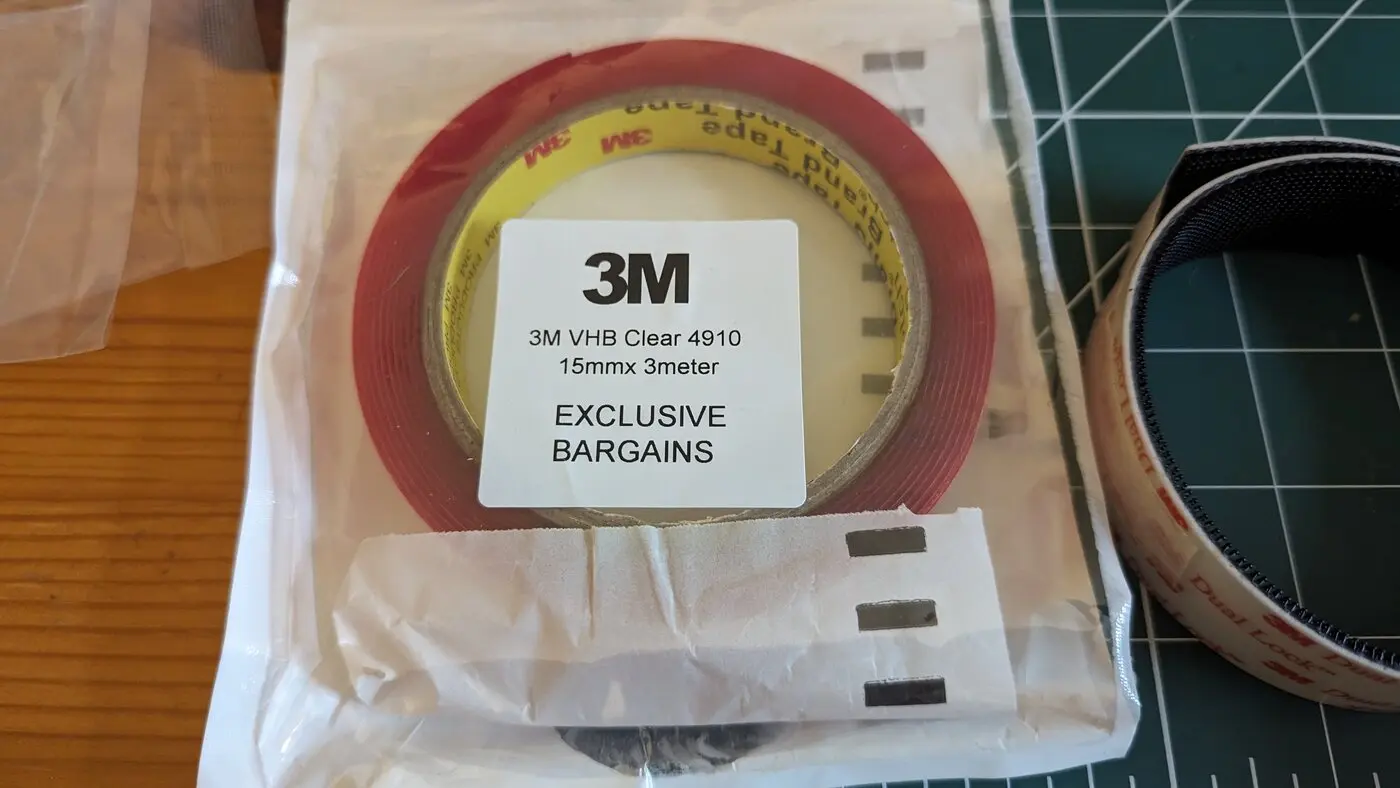

3M Dual Lock and UHB clear double sided tape. Dual lock mounted the ESC and UHB used to mount the switch.

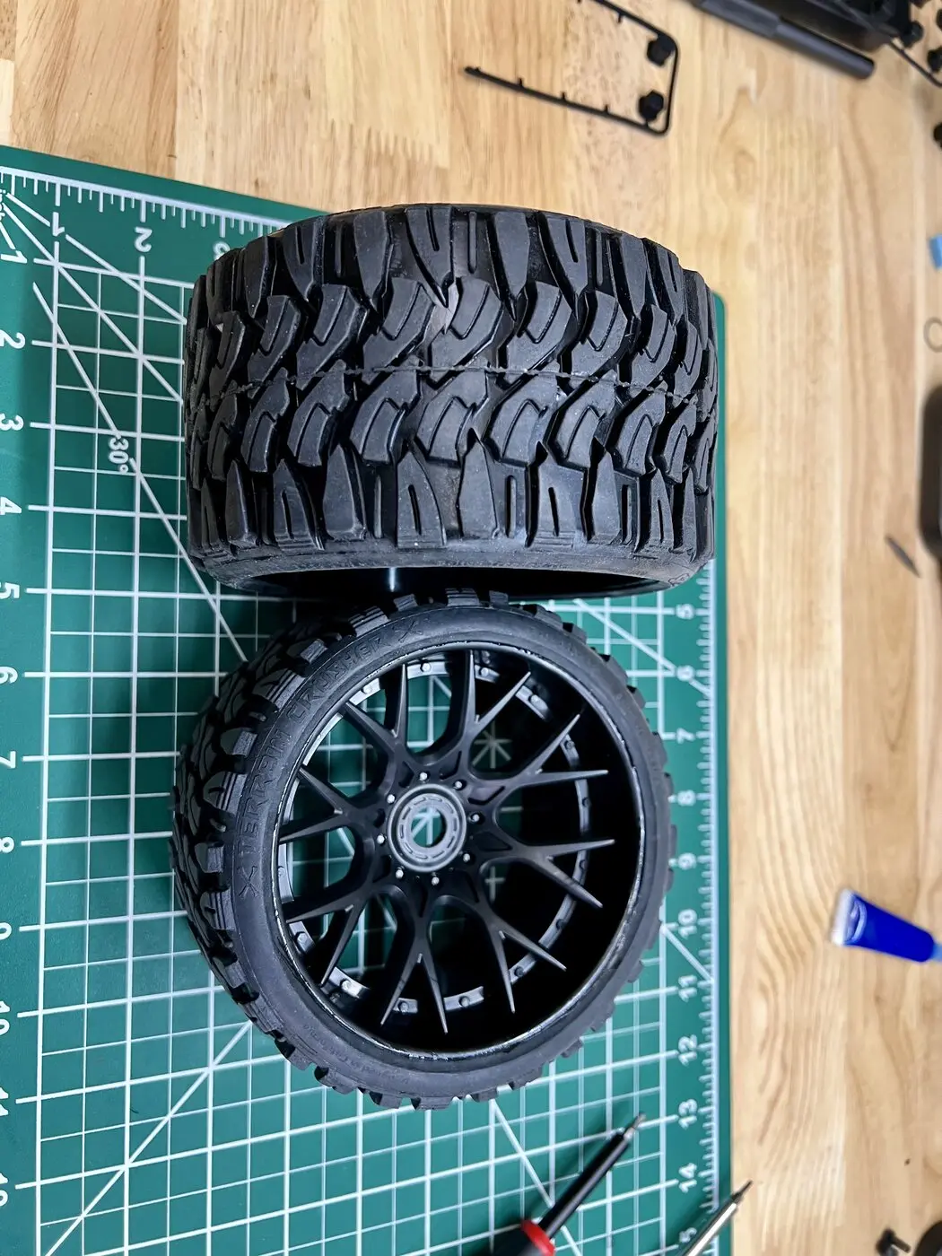

Layout of truck is weight forward, similar to Mugen configuration.

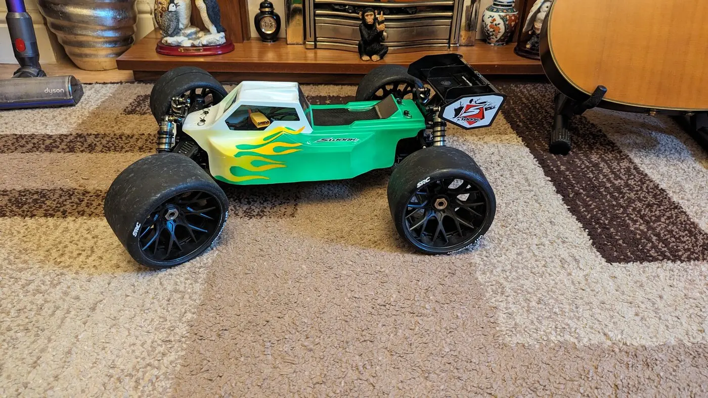

Sweep Crusher tyres are slightly bigger than Truggy tyres, but this will actually help increase the rollout value for speed runs.
So. Still no run time. 🥴

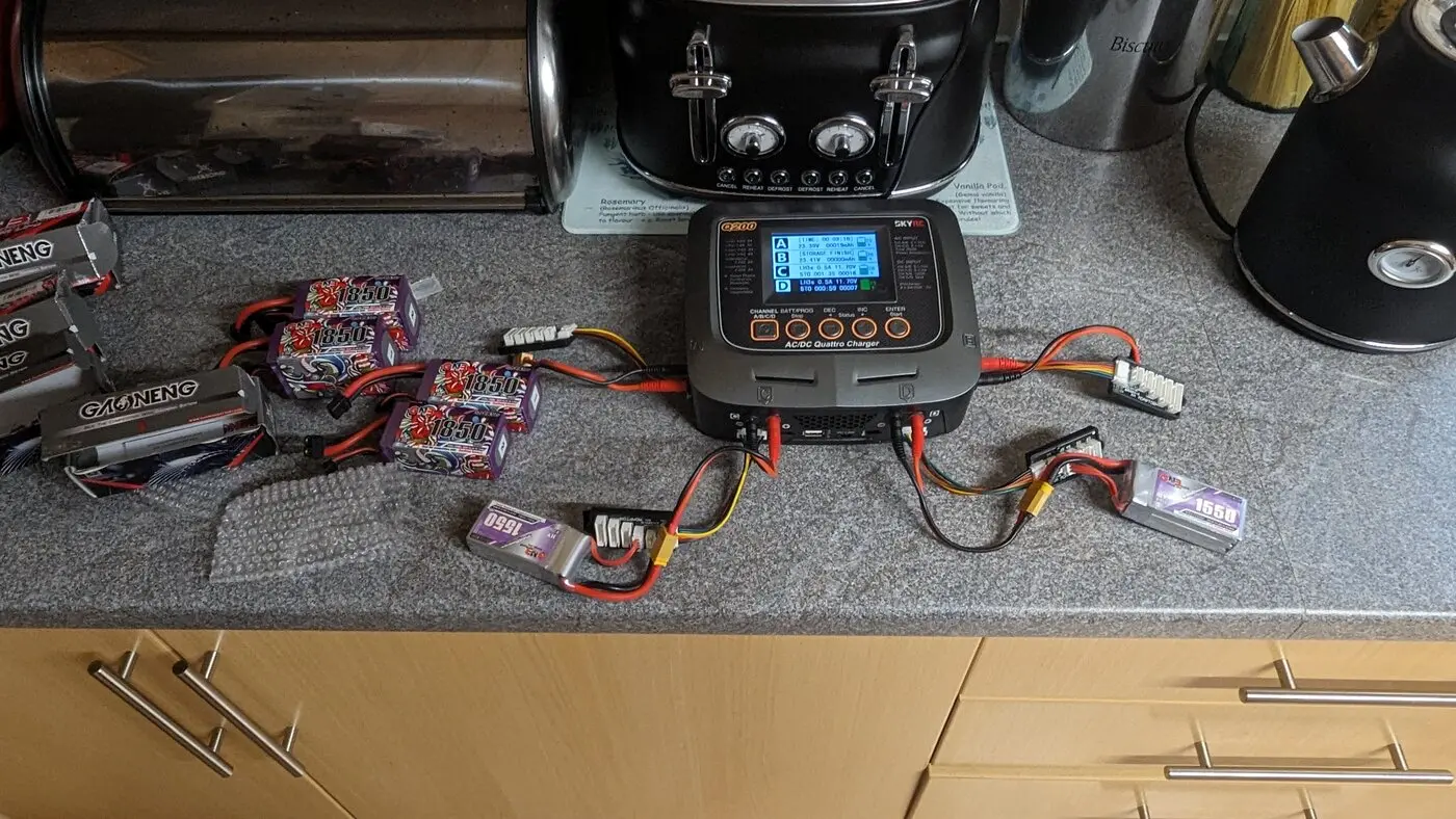

In the meantime, it's time to do some battery maintenance.
I like em! 👍👍
I’ve got their cousin’s sitting on my bench just waiting to go on the SSTE. Unfortunately the weather got in the way before I could get them out there! Hopefully soon! 🤞
