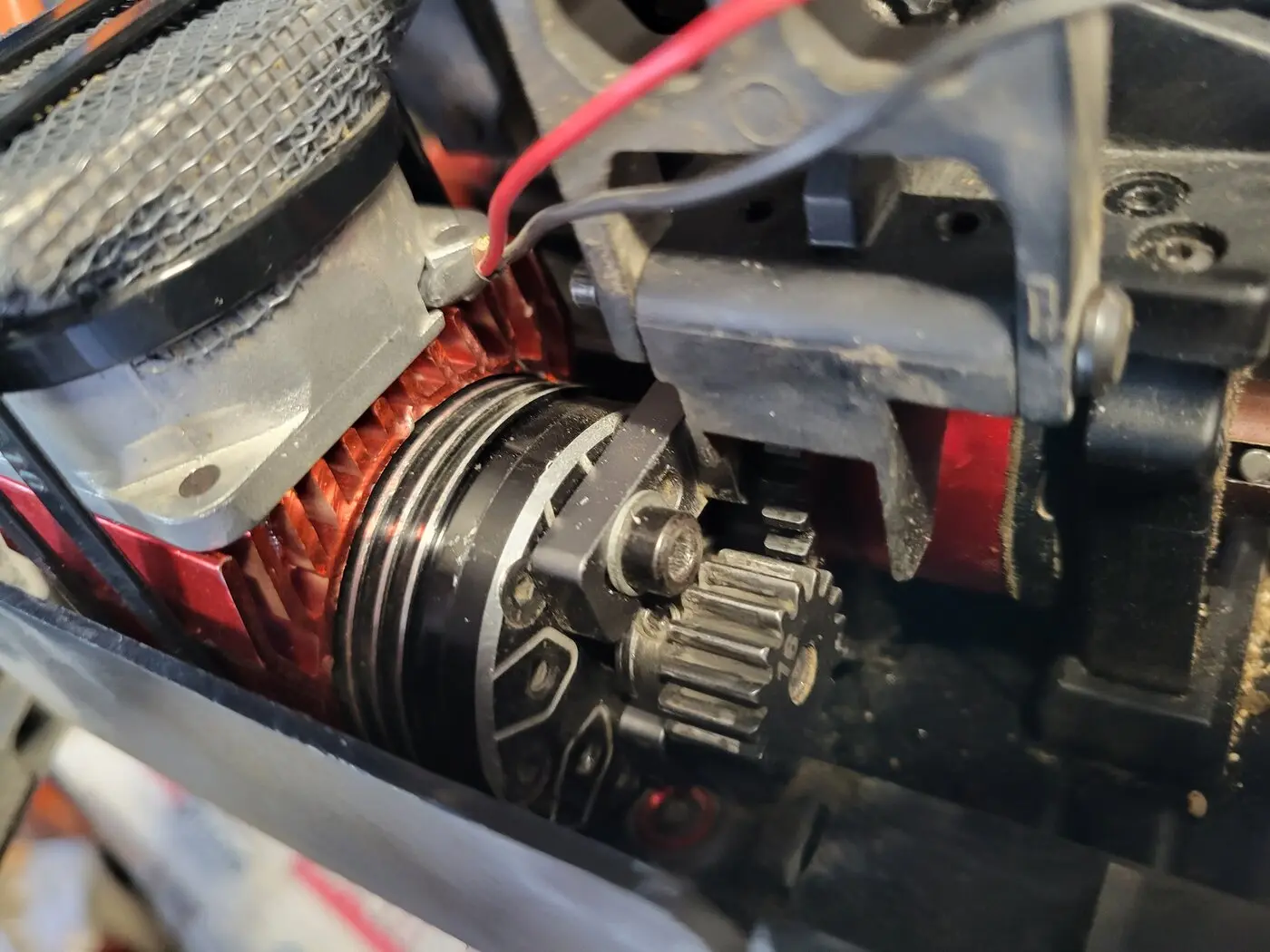

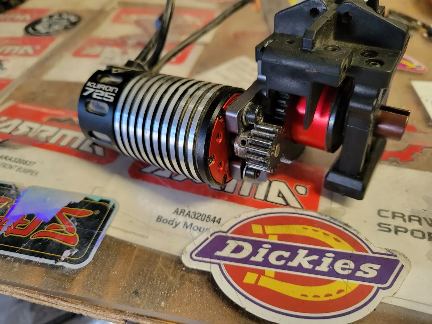

Finally got the first bash video uploaded on my channel. Stock out of the box besides lowering the brake and going up on punch settings. Have to finish editing up the next video and get it posted running the 6s wide hubs, 17t pinion and 300k in center diff. Think I'm going to swap out the stock motor for one of my Hobbystar 4068 2400kv and see if that gives me the air control I'm looking for.
And here is the last bash with the wide hubs mod, 16t pinion and new 120c 4s CNHL packs. Rig runs great loving the platform but needs more power as it still won't flip for me. Going to put a 4068 2400kv Hobbystar motor in next and hopefully that will do the trick🤞🏼

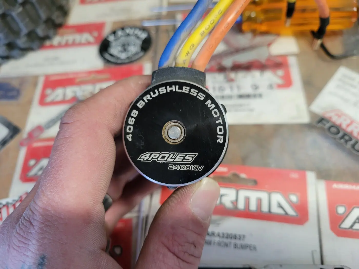

Ok so went ahead and swapped.out the stock motor for a Hobbystar 4068 2400kv. Running a 16t pinion she handles just like I want it to and backflips now!! But..... the stock esc is not cutting it, keeps cutting out and cogging bad with the 2400kv so going to have to put a BLX185 in if it will fit🤞🏼
