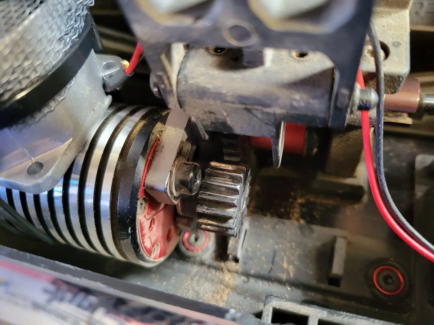

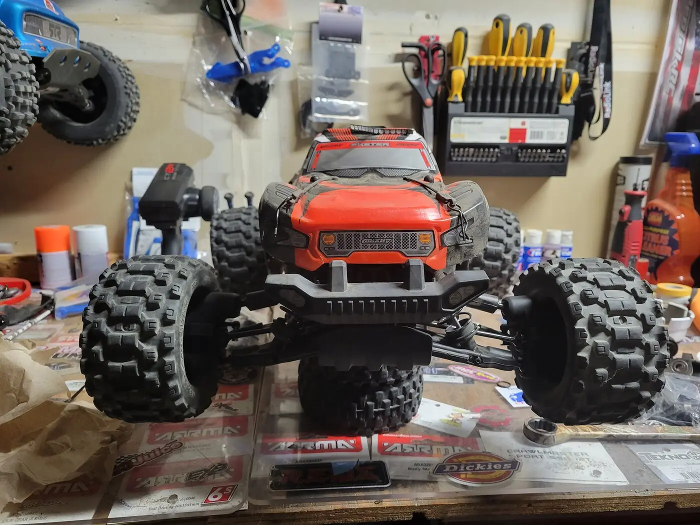

So 16t is still not giving me the air control oddly but the speed is there for sure now. Runs like a raped ape so to speak
but I barely can get a backflip

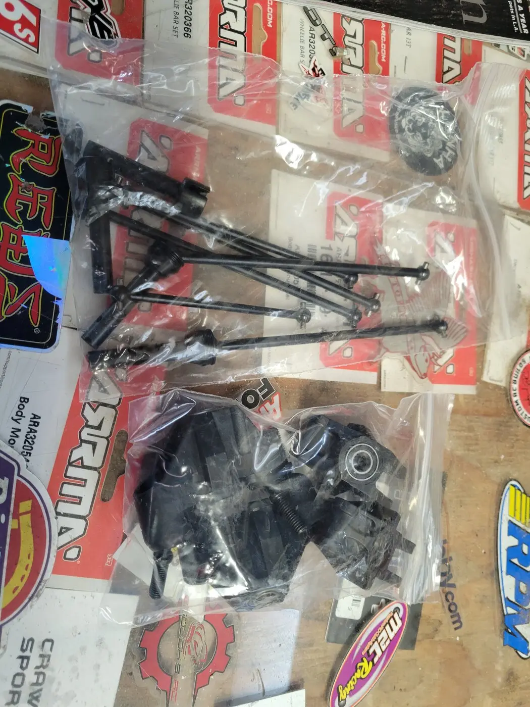

may pull the center and front diff and thicken them up see if that helps if not I'll be slapping on a set of MX28's and adding the wider hubs and axles.

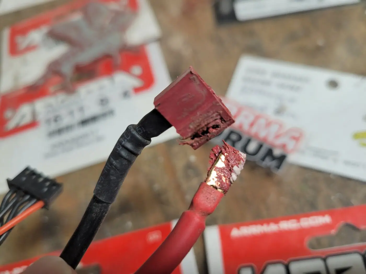

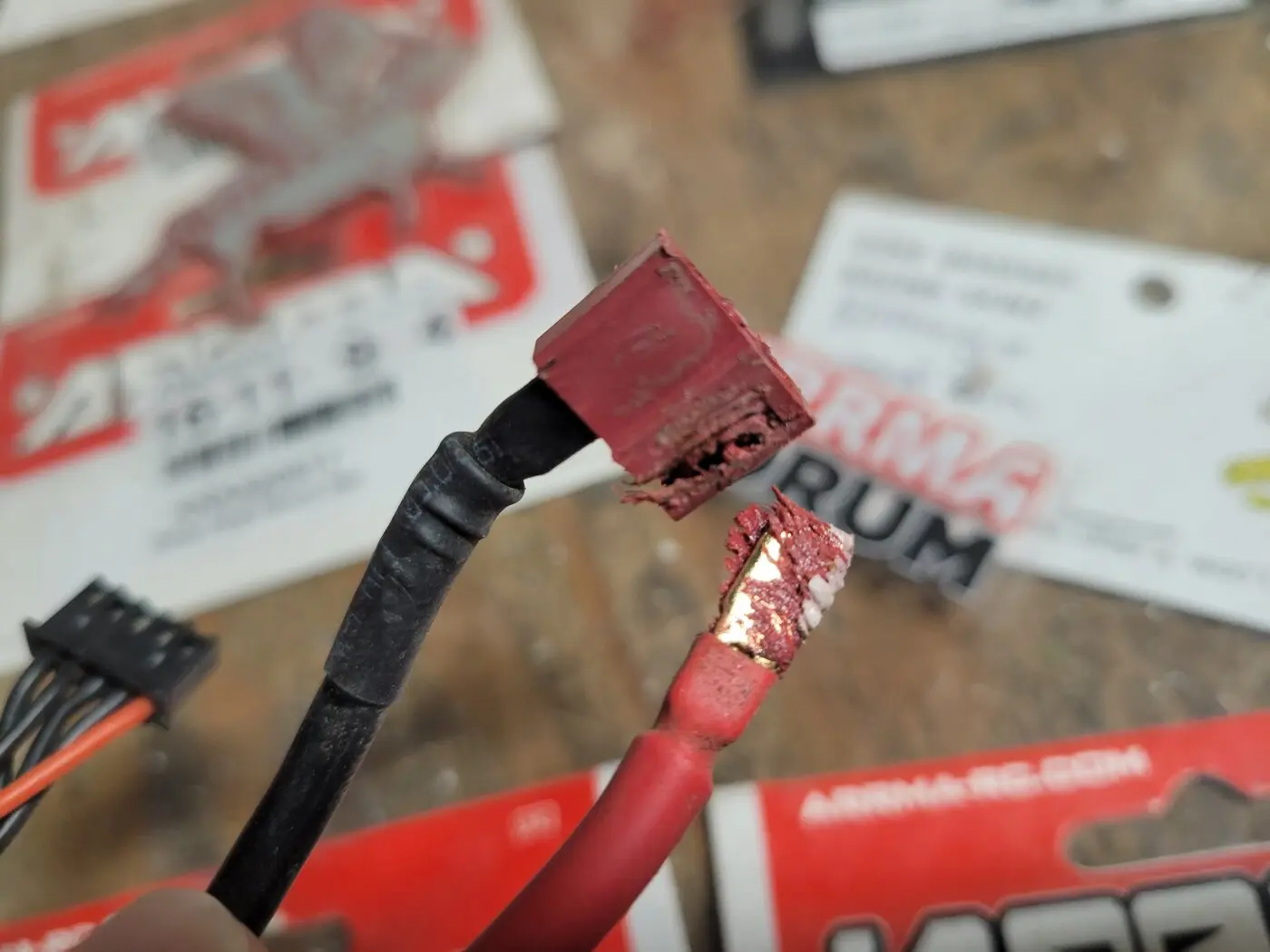

Also learned the hard way why NOT to run Deans plugs on anything pulling more than 50-60A
It definitely didn't hold up to the CNHL 4s 120c power and Amps pulled from the ESC while hard on throttle
Guess I'll get them all changed and soldered up now.....

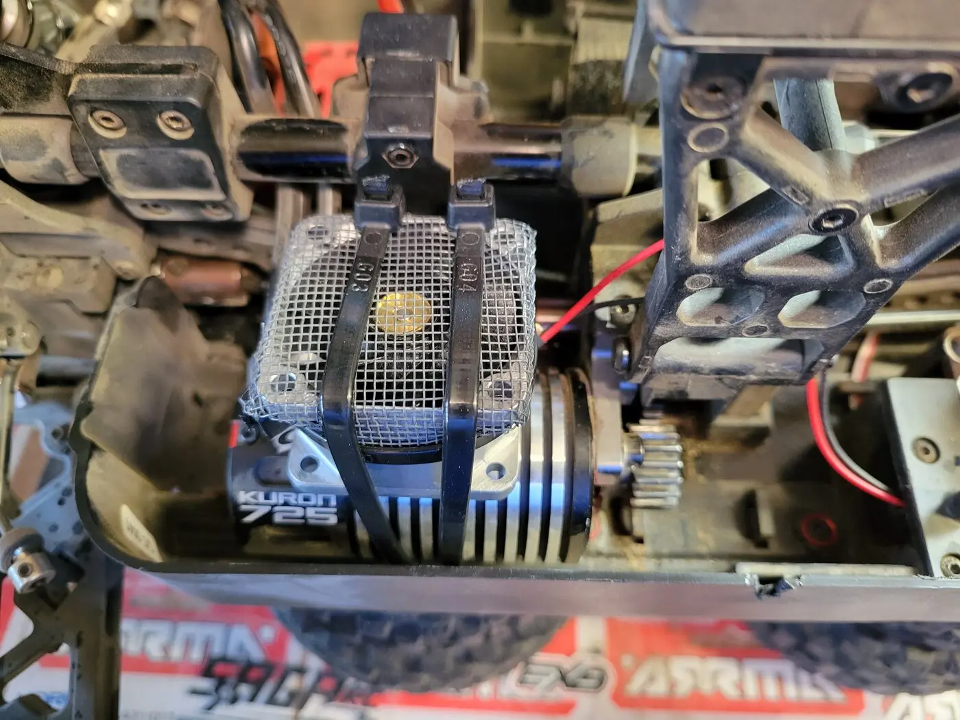

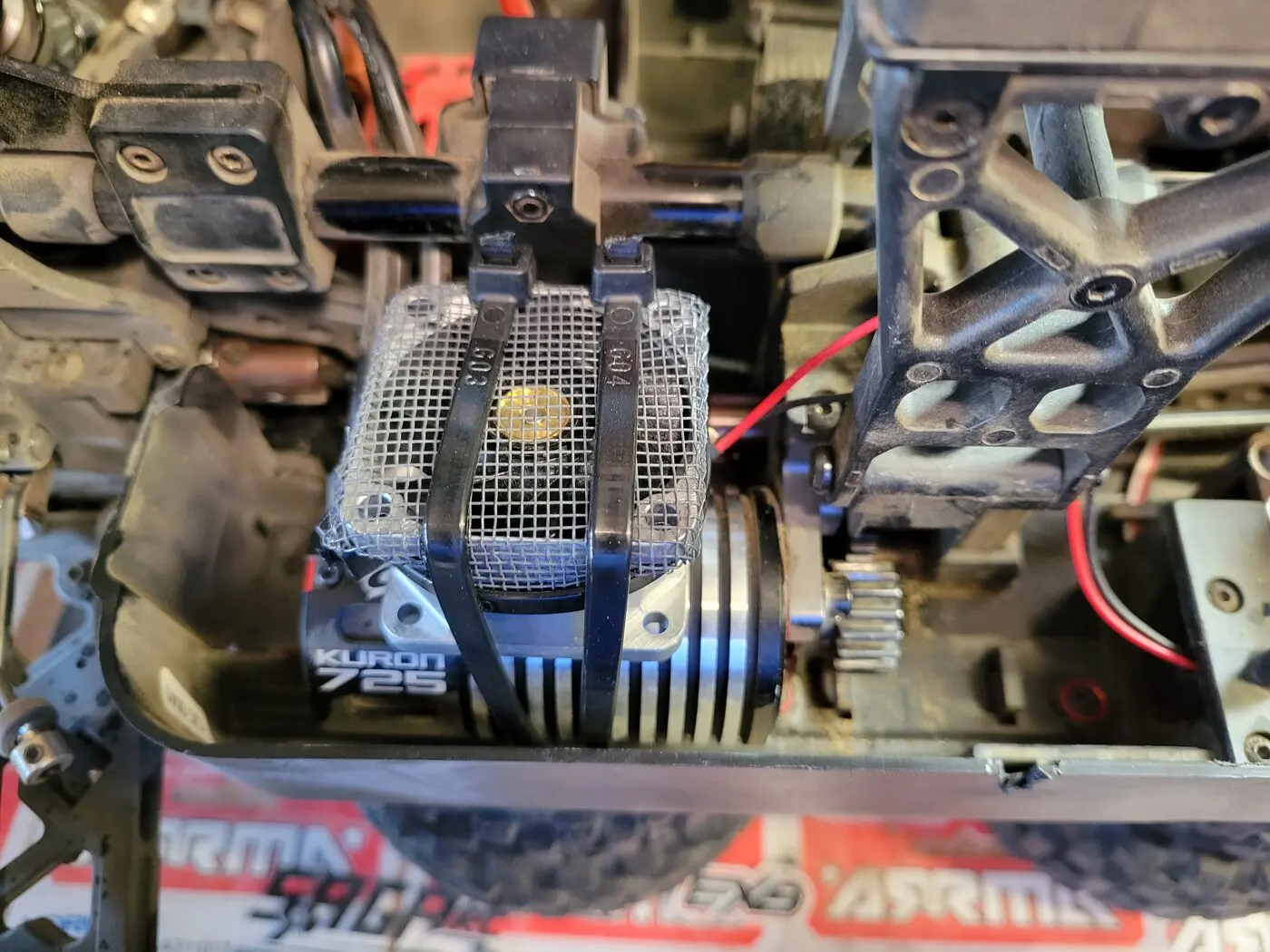

Actually the ESC temp wasn't bad even with the 16t and me always on throttle. But these fans I run BLOW air even off the reciever at 6v so it blows a bit on the ESC also from the motor.
