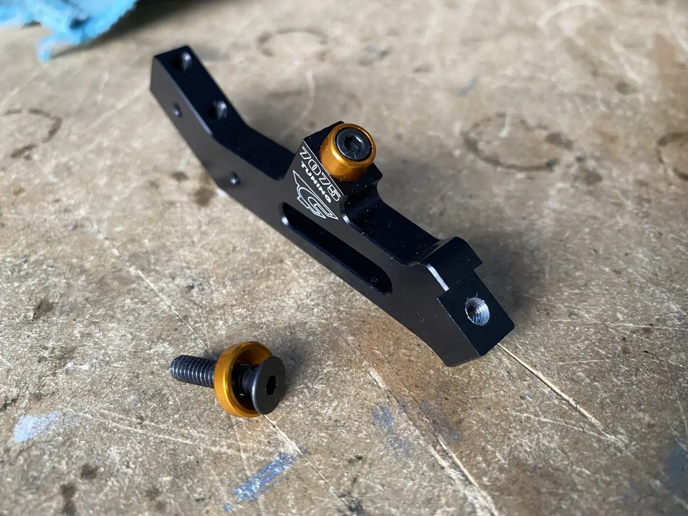

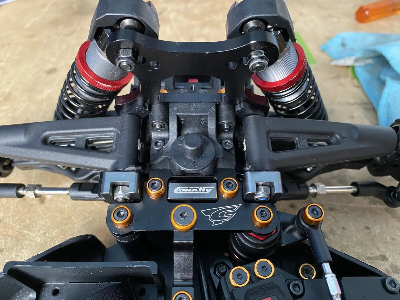

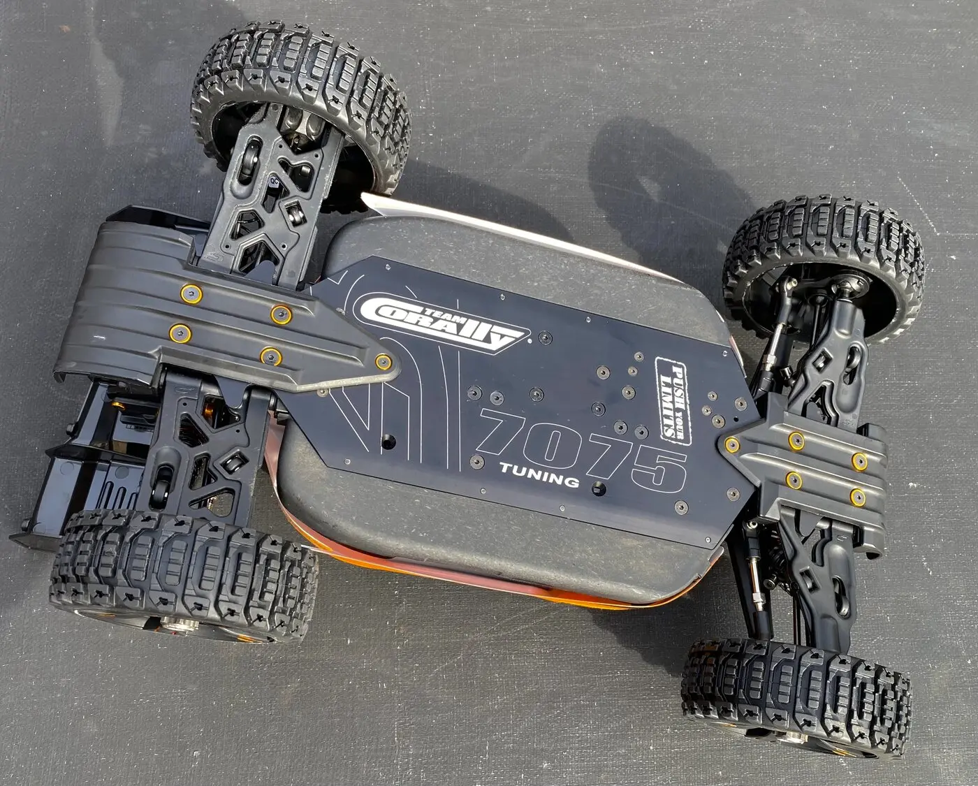

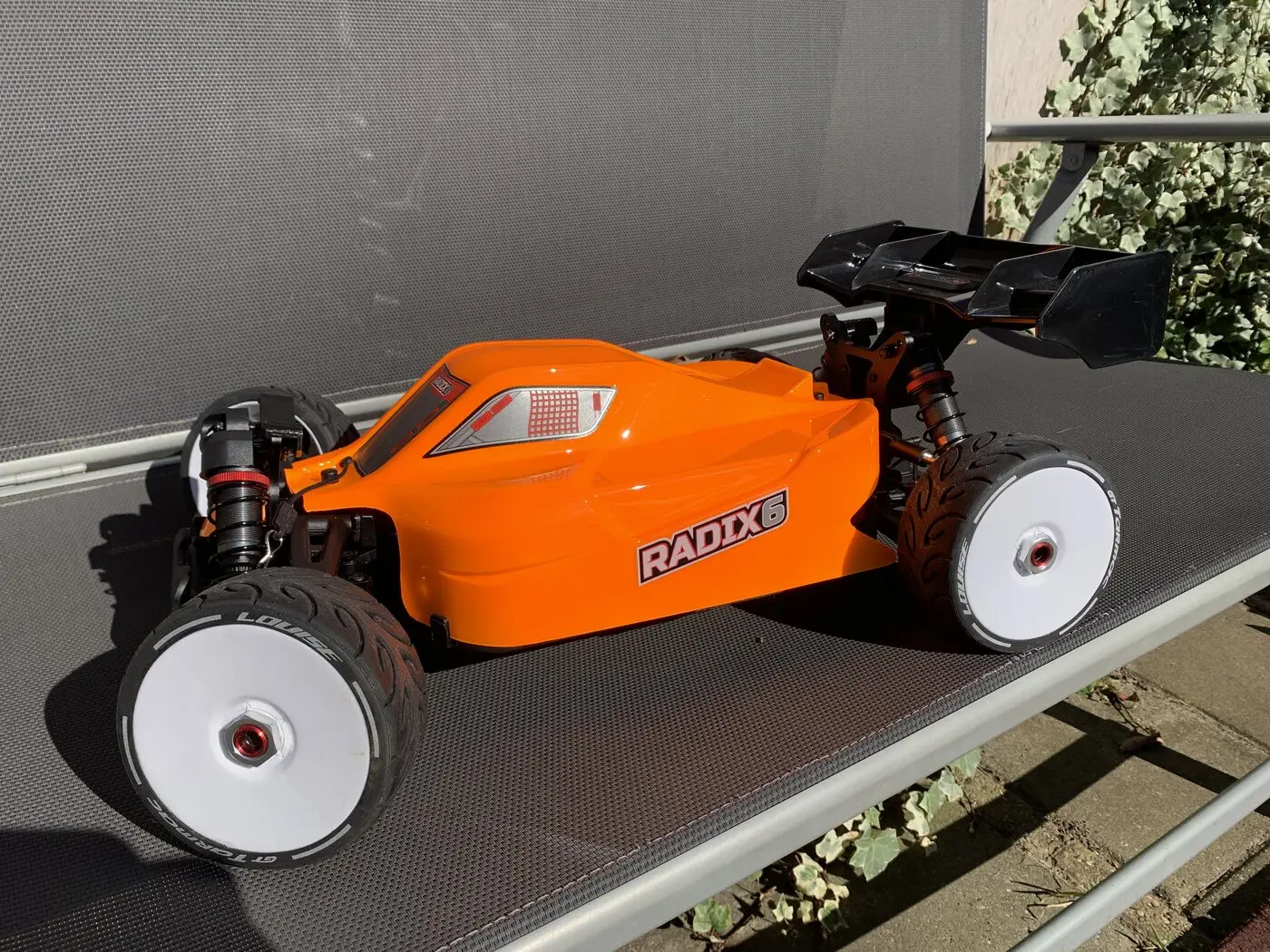

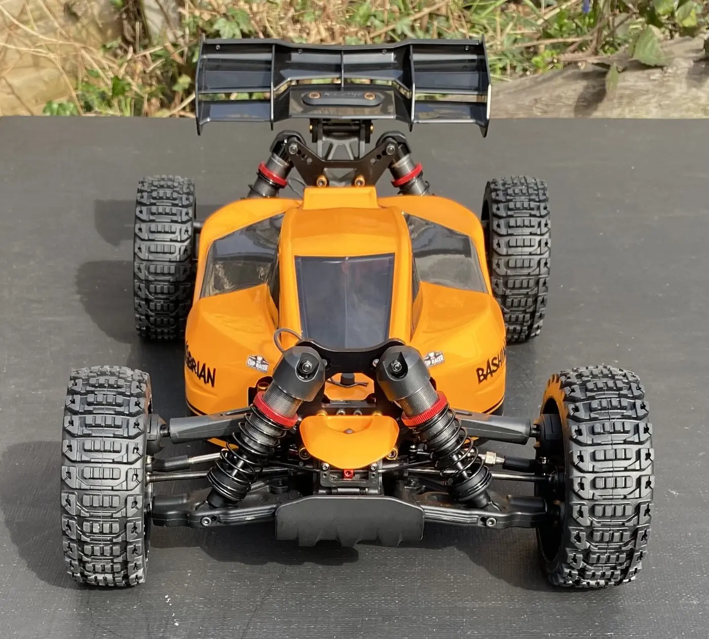

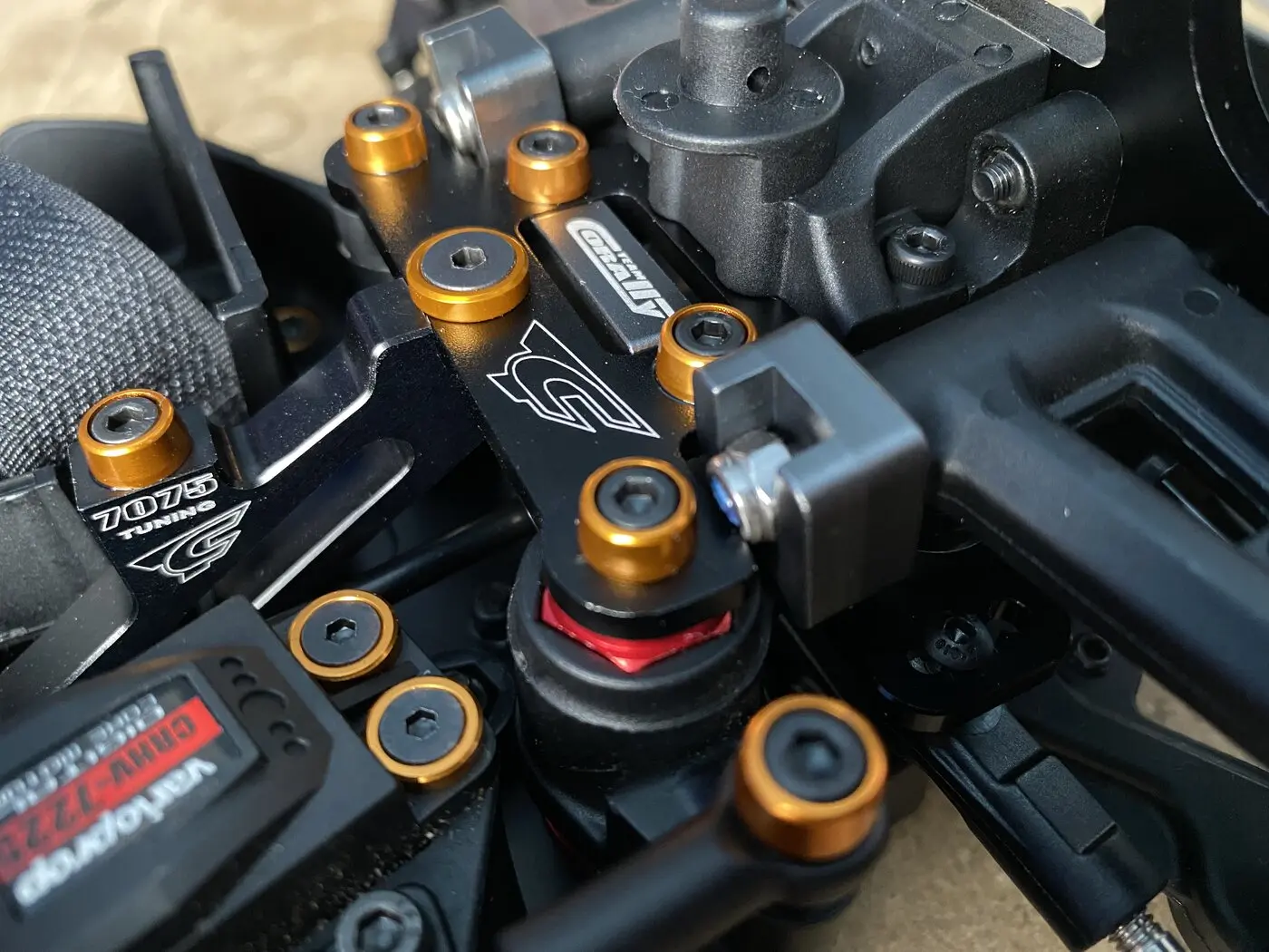

Ended up buying the Swiss 7075 chassis braces , the front one comes with a M3 thread in the top mounting position and that's no good in my opinion, I drilled a larger hole and re-tapped it to a M4 bolt thread..
Some bling shots

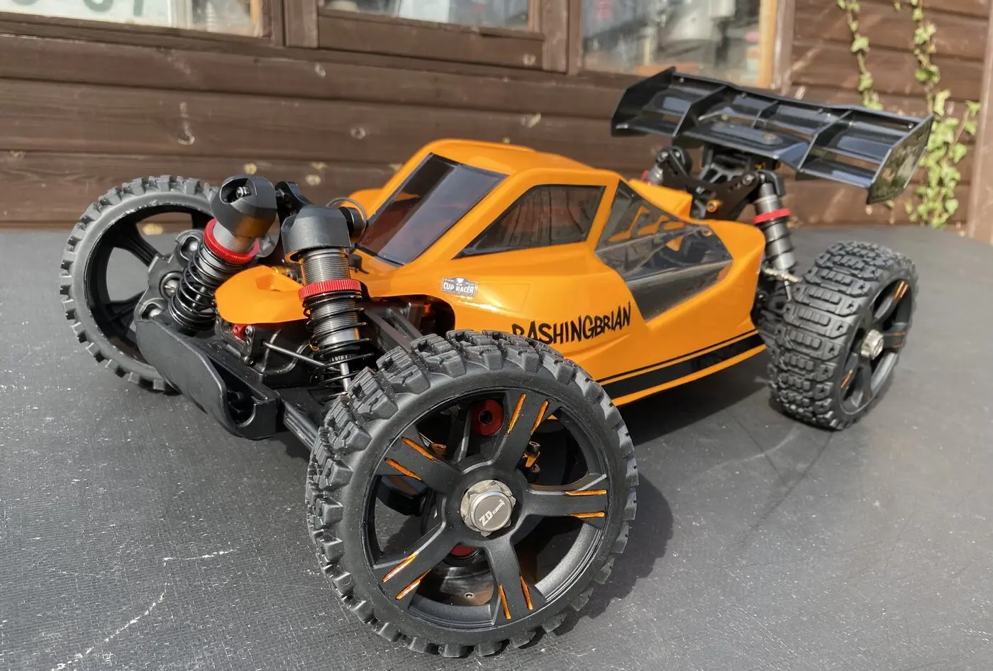

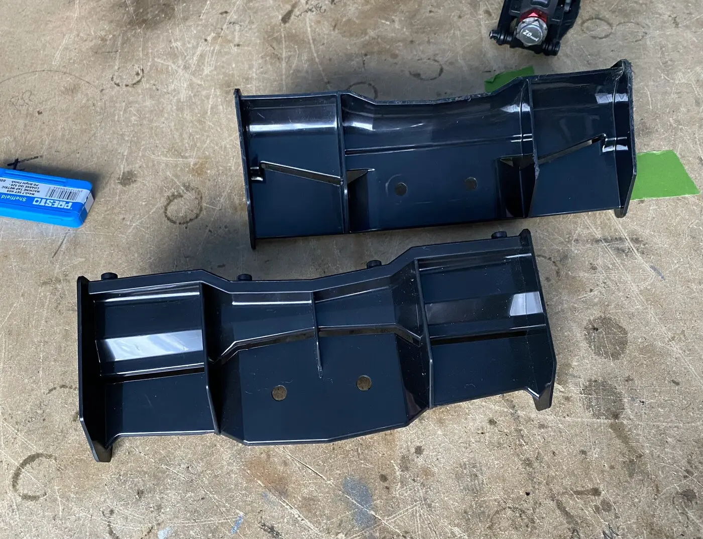

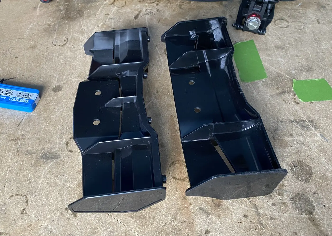

Changed the rear wing to a Proline one I had as it looks a bit nicer and is stiffer.
Proline on the left, stock on the right..

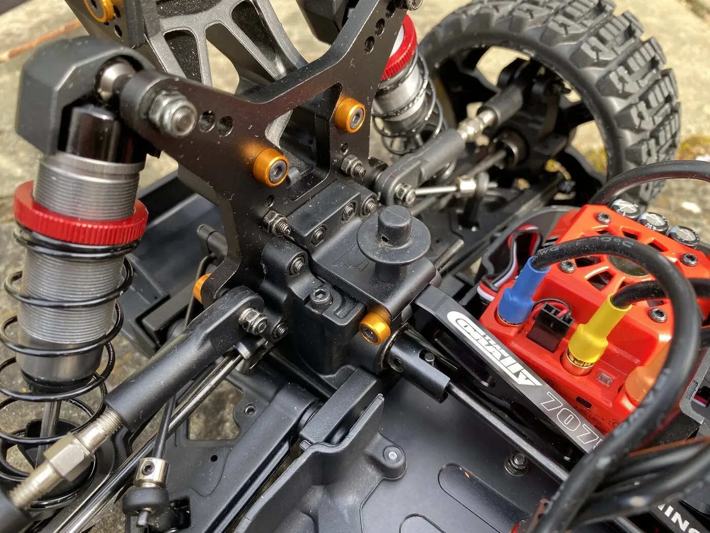

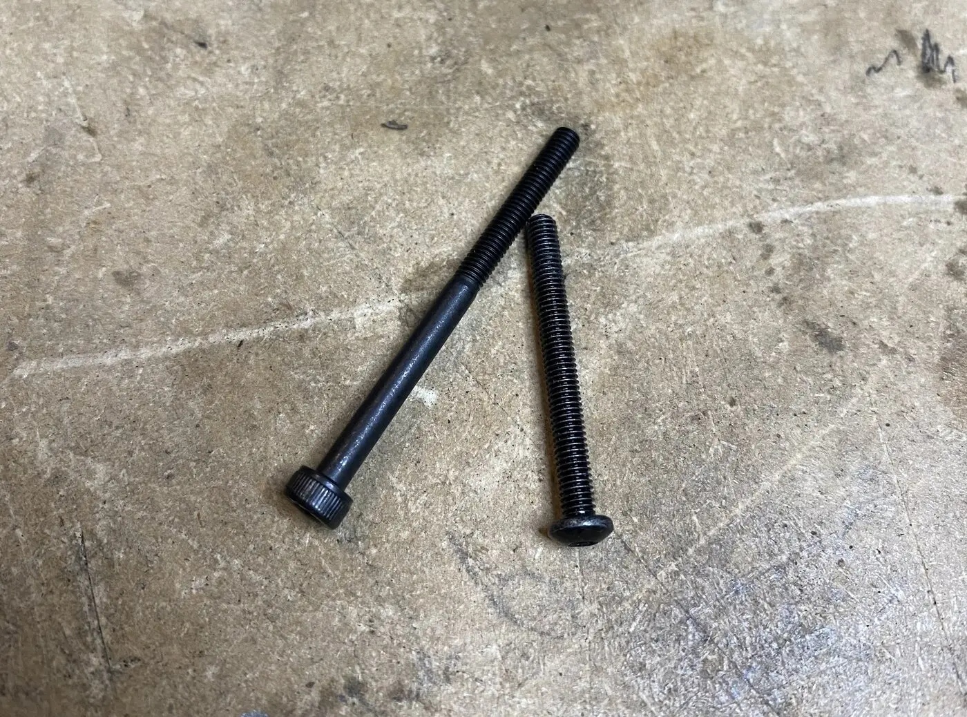

I noticed stock out of the box the rear chassis brace upper mount had some play in it, so I changed the rear mounting bolt to a longer one that has no thread because it's just ever so slightly thicker. Using this bolt the play is practically all gone
You can see the long bolt below.. ( I still need to cut the extra length off )
Some bling shots
