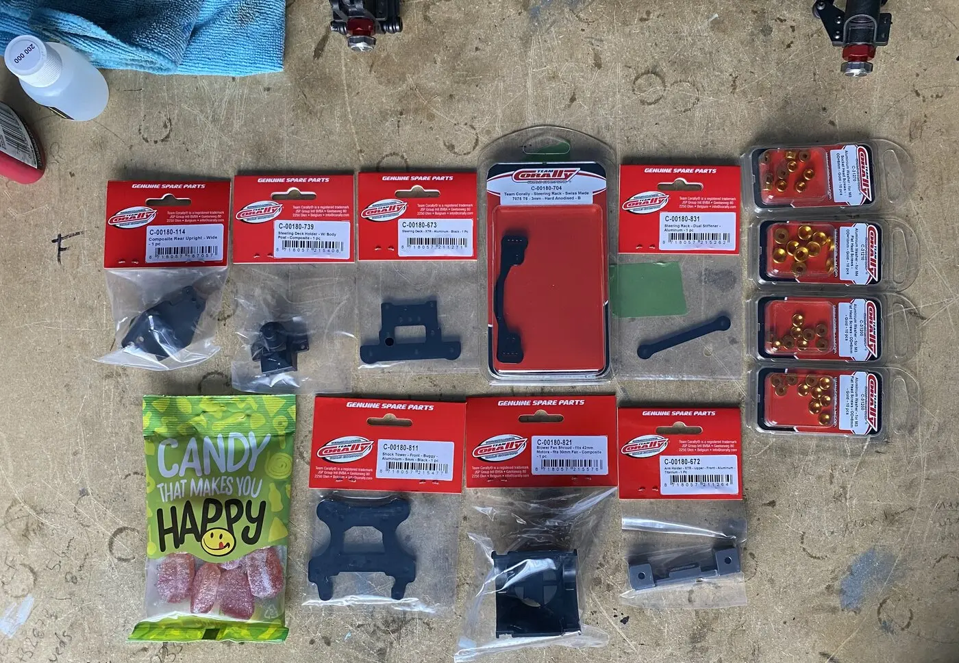

I had a bit of a spending spree this morning at Corally.com 🤣🤣 I couldn't help myself, I really do need to stay away from the internet in the mornings...!!
Teaser time.. 😉
Just waiting on a few parts from Jenny's to arrive and then it's modding time 😎 ( fingers crossed this weekend )

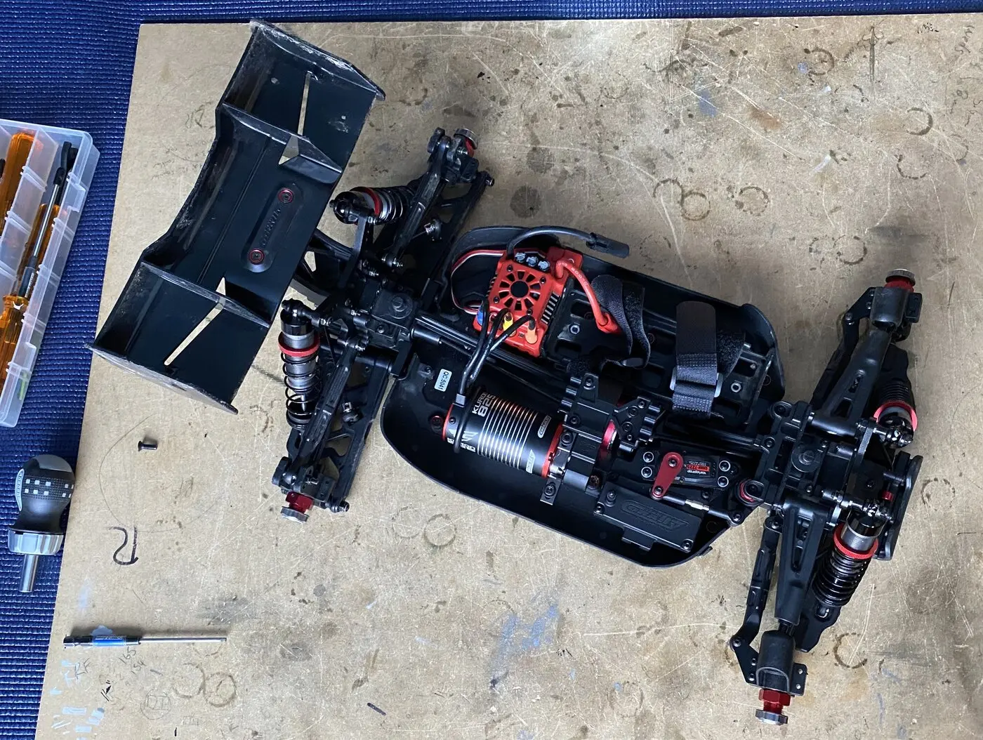

1st bash box stock..

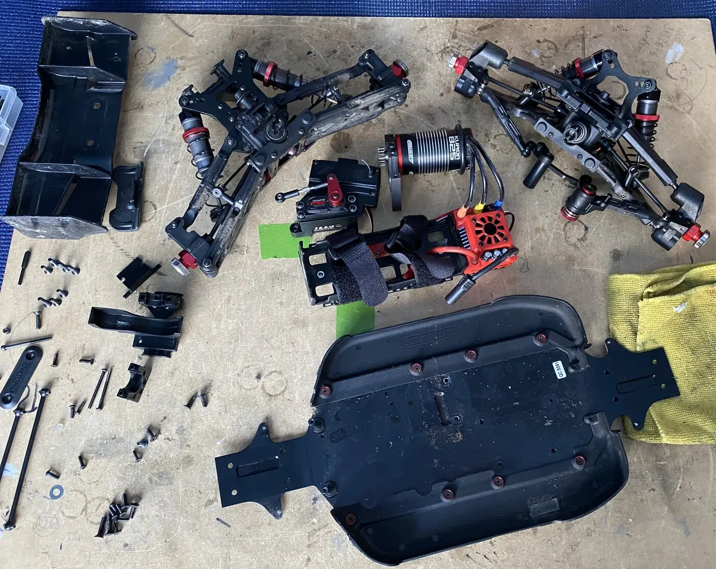

1hr later :ROFLMAO: this is where it all started, quick strip down and check over..

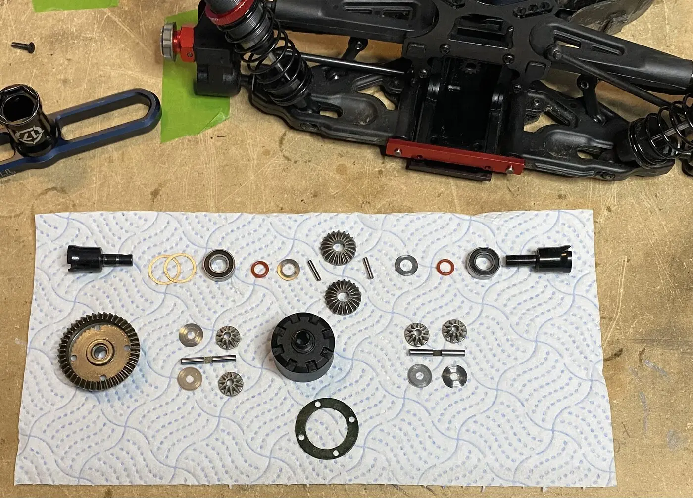

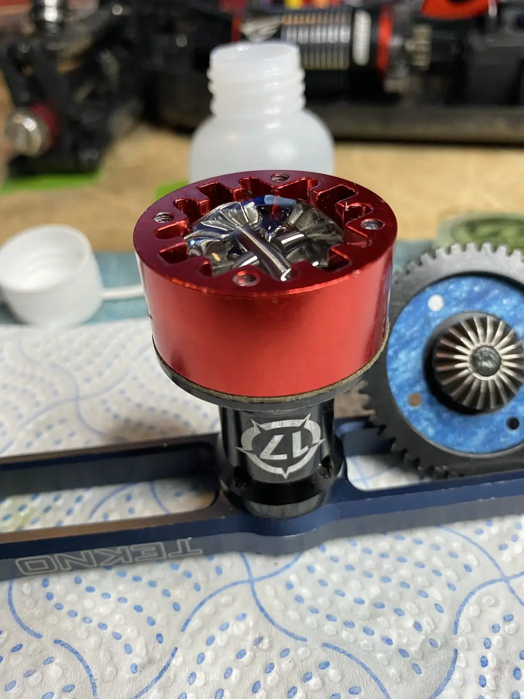

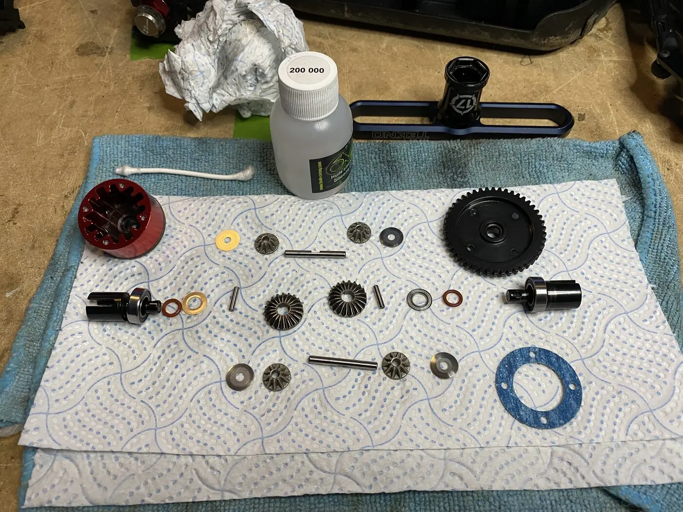

All the diffs had a reasonable amount of fluid in them from the factory.!! Quick build of all the diffs F30k / C200k / R20k
Center diff all stripped down cleaned and ready to be re-built, no issues and everything all in place as it should be (y)

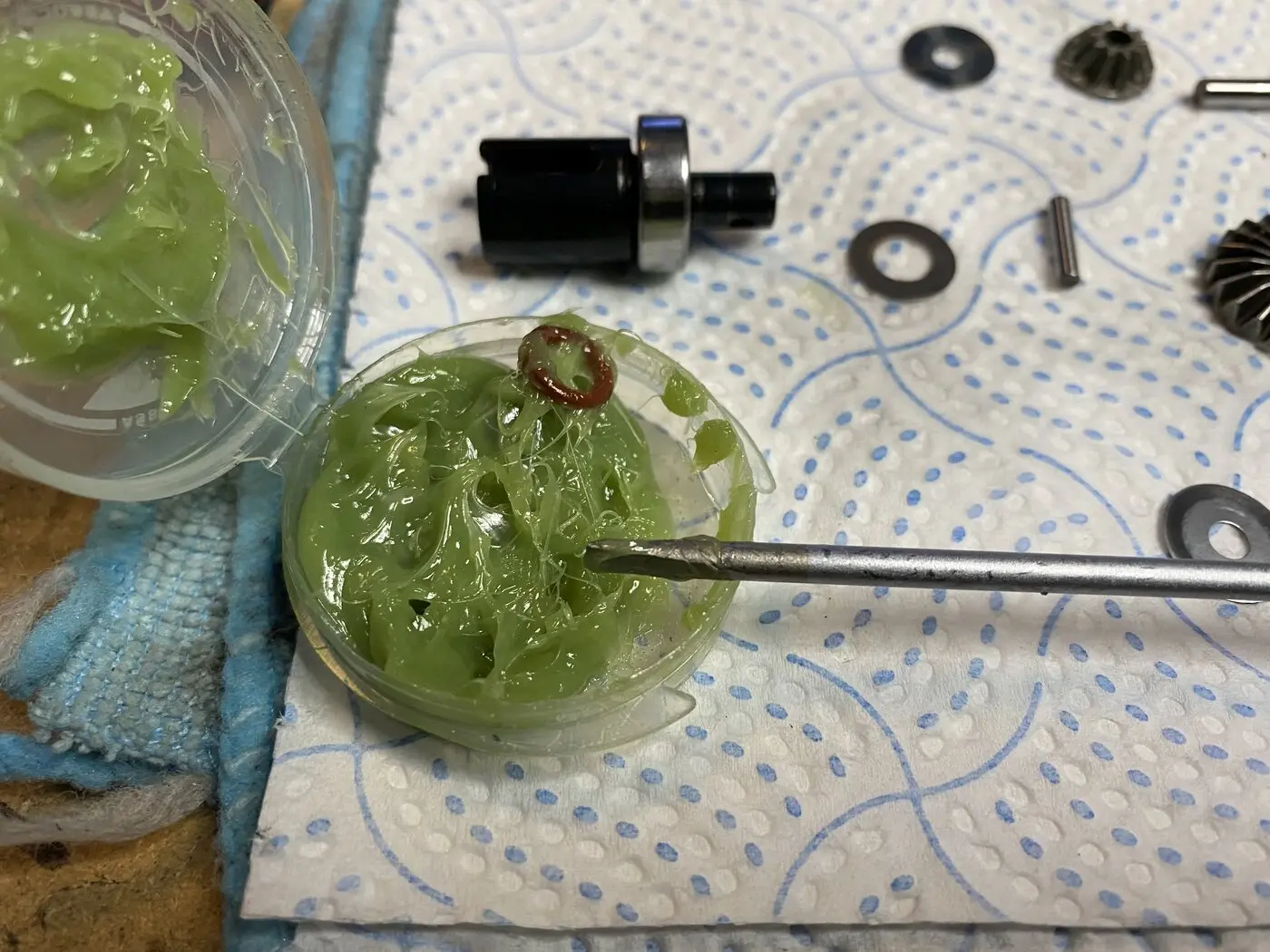

Can never have too much green slime..!!
Top tip, always use this stuff when building diffs or shocks, I always coat all the O-rings..:cool:
All done and waiting to be reassembled.. Top tip #2, always let your diffs sit for a while before assembling, allow the fluid to sink into the diff so you can see the correct level..

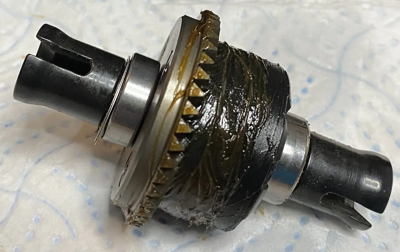

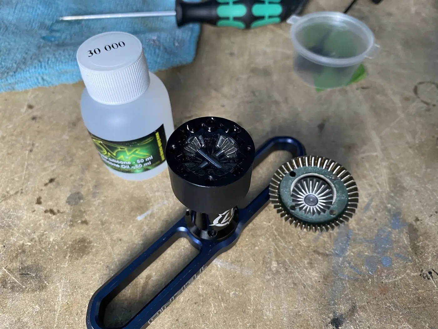

Here is the front diff at removal, weird brown grease inside the case :unsure:
You can see below the two shims on the outer bearing, they adjust the end play and correct the mesh between the spur and pinion inside the housing when assembled.
As I mentioned in a previous post, the diffs with the flared drive cups are harder to shim as you have to disassemble them to remove or replace shims..!!
You can't just slip shims over the ends like some other diffs.. ( I will say that with the two shims from the factory the mesh was nice and tight but not binding, well done Corally (y) )
Stripped, cleaned and waiting to be re-built.. ( you can see those shims at the top left of the kitchen towel )

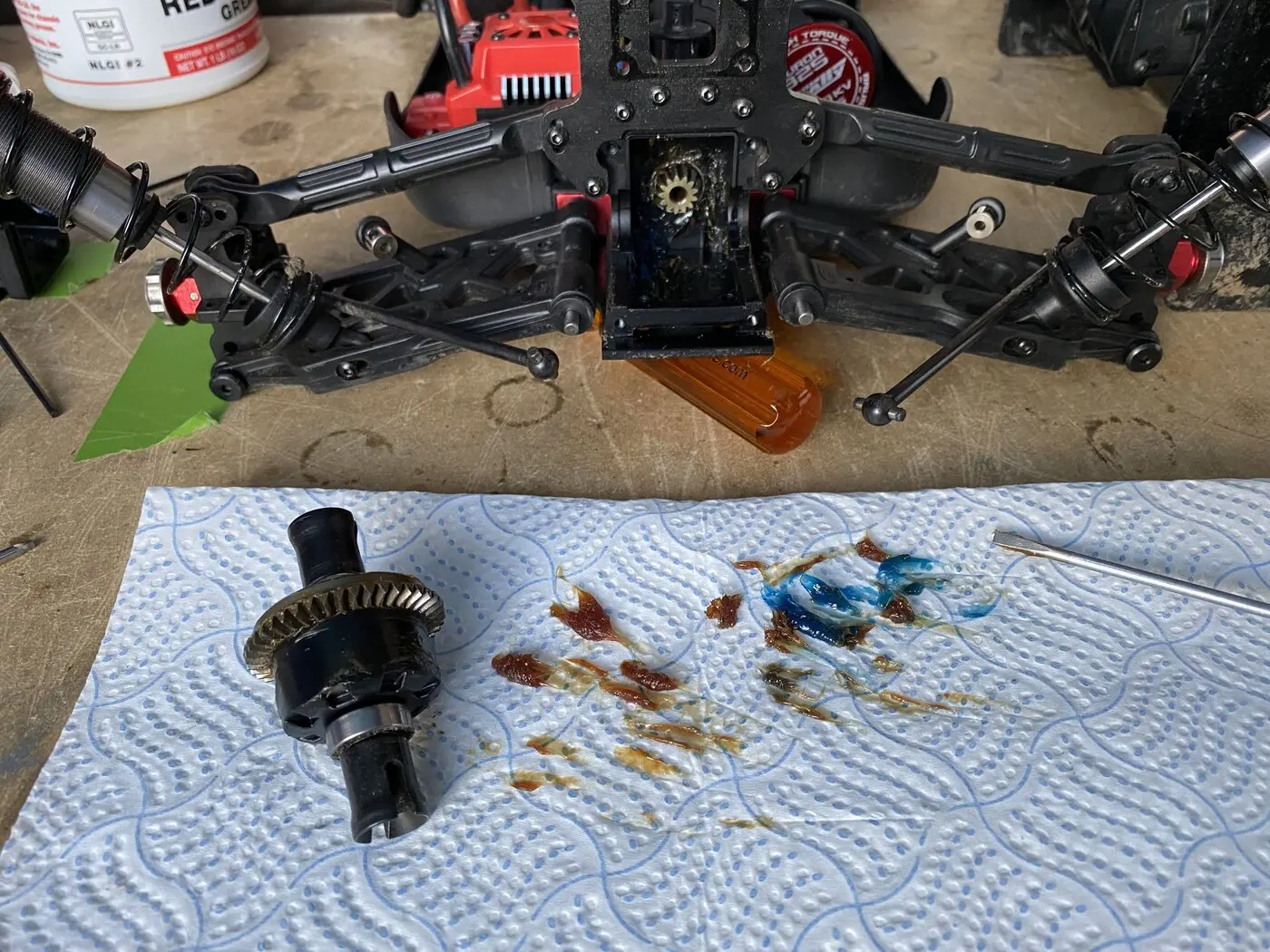

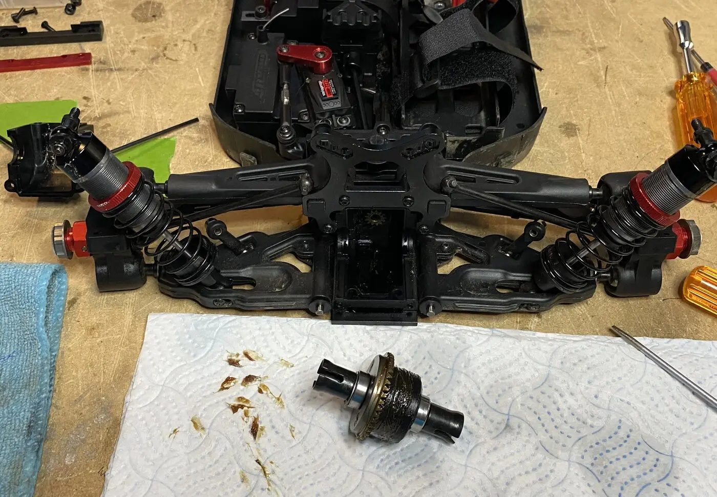

Rear diff just removed, this time weird brown grease and also some blue stuff too :LOL: not complaining, just noting the difference..
The brown stuff is heavy and stiff, the blue stuff is marine grease to my knowledge and it seems to be the same as the Mobil XHP222 I have.

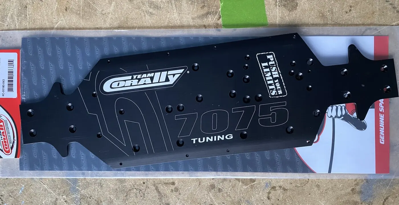

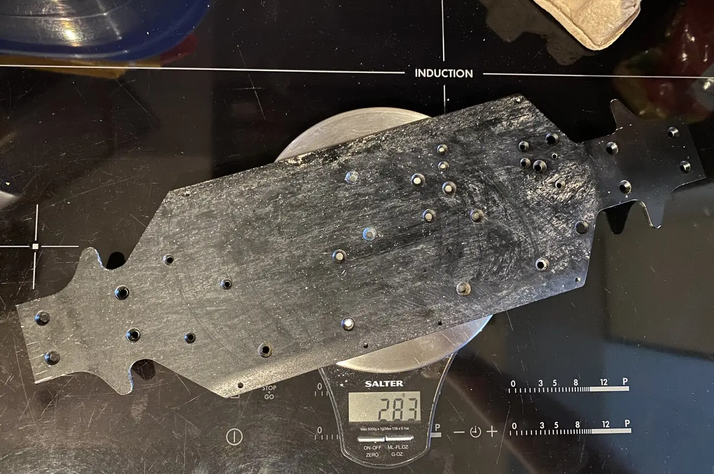

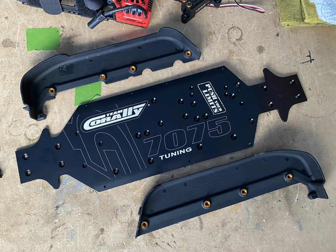

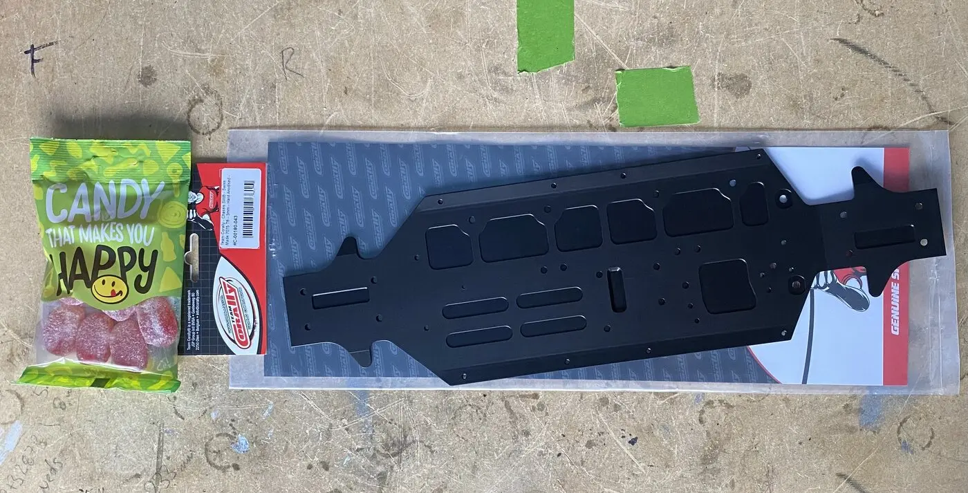

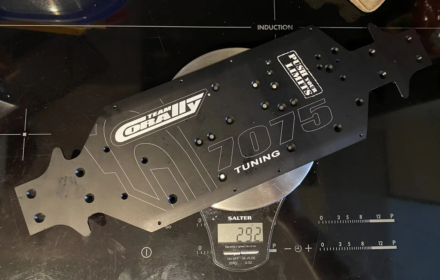

Here is a comparison of the chassis's weights
Stock chassis 283g
Swiss 7075 chassis 292g

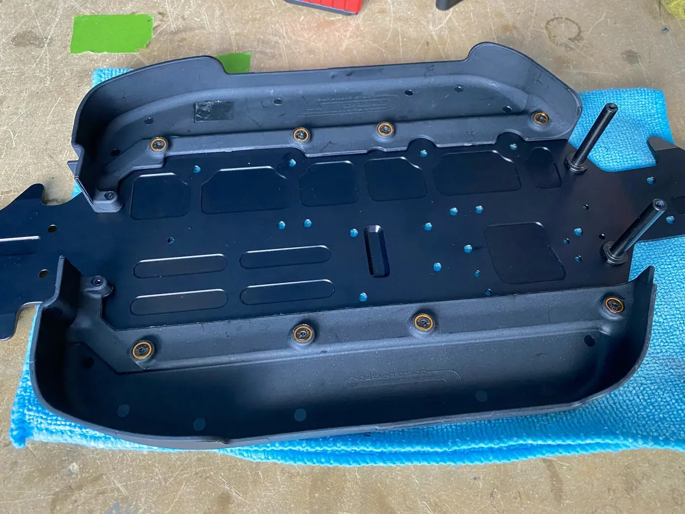

Underside of chassis
Inside the chassis, it's very nice quality machining and feels real nice and sturdy..😎

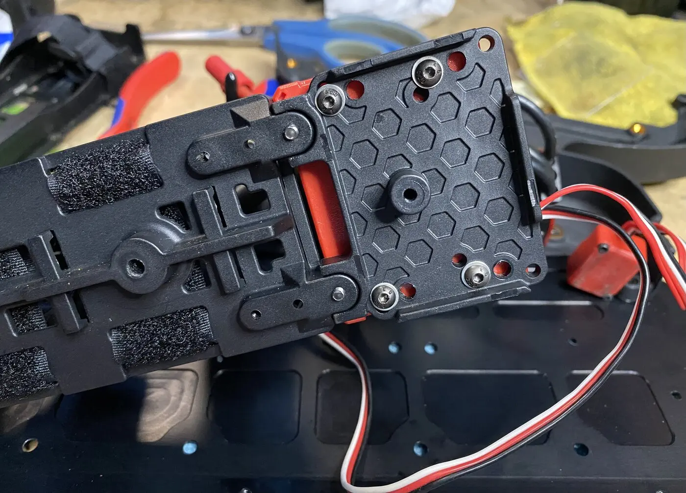

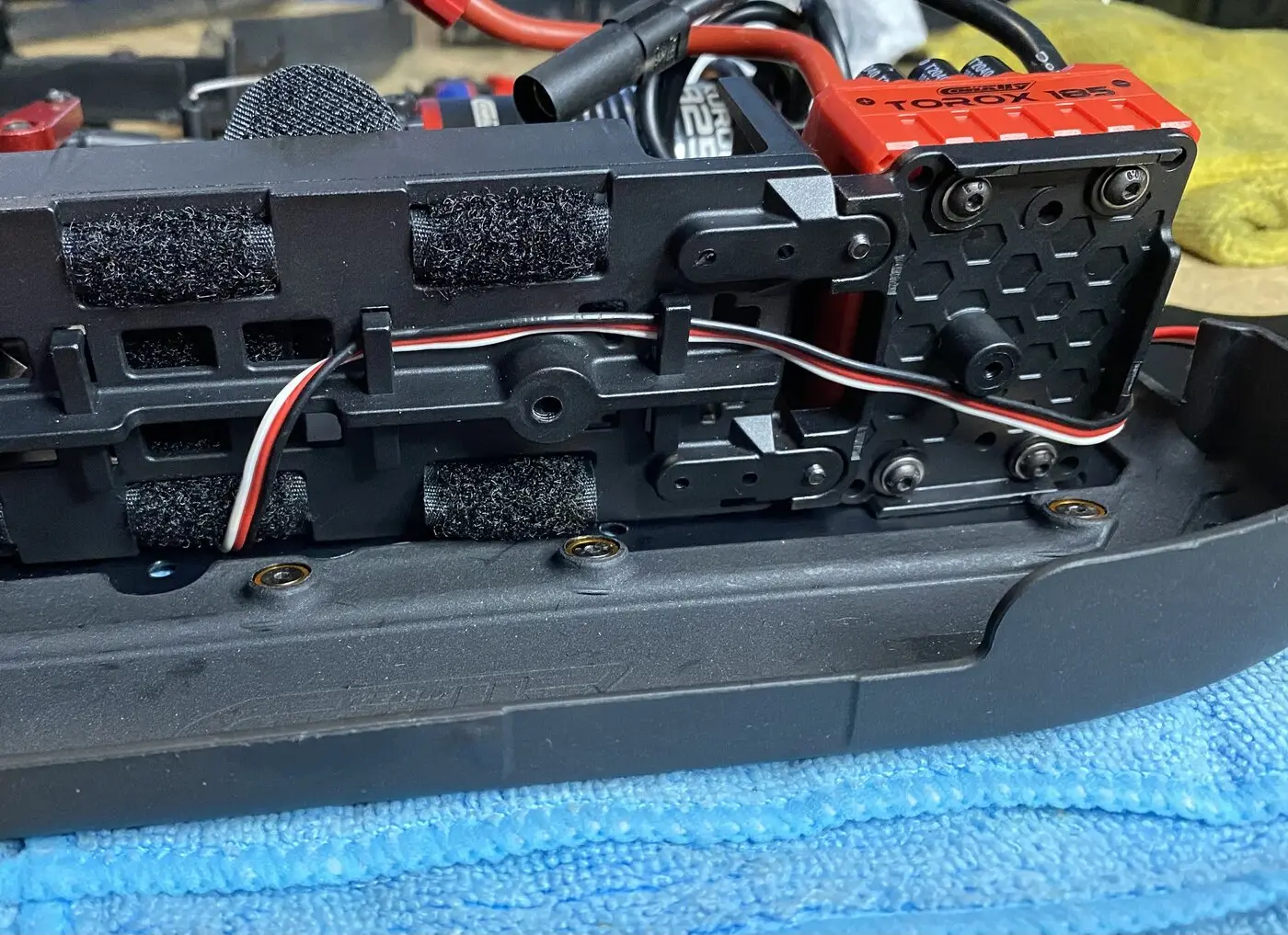

I have heard people mention that they fear that the esc cabling can get trapped under the battery tray, if you look there are cable hooks underneath that hold the cable in place.!!👍🏼
If you look at the the pictures ⬆️ above ⬆️ and ⬇️ below ⬇️ you'll notice that I have repositioned the esc slightly more forward on the tray, this helps the tray not flex around as much.
In my opinion the v2 battery tray bounces at the rear end too much where the esc is mounted, the mounting hole doesn't match with any holes in the chassis 🤔

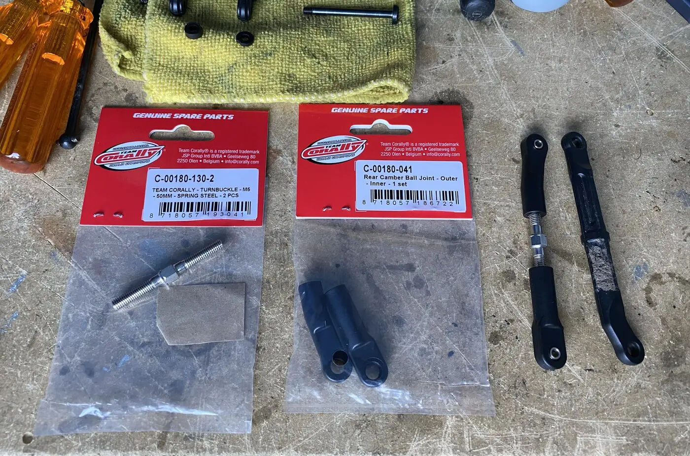

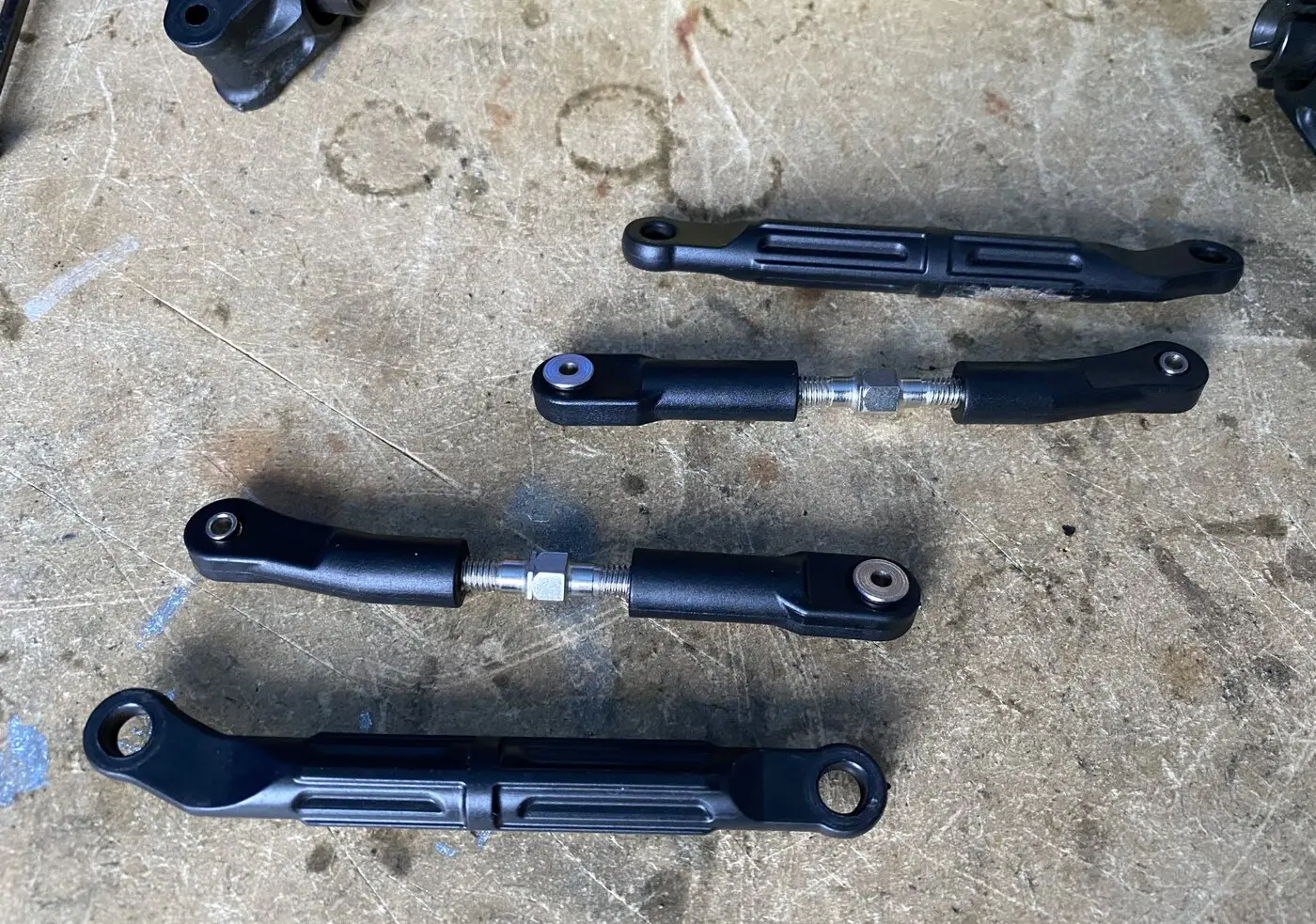

I quite like the one piece plastic turnbuckles they are just simple and work well, but I like to adjust stuff 😉 so in went the spring steel upgrades in the rear and the steering..
Waiting to be reassembled, I find that these Corally's go together well and nothing is hard to work on 👍🏼
Close up of the turnbuckles...
I noticed on some of the other Corally's that the turnbuckles don't all face the same way, you'll notice later on that I've fitted mine so they all face the same way, this is done so that when adjusting them they all turn in one direction..!!
If you look closely you can see a grove marking on the steel nut part and that indicates the direction, the groove faces the left of the car when looking from behind.. ( this is done because the turnbuckles have left and right handed threads )

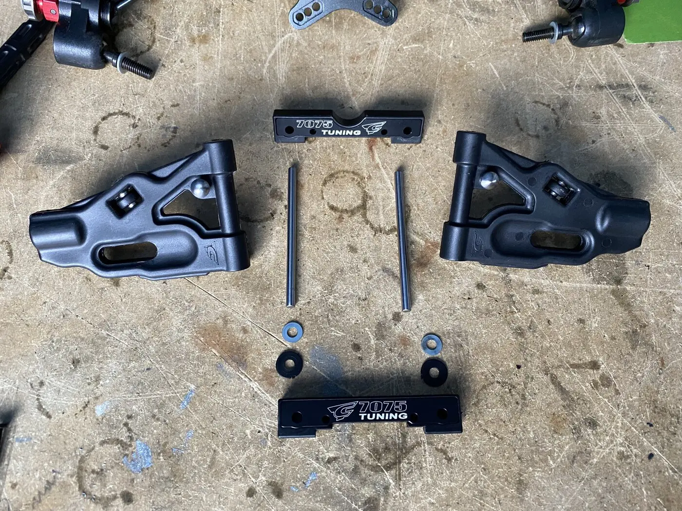

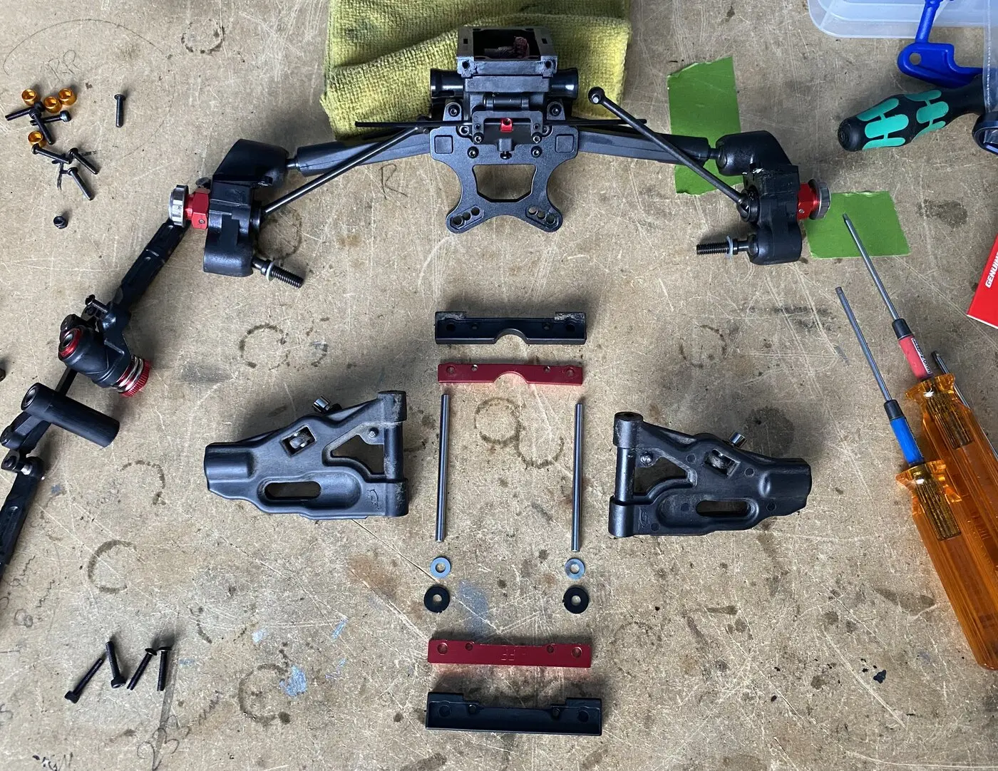

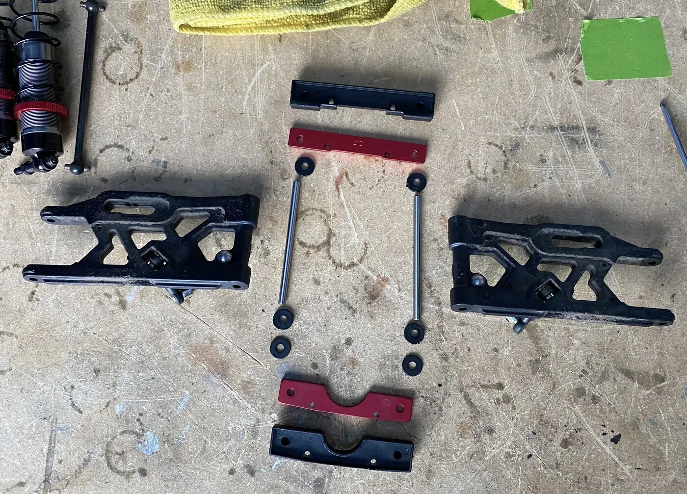

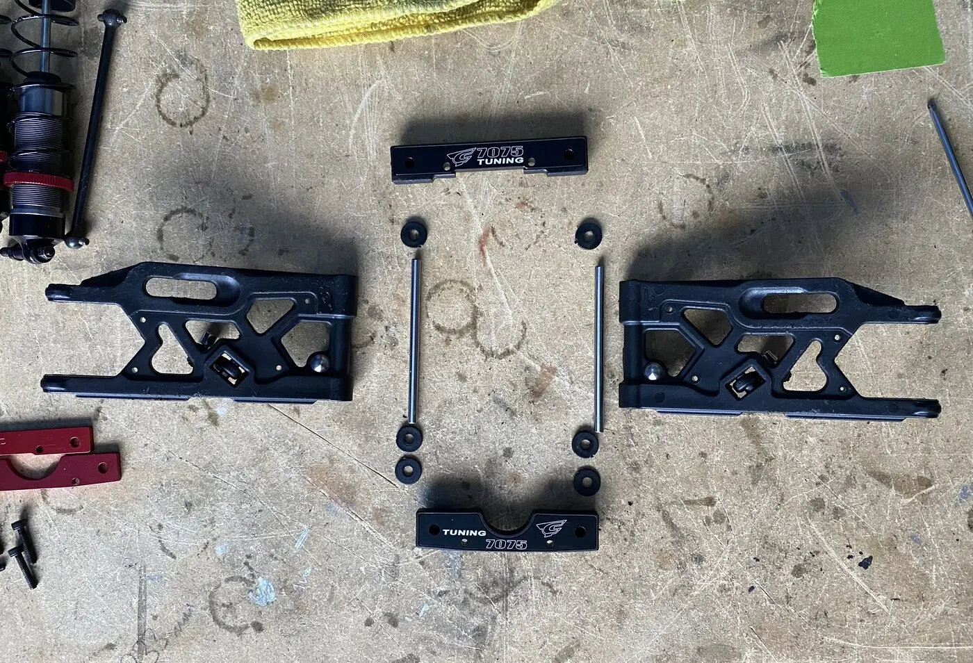

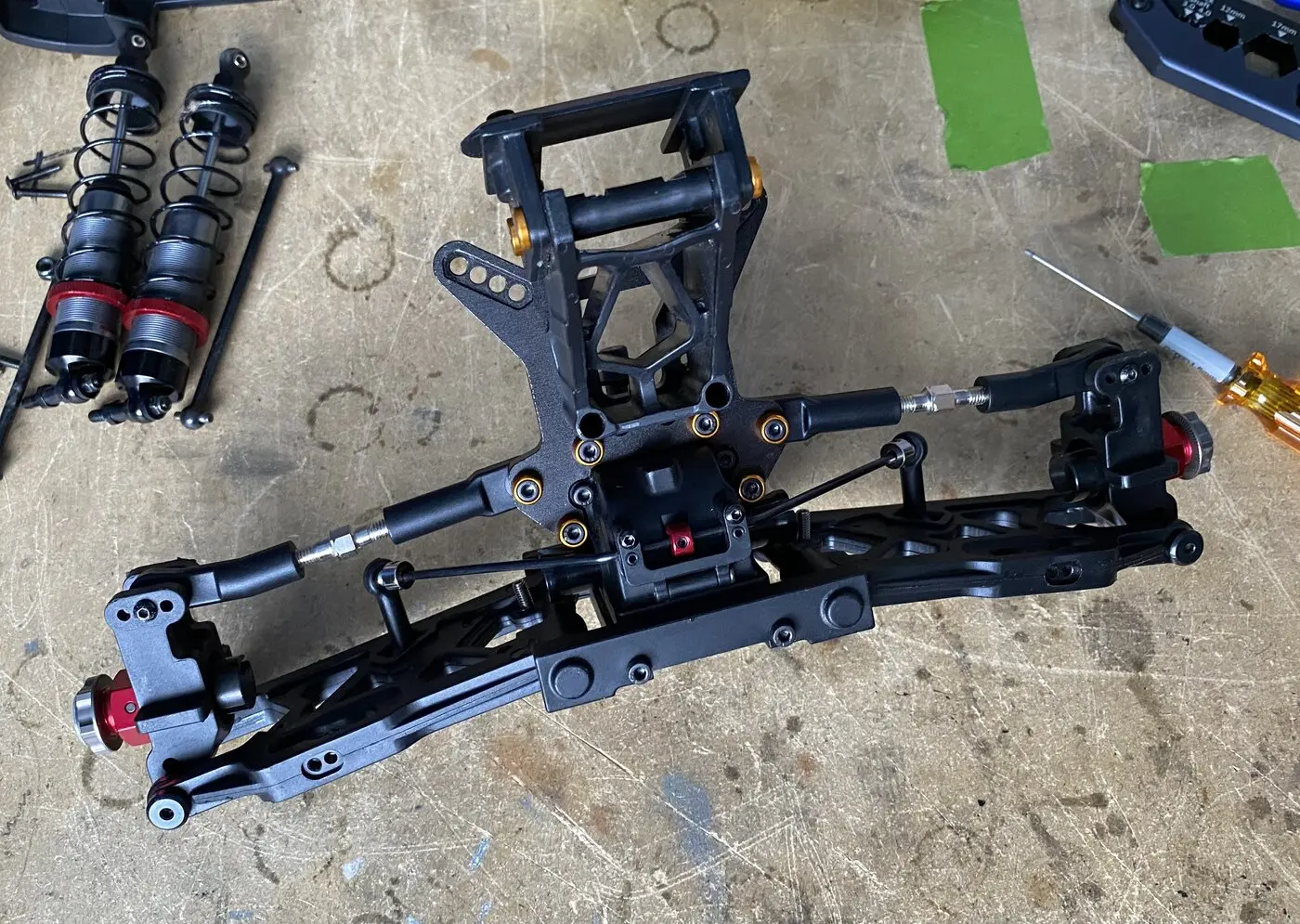

Rear end all stripped down ready for new parts, you can see that they use plastic and/or metal spacers to adjust the arms ( some slop correct too )
I fitted the Swiss 7075 suspension holders..😎
All back together ( liberal use of orange washers 😉🤣🤣 ) You can see more of the cap head bolts used all over the rear suspension.

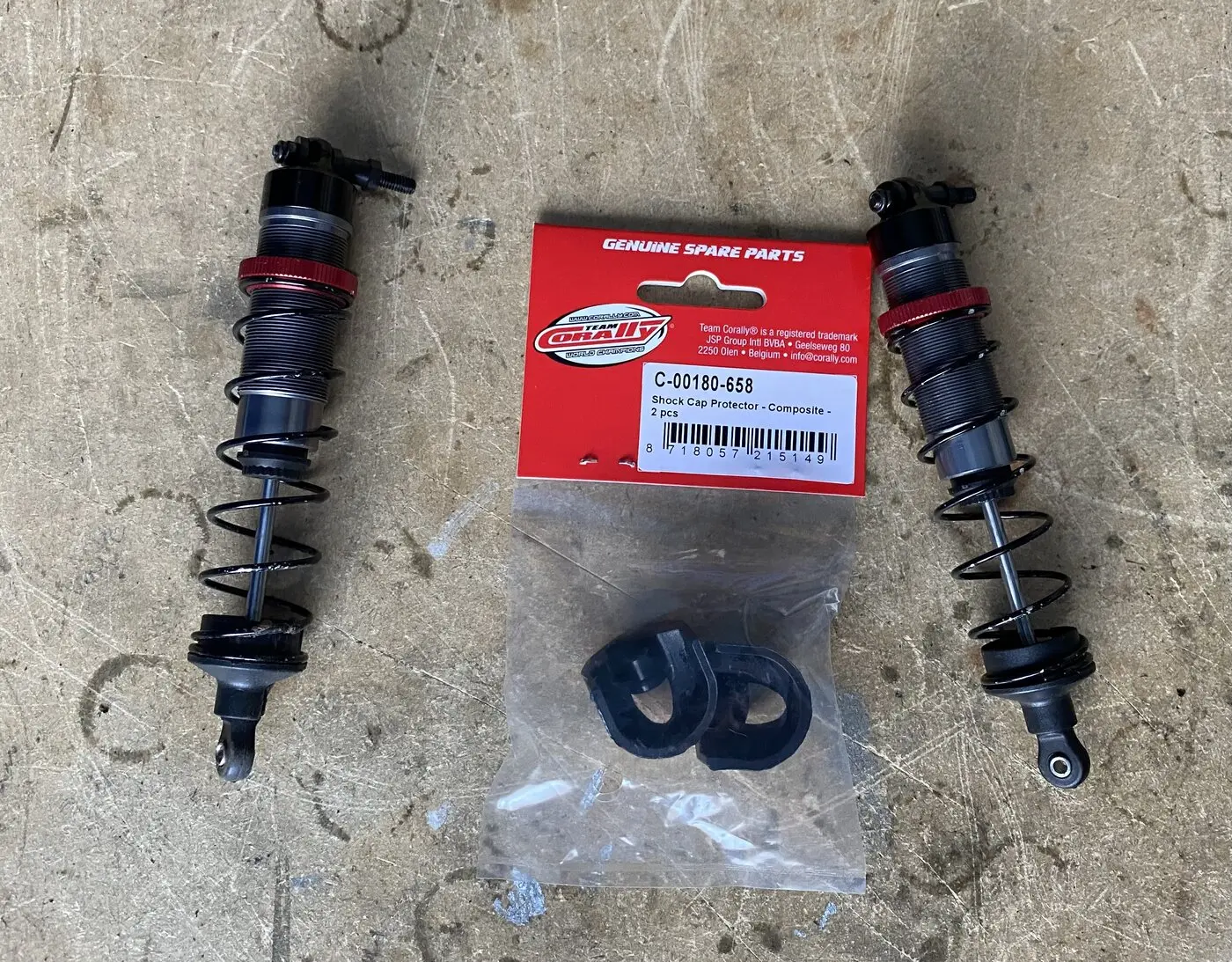

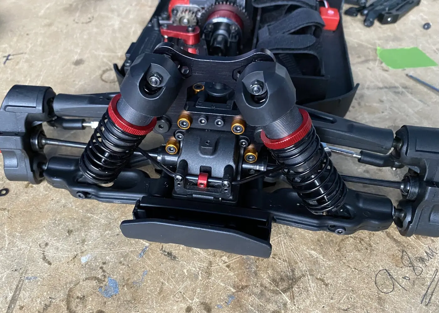

Shocks got treated to the new shock covers front and rear..👍🏼
They are quite clever in that they replace the stock top shock bush as it's built into the cap protector, a truly worthy upgrade in my opinion..!!

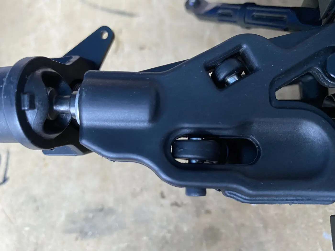

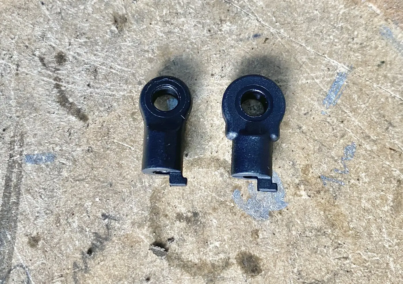

Also fitted the HD shock ends to the shocks, not really needed on a buggy to be honest but wanted to try them out.
What I did find out though and mentioned this elsewhere on the forum is that the HD ends bind on the arms..!!
As you can see below the HD ends are quite a lot beefier than the stock ones 👍🏼
You can see the binding of the HD end in the lower arm, I would suggest that you could either file the arm a small amount or maybe even trim the shock end slightly. I chose to do neither and will just let the end or the arm wear itself how it wants.
( the binding isn't enough in my opinion to hamper any suspension travel, but you can feel the bind slightly when the shocks aren't mounted at the top.!! remember this isn't a race spec buggy so I think you'll be ok 😉)
I believe Corally will redesign these arms eventually into a v2 spec to toughen them up at the shock end bolt mounting and to also open up that gap for the HD end..!!

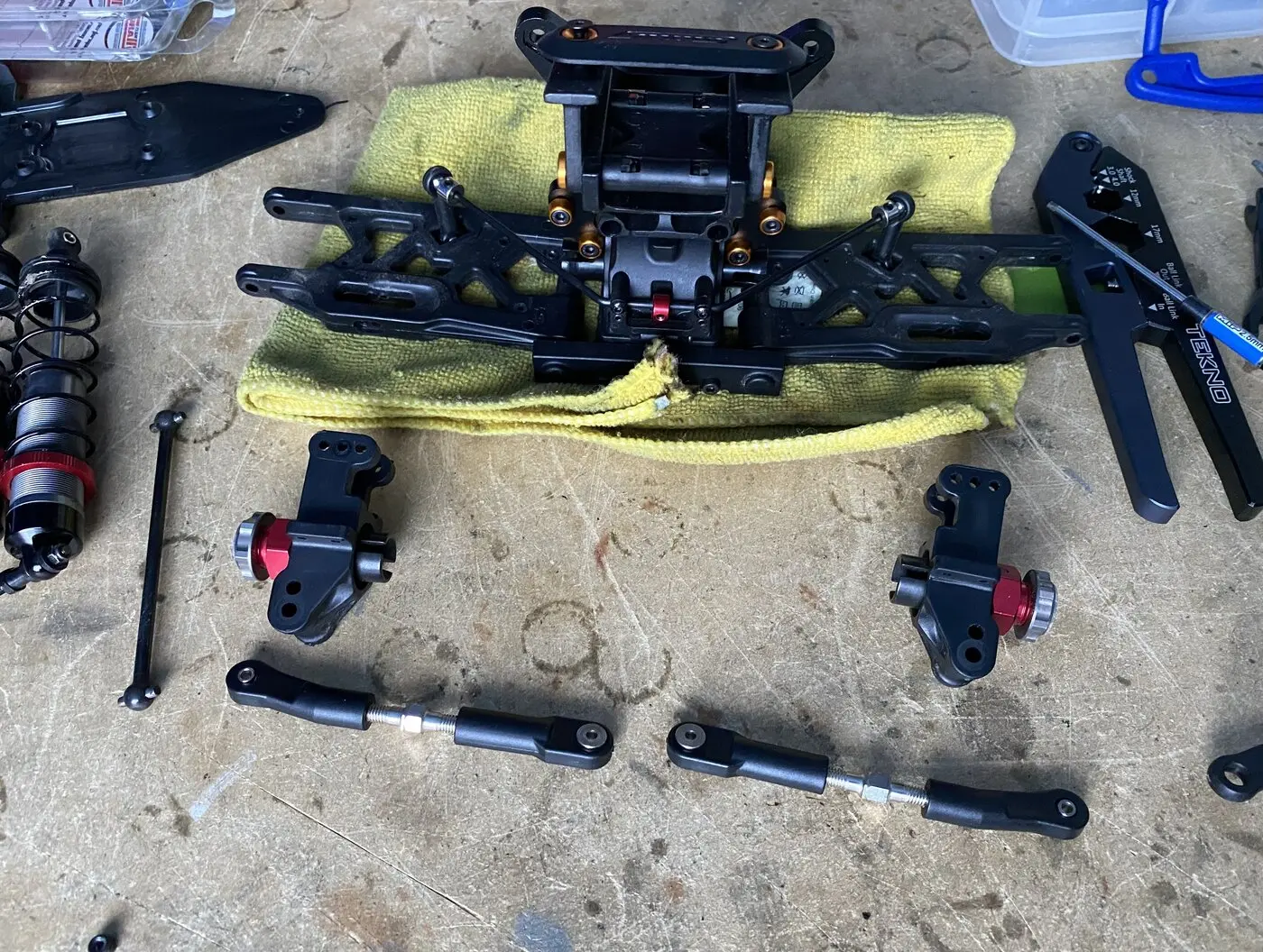

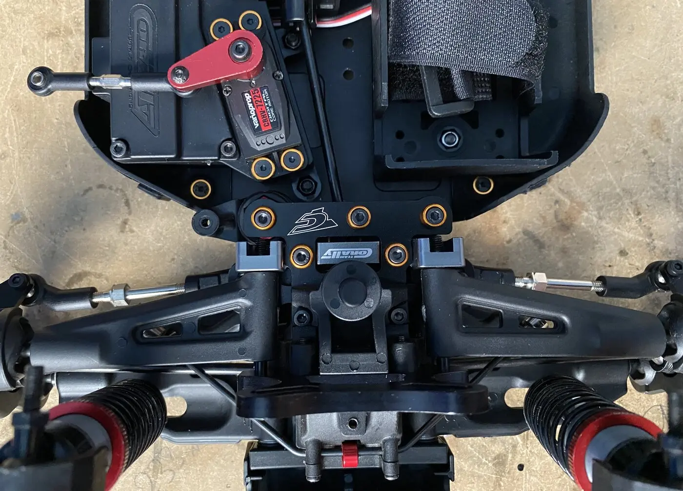

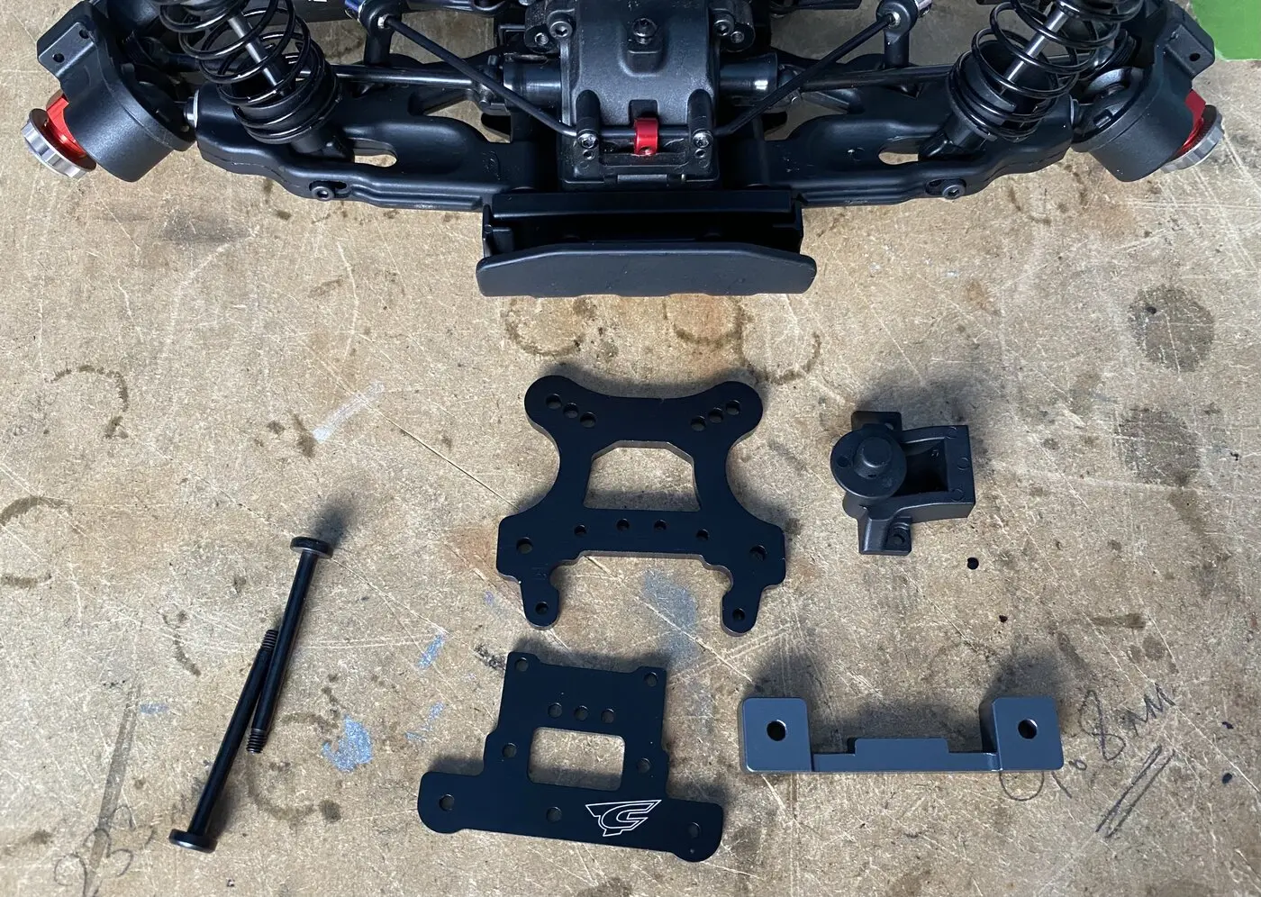

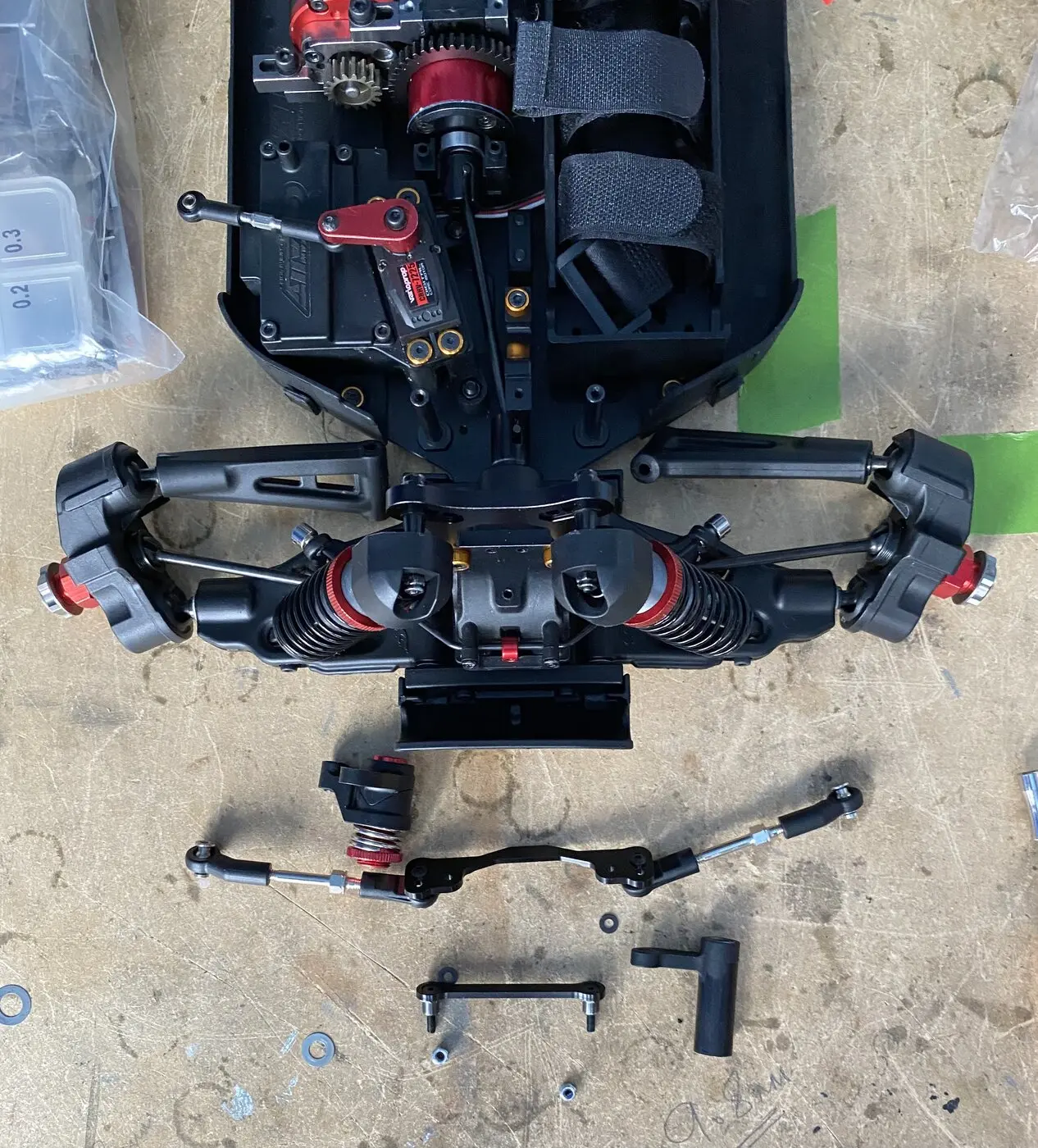

Front end all stripped down...
Swiss 7075 hinge pin holders front and rear

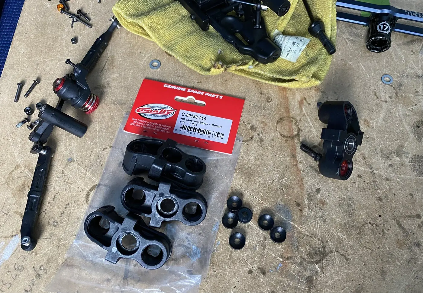

Took this opportunity to fit my complementary HD steering blocks ( Thanks Corally ❤️ )

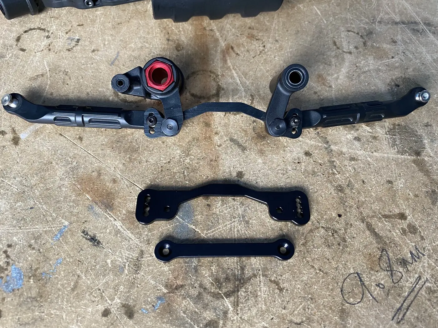

Close up of the stock steering top plate and related parts.
4mm shock tower with pills, plastic top plate with insert.
Swiss 7075 Ackerman top and bottom plates

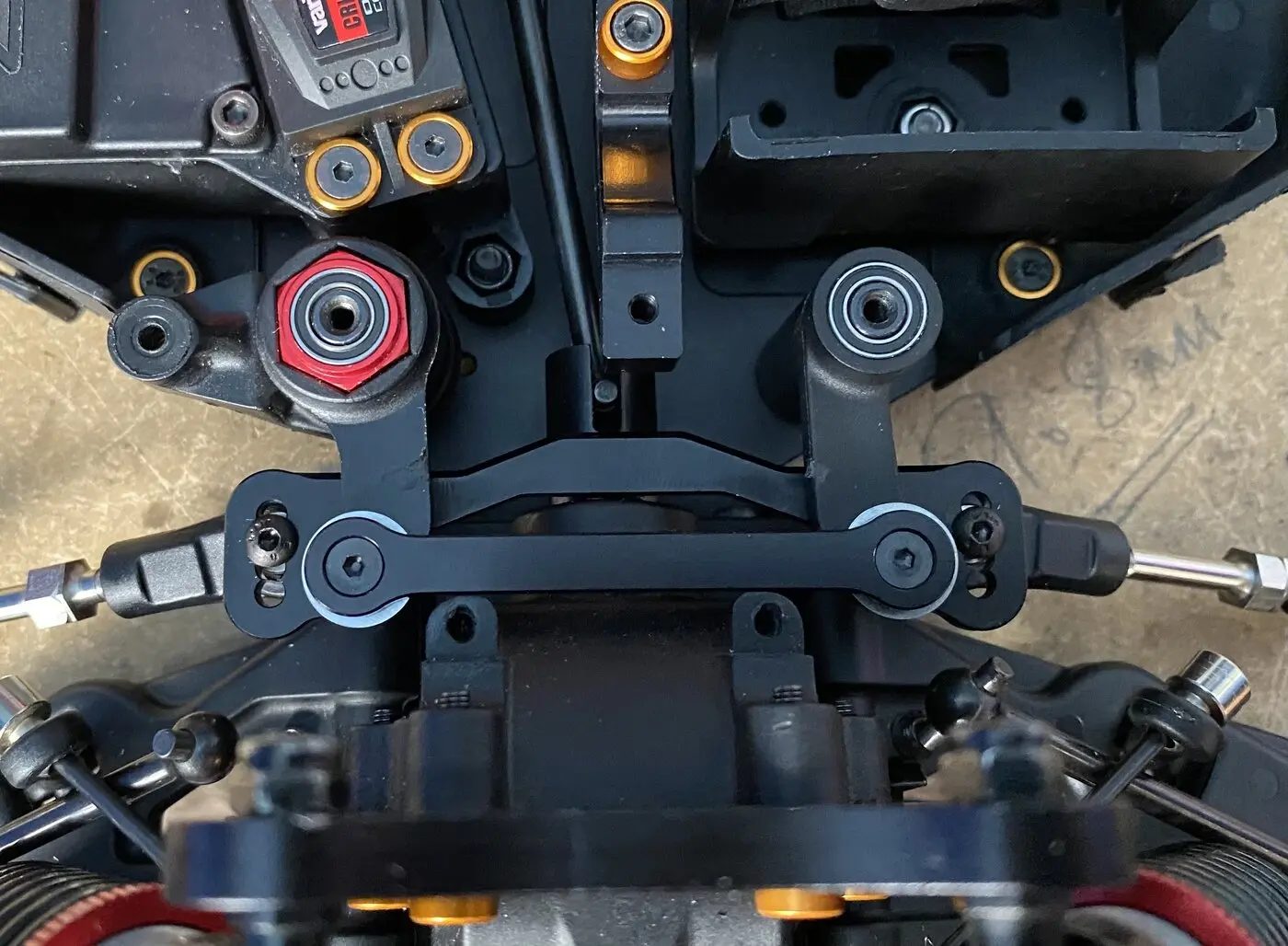

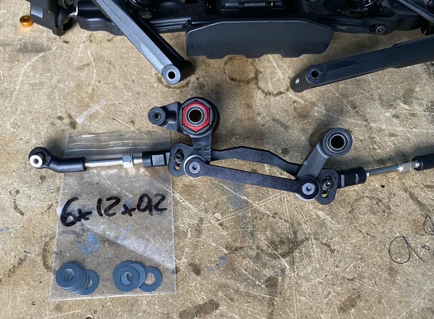

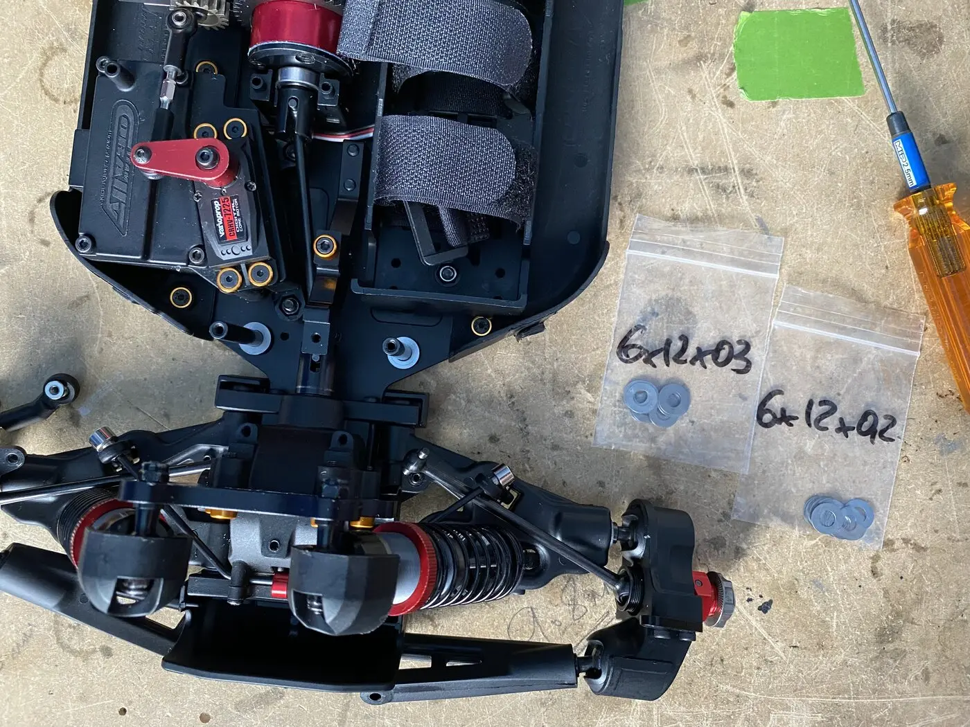

This far into the build and only now I feel the need to add extra shims, when I assembled the new parts there was some slop in the steering, servo saver and Ackerman. Below you can see what I used complete with the measurements of said shims 👍🏼
I love the fact that the Corally's come with bearings in the steering and not cheap ass bushes..!! ( here's looking at you Arrma 🤔 )

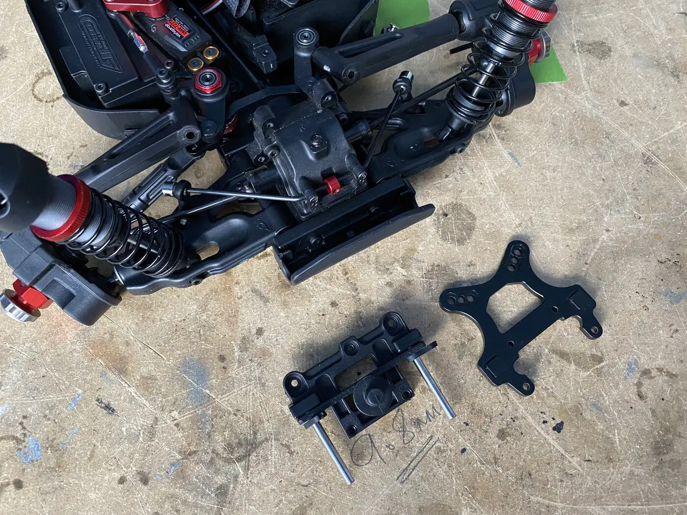

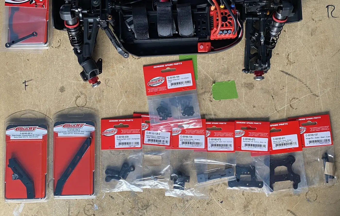

Below are the parts to upgrade the steering to XTR spec plus I also fitted the 5mm shock tower 😎
Top plate, arm holder, arm pin bolts and body mount brace mount

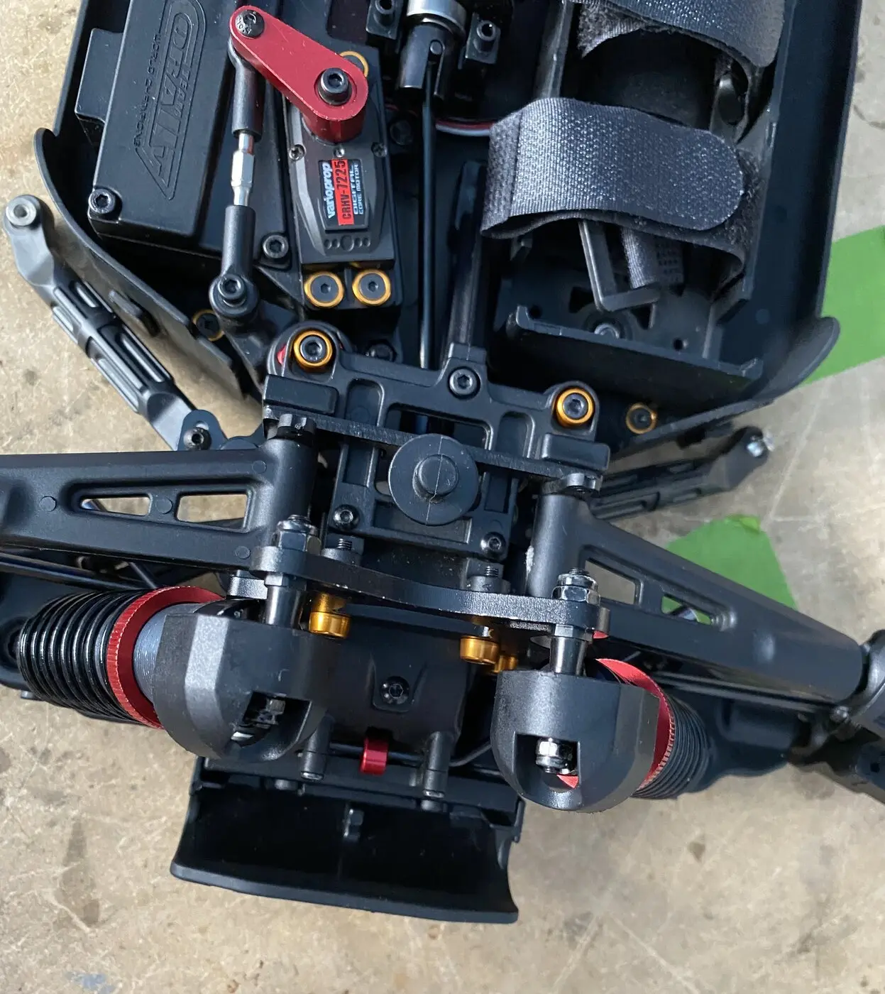

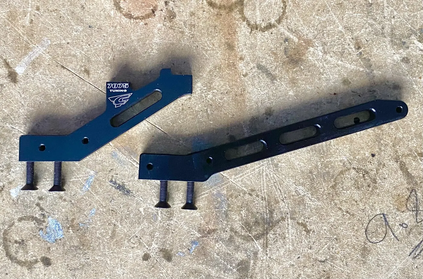

Swiss 7075 chassis brace's front and rear, love the way they use dual 4mm bolts in the lower position ❤️👍🏼
Almost done 😉
