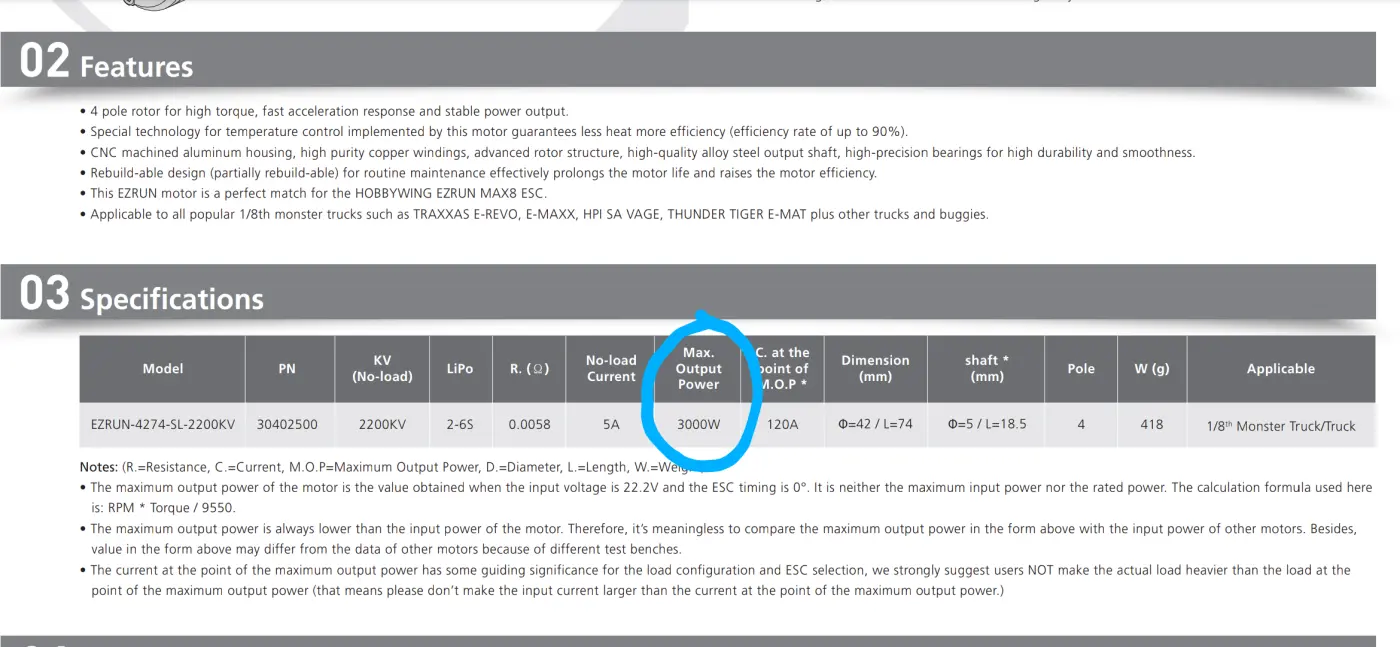

Max 8 combo is what people say the Corally electronics are based on - yet, a number of reviewers are quick to point out that these stock electronics are noticeably faster. The Torox 185 and Kuron 825 seem to be tweaked by Corally.

The 2050kv 4174 is 4.02 HP!! 😳
Getting a bigger can motor with more torque will pull higher gearing and run cooler, but then it's going to be heavier and require lifting (higher CoG) or modification to the side guards.
Max 8 is 4274, so is physically different, the 2200 kv is also rated at 3000w.

Suggestions recommend upgrading to the G2 max8, isn’t the Torox a cloned max8. So even with the HW 4278 I am not gaining anything that warrants spending the money. I am looking for more speed. Heat isn’t really an issue as I don’t run it hard for long. Is the Castle 1515 V2 worth doing or a TP 4030, 3500kv @ 6S sounds great on paper but what ESC would be needed as it’s 204amps. Not looking at going to 8S as this is too costly.
