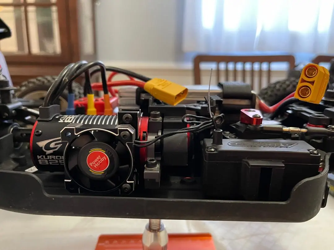

This is how I mount a fan on my Radix6. The fan in the Radix is situated in this manner because the body is so low at this point that the fan can't be on top of the motor or even mounted on an angle. Corally offers a 40mm fan mount that attaches the fan to the chassis in the same position as I have mine installed.

I use fans primarily as a safety measure in really hot weather: as the old saying goes, "It's better to have and not need than it is to need and not have".
My Castle 1717 1650 does not need a fan: even when I ran it hard in upper eighty degree temps for 20 minutes at nearly full throttle, I could never get the motor temp above 120 degrees. The Traxxas 2200kv motor in my Maxx doesn't get hot without a fan either.

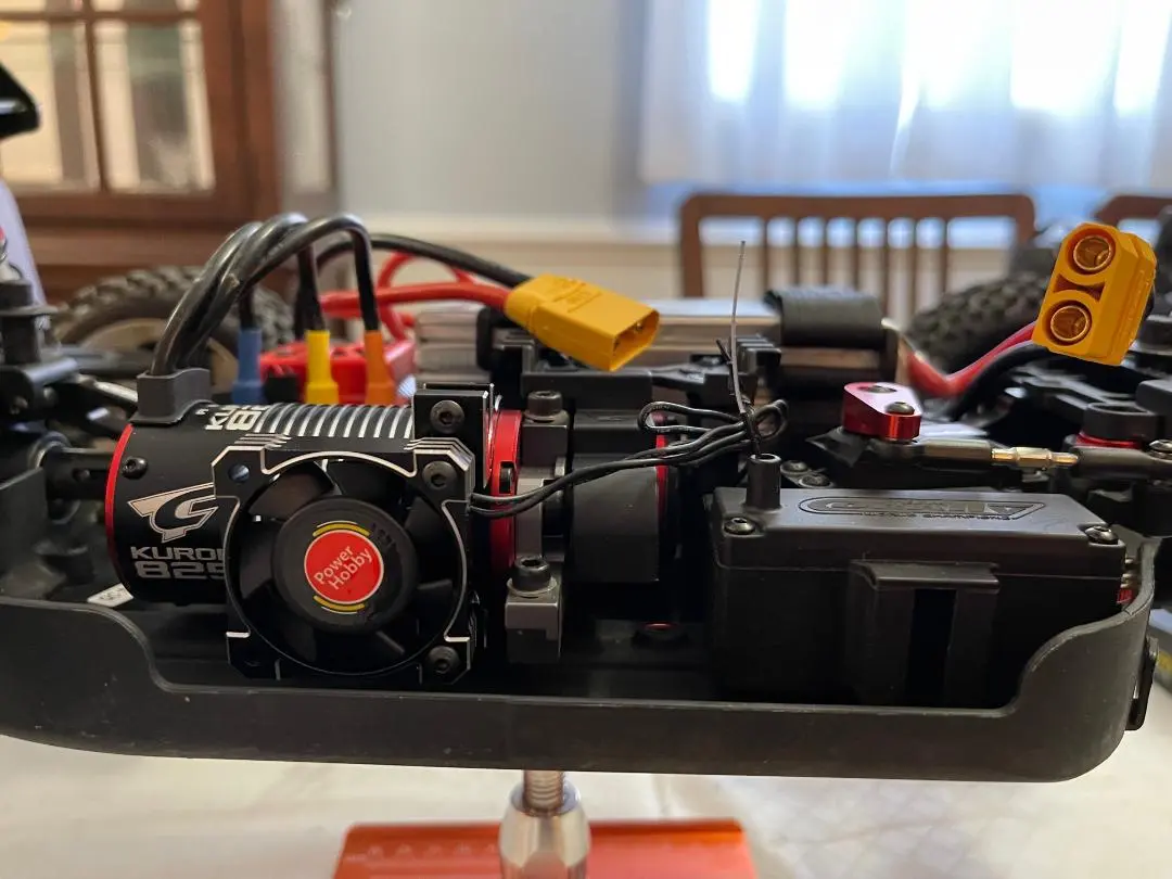

I will run without a fan on the motor first. If that works i won't install it. It is obverpowered anyways then on 4s so it should not heat up much i hope. On the Kuron 135 with a corally fan mount it heated up. I changed it. Worked better. I am not a expert. I just learned from experience.
