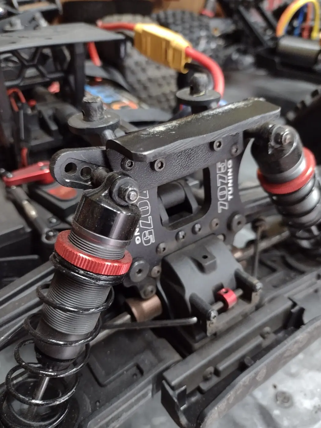

Hello, new here but I do have a solution, based off my experience I'm guessing the op is talking about the front standoffs, after breaking several I finally started looking at the truck and noticed bulges in my body, this told me the standoffs we're the first thing to hit the ground any time the truck landed on its lid, so I built an angled piece out of kydex that sits slightly higher than the standoffs, since this i have yet to break another on either my xtr or 8s Kronos, I'll attach a pic, the xtr has the shocks mounted in the lowest holes, 8s Kronos in the upper and it protects them the same regardless of placement

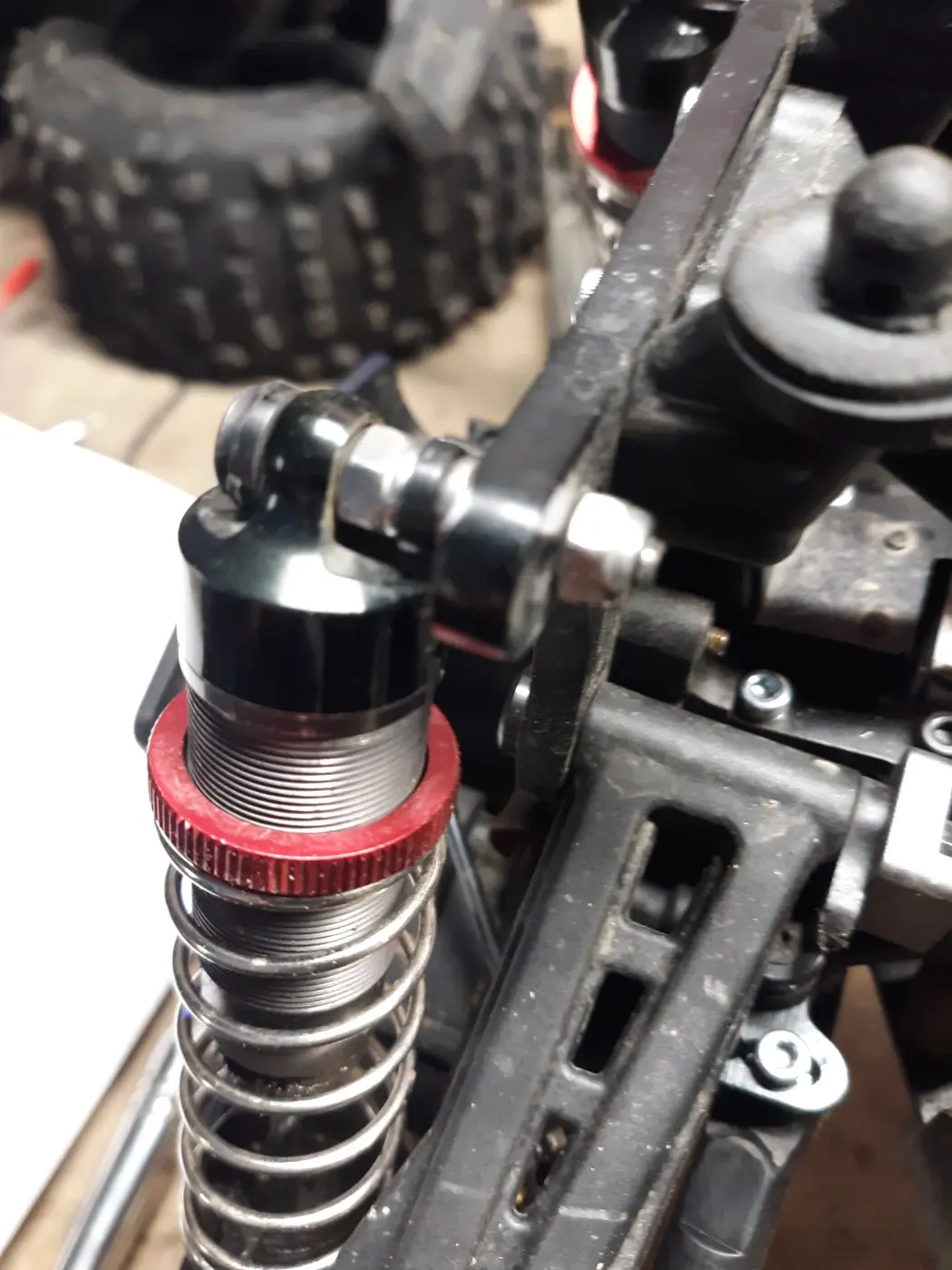

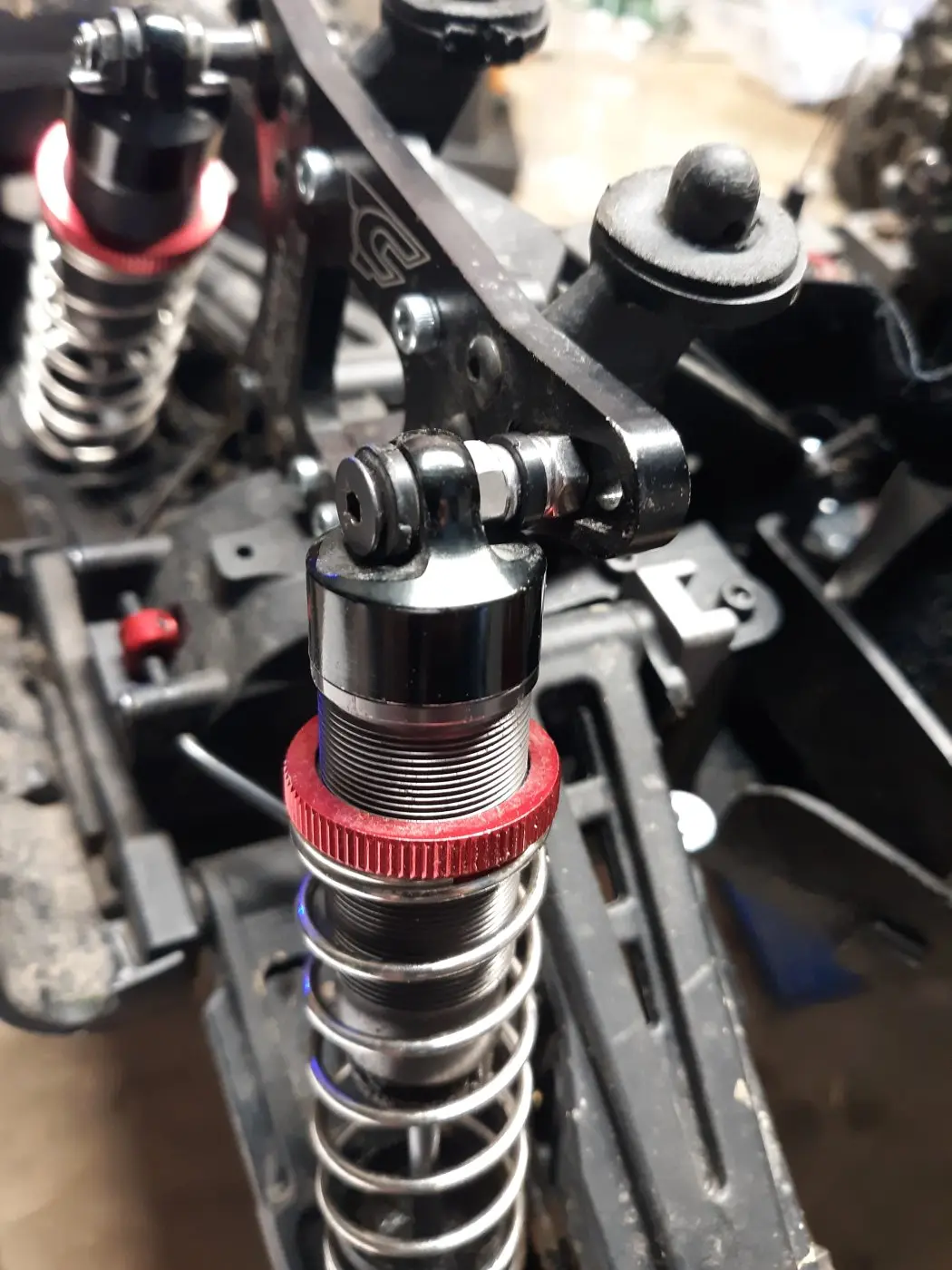

Soo, found a 4x20mm flat head screw, plastic spacer and 3 nylok nuts. Good to go!!
