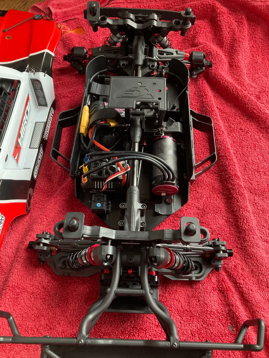

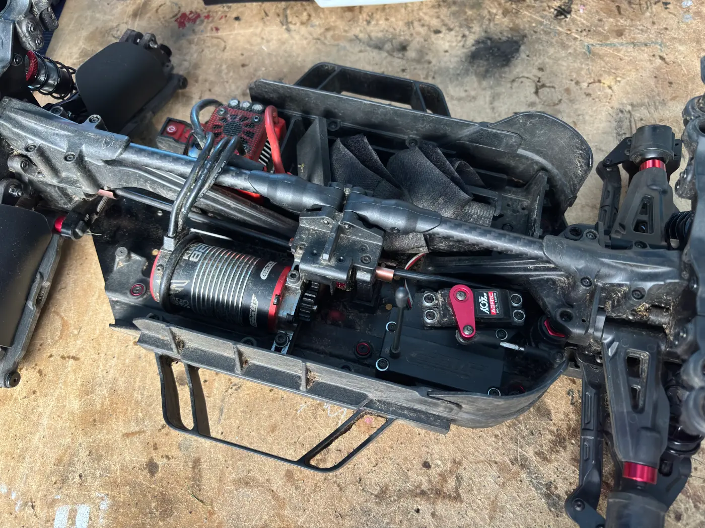

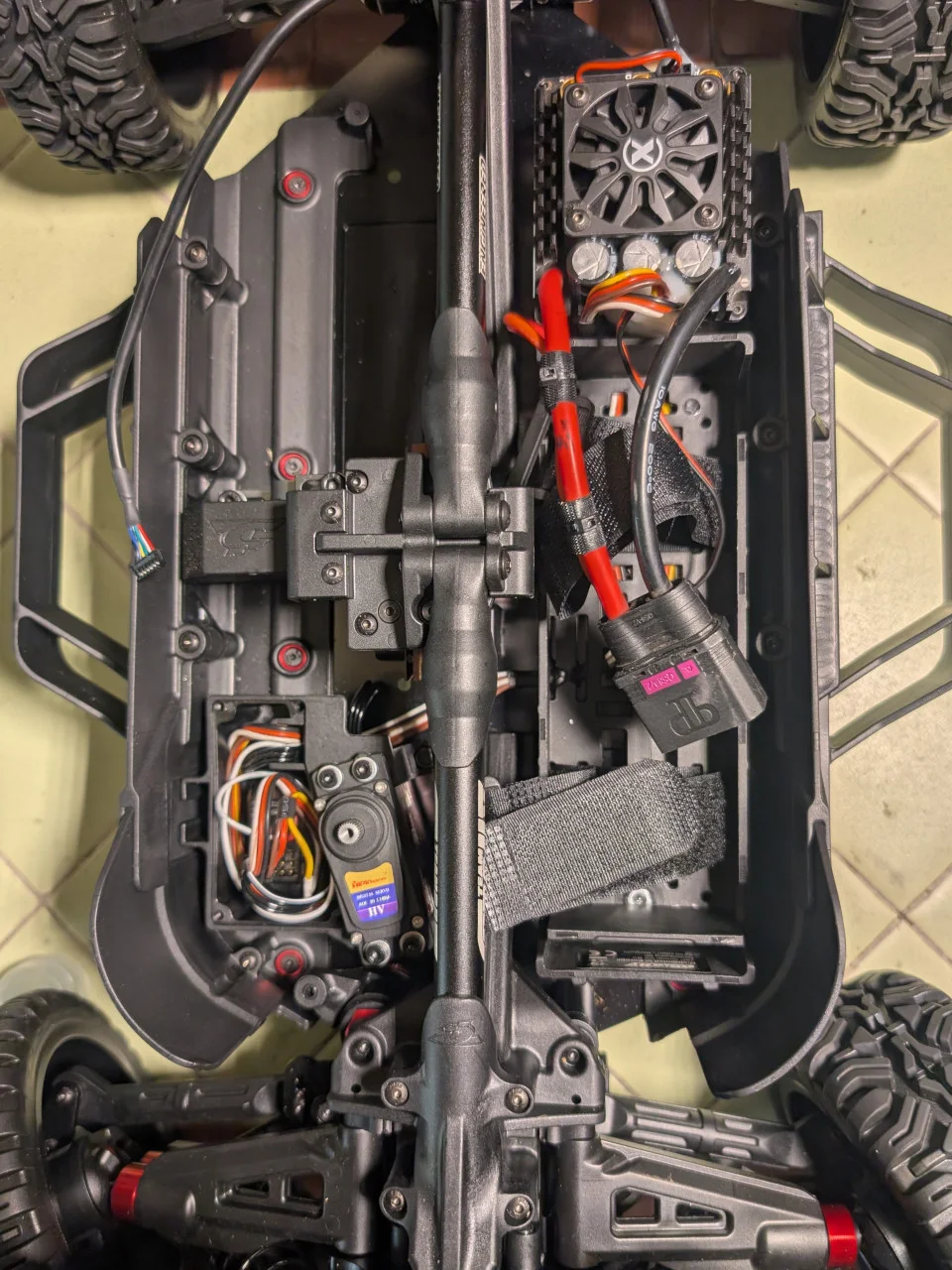

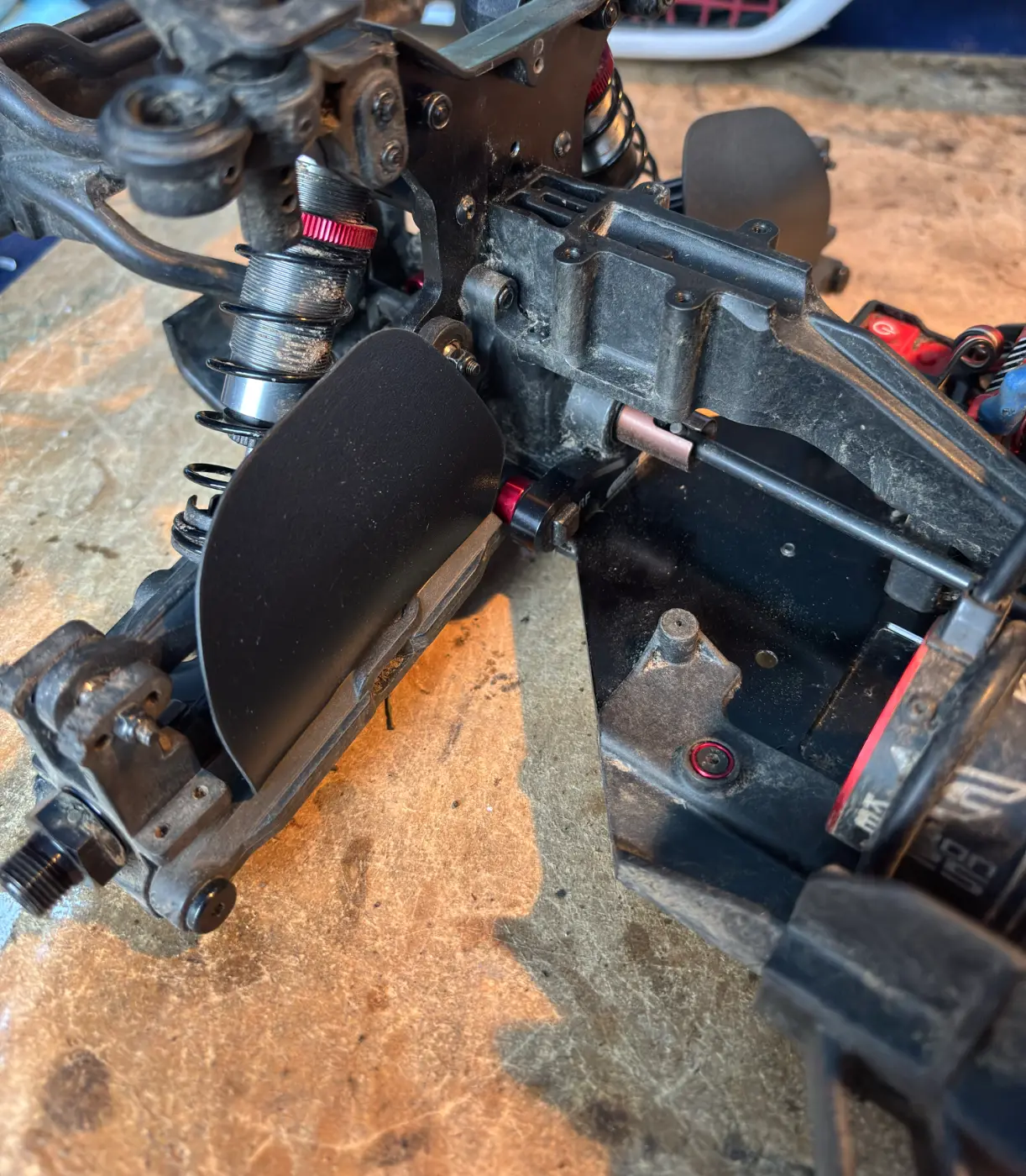

Can you post some pictures of those guards and braces?I found that 16T pinion or bigger and the motor mount hits the side guard..
You can remove the top 3 bolts in the side guard and remove it to give you room to remove and refit the motor..!!
Didn't get out today with mine, so tried some pinion swaps, also made some dirt guards and carbon fiber center braces..
I decided to fit the 16T pinion for my next run, going 6s, so that'll be fun..![]()
I think to go any bigger, pinion wise your going to need to swap out to the 46T center diff spur..
