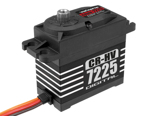

Your stock servo is this one, right?

Mind blown 🤯

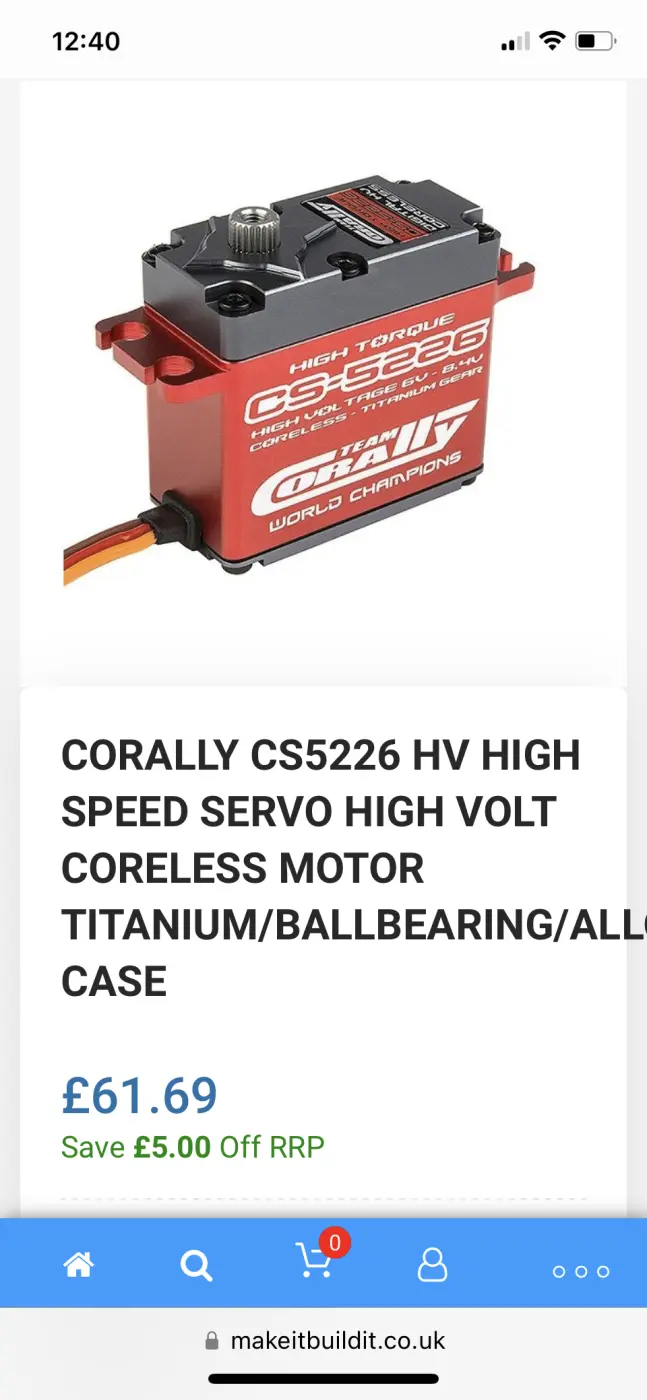

Yea that is the standard servo. So am I better (if I upgrade) to upgrade to the Corally one? It’s about £60 though.
I don’t really bash it, do a few jumps but nothing mental, defo no skateparks! Just raz a car park or field, hoping for some rollery jumps if poss. Neighbour has the Radix 6 so we make a course and race each other ( we have no other rc friends 🤣)

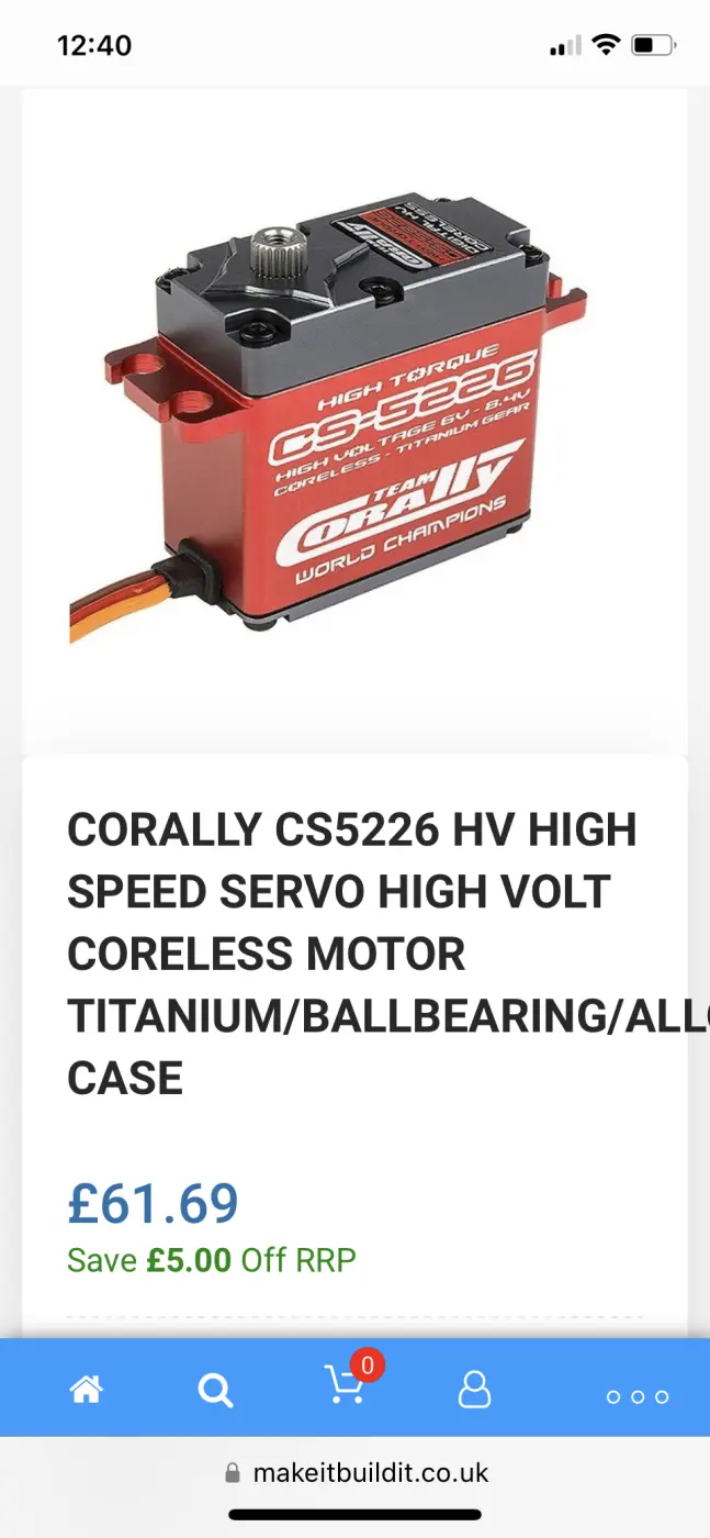

Attached is the TC servo upgrade, would it be worth the money? Although now mine seems fixed and ok for the use I give it. 🤞🏼 it lasts longer that the first one!
The servo you're showing is certainly going to be a more responsive/faster servo. Depending on voltage, it may actually have less torque. So depending on what you're after, it could be deemed an upgrade. 👍
