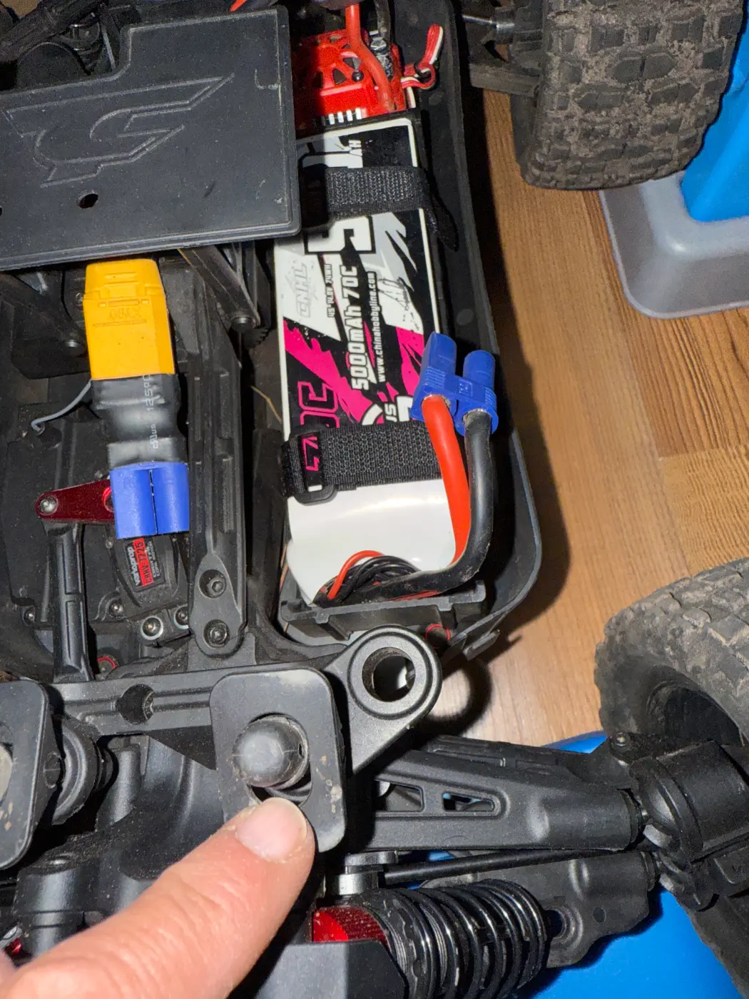

Installed new battery straps today on the Kagama4 much better for the packs I am using. Also saw some complaints on loose body fit, so my fix was very simple installed a thin O-ring around each of the towers they secure really nice once body pins are installed

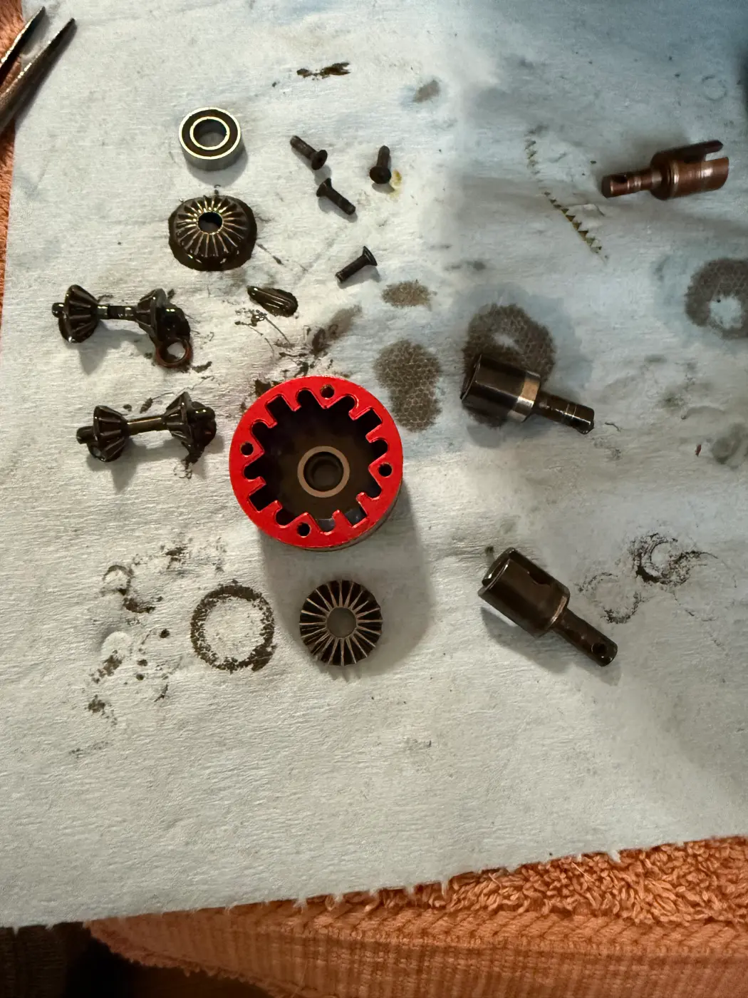

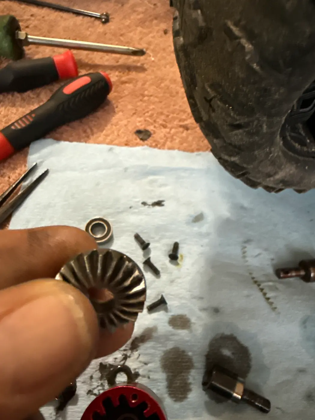

Huston we have a problem took the Kagama4 out for a test run and noticed an unusual sound seemed coming from the center differential. Just pulled down had extra set of spring steel cups I wanted to throw in and found 2 chipped teeth on the ring gear. Kinda disappointed I upgraded to the TC aluminum already built center differential it barely has any runs on it didn’t expect to see 2 chipped teeth already only good side is I have the original diff so I’m removing the ring gear from it installing on the TC aluminum then guess I should order some spares. You guys know if they offer an upgraded steel ring/pinion gear set. Thanks for the help as always guys
Looks like the diff was either shimmed too tight or or too loose or binding after overtightened diff screws. Normally those internal gears will last almost forever.
No upgrades for ring gear or input gear. Since those two will ‘match’ after some running, it’s preferred to replace them both at the same time.
This was all factory I hadn’t even serviced it yet. Going to order a new set and go from there
Strange, TC shimming usually is good out of the box. Did one of the diff bearings develop play, resulting in a wobbly outdrive causing the internal gears to ‘hit’ each other?
Well one thing that was strange is on the pinion gears they have the shim one on each and one side was missing a shim all together. That’s the only thing I saw that looked out of place of course other than the chipped teeth

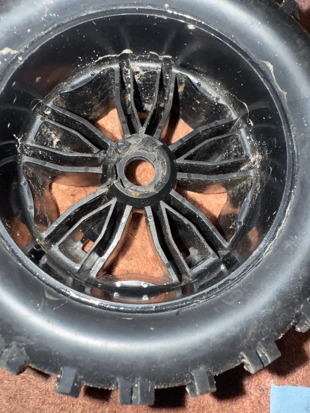

Welp the cheapo Amazon wheels couldn’t hold the power made a nice standard jump boom she was stuck. Walking noticed leaning to the right and what do ya know the wheel is a few inches away. Had the stock wheels but one had an area that came unglued, had some medium CA and used some thinner to clean the old away. This isn’t CA for rubber charging a pack now to see how it hold up. Guess I’m gonna need to learn how to do tires 🛞 next 😞
