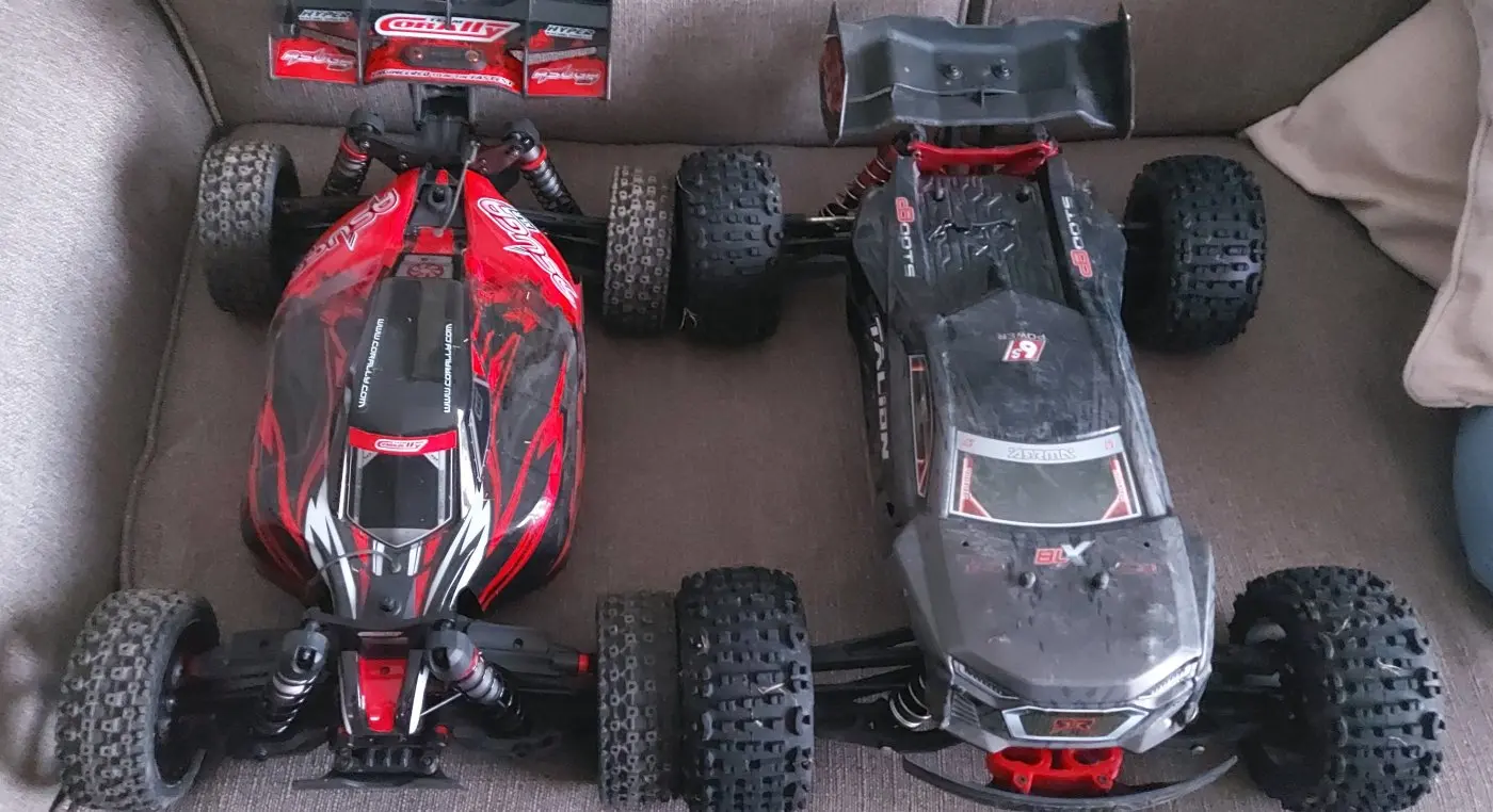

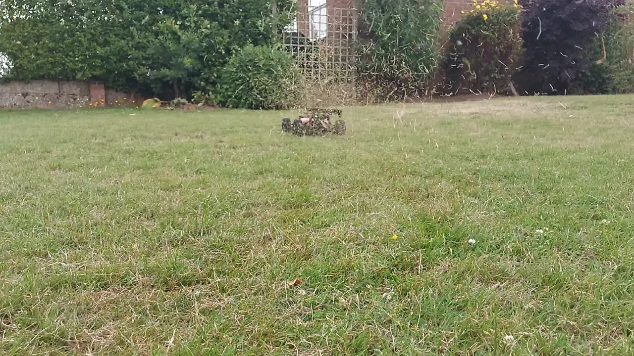

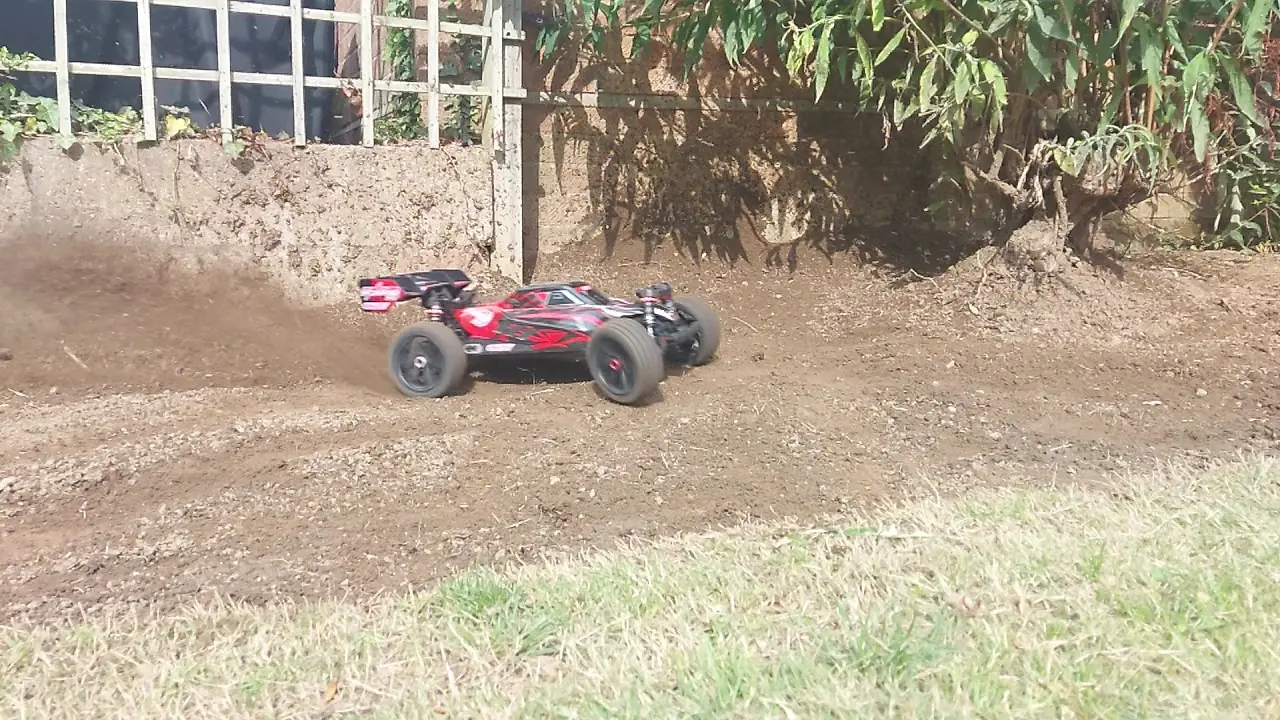

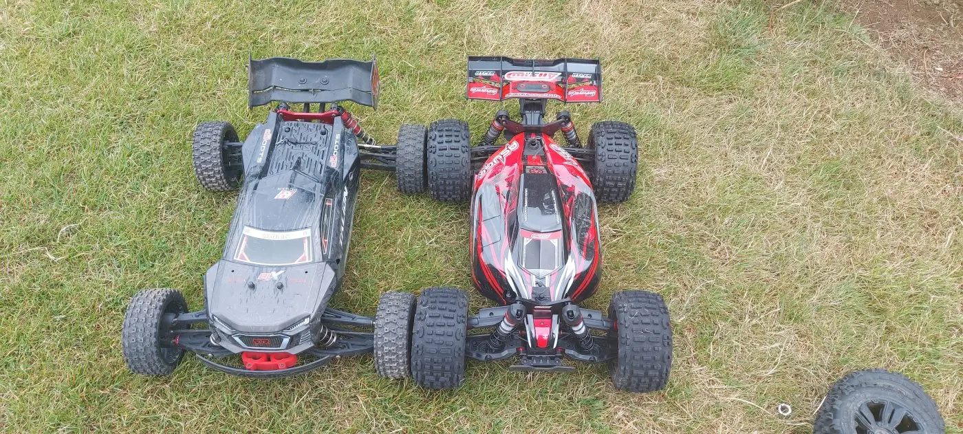

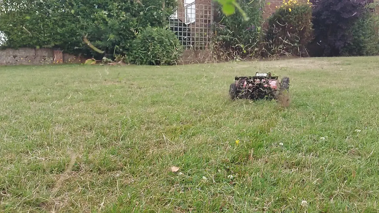

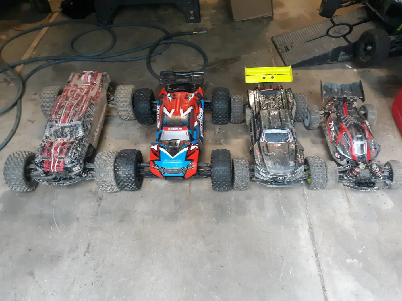

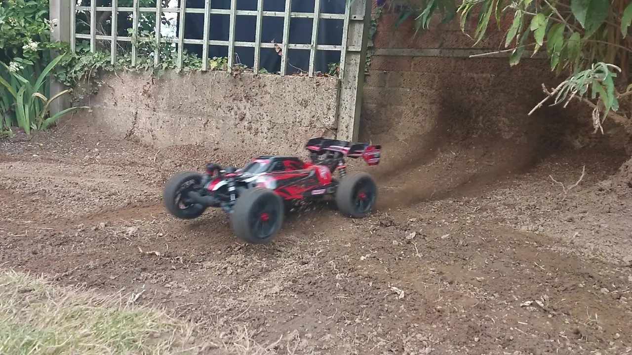

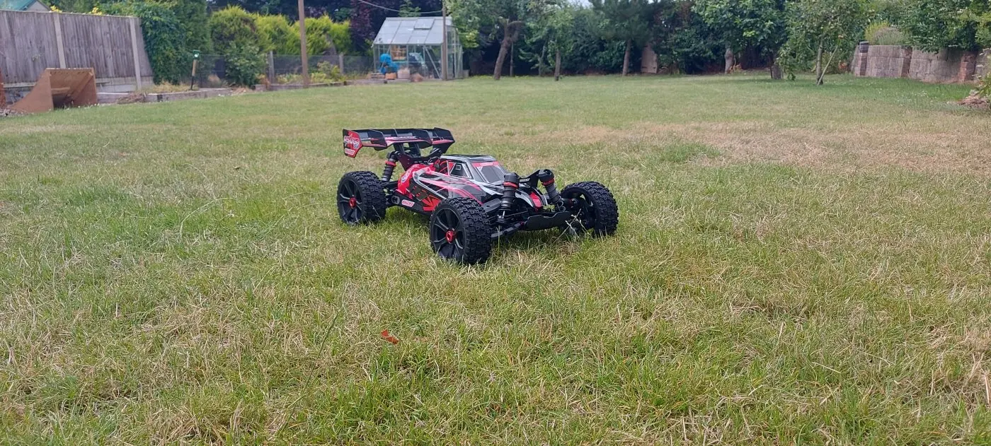

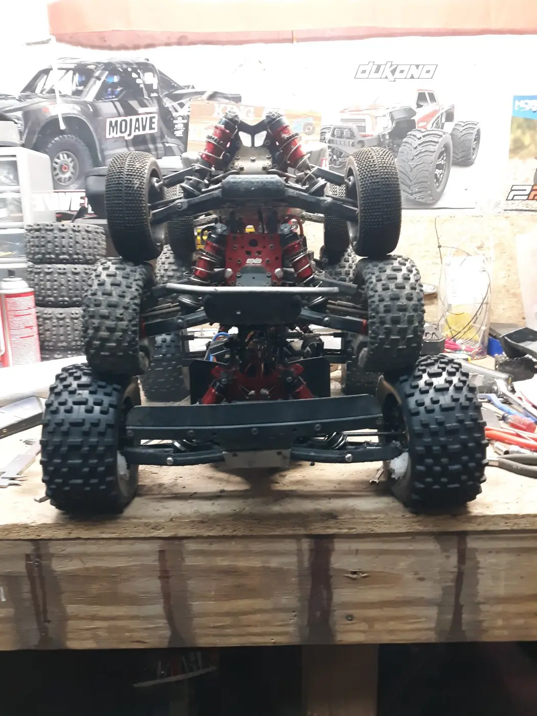

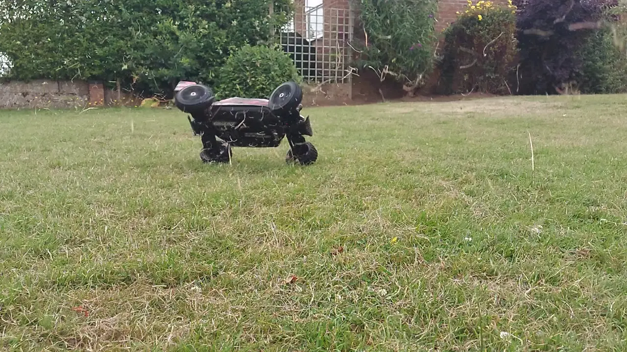

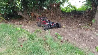

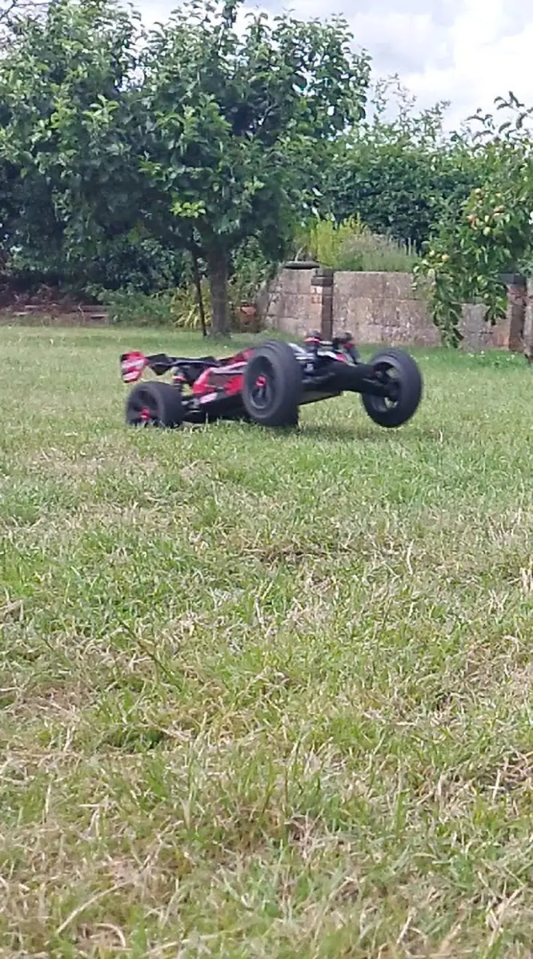

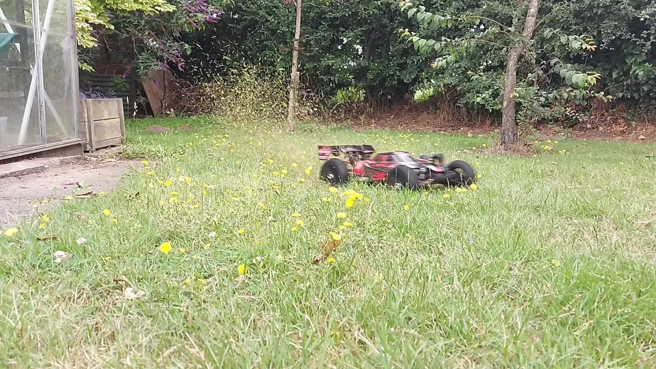

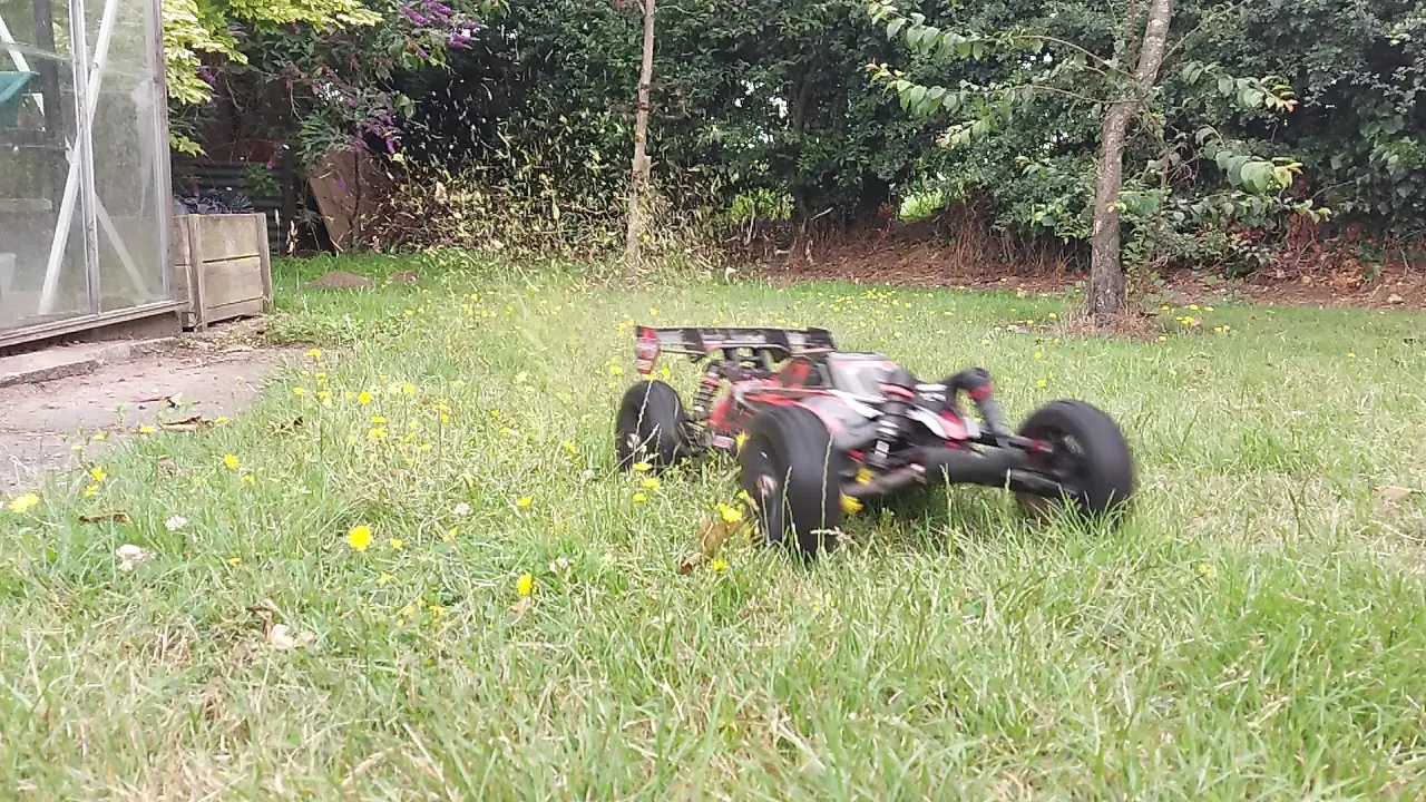

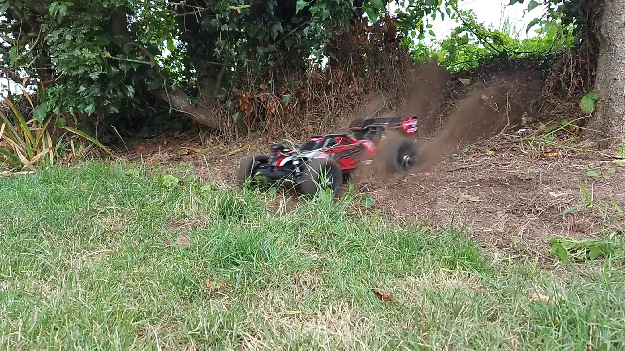

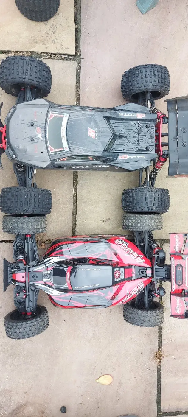

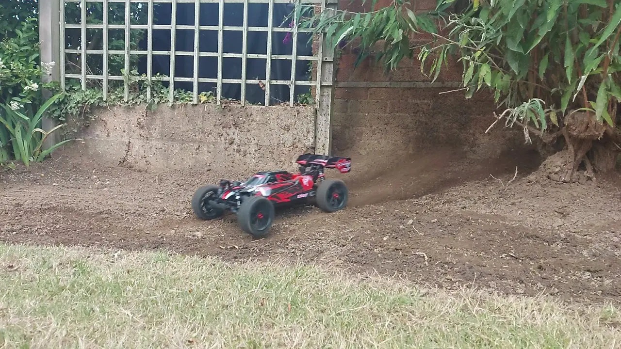

Hello everyone . Here is my review of my brand new asuga . 4s on 13t ( too slow ) and 16t ( not quite there ) over to 6s and 13t pinion ( fast ) and 16t ( very fast ) trouble with 6s is the front tyres turning to pizza cutters as seen in the photos , so out came the centre diff and I filled it with silicone plugs , this gave a 100% more enjoyable drive and no destruction of the front tyres . The photos in the muck is with a siliconed centre diff. Will I sell my typhon 6s or kraton 6s , naaaaa they'll take some beating. Took a little extra time to get the centre diff out cos of the brace system . Needs a fan of the motor too , got hot on me grass
