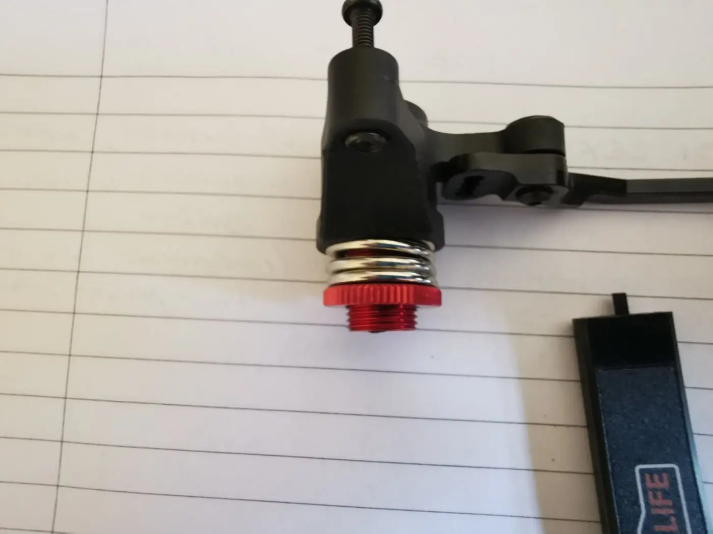

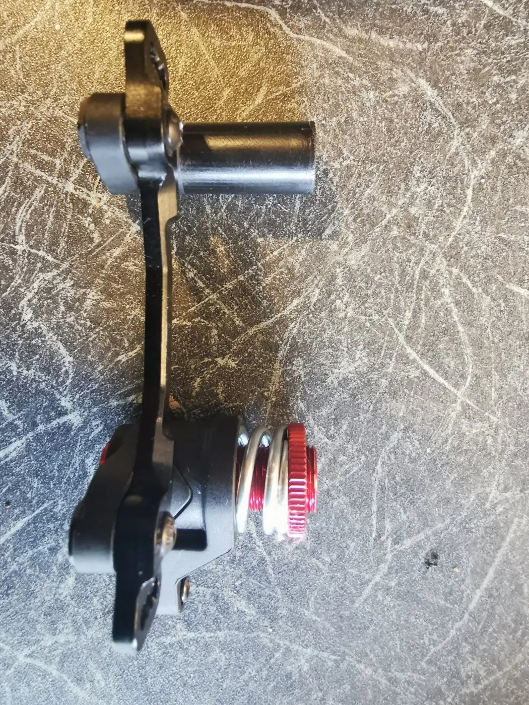

The servo saver spring is very weak. You can tighten it up, but the bottom line is: unless you tighten it up all the way, it gives all the time and makes the steering vague/unresponsive - especially when you're giving it full beanz.
There are threads here dedicated to the springs that are much better suited for this job.

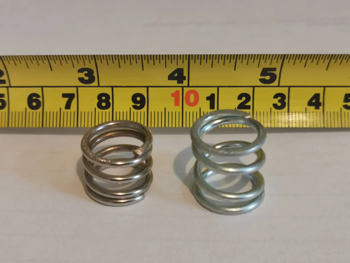

Original spring:
View attachment 4198vs the upgrade:
Note the space between the coils affords saving action in the event of a tumble/knock etc - but has a much firmer rate affording much more positive steering.
