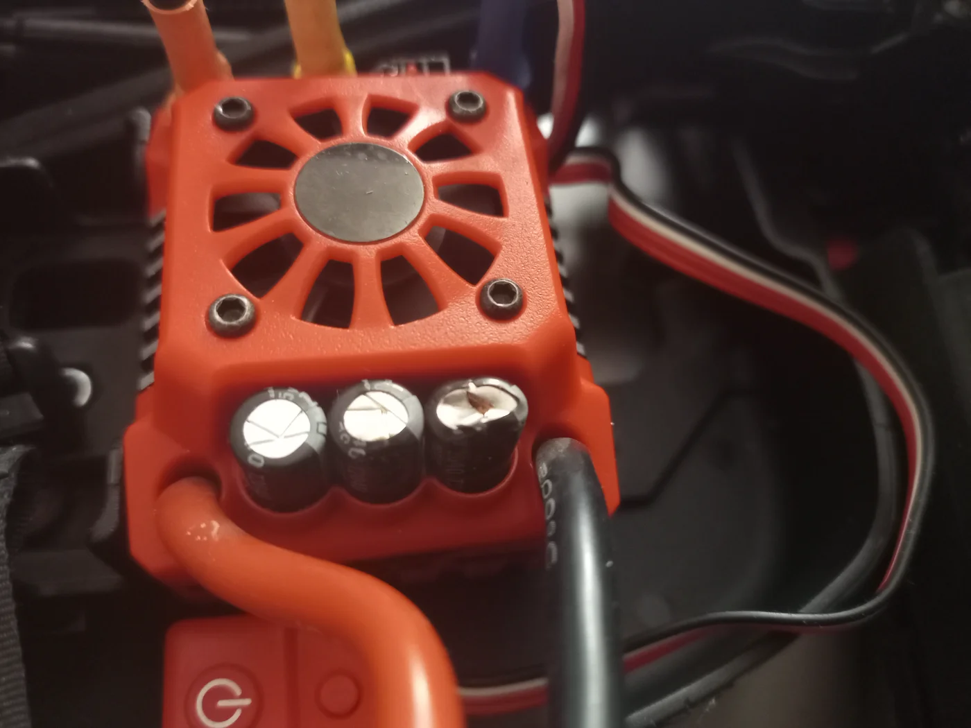

And while i finished it all up, i found this:
Well, we were talking about cap's popping last week. This one certainly popped.
Id did, didn't it?
But this one is brand new. Just one run on it on a 16t pinion. That's what i've been running in the other 2 buggies, with the same ESC's, without problems.
Id did, didn't it?
Magic smoke = released! 😝
If that ESC is outside of it's warranty - just solder in a replacement cap. Doubt it would cost more than £1 to replace. 👌
It's waterproof. I bet everything is epoxied.
If it's not, my soldering is still not good enough for that.
Yeah, that's a very good point - it's all epoxied in. 🤦
I suppose the issue is - what else went wrong to blow the cap? The MOSFET might be toast anyway. 🫤
I have no clue.
It just had one mild test run and it ran fine.
I did not notice anything out of the ordinary.
