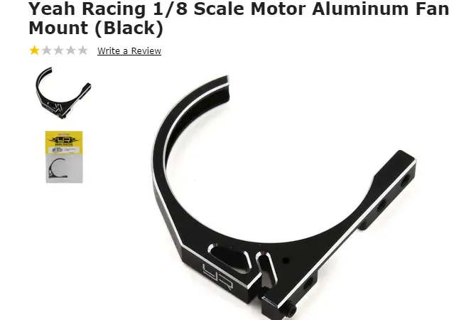

Yeah, weird that we can't find a published spec on this motor..FWIW a 40mm HS can def be squished down to fit. I actually used a HW C4 heatsink on a 4068. They're made for a 44mm can.Yeah, 37 sounds odd. I see some people have put an Arrma 6s heat sink on it, which is for a 40mm. I am thinking is a 40mm, but wanted to confirm. Not sure yet.

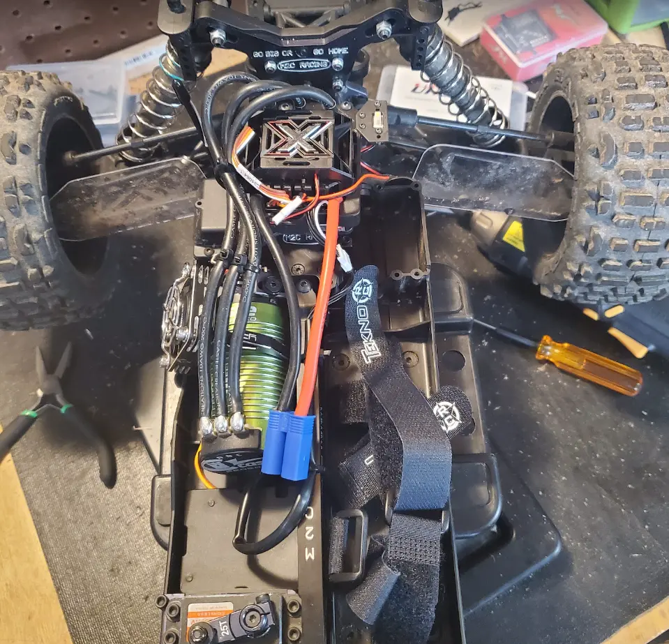

That's probably the most common 1/8 buggy motor out there.Just put the caliper to it and got 40 wide x 68 long, it was still installed but I think I got it good enough.

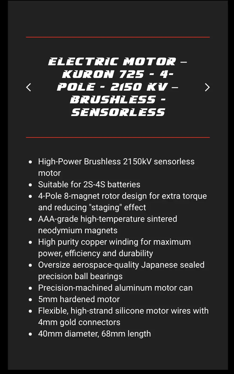

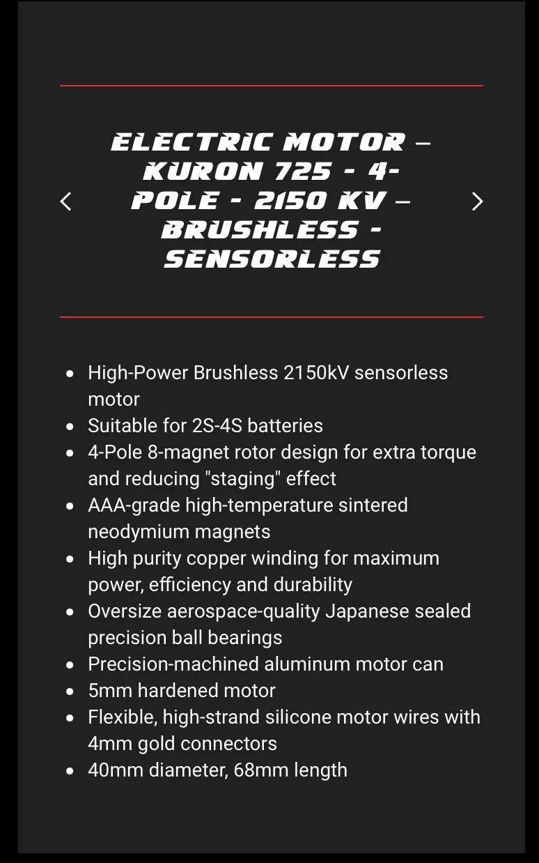

What is the diameter and length of the Kuron 725 that comes in the Sketer?
Nice find
Oh yeah, kaiju comes stock with 4068 2100kv and is 6s capable soo..Nice, 4068… hmm, I think it’s good enough to slap a 150a in her.. haha
