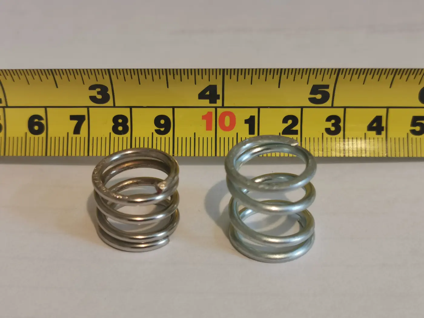

Stock spring
Aliexpress spring (Mn65): About 40lbs
Lee spring: A little over 50lbs
So yes the aliexpress spring is a happy medium.
Also they are kind of fibbing about the length out of the bag it's 25mm long for these "20mm" springs, OD is about 17.6mm which is acceptable tolerance. Grinding the ends with a sanding wheel and a drill press and fuly compressing it once reduced it to about 21.5 long uncompressed (it looses a few mm after an initial full compression). Maybe this is the estimated lenght after processing the raw springs? I just chucked up a dremel sanding wheel and held the spring in a flat surface and lowered it onto the end (need to have a container of water nearby to dunk it in every 5 or so to cool it). It has the same number of turns as the stock spring and the lee spring so the amount of servo saver deflection should be unchanged but you will need to compress it more to get the nut started on the thread. It is easier to tighten than the lee spring is but I still don't see it backing off.
EDIT after grinding the ends I inserted a rod into the spring to lift up the end of the wire and then carefully rounded it off with a dremel because I am OCD like that
Stock spring: About 25lbsHowever, what would be a crude test, is to compress the springs on a bathroom scale with a clamp. You can see exactly how many kg's it takes to compress the springs that you have in your possession.

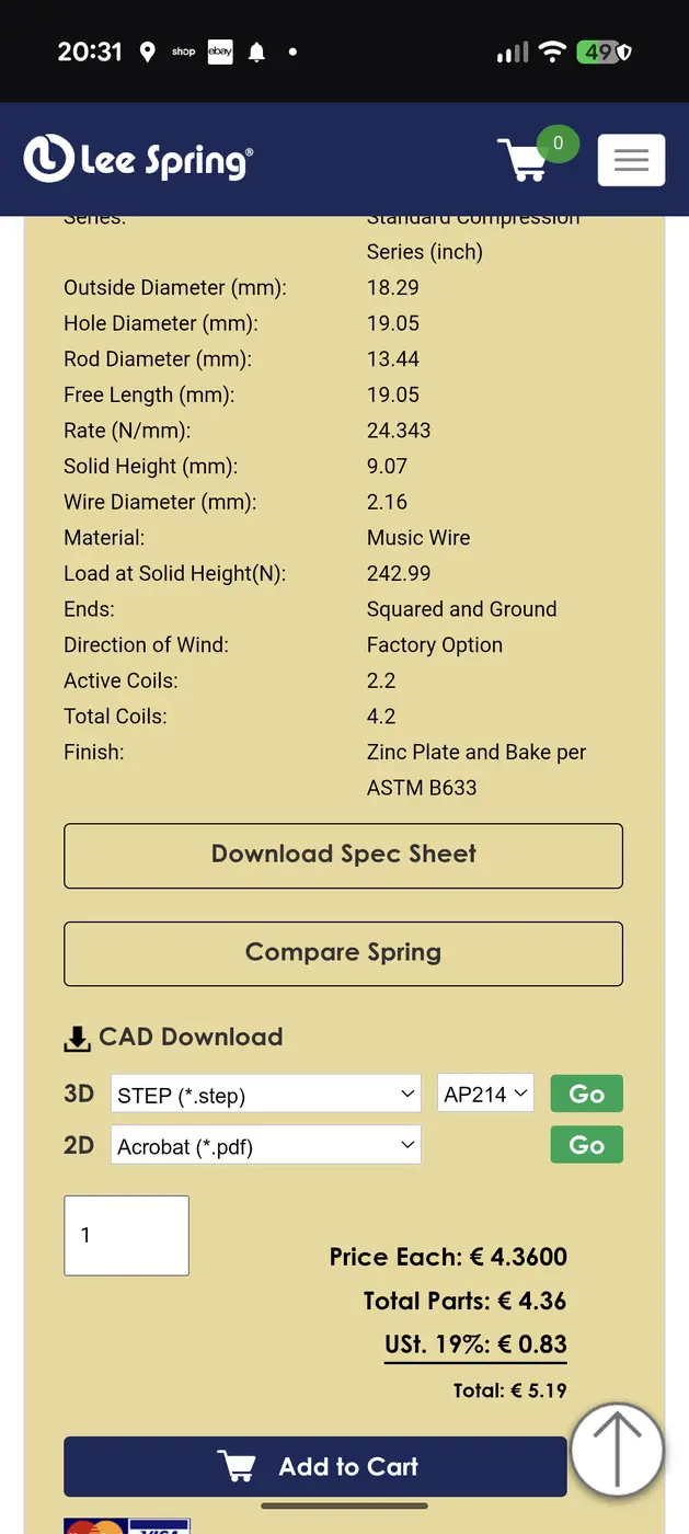

In the case of the Lee Spring - it's 19mm high and is Solid at 9mm, fully compressed. It takes 2kg per mm to compress it, so given that it's a linear compression spring, we can expect 20kg to fully compress the spring. Between a finger and thumb, that exceeds what is humanly possible. The stock spring in comparison is certainly possible to compress (almost completely) between finger and thumb.
