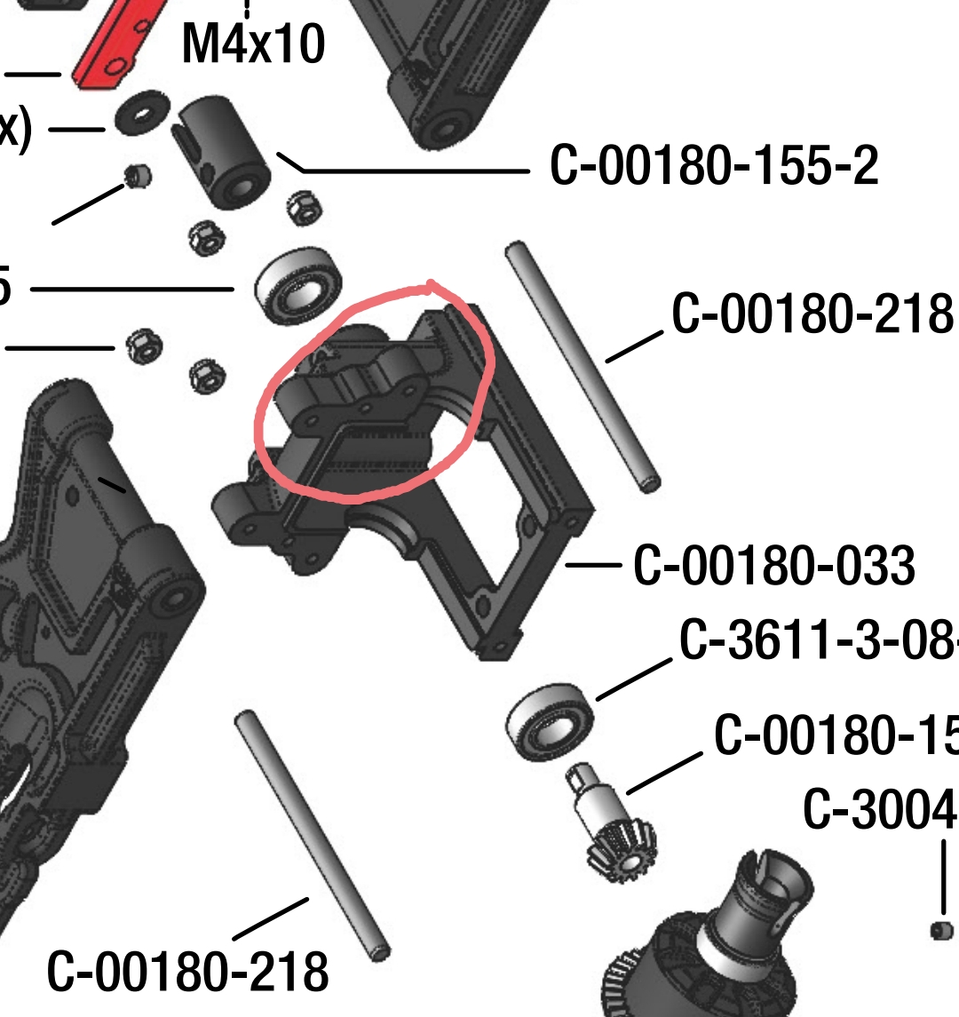

I posted this up to show the input shaft bearing spacer (being smashed out with the driver). If that's loose (for whatever reason), it might give rise to the mesh becoming loose and the diff slipping/stripping input and crown gears.I'm not sure Claire's RC video was all that informative, past saying that the Corally Kronos was incredibly weak etc.

There isn't a spacer - it's part of the actual case that they smashed to sh1t.I posted this up to show the input shaft bearing spacer (being smashed out with the driver). If that's loose (for whatever reason), it might give rise to the mesh becoming loose and the diff slipping/stripping input and crown gears.

That's exactly what it was, but due to their inability to A) drive and B) look at an instruction manual, they'd sooner conjure up and edit a 10 minute BS video about a part that doesn't exist to mislead people.But that easy 8 quid part and fix would mean no dramatic video!
I think that particular skatepark destruction also bent the chassis and rear centre driveshaft - probably this punched the input cup into the diff housing breaking the bearing seat.
