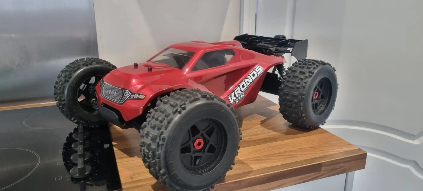

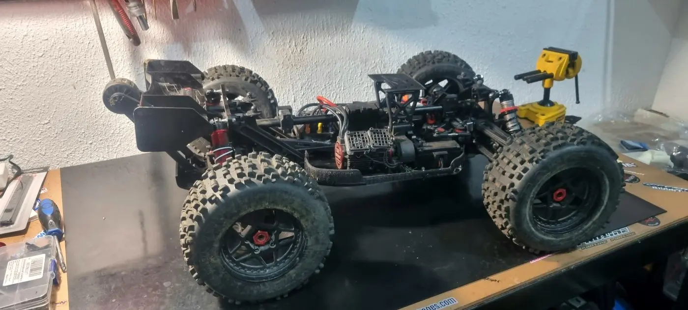

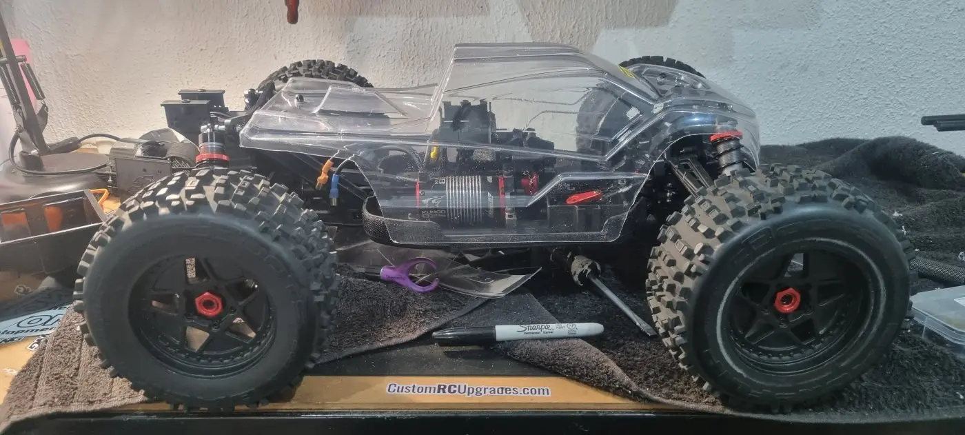

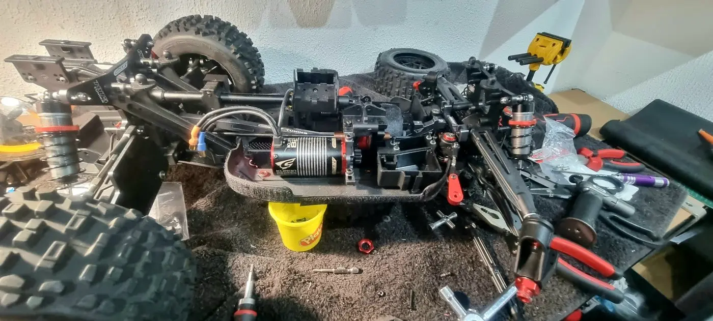

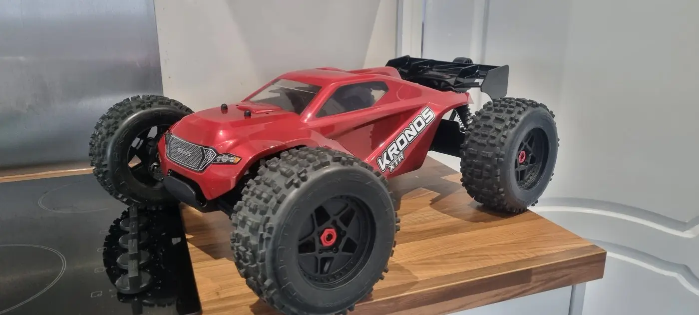

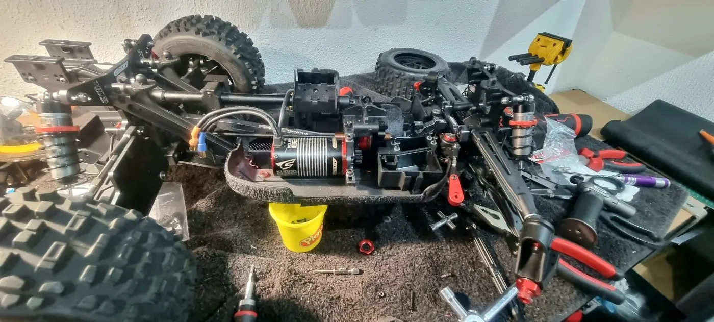

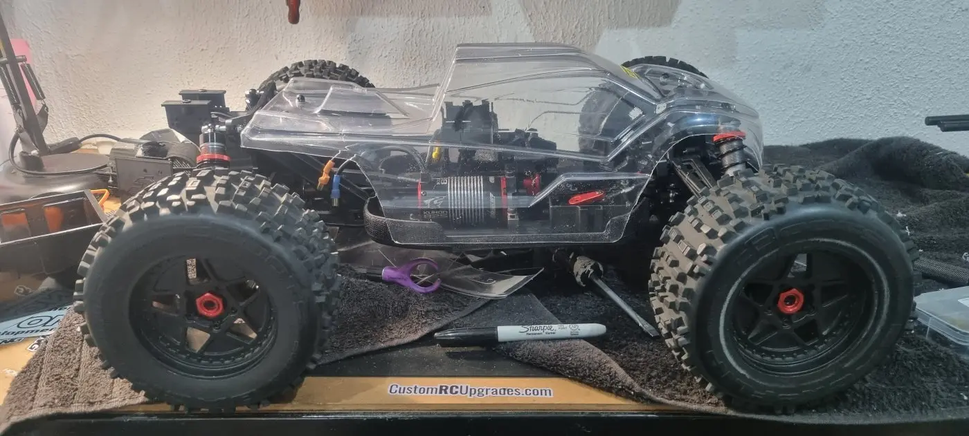

Finally started putting together my 2022 Kronos XTR which I purchased back in Feb.
I've had several Arrma 6s cars but got tired of their diff issues and overpriced parts so swapped to a Hobao SSTE which is my favorite truggy in terms of durability, performance, and cost. Then I found out about Corally so thought i'd give them a go. Tried the Shogun but realised it would cost loads of money to get all the right parts to toughen it up and bash proof it. So sold the Shogun and went for the Kronos XTR.

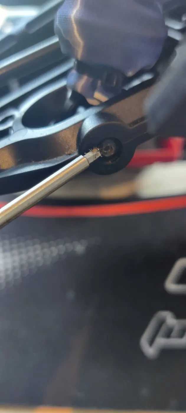

I gotta say build quality, I'm impressed. Diffs are solid, smooth and chunky look like they can take a beating, the arms, braces, driveshafts, chassis, steering components all look solid.

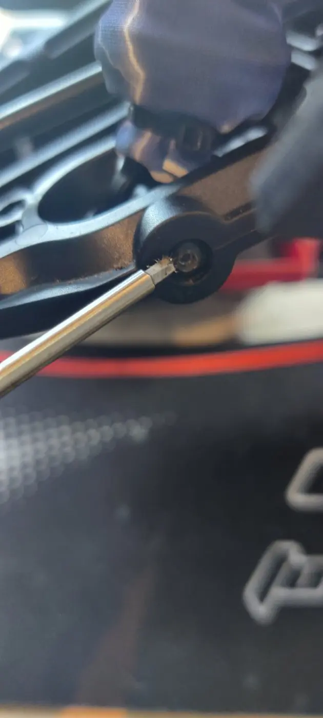

The only let down was the screws which I've managed to strip the heads of so will change them all out for better for screws with better heads.

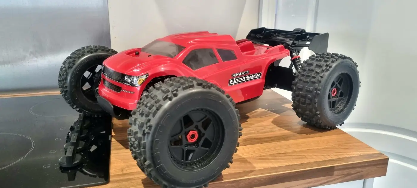

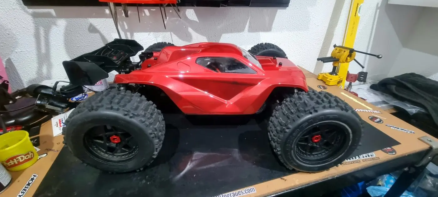

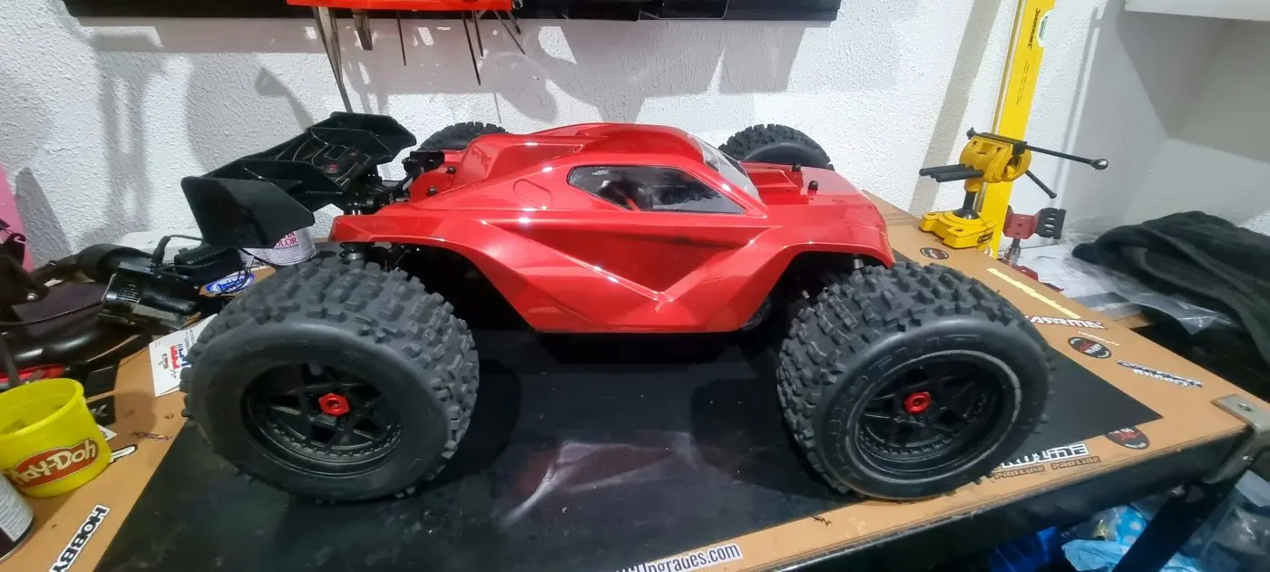

Hoping to test drive tomorrow still deciding between stock or finisher body.

I like the Finisher body too.

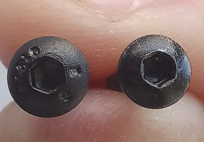

I haven't had this issue with my XTR. You probably know this already, but could it be that your tools are a bit worn or that they're low quality hex drivers?

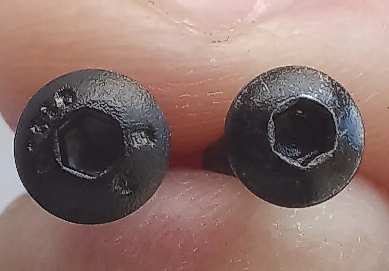

Now strangely enough, the pan head screws are 2 different qualities on my Punisher. The good ones are stamped with a 12.9 ident, and there's a handful of plain heads, and these are much softer and easy to strip.
Most of these have been replaced (with the extras from the brace kit), and I'll get to the others when I need to.
Interesting! I'll have to pay more attention to my XTR the next time I'm going over it to see if there's a mix like in your case.

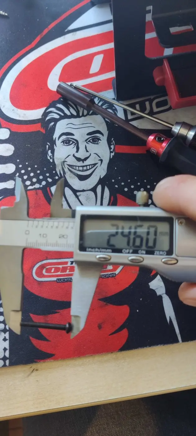

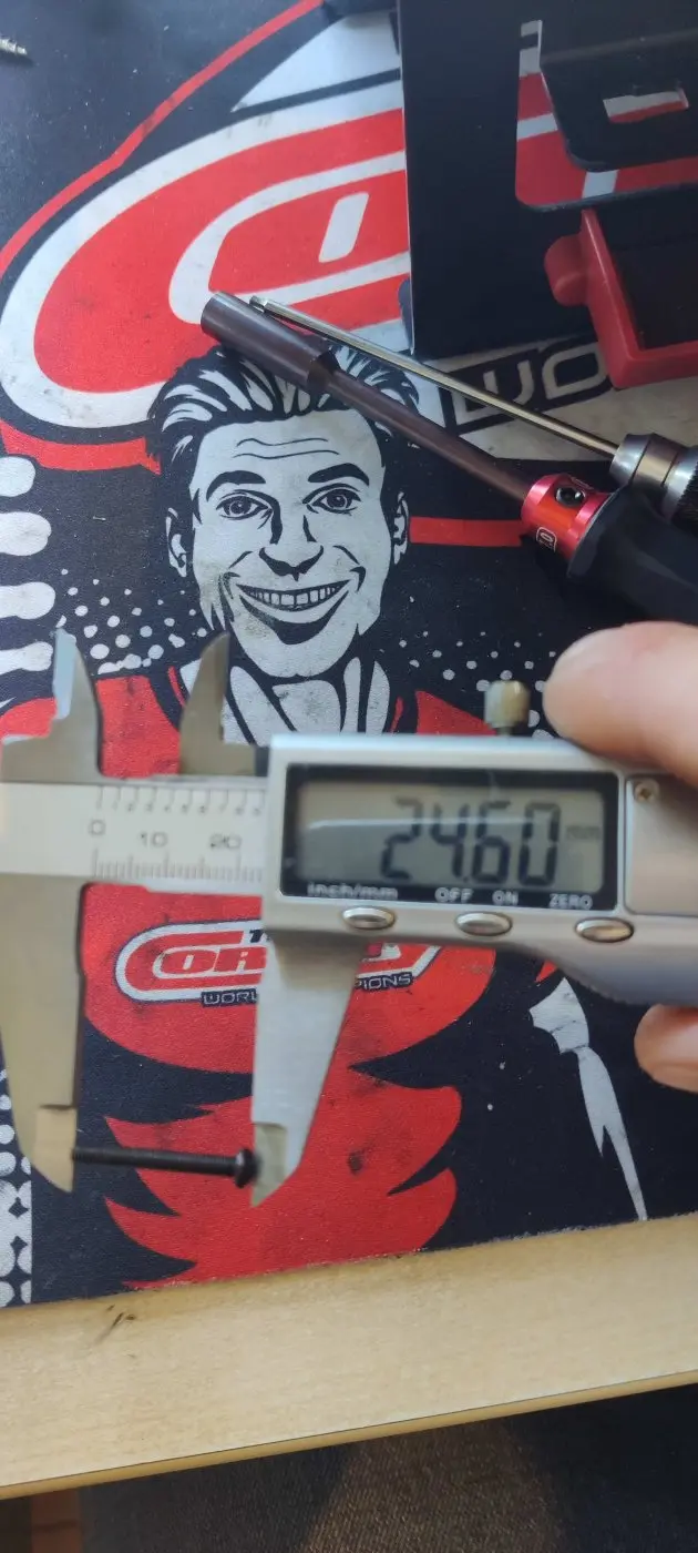

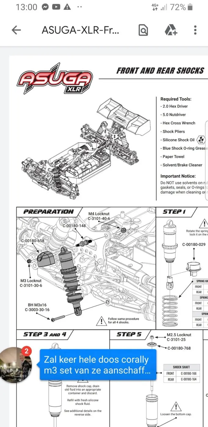

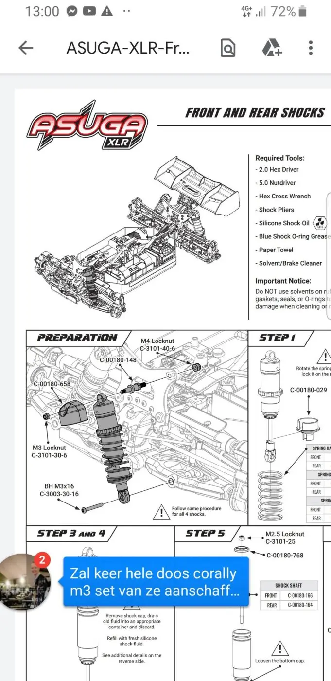

Had that in the shock screw in the lower front arm of my Asuga. Replaced it. Manual says m3x16. I measured it and the total is 24mm. I think the manual is wrong 🤔 i put a m3x20 in. Hope it holds
It's the length of the threaded shaft, so that's probably an M3x22.
As long as the 20 has enough thread engagement, it'll be fine.
Oh, and the Punisher manual has the wrong screw lengths in a few places where the threads don't quite reach the nyloc bit of the nuts. Just swapped for ones I considered to be correct.
Seems like a common thing on the Corally manuals
I buy screws from hardware suppliers generally. The small metric screws and nuts typically come in bags of 50 to 100..much cheaper that way.
I bought a bunch of different sizes from Graingers. I get a a discount plus free shipping through my employer's account. Helps my cause. Some of these that were advertised as 12.9 are actually ungraded sadly, they strip quite easily too.. I always err on longer than needed if the correct length isn't in my assortment. Sometimes cutting them off if needed.
Also, I try to replace button head screws with cylindrical head whenever I take something apart. More engagement of the hex wrench, and typically the next sized hex up vs button heads of same diameter.

+1 vote for the Punisher body here. Both look good though.👍
IDK how you bash, but I strongly recommend using the body brace that mounts to the top of the center diff. Really makes a big difference in how long a body lasts if you tumble alot, which my rc's do, LOL.

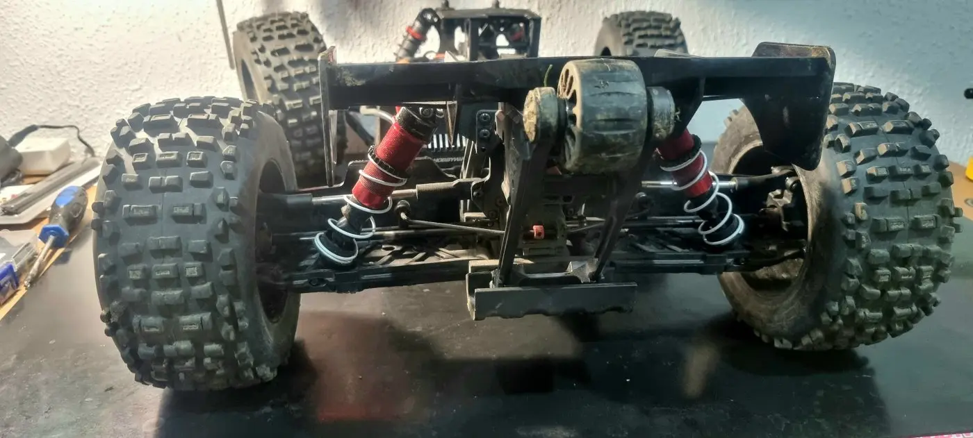

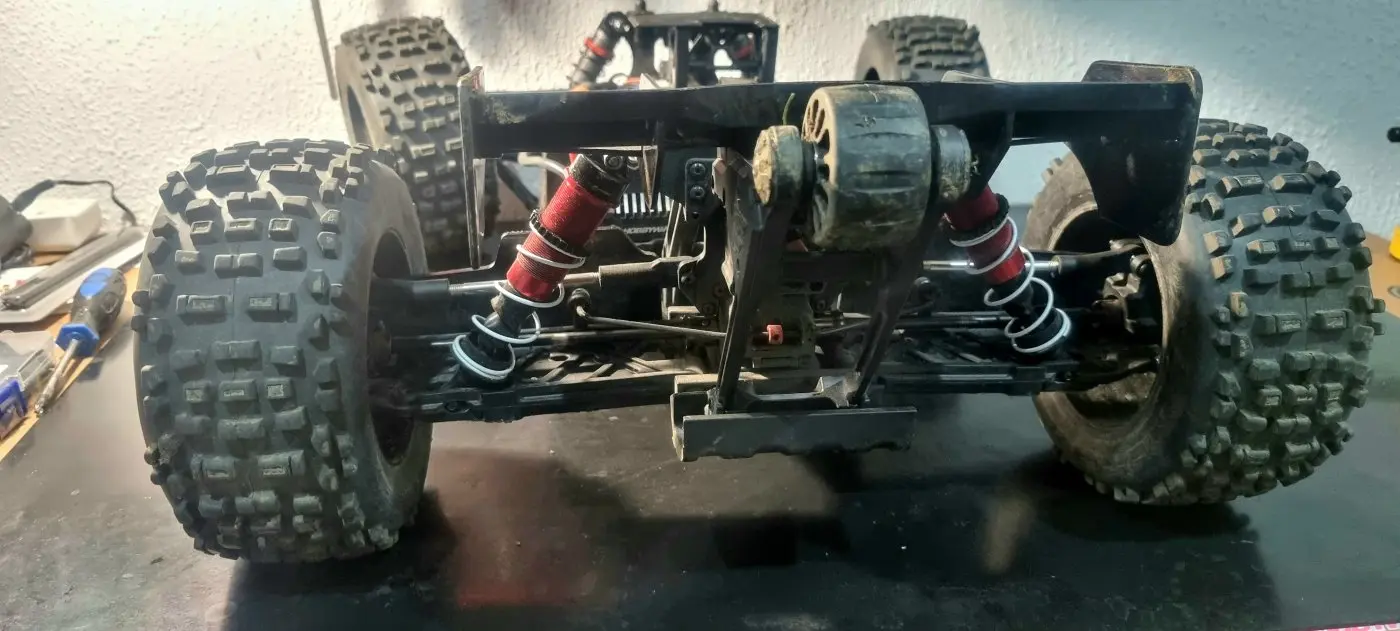

Thanks for the tips and advice. 1 week in and 3 seripus bash sessions and I must say I still love this car. Its drive and handling are really refined for a car priced cheaper then Arrma/Traxxas.
Unfortunately I have had some breakages
- Front of battery tray snapped off
- Right back shock end broke twice and ended up bending the rear dog bone so temporarily running kraton rears
- Rear input gears stripped (I don't land on power) no idea how it happened
Even with those few things I'm really happy with the car. I notice my 2050kv motor with fans gets warm on 6s and 13t so will drop to a 12t
I haven’t really bashed it very hard due to the weather, but I’ve launched it pretty hard on a high traction surface and nothing has shown any signs of breaking.
I've had a few but I'm wanting to test how strong it is. Its definitely a high flyer
