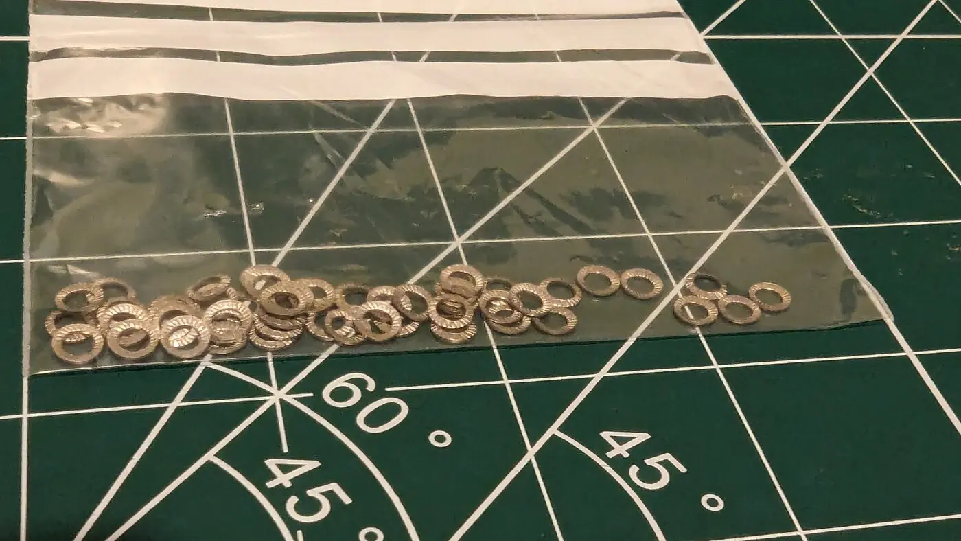

Seeing as some screws like to come undone - even with blue thread lock, I've bought these to try:
Serrated, anti-vibration, stainless steel, M3 washers.
Please let me know how those work out, I’ve kinda been wondering the same thing. I’ve got a couple on my SSTE that just don’t stay tight.
Will do. I think they're going to be good on the screws that go into metal - button heads that hold down plates etc. I can think of about 10 screws that will benefit from these on the S35 T2E Pro. 🤞
Righto - I fitted the serrated washers. They are conical and as you tighten them flat, are like little springs. Win win.
I've used them on the centre diff mount where the screws go down from the carbon plate into alloy through plastic, and also where the split part of the mount bolts down into the bottom part of the mount.
17mm serrated wheel nuts work extremely well. I have no doubt these will add an extra layer of protection on the screws I found to get loose during the shake down.

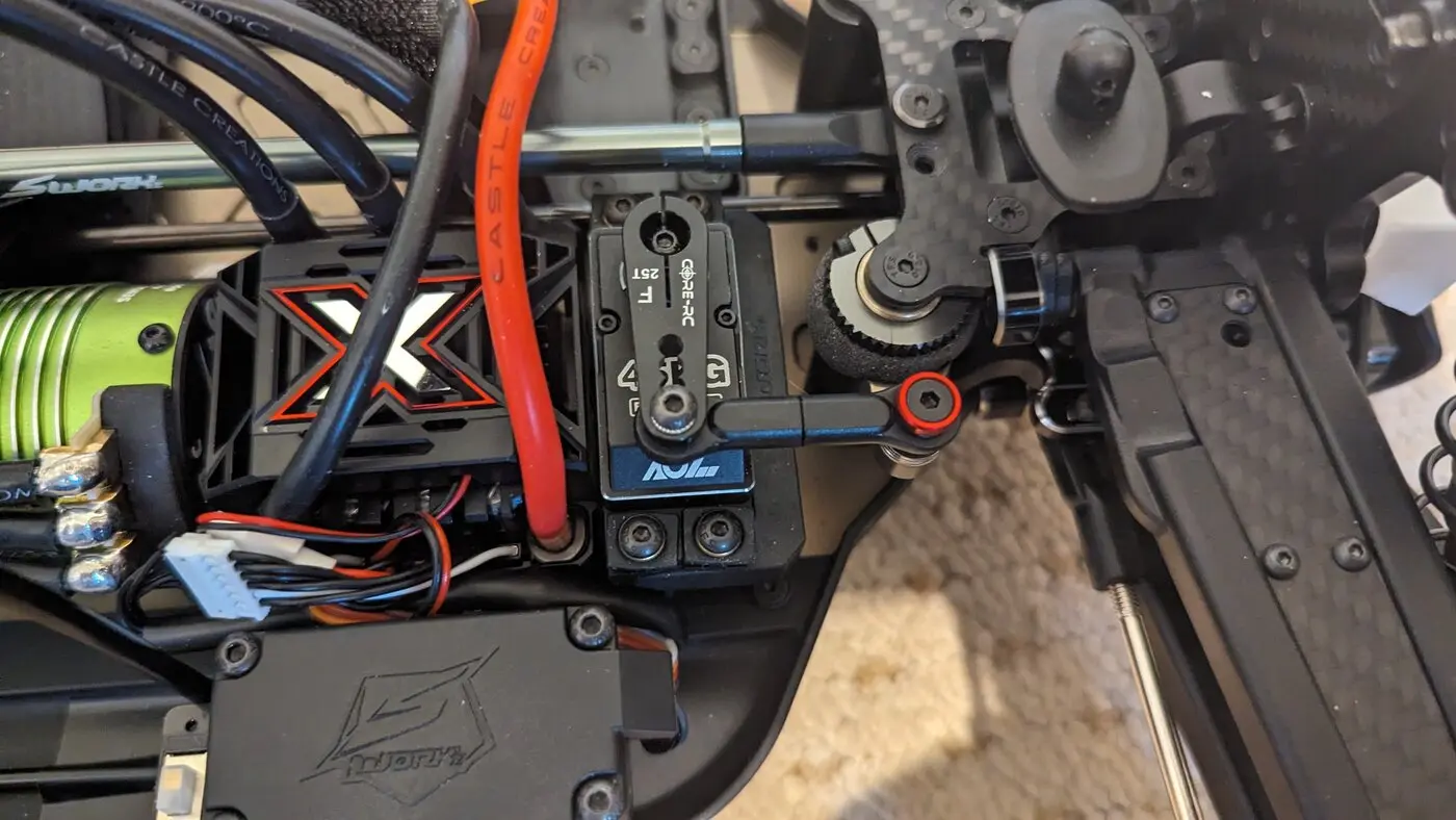

Core RC alloy, offset horn finally arrived from Make It Build It. It took 8 days to arrive - noone really knows why, or particularly cares. 🤷 I've had no issues with them before. Ordered my Kronos XTR with them in 2021 and it arrived within 5 days. Which considering it was via courier, and within the UK, isn't especially fast thinking about it.
Anyway:

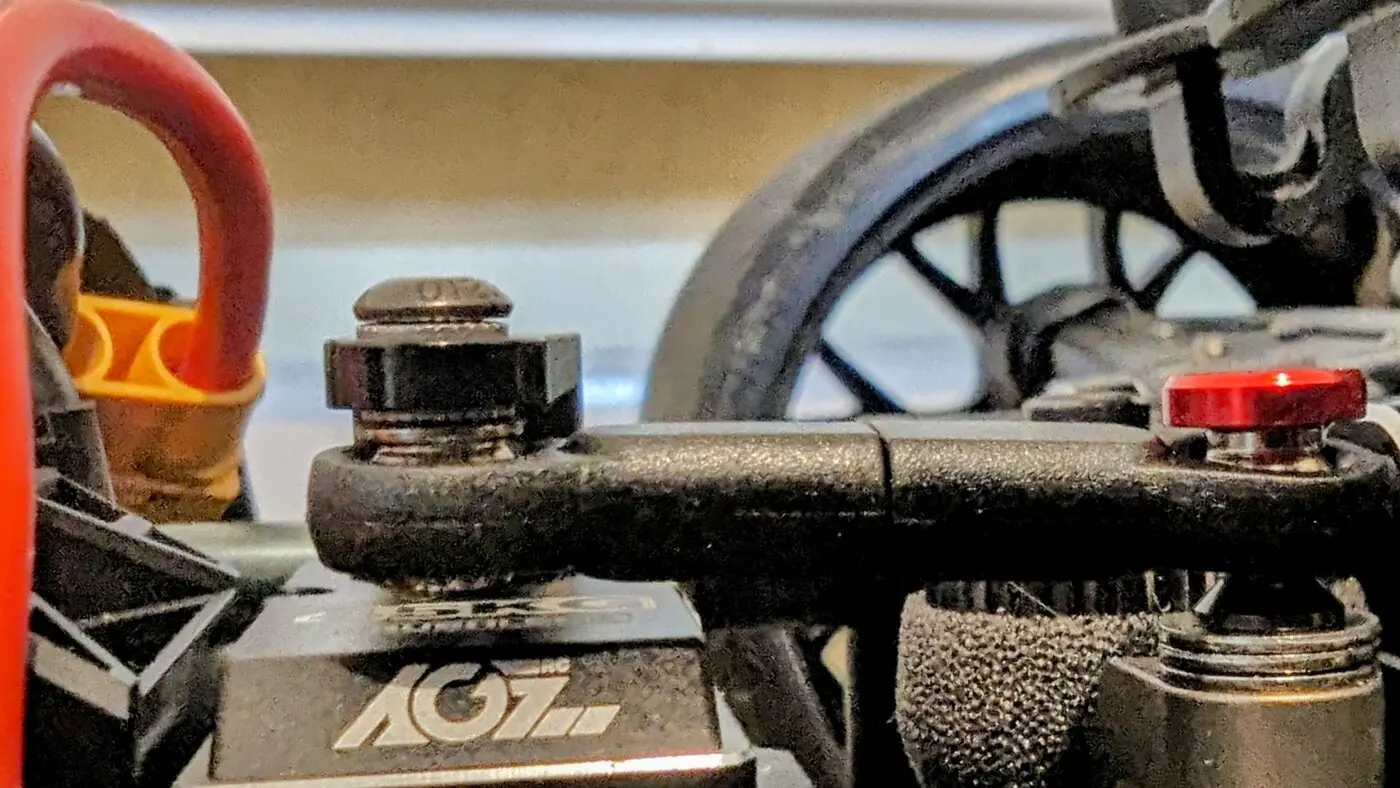

Conical serrated washers used here - to mount the horn with the M3 Button head. To screw into the ball stud - with 1 under the button head - and another between the ball stud and the horn.
Thread lock used on ball stud as well.
Belt and braces.
My M3 threaded (threaded all the way through) 8mm ball studs are on their way.....but from China. Get here mid March apparently. 🙄
Geometry with the Alloy Core arm (distributed by Schumacher) is actually better than the specific nylon arm supplied by Sworkz. It's a perfect 90° Angle at neutral.
So very pleased!
