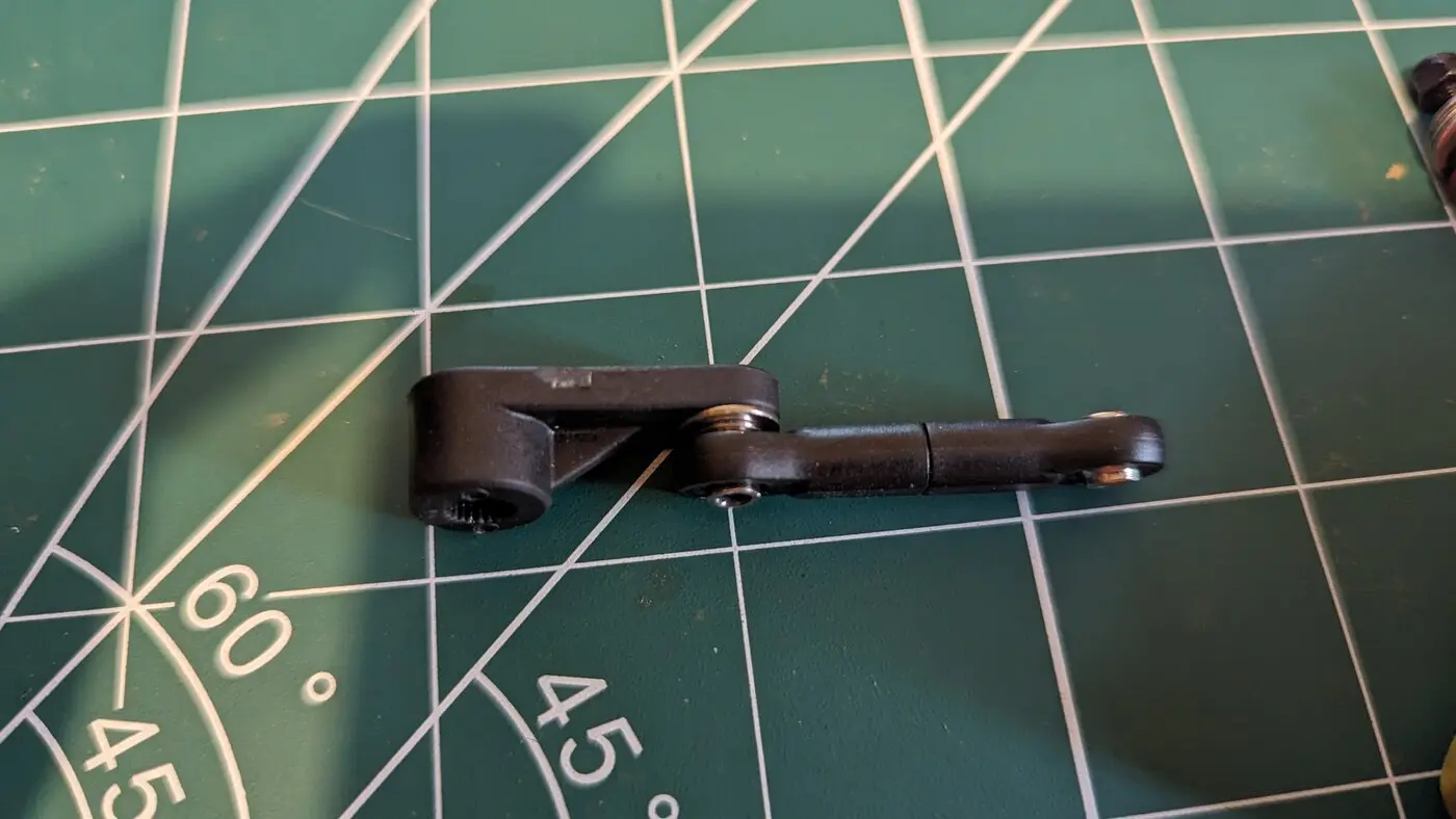

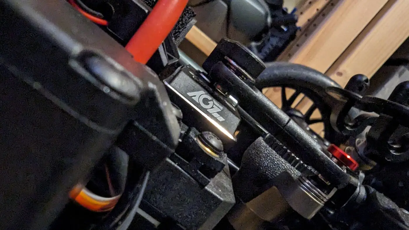

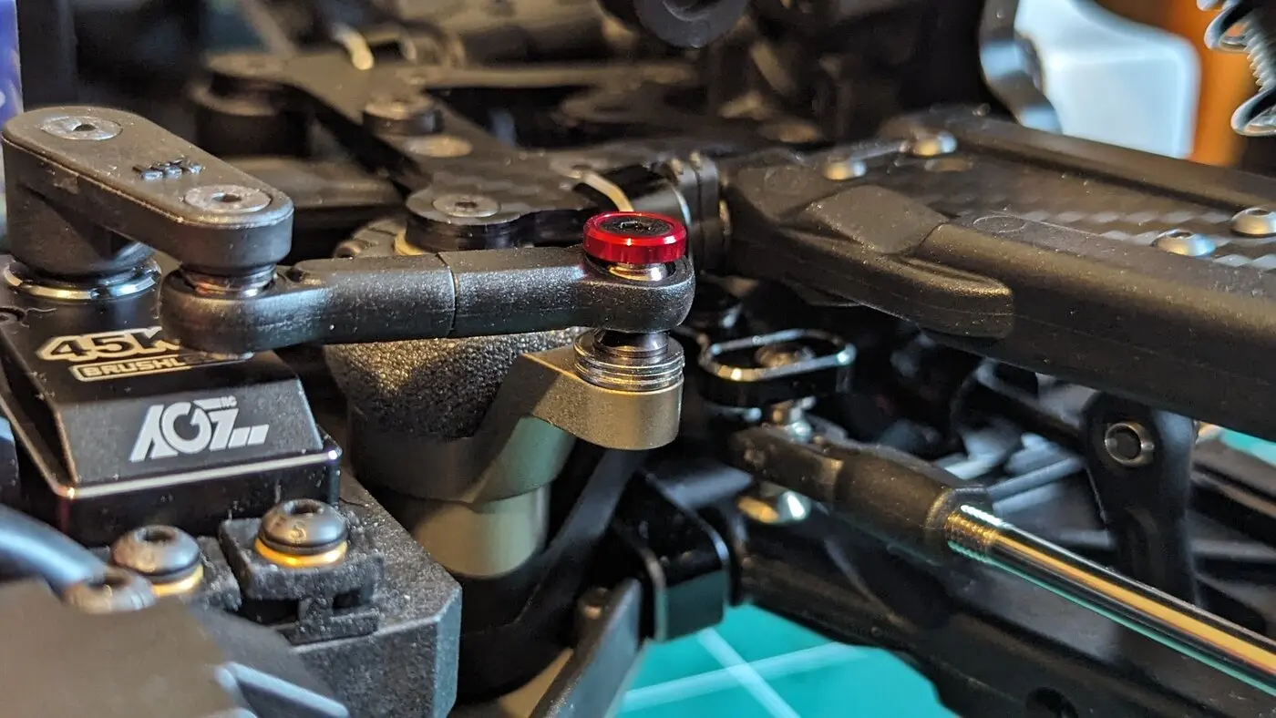

I needed to get the angle of the steering link level. To do this, I used 3 washers, a conical M3 washer and an M3 countersunk washer.

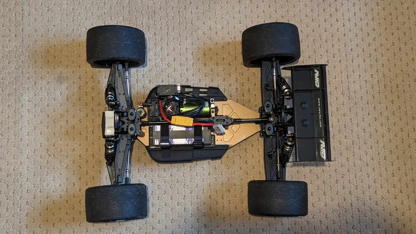

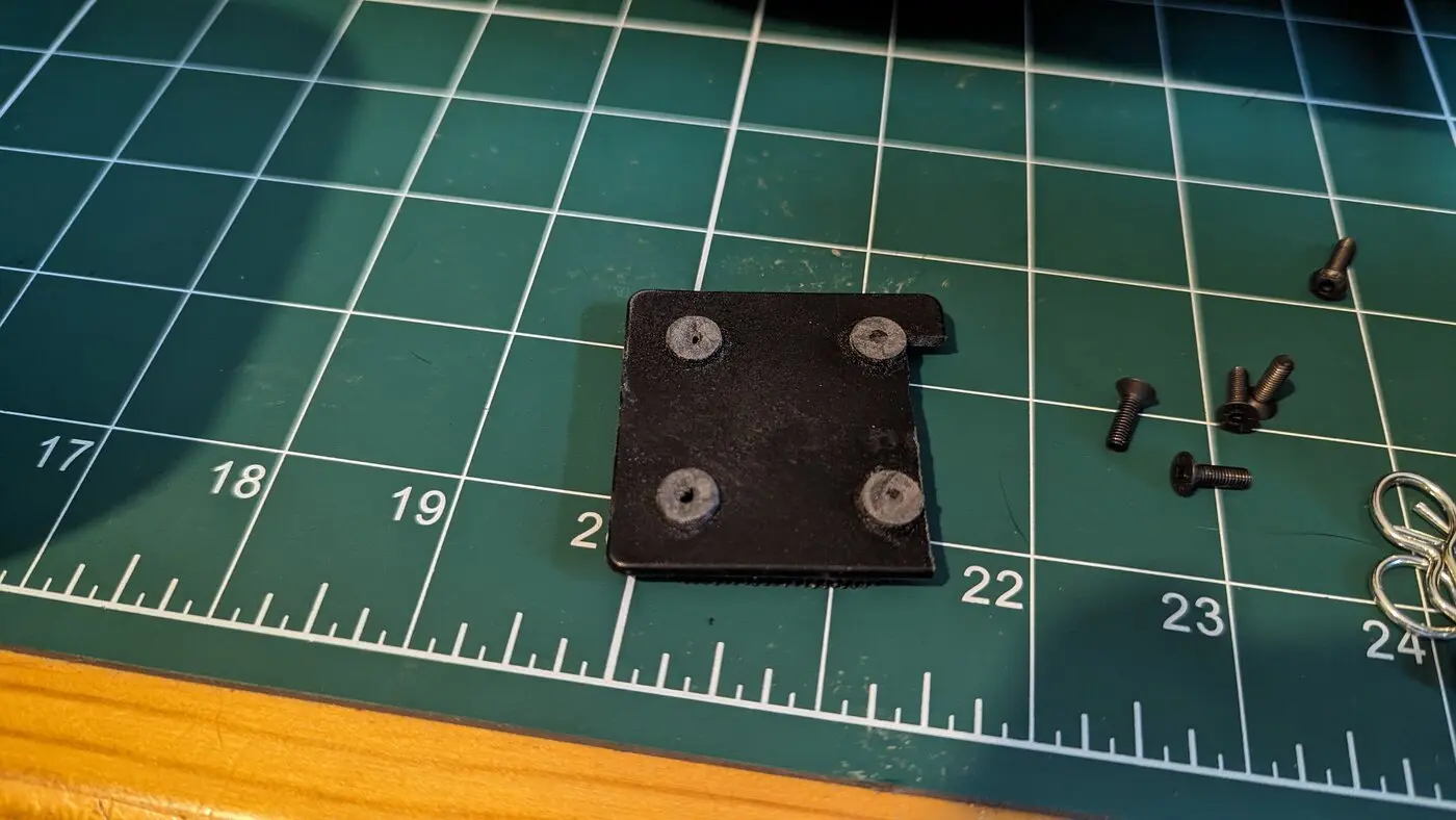

The mounting lugs have been removed to 2mm on the ESC mount. Fitted to the chassis, this lowers the ESC sufficiently to avoid the steering horn fouling it. 🤩
View attachment 5335View attachment 5336

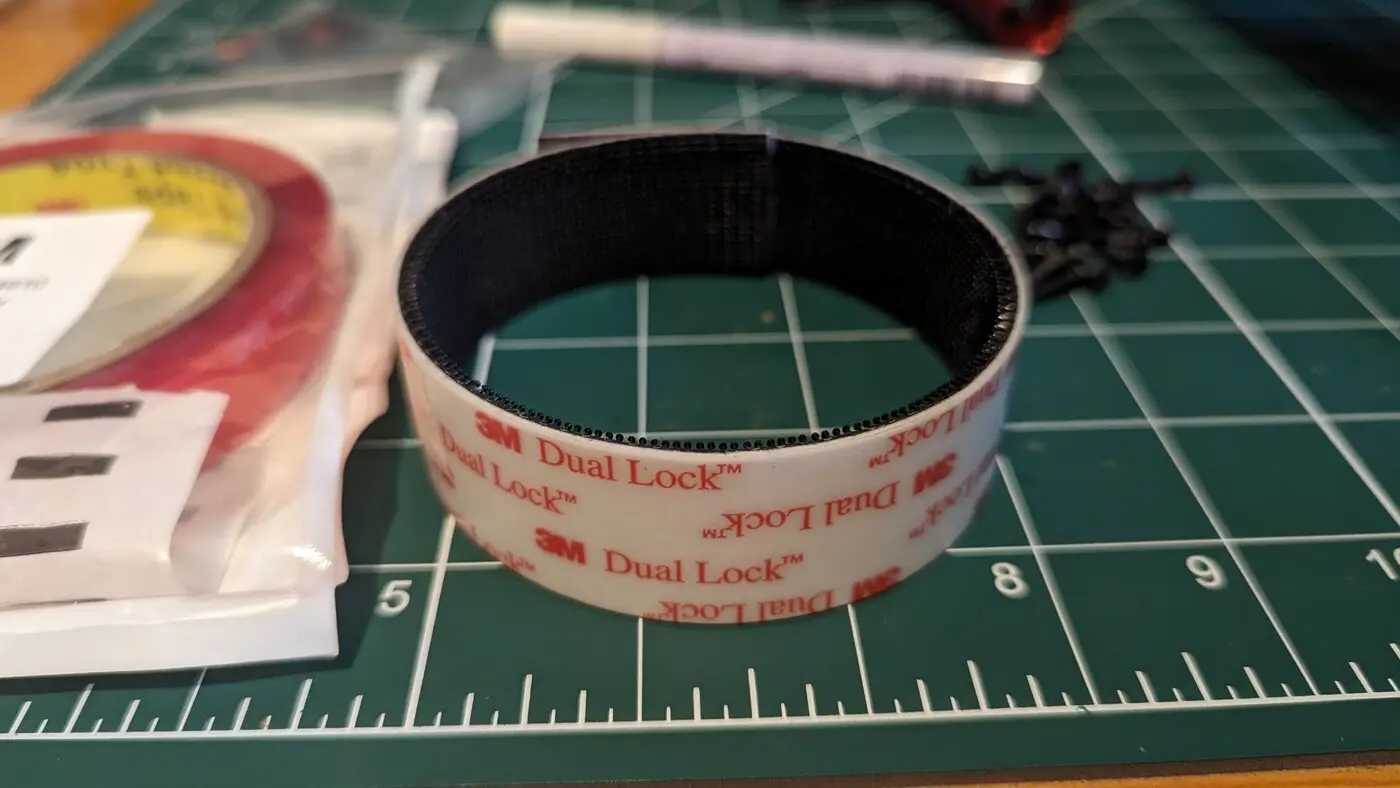

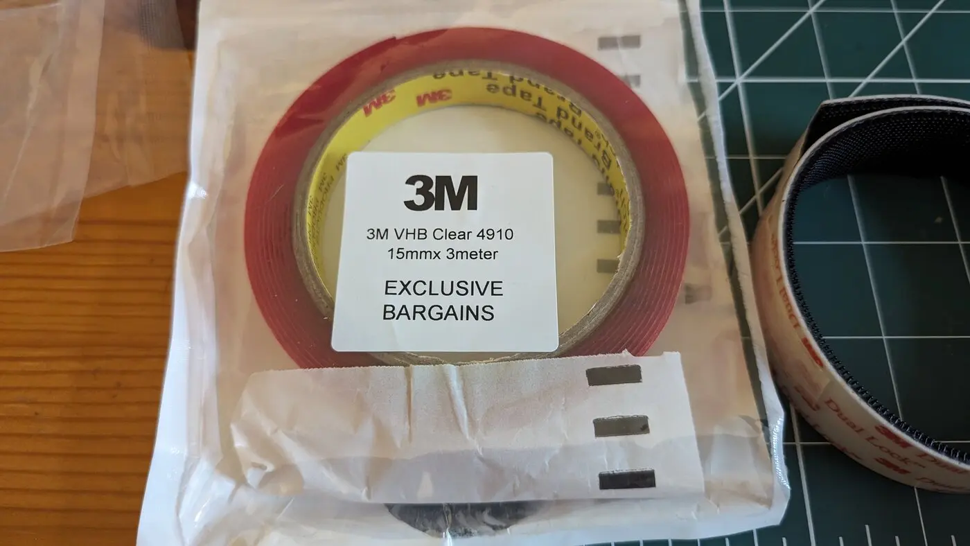

3M Dual Lock and UHB clear double sided tape. Dual lock mounted the ESC and UHB used to mount the switch.

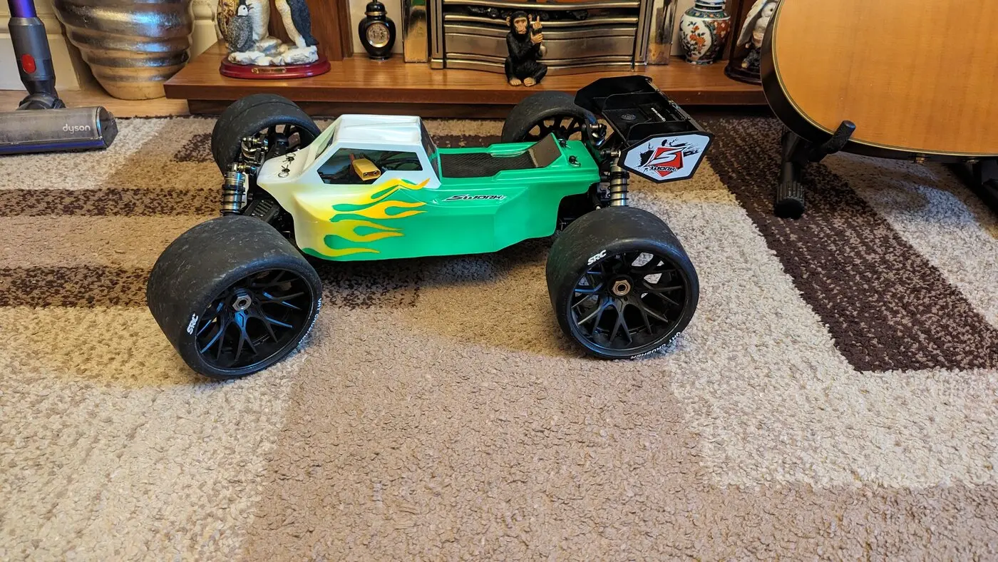

Layout of truck is weight forward, similar to Mugen configuration.

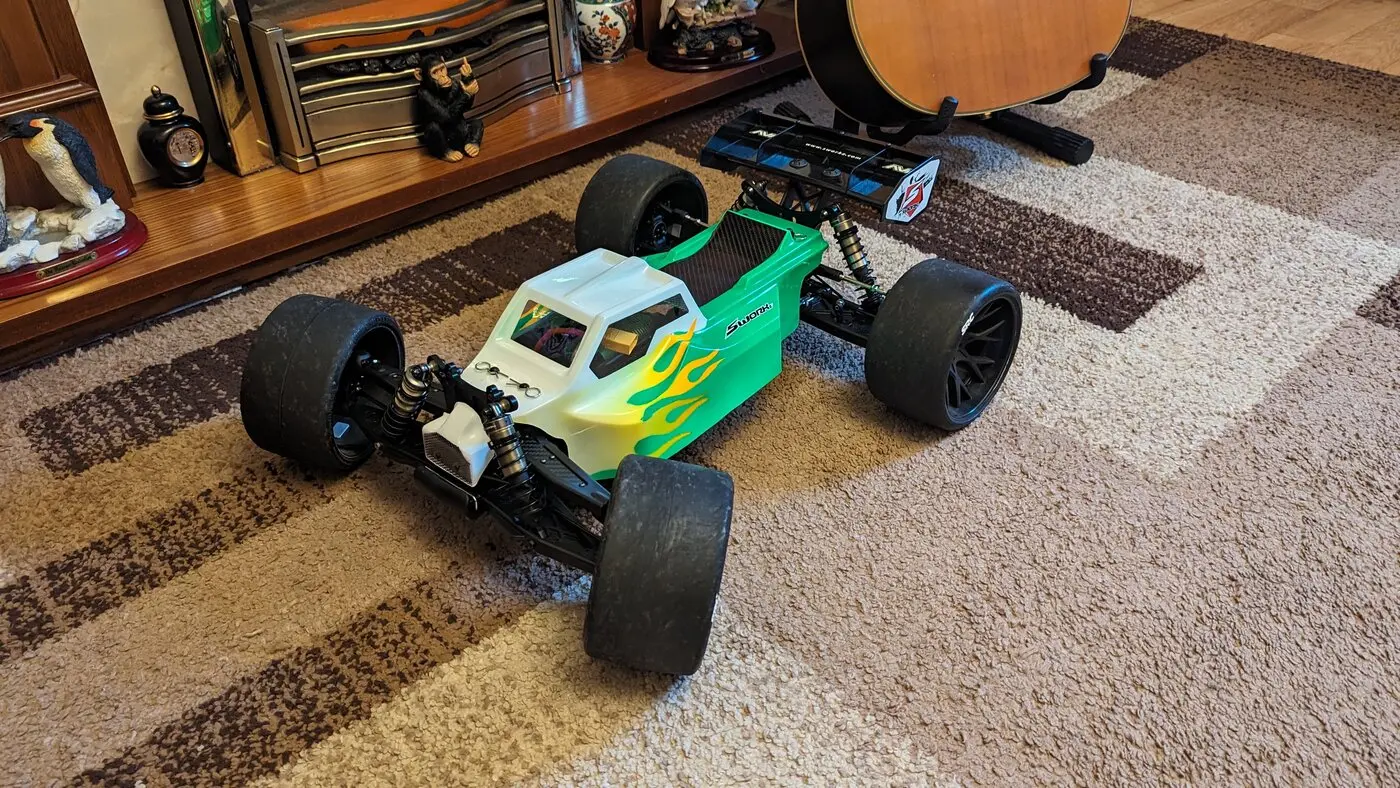

Sweep Crusher tyres are slightly bigger than Truggy tyres, but this will actually help increase the rollout value for speed runs.

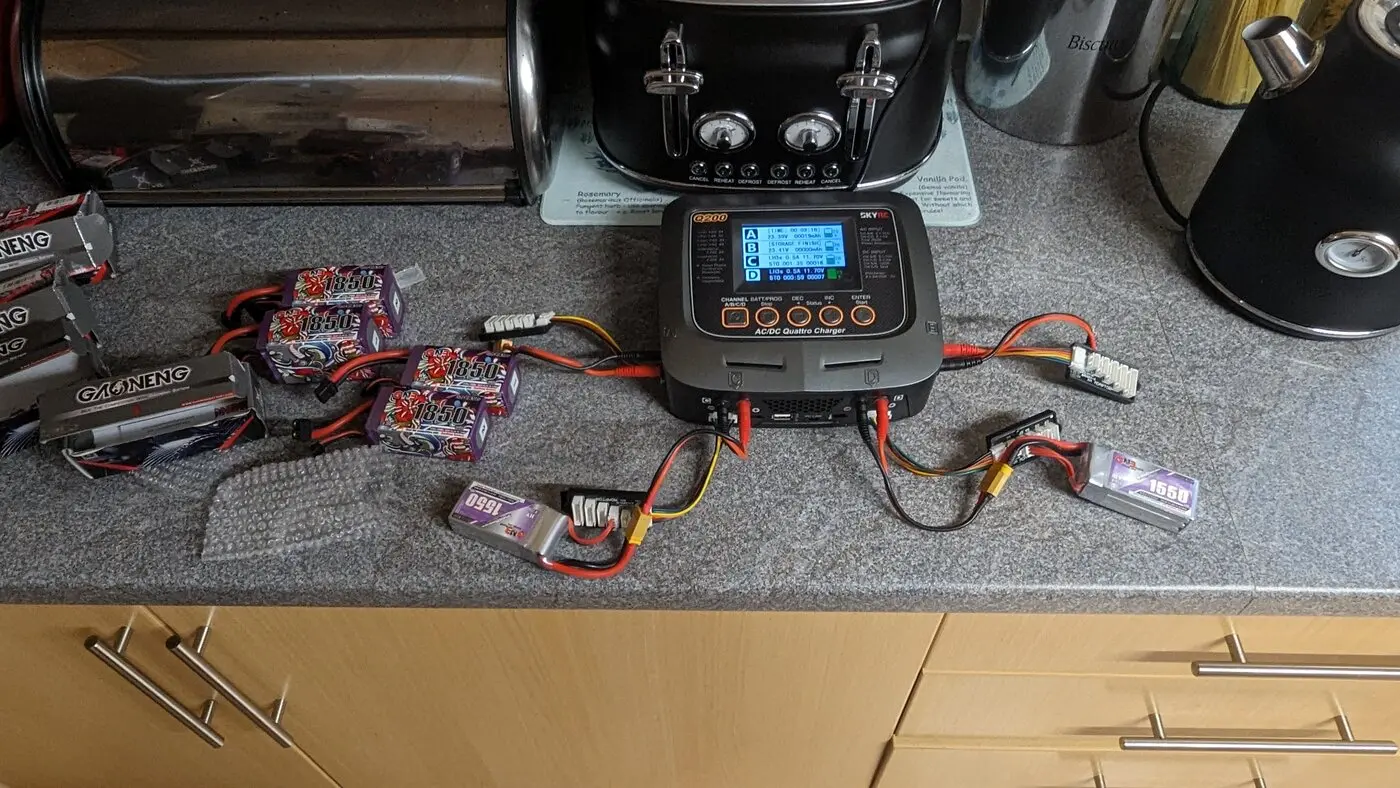

In the meantime, it's time to do some battery maintenance.

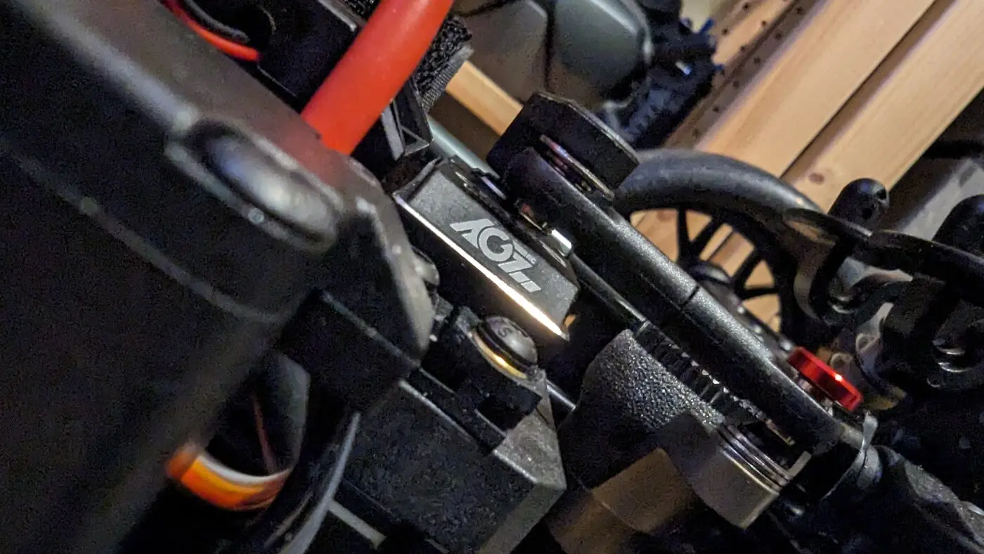

Now that's interesting. I meant to comment on the washers on the servo arm; the arm on my 48.3 seemed to be lower than the servo, so the initial horn I wanted to use gave it a bad angle. I think I'll try some washers to see if I can go with my original selection. Also wanted to comment on the characteristics coming out of the turn. I suppose I could tune the diffs in the Shogun to come close it the T2E's rotation, but my previous venture down that path made it quite twitchy. I ran a 10K center, 7K front and 5K rear. Almost felt like I was driving a squirrel that had taken the little blue pill with copious amounts of nitro-grade caffeine.
Definitely makes me want to get a SWorkz. 🙌
@VaporTrail
Yes, the linkage arrangement probably would have been fine if I'd direct mounted the servo. So I had to raise the link accordingly - by about 2.5mm. Cunning use of M3 conical spacer. 🤓
It's really helped. My options for choice of horn are extremely limited due to how little space there is and the fact that the linkage fits under the horn.
I'm going to get the Sworkz upgraded alloy horn as a matter of principle! 🤣
I need to replace the ball on the horn side of the linkage - or most likely I'll just drill it out and re-tap it.
There are many, great things about the T2E - the linkage arrangement isn't one of them.
I was going to use the TC servo horn, since it's a nice chunky piece, but it seemed to put the linkage at quite the bad angle. The 48.3 came with quite the slender servo horn, so I went back to using that. I do believe I have some conical spacers in the tool box; perhaps I'll try my hand at your ingenuity. The servo horn that came with the servo is also supposedly an alu version, so maybe I can even consider that.
Bummer to hear about the linkage replacement, but I suppose it's a small niggle compared to the overall. Kinda like that one girl you find at the bar who is an absolute bombshell, but also has one longer big toe than the other. Niggles, yes. :LOL:

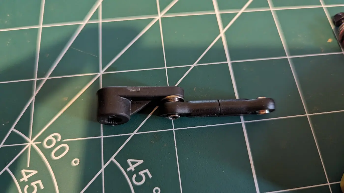

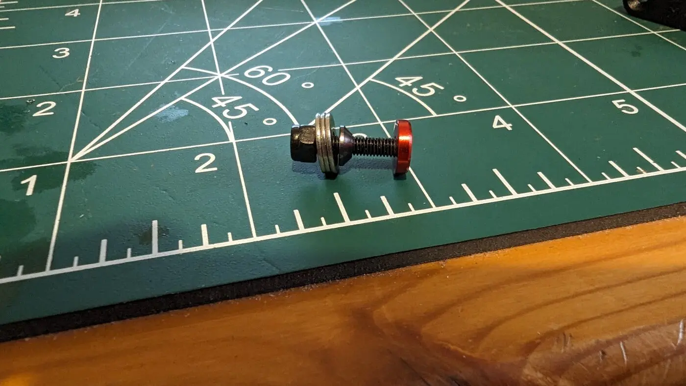

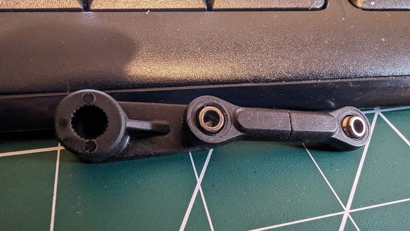

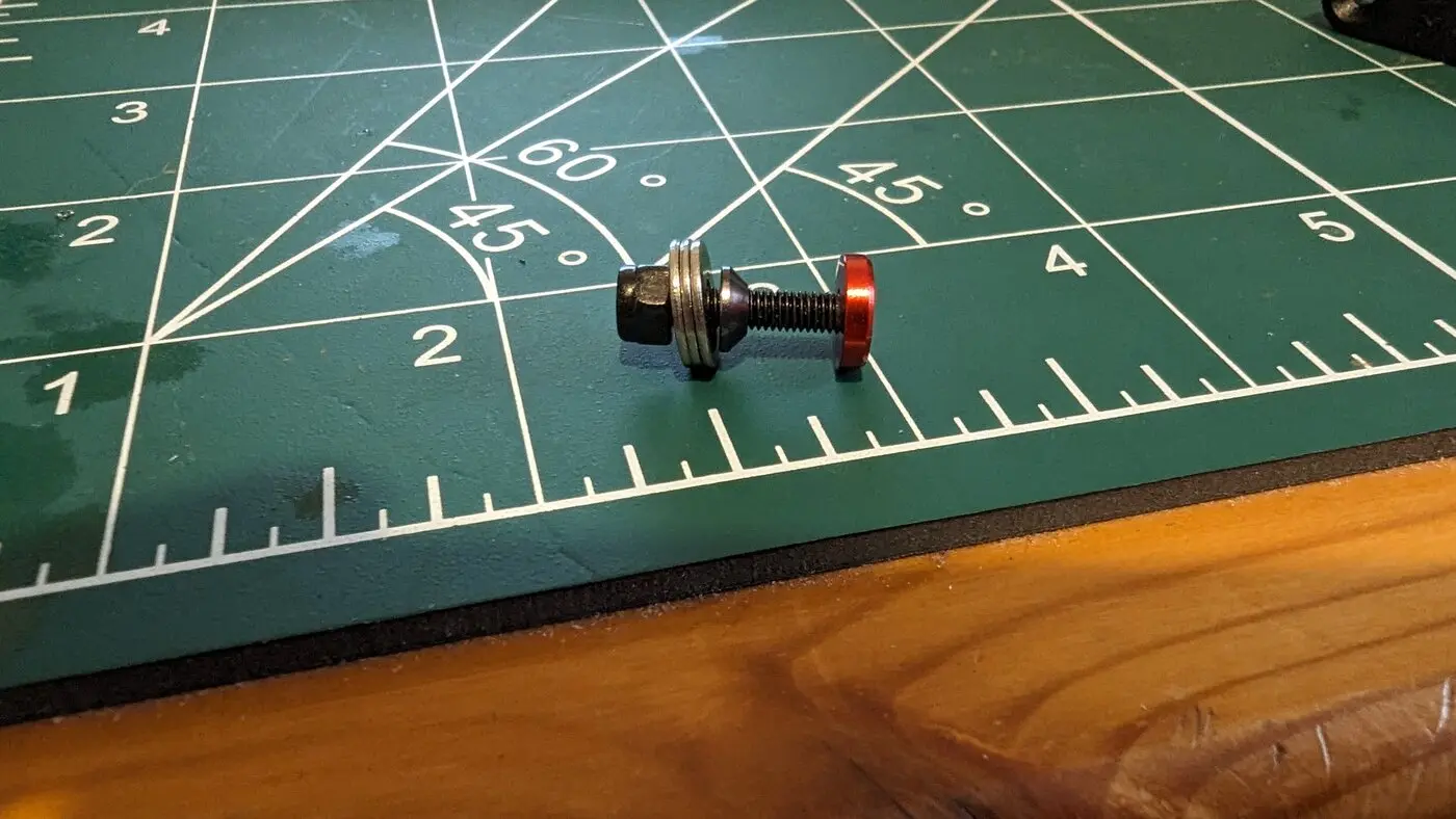

The 6mm ball stud is threaded only half way through. The countersunk screw M3x8 goes through the horn and into the ball stud. This sounds simple enough, but:
  1. The screw is too long - it reaches the end of the threads before the CS head gets tight in the CS hole in the horn.
  2. There is no straight forward way to tighten the screw into the ball stud. It's round and has nothing to grip.
  3. Once it's on (you have to tighten it off the car) - there's nothing to stop it getting loose, which is far from ideal on a critical steering component. Careful application of loctite without getting any into the joint is the only way to mitigate it.
M3 x 8 CS screw is now M3 x 5.5 and the ball stud is fitted with a 0.5mm washer.
You can just see where the thread ends in this shot.

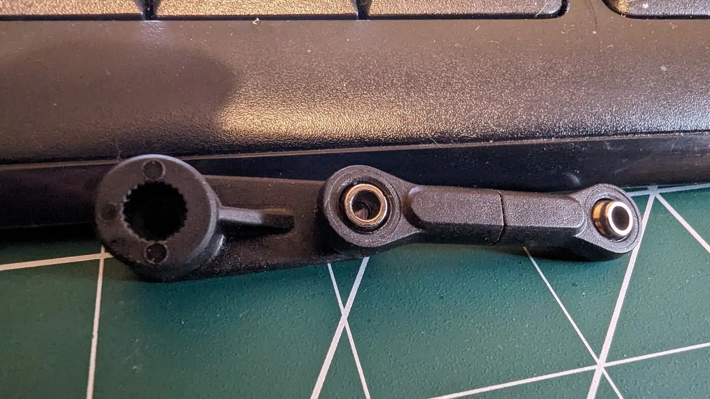

At the other end of the linkage, here's the detail of how I fit mine. The M3 nut is captive inside the steering bellcrank. The linkage sits on top of a conical washer and 3 0.5mm washers. This definitely works and no way this end of linkage is going anywhere.

Hmm.. assuming you don't have a means to tap the pivot ball the rest of the way through. Probably not feasible since you'd have to grab the pivot with pliers or similar to tap it.. I think the most efficient remedy is a different servo horn, and/or steer link? A poor design indeed they used there. The plastic horn is a bit of a letdown. Tekno gives plastic horns in their kits too.. the one included with the v1 MT410 wasn't even worth the time to install it stripped soo easily. LOL.
Your appraisal is 100% right. 👍 It's almost like they designed the car, got the kits ready and thought 'oh $h1t - where's the linkage going to go' and bodged a quick fix the day before release. 🤣
I attempted to cut a thread, but it simply wasn't worth damaging my M3 x 0.5 tap. The 6mm ball stud would have been mangled if I'd gripped it strong enough to cut into steel. 😬🔨
The Sworkz alloy horn is £20. 🙄
My work around should work and I'm not sure if all the kits are supplied with a stud like this or whether it was just a one-off with mine. Perhaps my kit was packed on a Friday. 🤔
An entirely different setup would be better, with the countersunk going in from the bottom with a locknut on top. This is what I'm looking at doing, but there's not much room to play with. As in - no room whatsoever.

That should work.. HaHa, that's what Sworkz prolly said too, LOL.
TC and Arrma use a threaded pivot ball that accepts a hex key for tightening IIRC? Maybe you could retrofit one of those?
That could work. Or a 6mm ball with M3 thread straight through the horn, with the lock nut on top. 🤔

Definitely points for ingenuity. No points for Sworkz. I do like how you've set that up. (y)
I'd be in agreement. The alu servo horn from my cheaptastic amazon servo actually sits rather high. I'm thinking to do Horatio's washer set up so that I can run that servo horn. Plastic horns are a bit of a conundrum; they're not so great because they can strip easy, especially on 1/8 rigs. Their weakness can also be a positive; I'd rather strip a servo horn than servo gears.

You weren't kidding. Wow, that's cutting it by a hair. As I mentioned above, my cheapo amazon servo horn has it's arm sitting a little higher than the crown where it attaches to the servo. Initial fitment caused a rather extreme angle on the servo linkage, but with your remedy I believe I can now make it work.

Just found this Sworkz 6mm steering ball stud:
Which bears the same part number 330694A - but unlike mine - it clearly has a hex. Mine didn't. Also, mine was silver in colour. 🤔
Looks more useful, but doesn't look like the M3 can go all the way through. Ideally, I'm trying to find a way of securing it with M3 lock nut.
Seeing other parts, there are thes 6mm M3 threaded balls:
These could work I reckon. No stand-off, button head straight through from the bottom, through the horn, lock nut on top?
Obviously I'll have to change the plastic horn because it's counter sunk.
Edit to add:
I've ordered this offset horn (more space under the horn:
Along with the threaded 6mm balls. 😁
