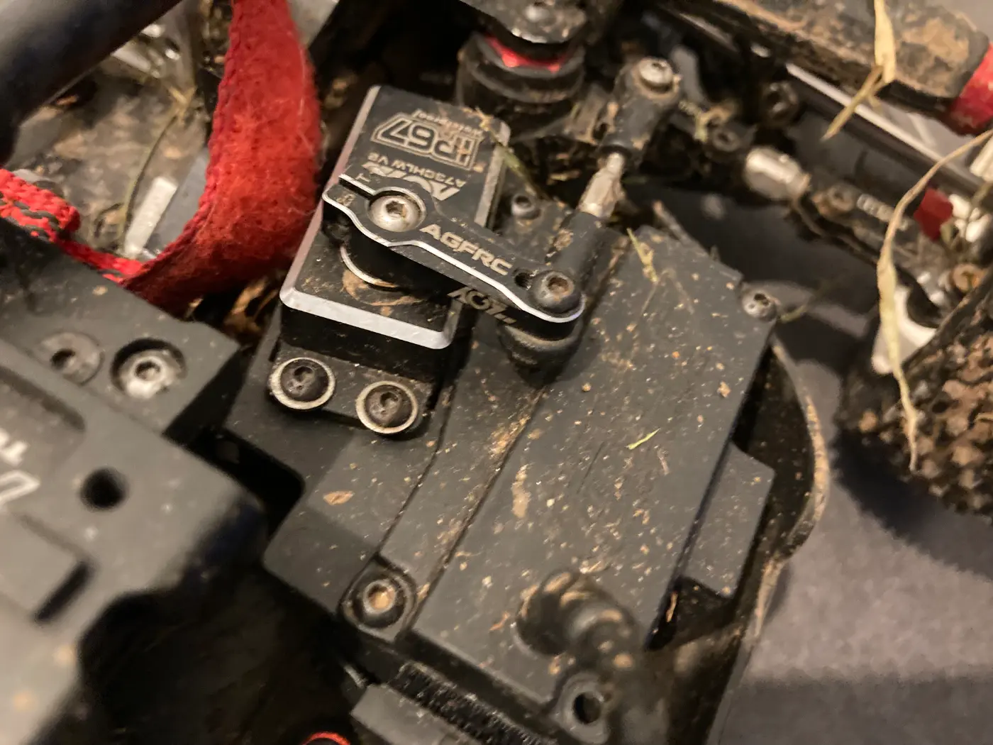

Full convert to posh servos now :D got 2x A73BHLW V2 from Scorched Parts cracking service so far.
Stuck one in my kkpit beetle and at first it did not seem any quicker than the cheap brushless one that was in it before but dear lord you can tell when the beetle is ripping about the steering is so responsive and way faster now, well worth the cash to me :).
These 6s Kagamas are tanks you will enjoy launching it :D.
Only things I keep an eye on are the rear lower hinge pins like to bend after hard crashes never effected how it drives just wears the little plastic inserts out quicker and the rear input pinion bearings like to wear making play and buggering up the mesh on the rear diff :rolleyes:.
Now that your converted although unless you use discount code scorched prob best price for them , but if get them from AliExpress direct from agfrc can buy them without servo horn bit cheaper than with then upgrade to their more fancy servo horn 😂

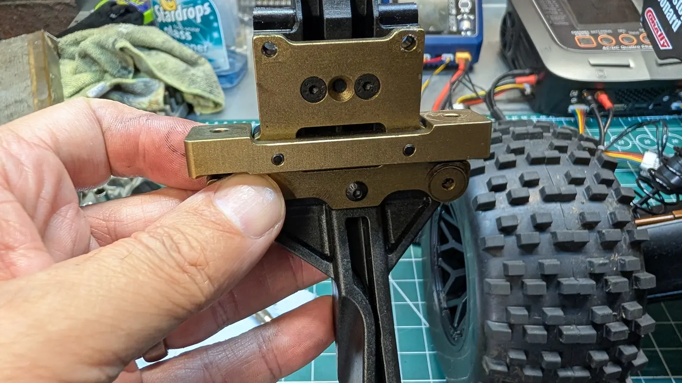

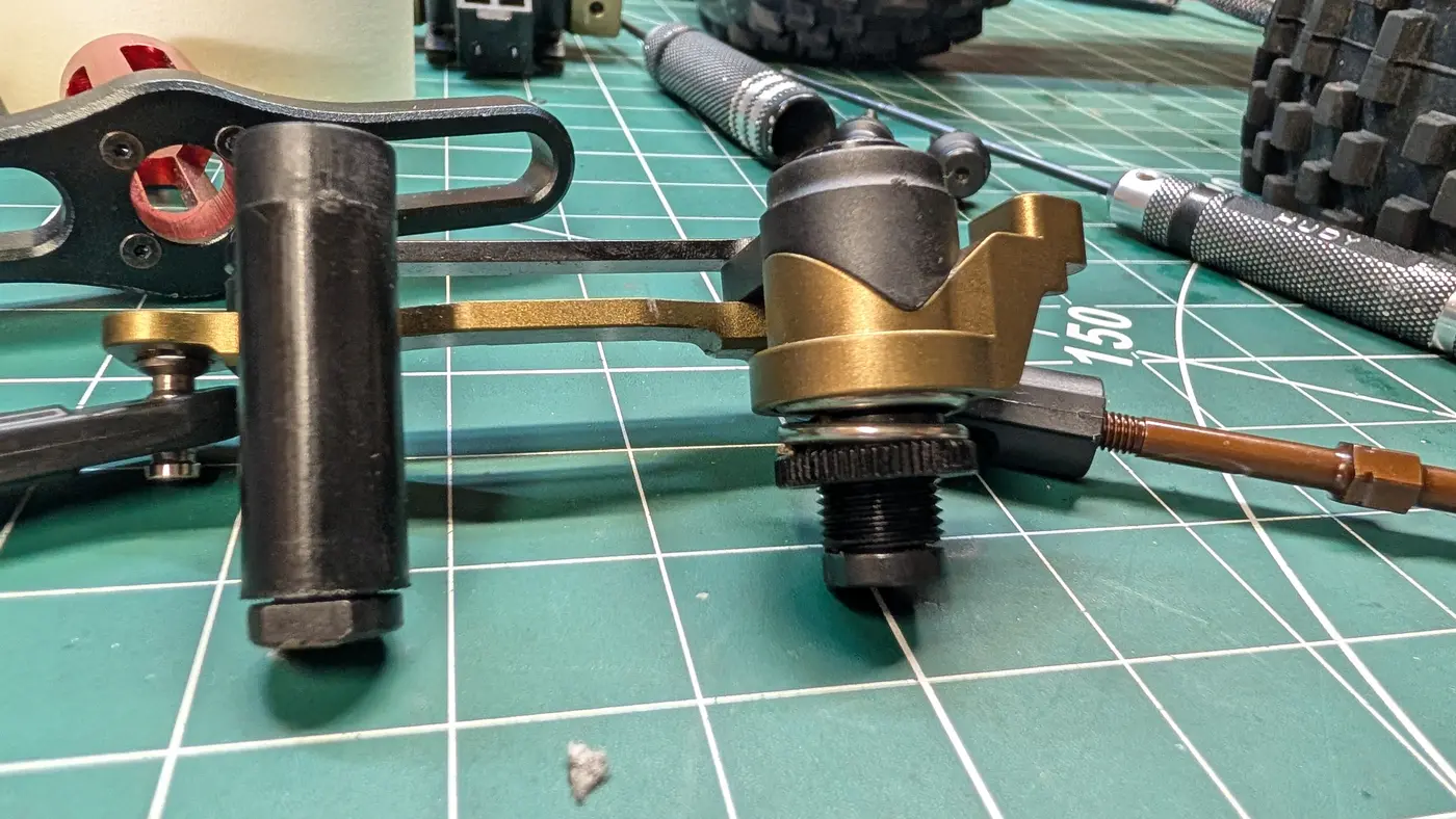

Thumb screw tightened right up. 👌 Much better. Tolerable for now.
Crafty hidden screws. 🤦
Car is done for now.
Servo and Rx incoming.....

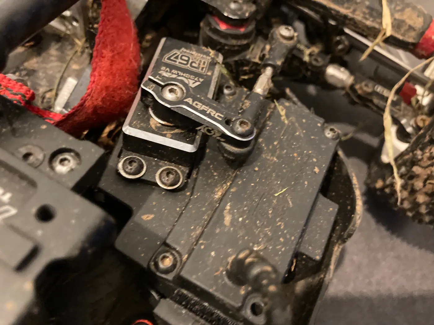

Fitting AGF 81BHMW and new Corona FASST receiver - full fat, full range. 😎
☝️ More redundant stuff. 😝 Servo might find it's way into my Sand Scorcher. Receiver will be quarantined for the sake of humanity. 😅
