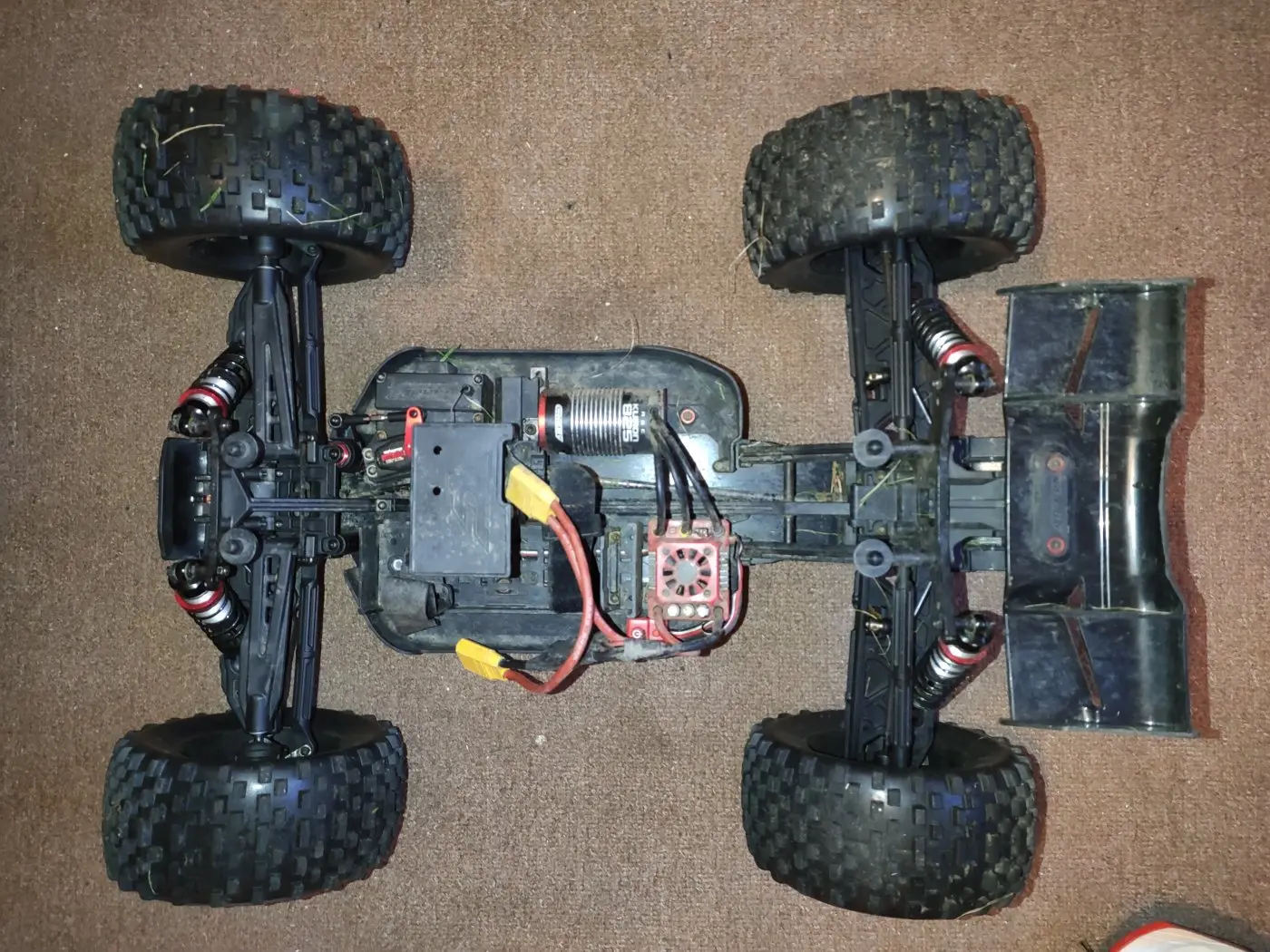

Kronos Front wheels not straight

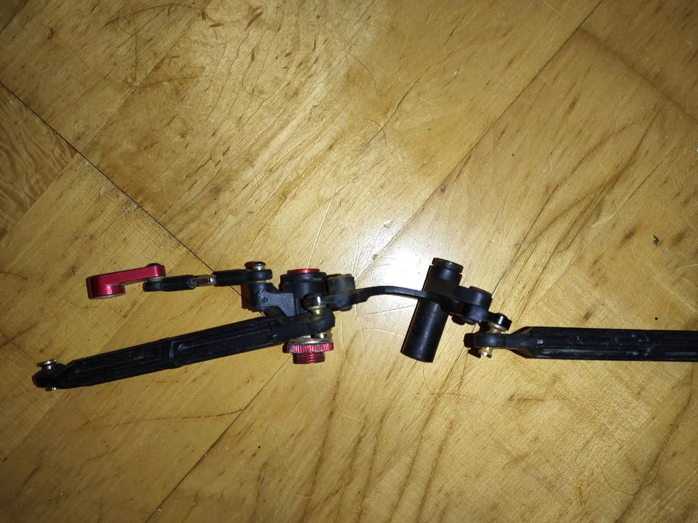

I'd be checking to see if you bent the steering rack/ackerman bar, it's a little difficult to see being buried in there, if it's bent it'll pull the turnbuckles in at the center thus toeing the wheels out, no guarantees that's it but worth a look
Well @AngrySection8 was right on the money, I know for sure that the steering rack is not supposed to look like this :LOL:
I've been sat on a whole new steering set I managed to get off of Ebay for £23 for over a week and eventually found the time to figure out how to replace it. A couple of hours later and Bob's your uncle:

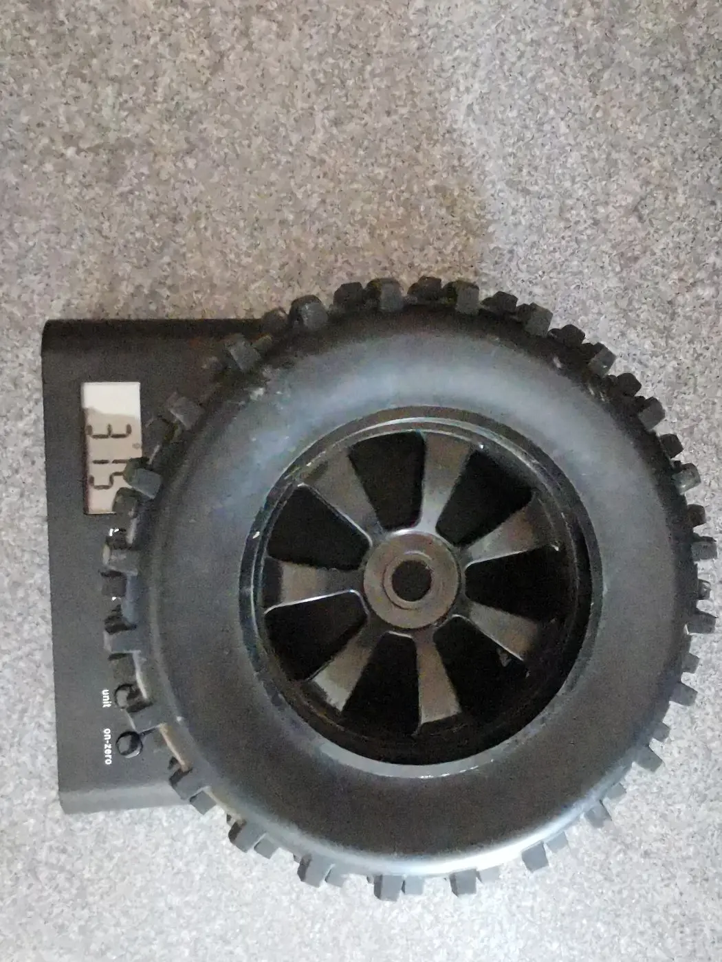

The stock tyres are an acquired taste, looks-wise. They hook up well and are nice and light - but they really balloon and are too hilarious for any serious road use. Unless you like giving your body shell serious road rash! 🤣

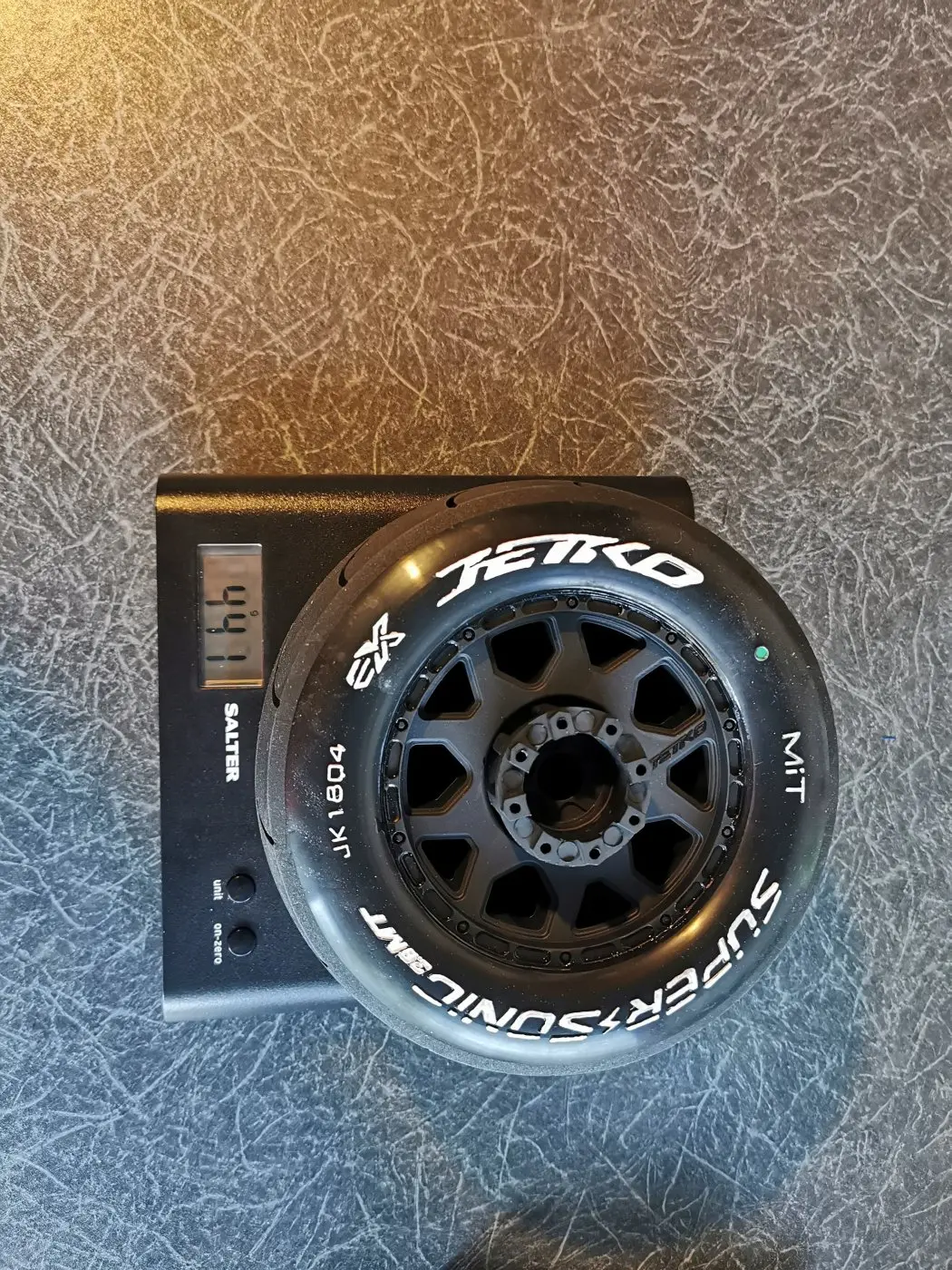

The JetKo Belted Slicks are awesome. They weren't that expensive (I keep telling myself that with all my toys!) - but they are heavy.
But these are what you need for high-speed runs, once they've been balanced.

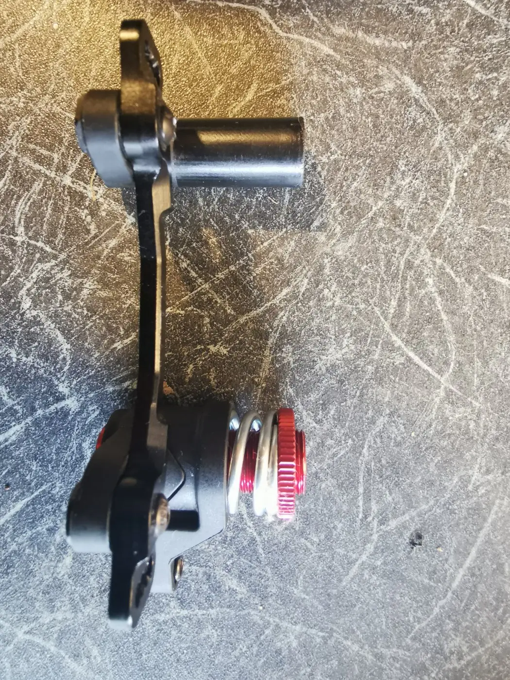

This was how I was running my servo saver. Far from ideal.

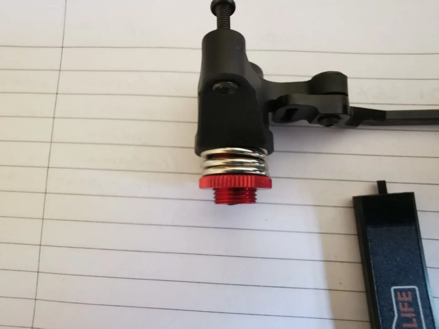

Now it has a proper, beefier spring...
Problem 100% solved. It doesn’t matter how good your servo is - if the servo saver is all floppy, the wheels do what they want to do - forget your input - the steering will be all vague. Your inputs are merely suggestions that your Kronos will mull over and get back to about. Possibly. Or it might just have an accident instead. Hilarious torque steer and consequent comedy will occur. 😝
I'd just like to add, that initially the stock servo saver spring seemed OK. But as soon as I started hurtling it around on heavier tyres, the spring seemed to lose tension and get weak. Then even when I reverted back to lighter wheels and tyres, there was still a problem with the spring unless it was clamped right down.

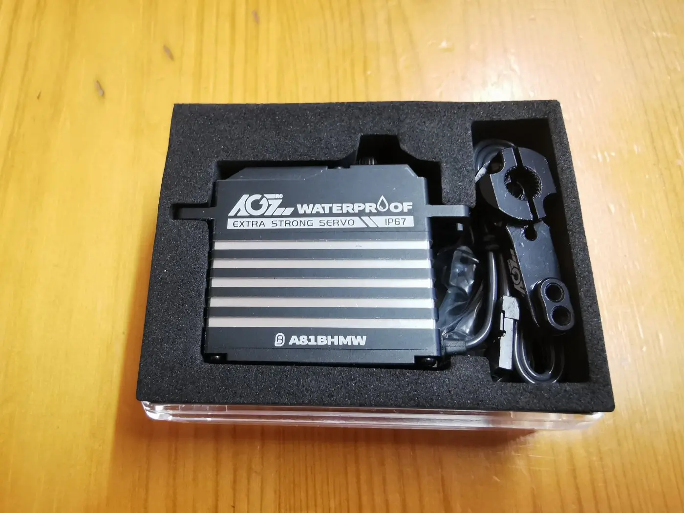

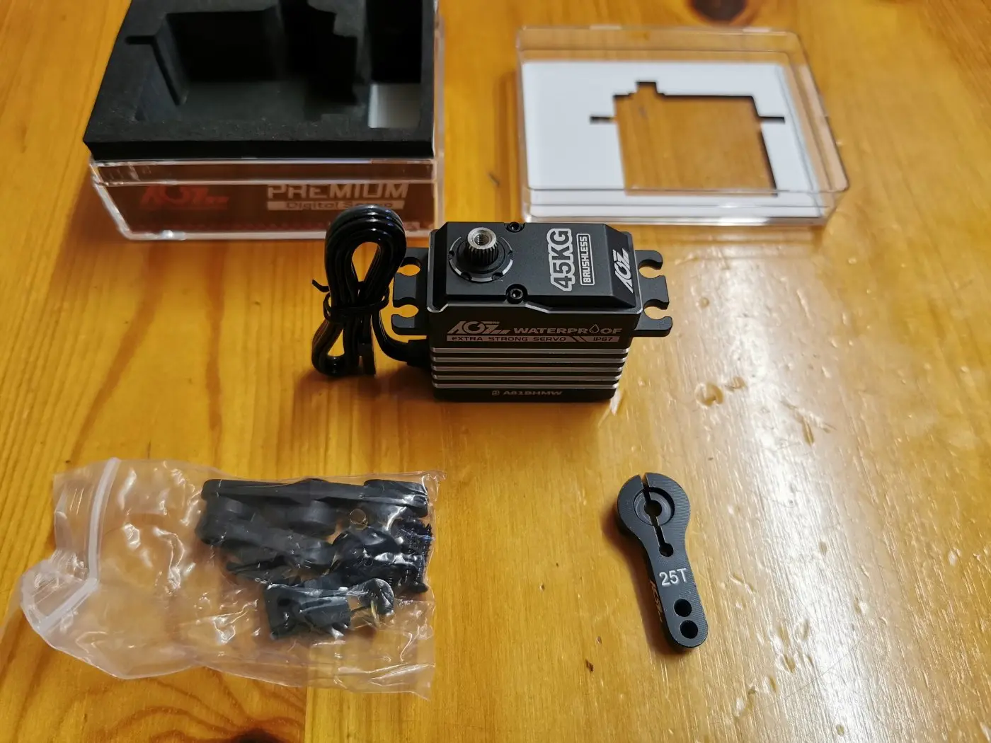

Because my XTR was a roller, I selected a suitable servo from the get go. I had intended to get Protek 170 SBL servo for it, but in the end used AGF A81BHMW 45kg which has turned out to be a brilliant servo.
The JetKo Tyres are heavy and needed balancing - 1 needed 6g of weight. The other 3 needed less than 5g.
Check your car's toe out. It might have too much. I don't recommend more than 2° On these JetKo slicks.
I selected this servo for it's impressive speed, HV voltage handling, being waterproof and good centre holding (by all accounts). Specs were very impressive for the money, which I why I held off getting another Protek (which are absolutely first rate racing servos).
