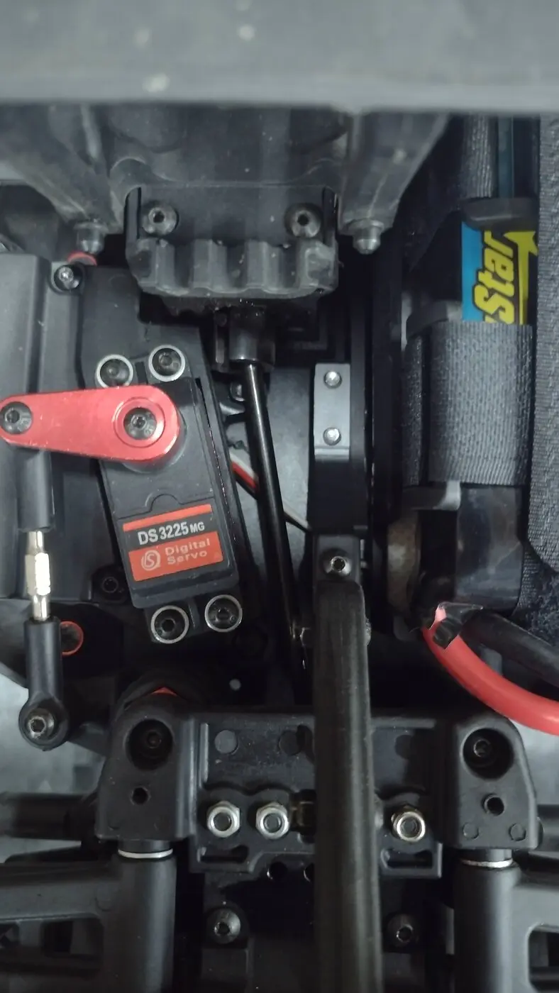

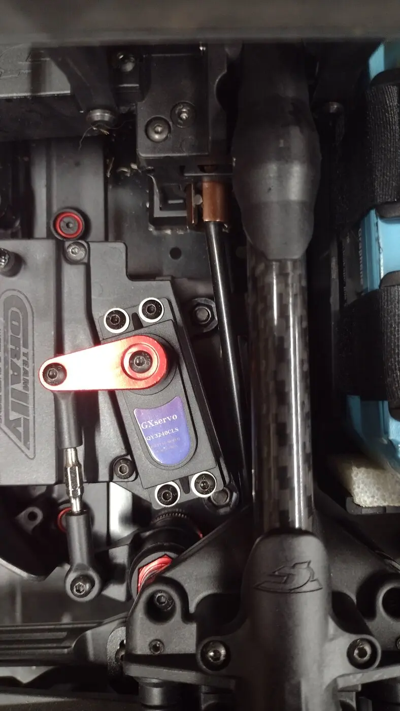

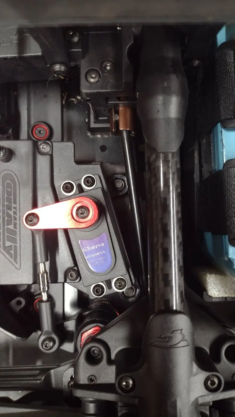

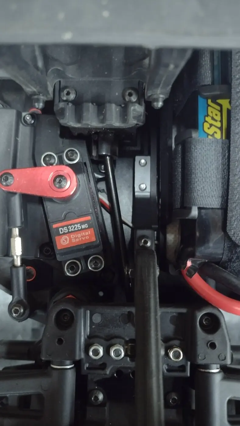

Is it just me, but does the Kagama have a straighter centre drive line? As in less of an angle on the centre front drive shaft?
Belted Sweep Crushers. 💪👍
Sure does, both front and rear are a lesser angle than previous versions, kagama first pic kronos second pic
