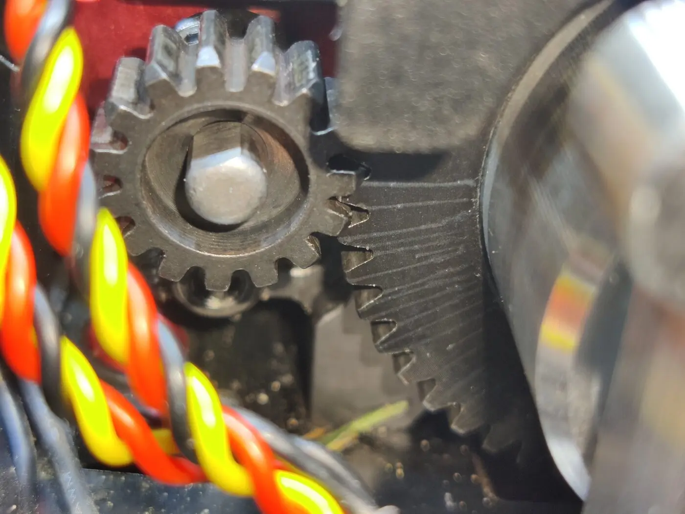

Sketer uses mod 1.0 pinions I'm pretty sureI can't tell for sure, but I think you have the wrong gear pitch on the pinion. The gear pitch on the Sketer is 32p, which equates to Mod .8 pitch, and that pinion looks like it might be Mod 1 pitch.
It's confusing: one site says they use 32p, another site says Mod 1.Sketer uses mod 1.0 pinions I'm pretty sure
Are your motor bearings o.k. ? It's not uncommon they wear out quickly. Maybe you should check them first and replace them with some MOTOR BEARINGS (not the rubber sealed stuff).I can move my pinion up and down. Motor bearings looks broken. Why? Not that old.
Only drove 15 to 20 lipos (Sketer was still stock) changed to 15t (didn't test it after i saw this moving) Bearings are cheap i know but i am gonna ask Corally how this is possible. Corally waranty?
completely with you!You should have enough play between the gears so that you can hear a "tick-tock " sound when you rock the spur gear with your finger.
