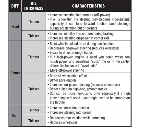

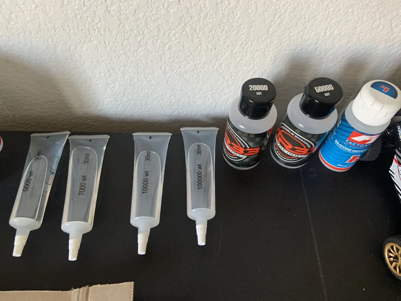

Can anyone tell me why some people put in very thick diff syrup in the middle diff?
Seen some videos on yt where they put in 500k or even a million. I know it has to do with the distribution of power to the front and make a kind of difflock with the thick syrup but 500k or more makes a lot more stress inside the diff, will the planetary gears even turn with those syrups?
