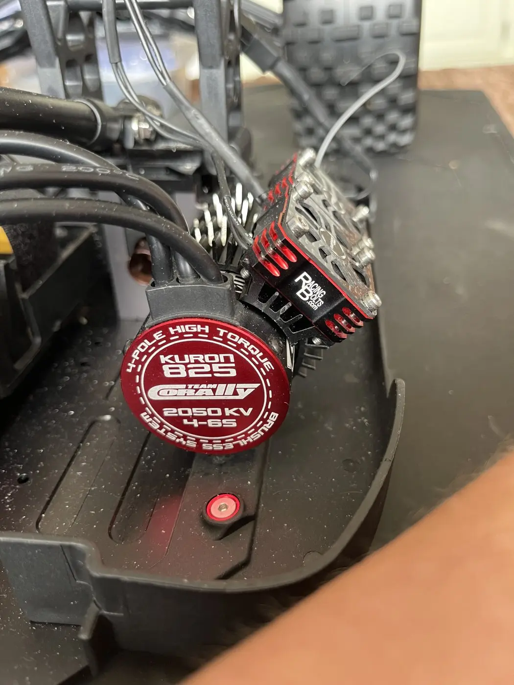

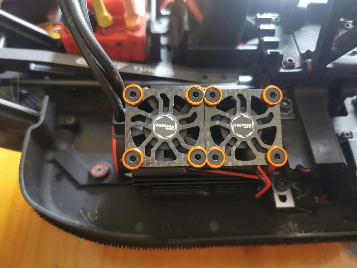

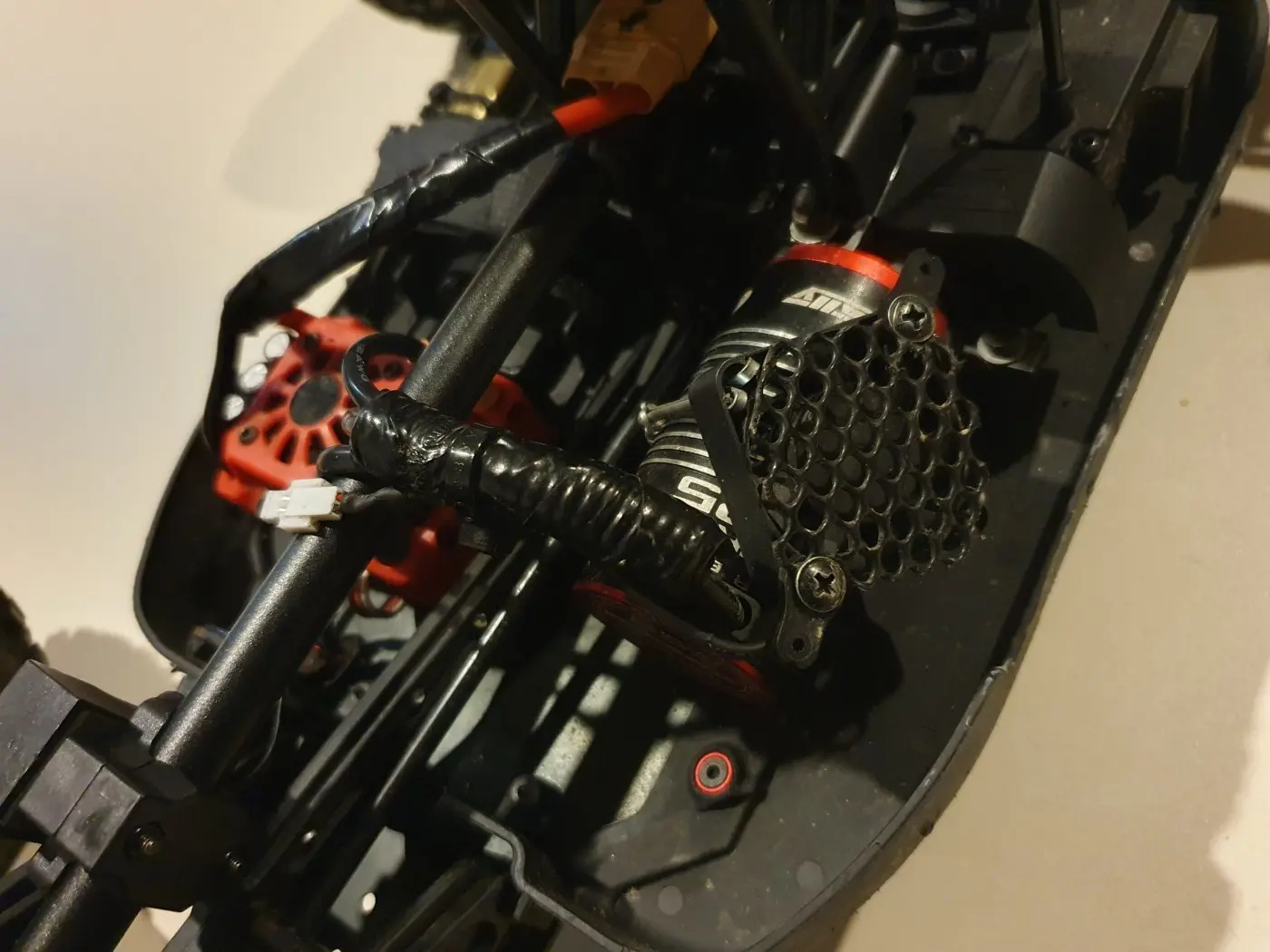

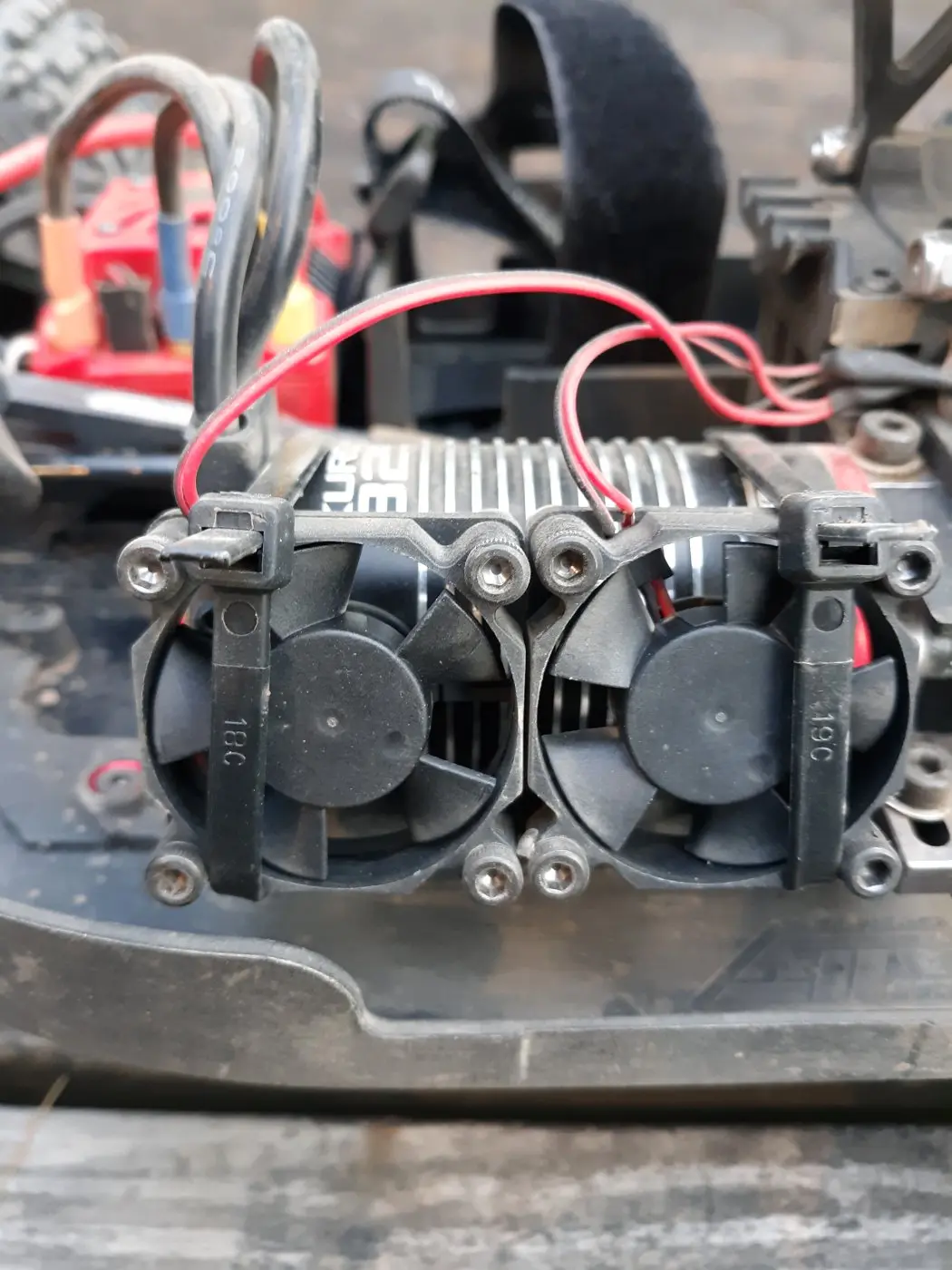

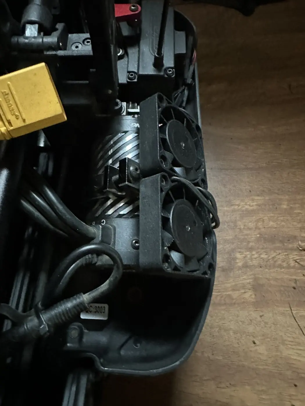

Ive got a shogun 6s, ive made a cooling fan out of a mini computer cooling fan running off a 9v battery. Is there a plug and play option?

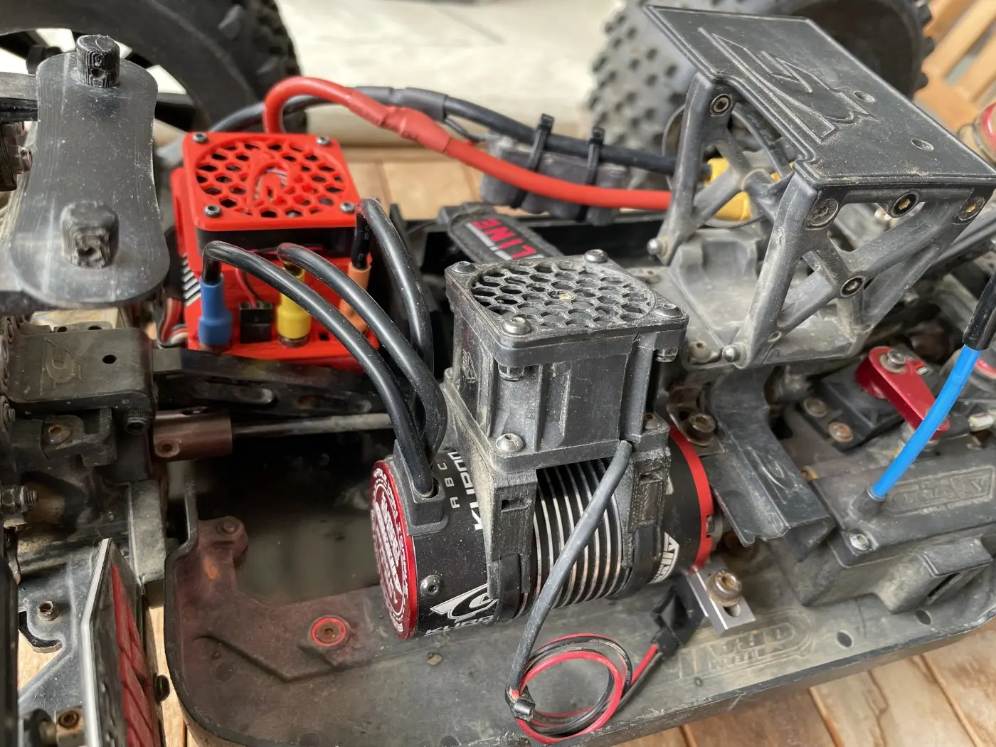

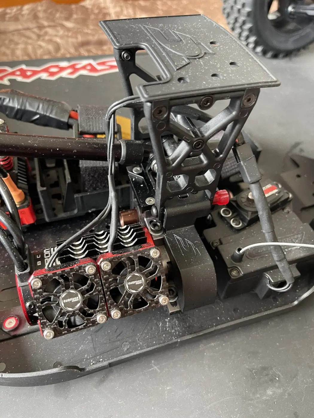

Thanks for that,I bought a heatsink and fan combo off of ebay that sits around the motor. I then bought a a split harness that goes in the ESC, ESC fan and the motor fans then go in to the split lead.
I wouldn't that these 2 exact items are particularly plug 'n' play since the cables are all really long and I have them wrapped precariously around the body posts at the minute, I need to get out the soldering iron and shorten them up.
I wouldn't advise that exact fan/heatsink combo though since the quality wasn't great. They sent the wrong cabling with it, not once; but twice so right now I only have the one fan mounted. Once I get my soldering iron out again I'll butcher the two cables together to get a fully working system.
They were several options available when I had a look.
Still, ultimately using a split cable is likely a better option than having a 9V battery potentially rattling loose in your chassis?
There isn't a risk to the esc piggybacking the fans? Do you know the voltage of the esc fan. Thanks mateI bought a heatsink and fan combo off of ebay that sits around the motor. I then bought a a split harness that goes in the ESC, ESC fan and the motor fans then go in to the split lead.

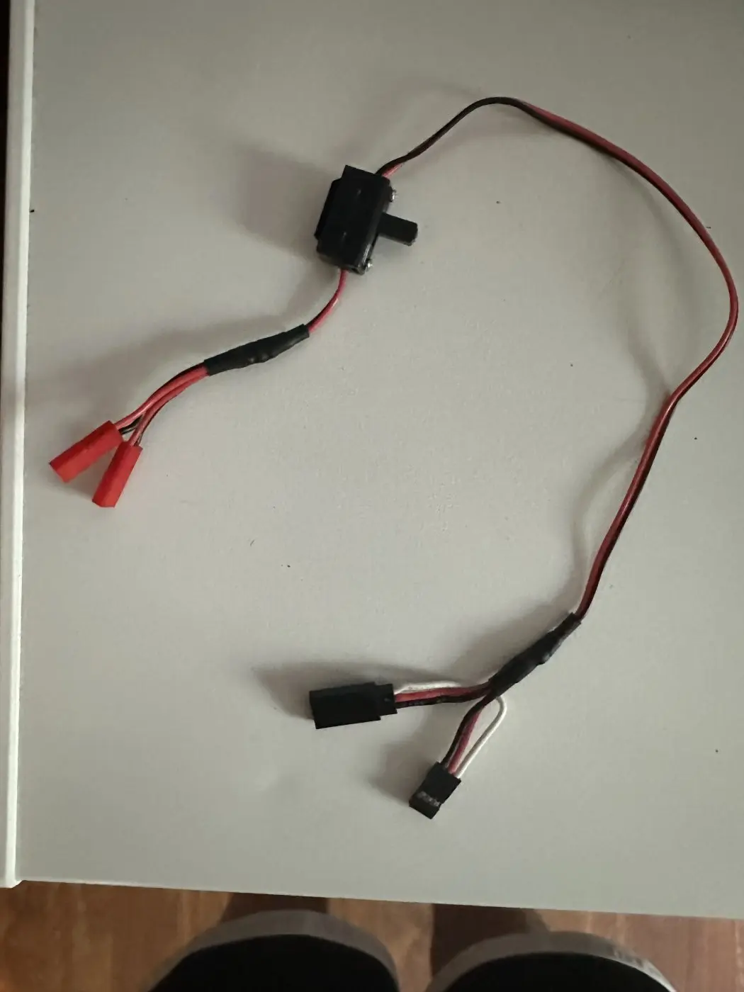

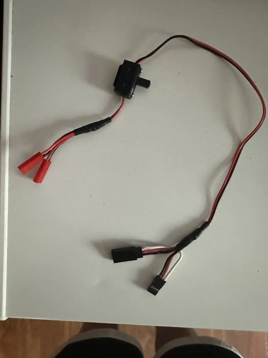

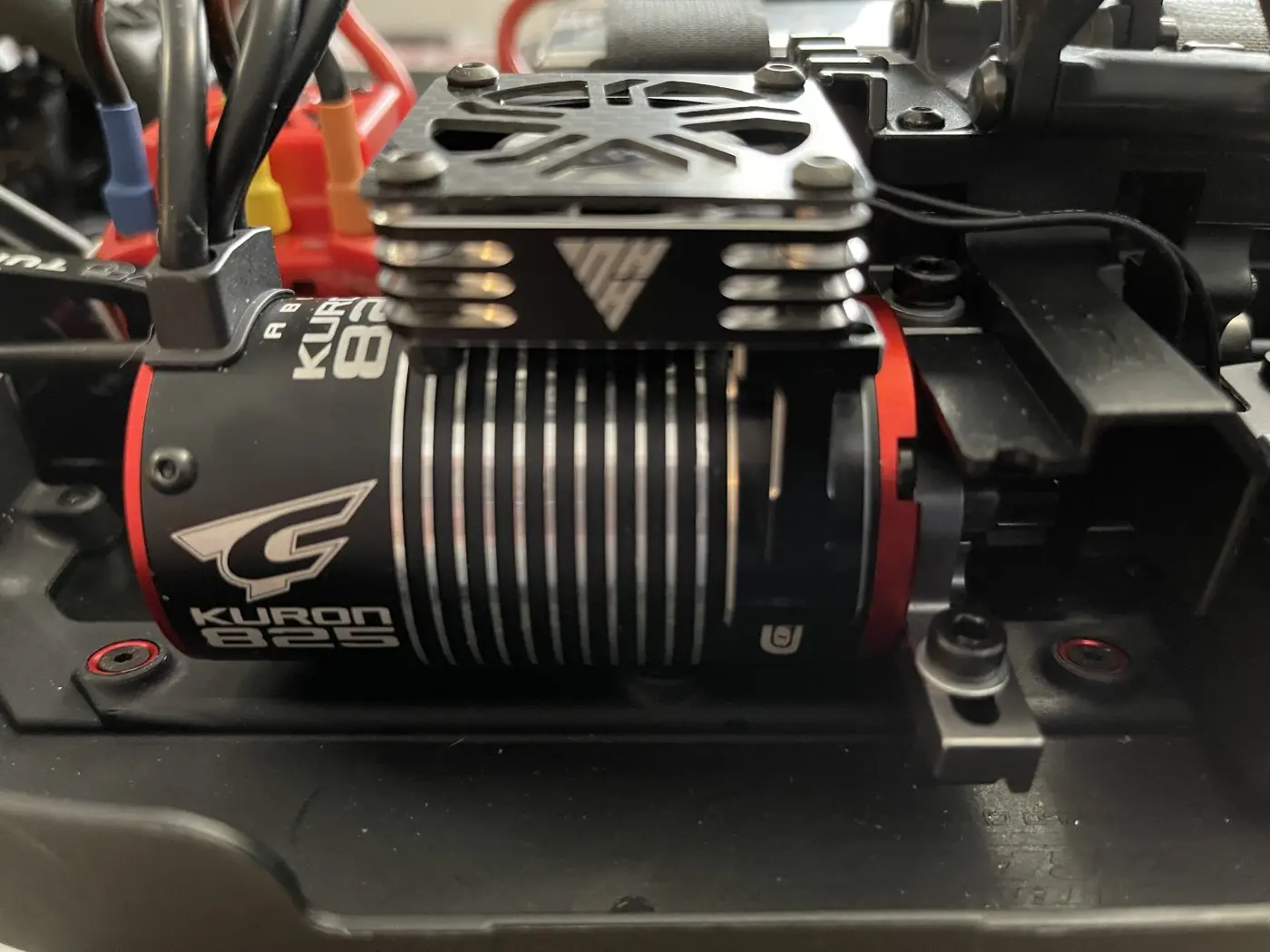

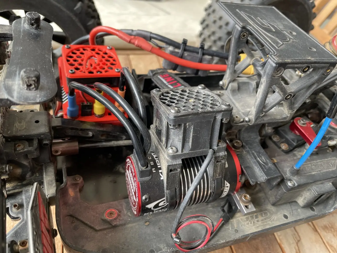

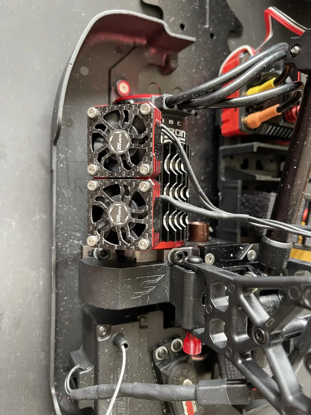

Thanks for the info mateYou can either install a Y adapter at the esc where the esc fan plugs in or tap into channel 3 on the receiver. Assuming the receiver is 3 channel. It's possible to overload the esc I suppose, though unlikely with these miniature fans. I've used fans ranging from 5-12v without issues. The 12v fans won't deliver their advertised performance since the most you can send from the Torox esc is 7.4v. They still work though. There's a plethora of heatsinks (HS) out there with and without fans. The Corally Kuron motor already has fins on it so, those are the heatsink. Adding another slip on HS will leave you with voids of hot air trapped between the motor fins and slip on heatsink, not a good idea. You really just need a fan mount and fan(s). I like this (below), but there are many other types out there too.
https://www.amainhobbies.com/exotek...SBOJ2wHa9TD25skIruq48hYWrCXuPXFRoCWQcQAvD_BwE
That's a great idea. Being able to turn the fans off!? Wow, why didn't I ever even think of it? LOL.I use the power hobby dual fan and radio control power has y adapter power switches. A few different types
U can plug that into esc side great product
