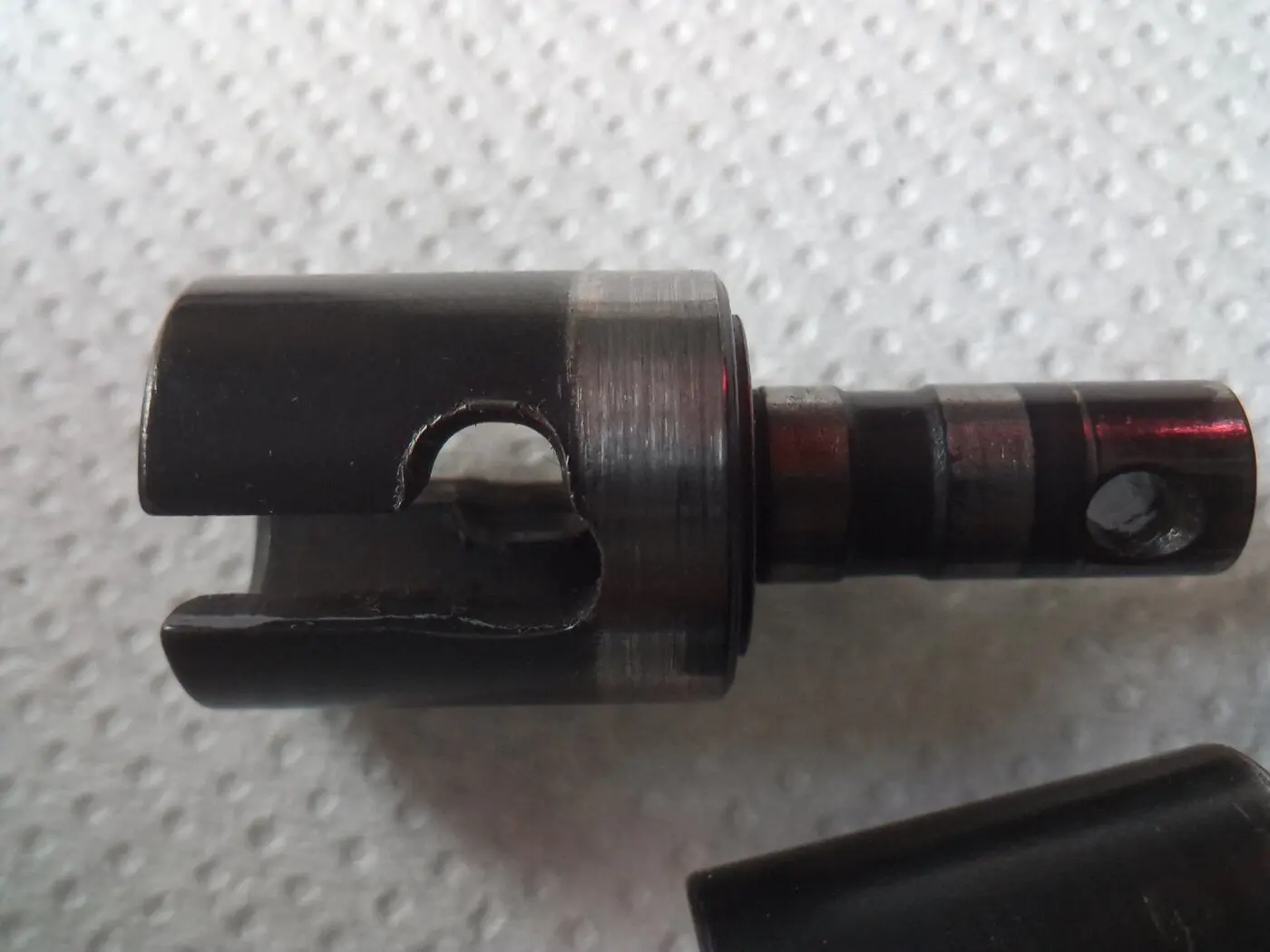

- standard spring steel diff cups can exhibit notching, where the pins on the dogbone/driveshaft can wear a notch in the cup

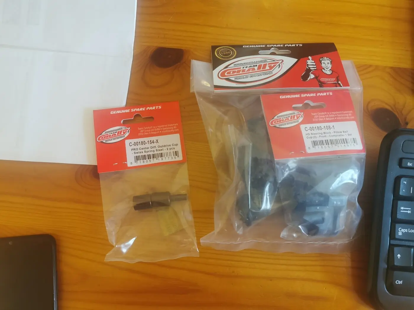

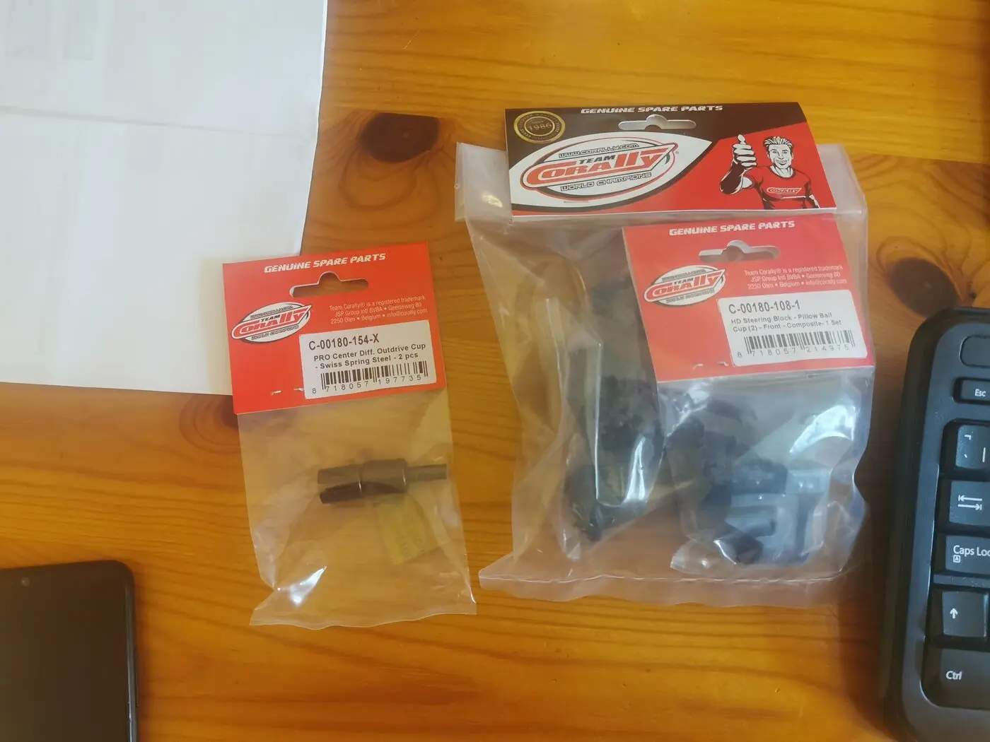

Only issues I see is the dog bone pins wearing the outdrive cups. Corally have given me part numbers so I can convert all the outdrives to the new spring steel. Last thing is I purchased mine February 23 and I didn't get the tower to tower brace like some others mentioned here..
