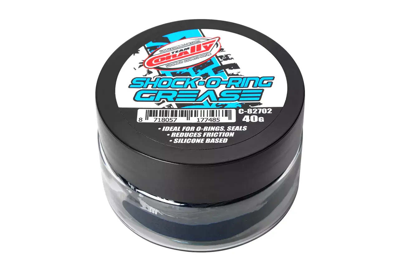

Team Corally – Blaues Fett 40 g – Ideal für O-Ringe, Dichtungen, Lager und Reibungsreduzierer der Aufhängung​
Team Corally
C-82702
Team Corally
>10 auf Lager
6,50 € 5,37 € exkl. MwSt. MwSt
st
shopping_cartIn den Warenkorb legen
BeschreibungTechnische Daten
BLAUES FETT
• Ideal für O-Ringe, Dichtungen, Kugellager
Yes, that would definitely be helpful! I think only two of the shock collars on four of my Corally rigs moved smoothly. I didn't know they had a specific grease for it. :oops:
