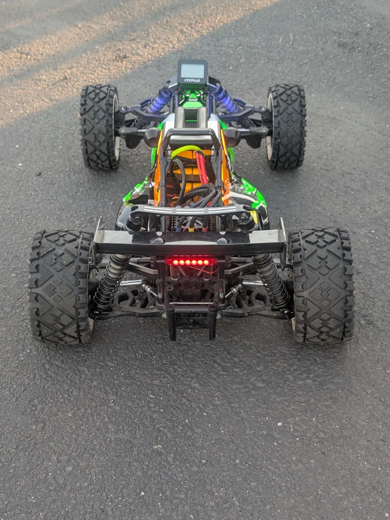

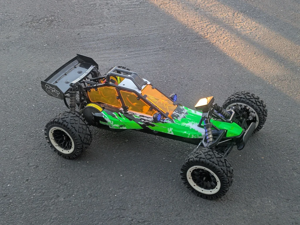

Some preview pics, still not finished with it. Note the body side pods have been replaced by the Baja 5T underguard instead. I also replaced the roof lights that came with it with an aluminum plate and and upper roll cage / handle.

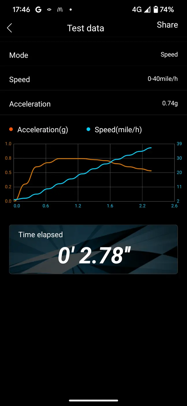

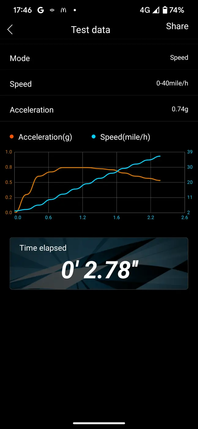

Challenge accepted, what car, what terrain, what battery S's.??
Baja 5B. 26cc Fuelie (16 years old). Tarmac. Keep us posted. 👍 Zero driving aids - no auto throttle or gyros.
@AngrySection8 will be busting out his Bartolone engine and smashing this 0-40 time in 3...2...1... 🤣
Regardless of engine, Vs brushless - it's going to be very interesting. Multiple factors come in to play.

I need traction first! My off-road testing on frozen ground just isn't cutting it. Ultimately I need to give it a go on tarmac, guessing it'll be a few months before I start posting Baja times but definitely interested in what others can achieve, I'd really like to know how my gasser compares to the brushless stuff in the acceleration department.
Nah! Your best Baja times so far have been done on frosty grass! 'Need' is far too strong a word. 😝
I believe brushless will have the torque and HP advantage. But.
0-40mph will be a great equaliser - believe me. 😁
You can only put so much power to the ground before the tires give up and a 12s 7500w motor is likely beyond that wall. I'd have to get into ridiculous things like duallies to make an improvement but I'm more interested in just bashing. I know that it goes fast and that's enough.
EDIT: After adjusting the camber to neutral (out of the box the Rovan baja has high negative camber) and with the tarmac buster tires top speed was 62mph @ 49v. I think that's plenty fast so I am now ignoring the little voice telling me to gear it up.
These springs are 2.2mm for the front and 2.5mm for the rear compared to 2.5mm for the front and 2.7mm for the rear on the stock Rovan springs (I feel the Rovan springs are too hard)

The Rovan e-baja comes with standard 8mm dogbones and drive cups not the HD 9mm ones. However they seem to be holding up to 12S fine and the cups and point show no visible wear so far (why don't Corally cars use drive boots and grease?). I will eventually change them out for the HD version at some point.
The shocks show some silicone oil residue inside the boots but no visible leakage (Rovan uses silicone oil not fork oil like HPI). It's likely oil is gradually working it's way out of the shock via the shaft moving so I think tighter seals are in order. The shocks clearly have air in them, they rebound quite a bit. I was already expecting to need to redo the shocks correctly.
I noticed that the wheel hexes have a thread for a screw pin but Rovan provides only plain pins.

You know how fast. The stock 8S flux can achieve over 60mph.
But how rapid can you get it to go? That's where the challenge lies. 0-40 times are where it's at.
62mph on asphalt with street tires 41mph on a rough field of wet dirt and grass with knobby tires. Acceleration feels no different than the 6s Shiroi I ran on the same field afterward, one is a 12lb car and the other is a 28lb car. I would like to be able to wheelie it though so I will be gearing it up, it was only hitting a max of 140A and only briefly, usually at full throttle it was around 100a or so. There is plenty of headroom for increasing the gearing with the 250A ESC.
